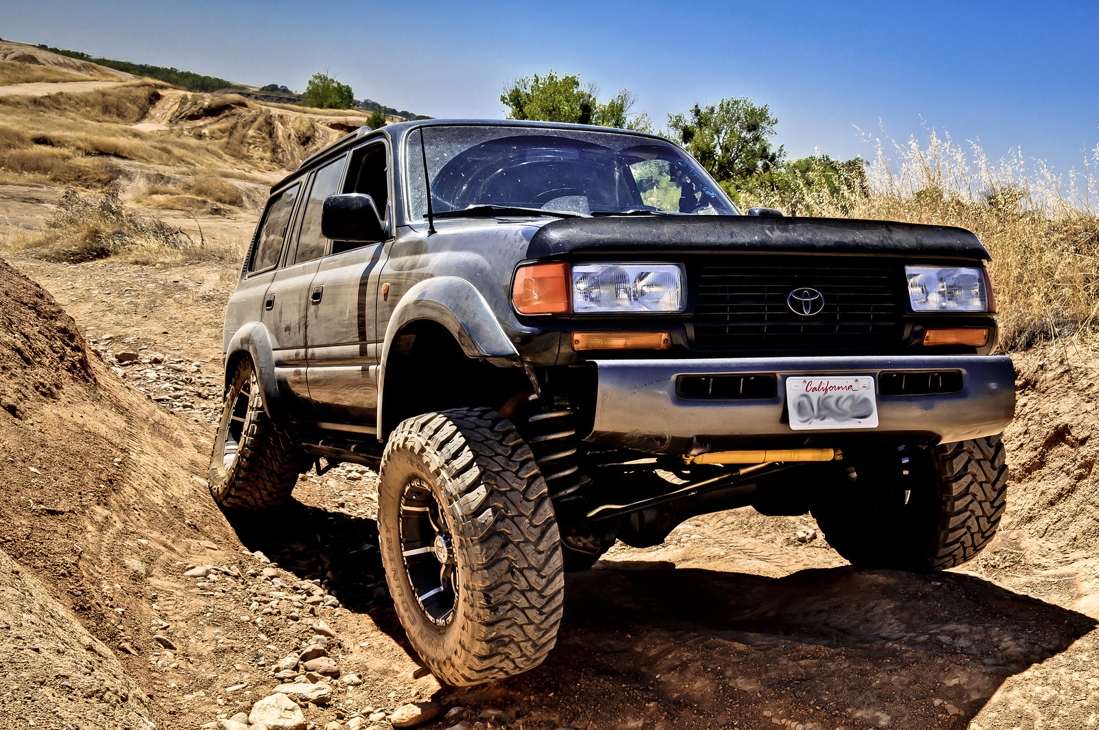

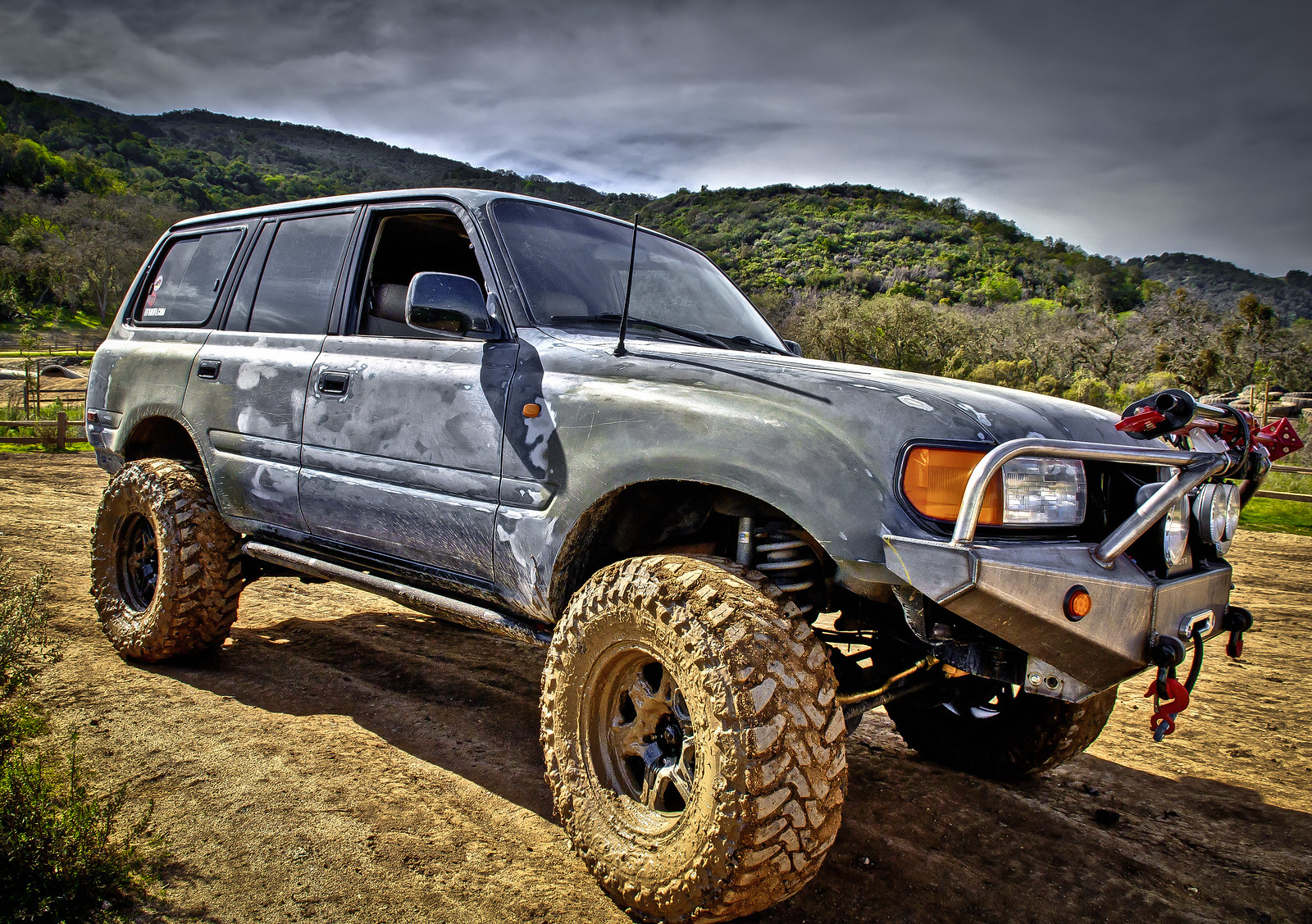

1996 Land Cruiser
163,XXX miles
Factory lockers
F.O.R 3.5” lift
Fugly 17x9 wheels
35x12.50/17 Toyo Mud Country tires with plenty of meat left
Rock sliders, welded
Chromoly Birfs (according to the PO, unconfirmed by me)
Parked outside of my office the day I assumed custody (June 22, 2012)

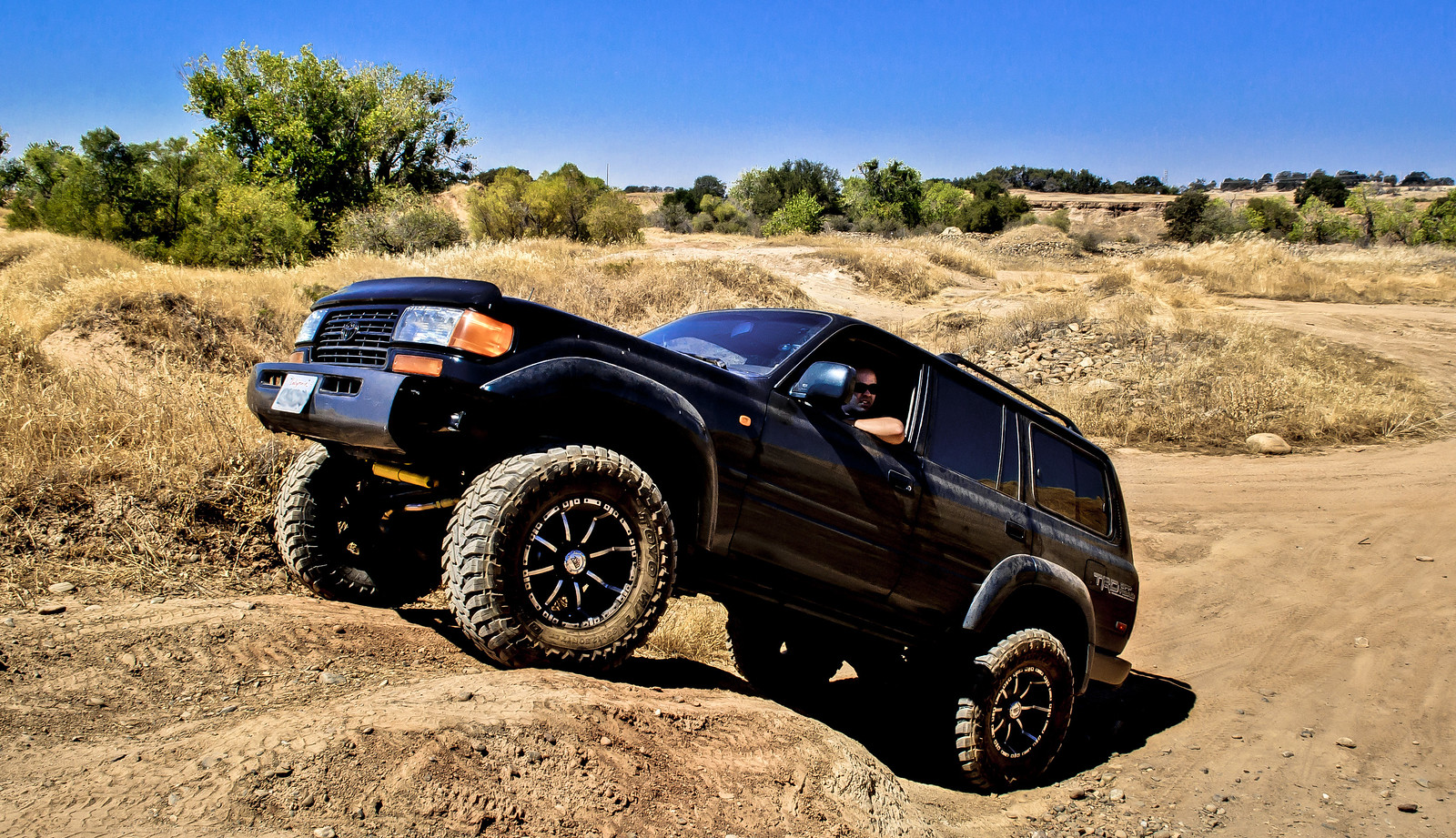

Took her out wheeling for the first time on some easy dirt roads and managed to get high-centered. DOH! Rookie move. This is when I realized I need a winch.
STUCK!

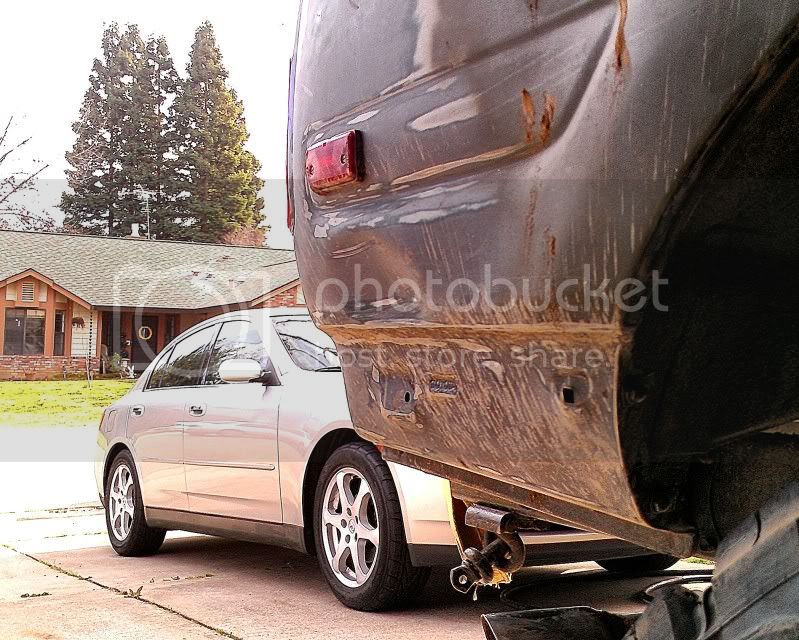

I didn’t make it out of Slick Rock completely free of damage. I tore off a rear flare after bumping it against a rock. This was a turning point for me. I knew the flares would have to come off eventually if I wanted to do more serious wheeling. And I knew if I removed the flares I might as well repaint the whole truck, or line the whole truck with something more durable. After this it was all downhill. Or uphill??? Ah who knows. Either way, it results in more money being spent. Doesn’t it always? :)
The very next day, after tearing off all the flares

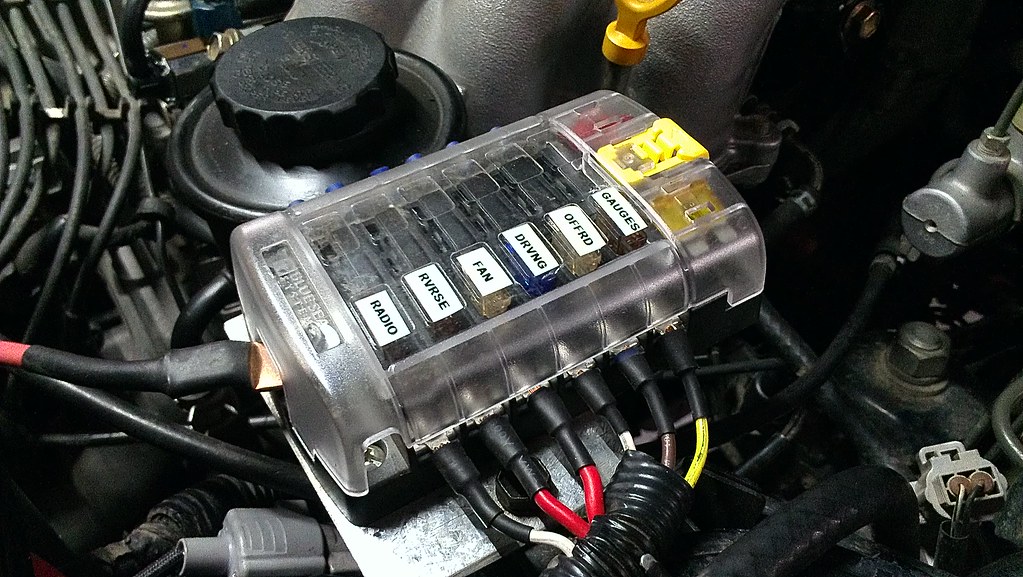

Now that I’m starting to add all sorts of gadgets and gizmos, I need to add an auxiliary fuse block before it turns into electrical spaghetti behind the dash and under the hood. I decided on the Blue Sea 5029 fuse block with 12 slots. This thing is NICE! Used a lumber tie-plate from Lowe's and attached it to the charcoal canister bracket. This should give me enough room for all the gadgets I will add in the future.
Added some extra switches in the stock openings in preparation for the lights I’ll be adding up front

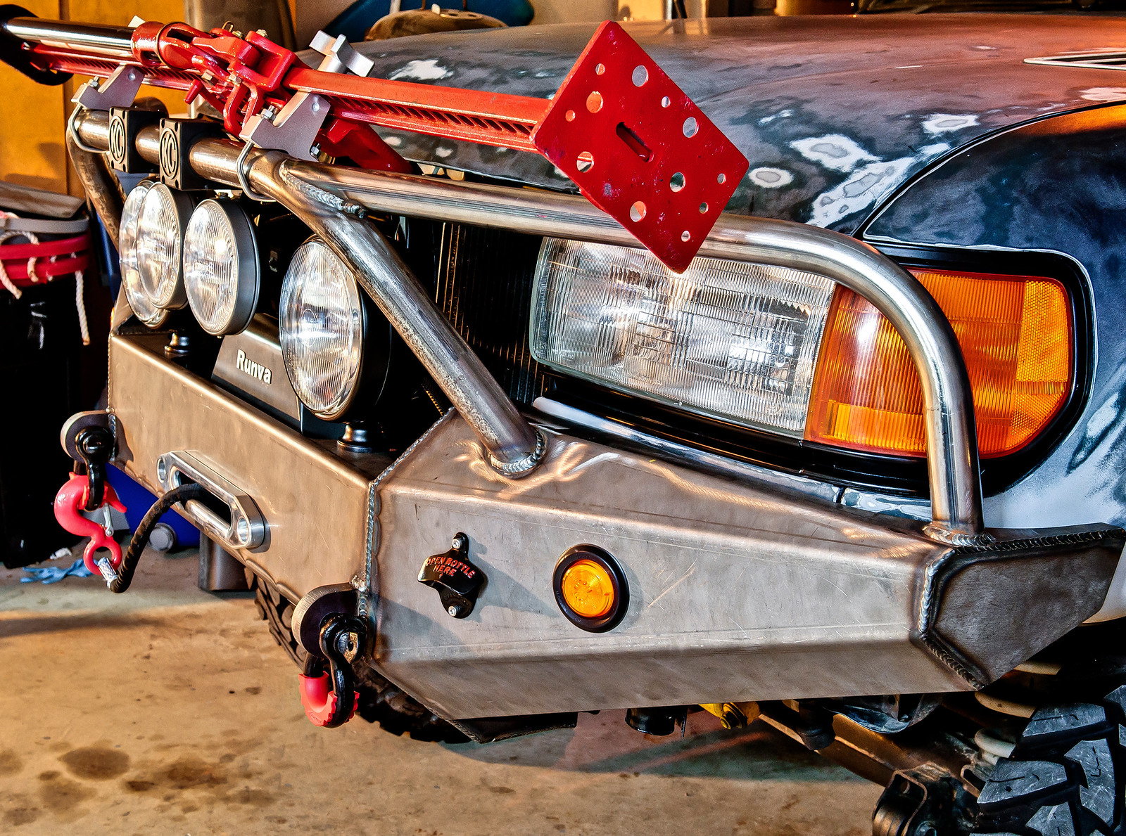

AT LAST! After what seemed like an endless wait, my bumper is here! I started off by putting a deposit on a Bink's bumper back in August. After two months of waiting I got a refund and chose to go with AOE's bumper. It took me four long months to get this bumper but the wait was worth it. There was really no other bumper on the market I liked. Bumper seems to be really well built but I really have nothing to compare it to. The whole thing is very solid and went on super easy. I decided to leave it bare steel. I’ll sand/wire wheel it to polish it up and clear coat it. No black bumpers for me :flipoff2:
The bumper gives high approach angles and the way it's built it covers the factory turn signals. So I bought some simple trailer lights at Napa which actually look good IMO. And of course, an offroad bumper is not complete unless it has some bottle opener bling :clap:

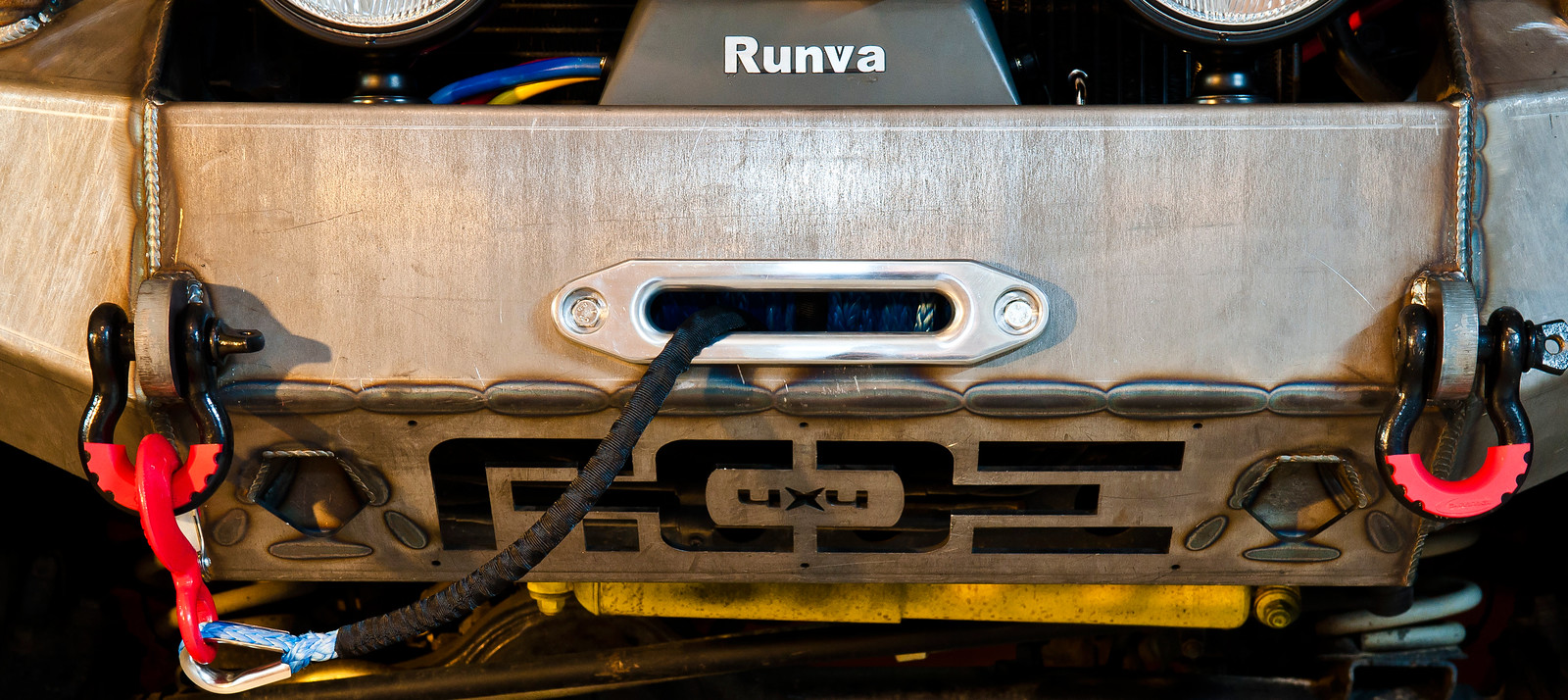

Winch is a Runva 12,000lb beast w/ synthetic line. It was a tight fit! Lights are some 8" Pro Comp and 6" FETs I had laying around. I used some KC mounts for the 6" FET lights. The 60" Hi-Lift jack will eventually find its home on the rear bumper.
If you guys are interested in the bumper, give Alex @ AOE a call. Contact info and a lot more pics of 80s bumpers in here (sift through the various albums)
American Overland Expedition - http://www.facebook.com/pages/American-Overland-Expedition/89641896537

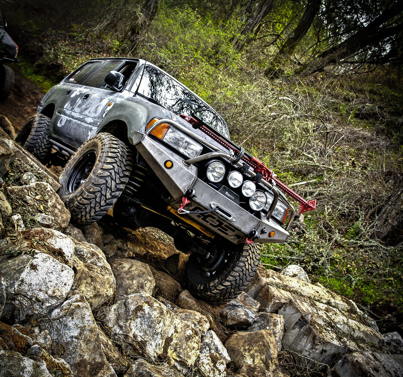

Now that I had the bumper and winch finally installed it was time to go wheeling again. Went to Hollister Hills SVRA park with some new wheeling buddies. Fun times! First time in the park. Did some Black Diamond trails that were pretty intense for my wheeling skills. The rest of the group were some serious wheelers who went through Tank Trap (triple Black Diamond rating). That was the craziest wheeling I've seen! Hollister is an awesome park. Everything from mild to wild. You can wheel a minivan or an exo-cage rock monster on 50” tires and have a blast.
Hollister continued...

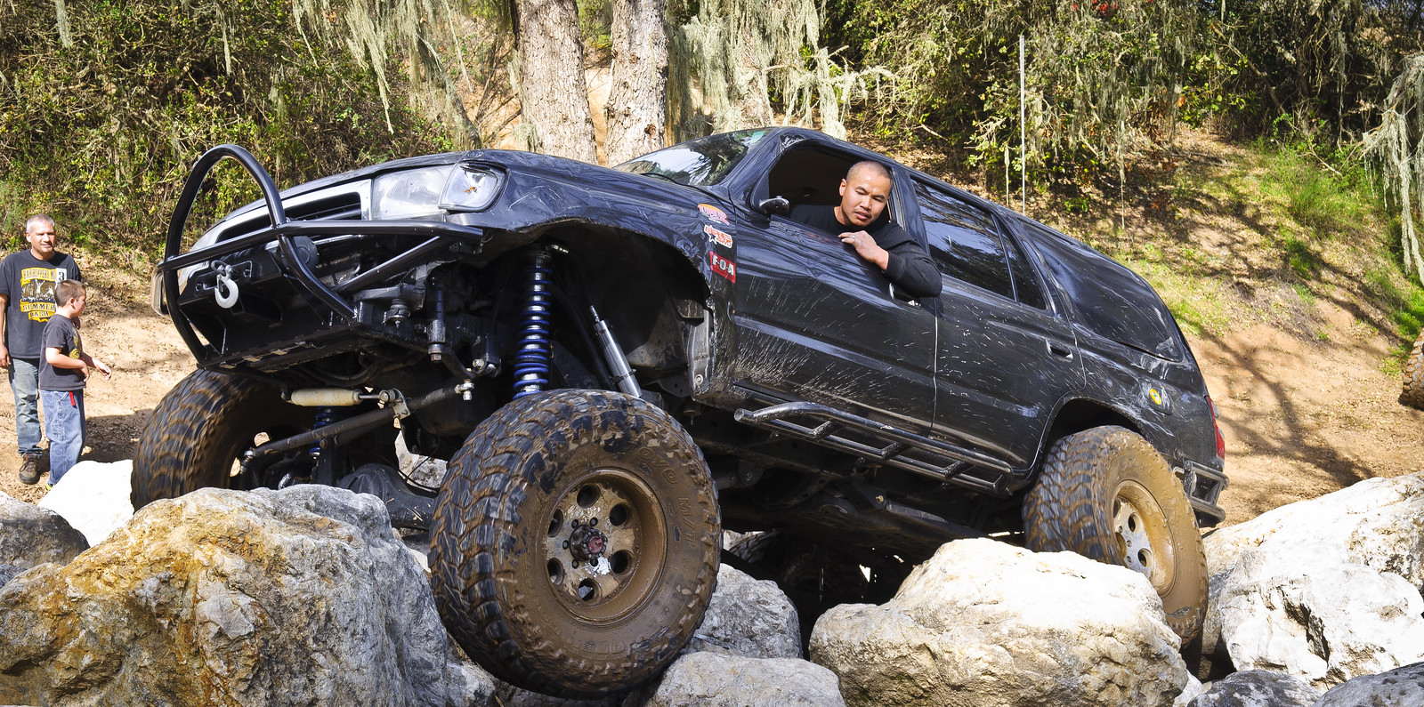

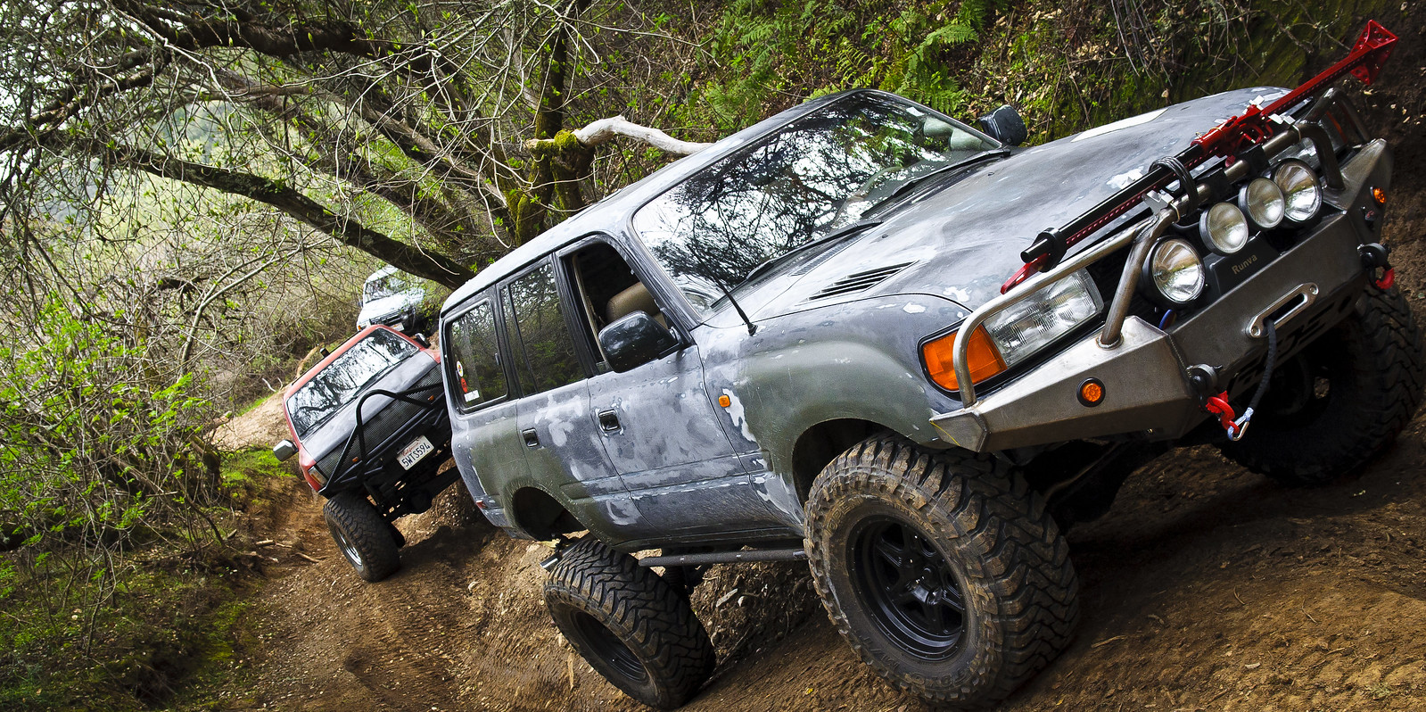

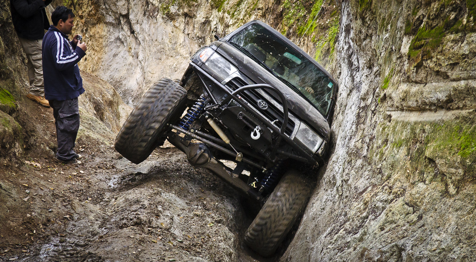

You wanna try Tank Trap in an 80? :flipoff2:
And I received my fair share of carnage too. Nothing serious though. Ended up with a dent in rear quarter panel and almost tore off my mirror. Some of those trails aren't 80-friendly. Need a lot of articulation to avoid sending the body into the walls, and that's something these rigs don't do well out off the box!
