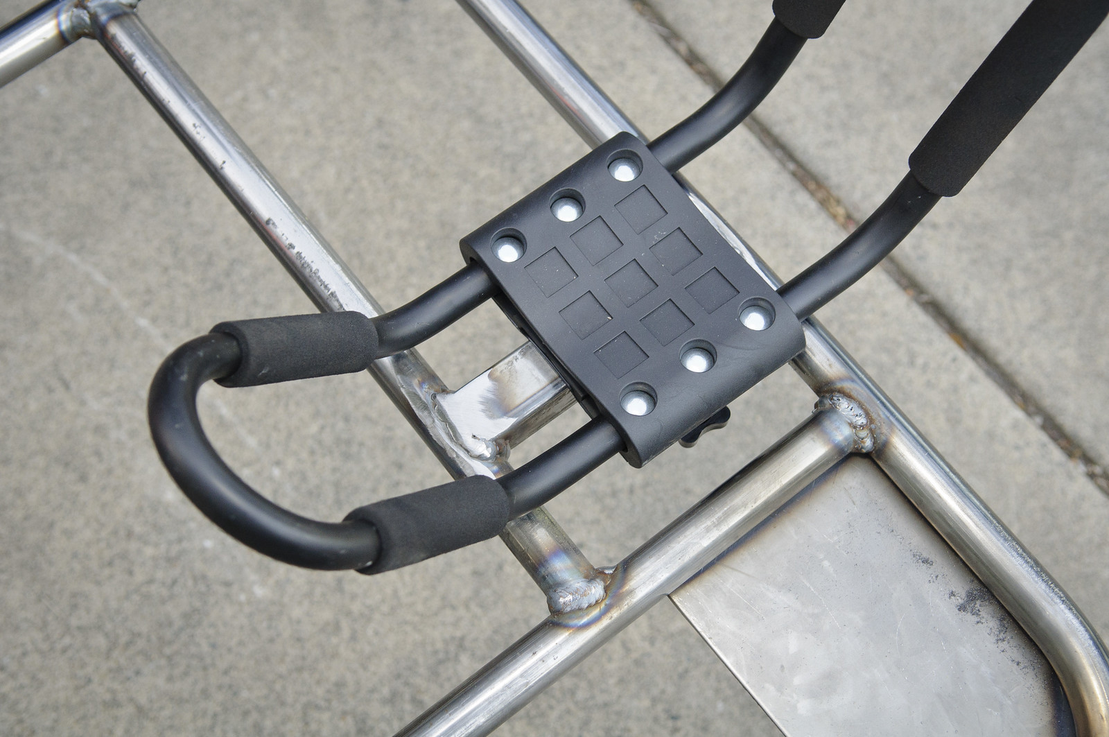

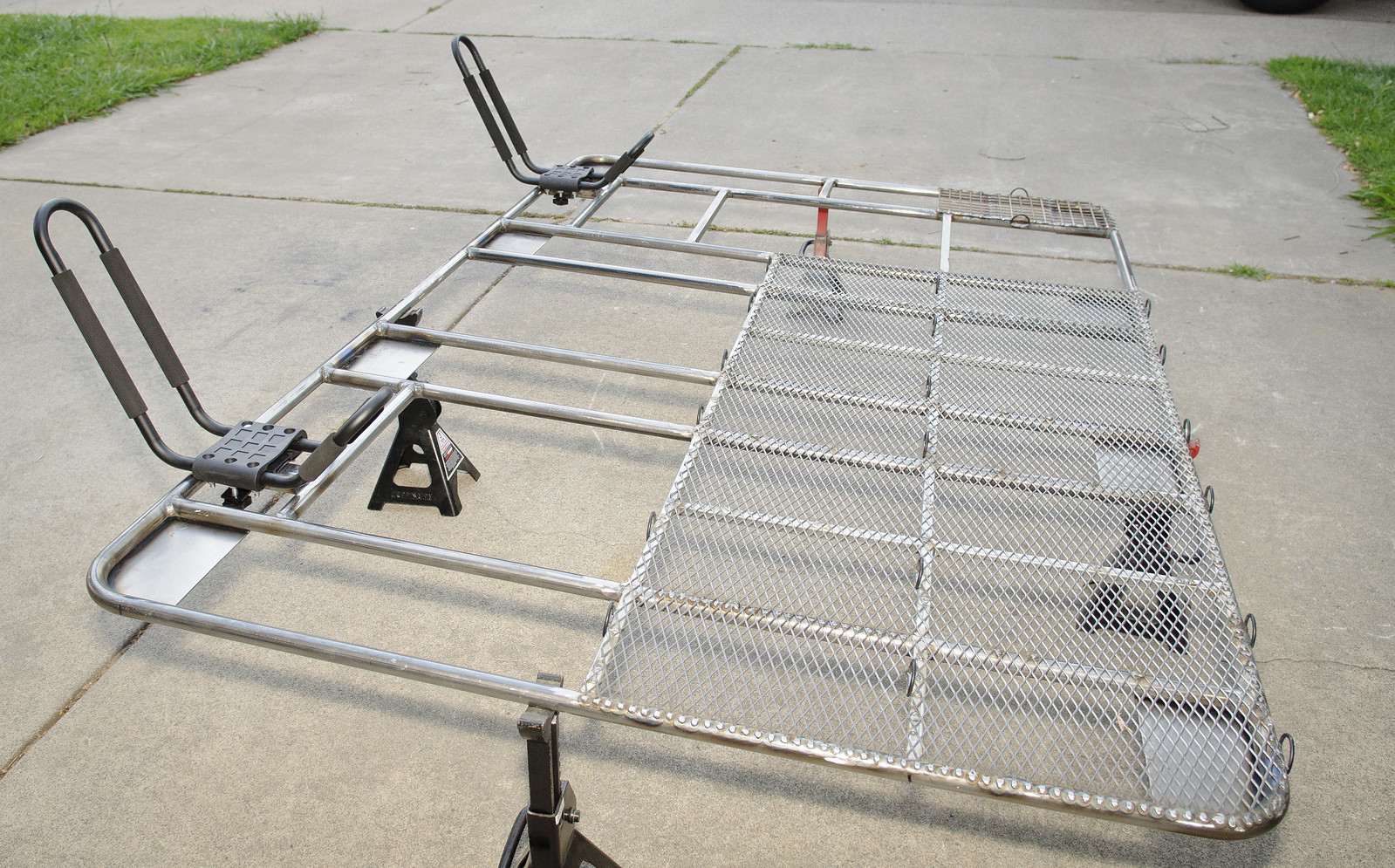

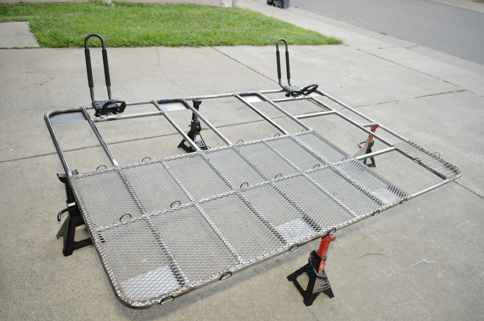

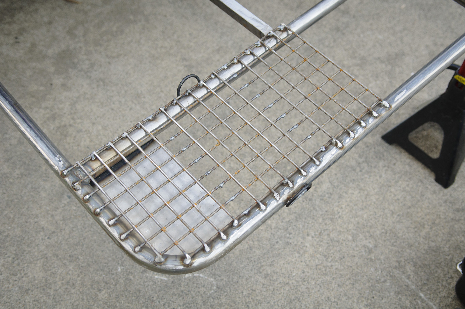

Fast forward a few days and here you see the finished floor with thin-gauge expanded metal, mini D-rings to hold the totes and additional tubing for the kayak mounts I bought on Amazon.

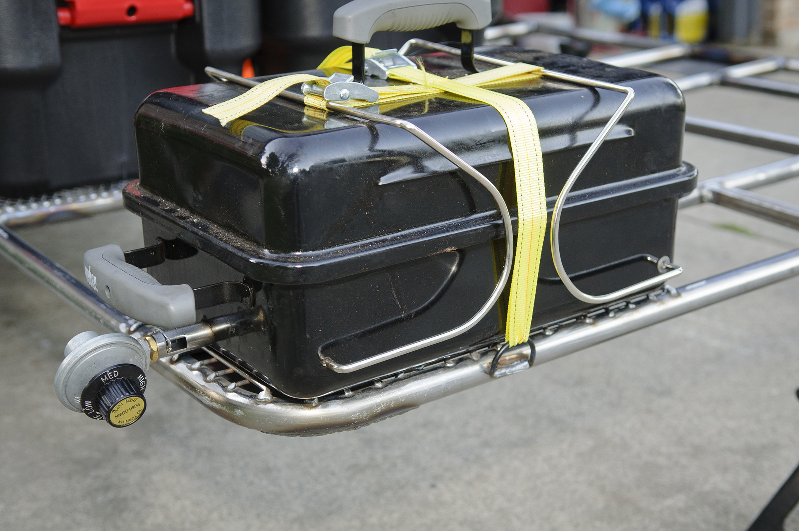

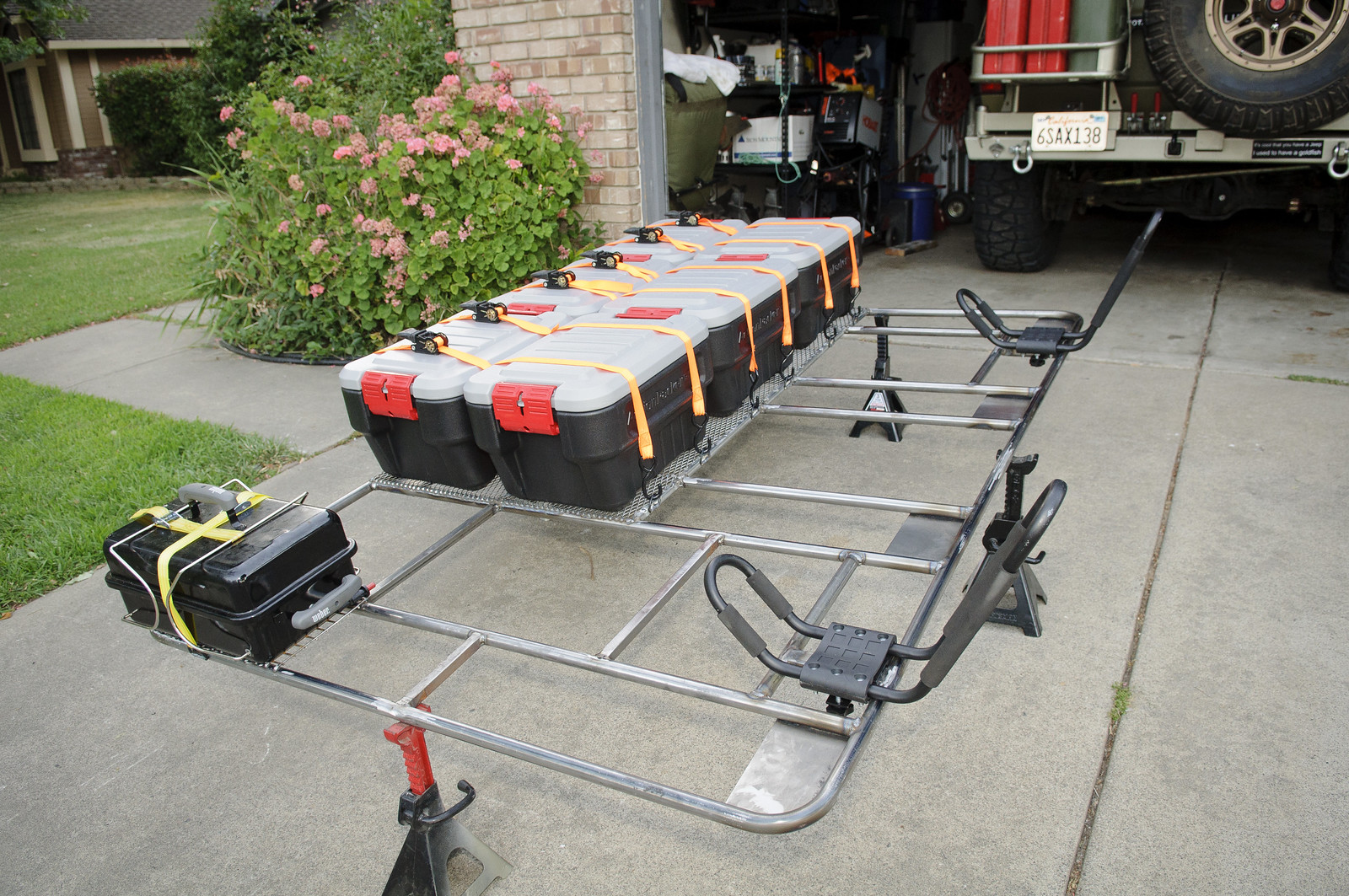

I also made a small floor in the corner to hold my Weber grill

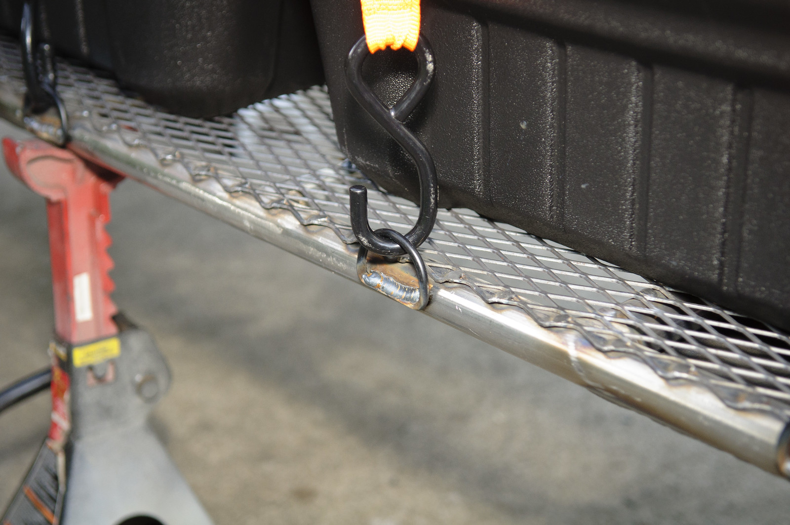

Closeup of the mini D-rings I bought online. Took a bit of searching since most of the stuff out there are giant and rated for thousands of pounds. Too much to hold a few totes.

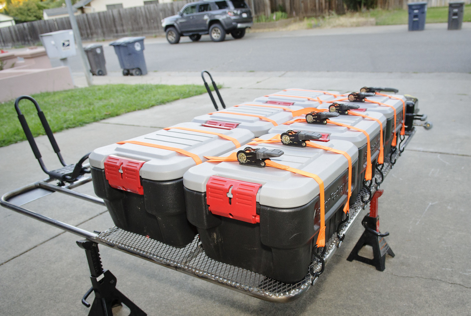

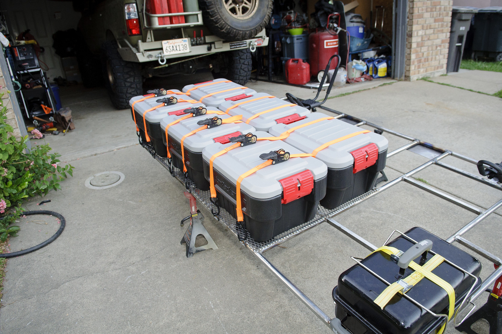

And here's the layout with all six Action Packer totes. I doubt I'll fill all these up but I wanted to future-proof the cargo management. Never know when you'll need the extra space. These things are rock solid and are NOT moving.
And that's it! Easy right? A lot of work, but I saved a lot and designed it exactly how I wanted :cheers:
real quik which mounting plates did you use? Im about to start to burn some wire. they sell two differnet types I need strong for RTT
Plates or mounts? Mounts are low profile Gamiviti. Plates are DIY
My bad I meant mounts, I see to diff versions. this is my first rack so i really want to carbon copy the base of yours.

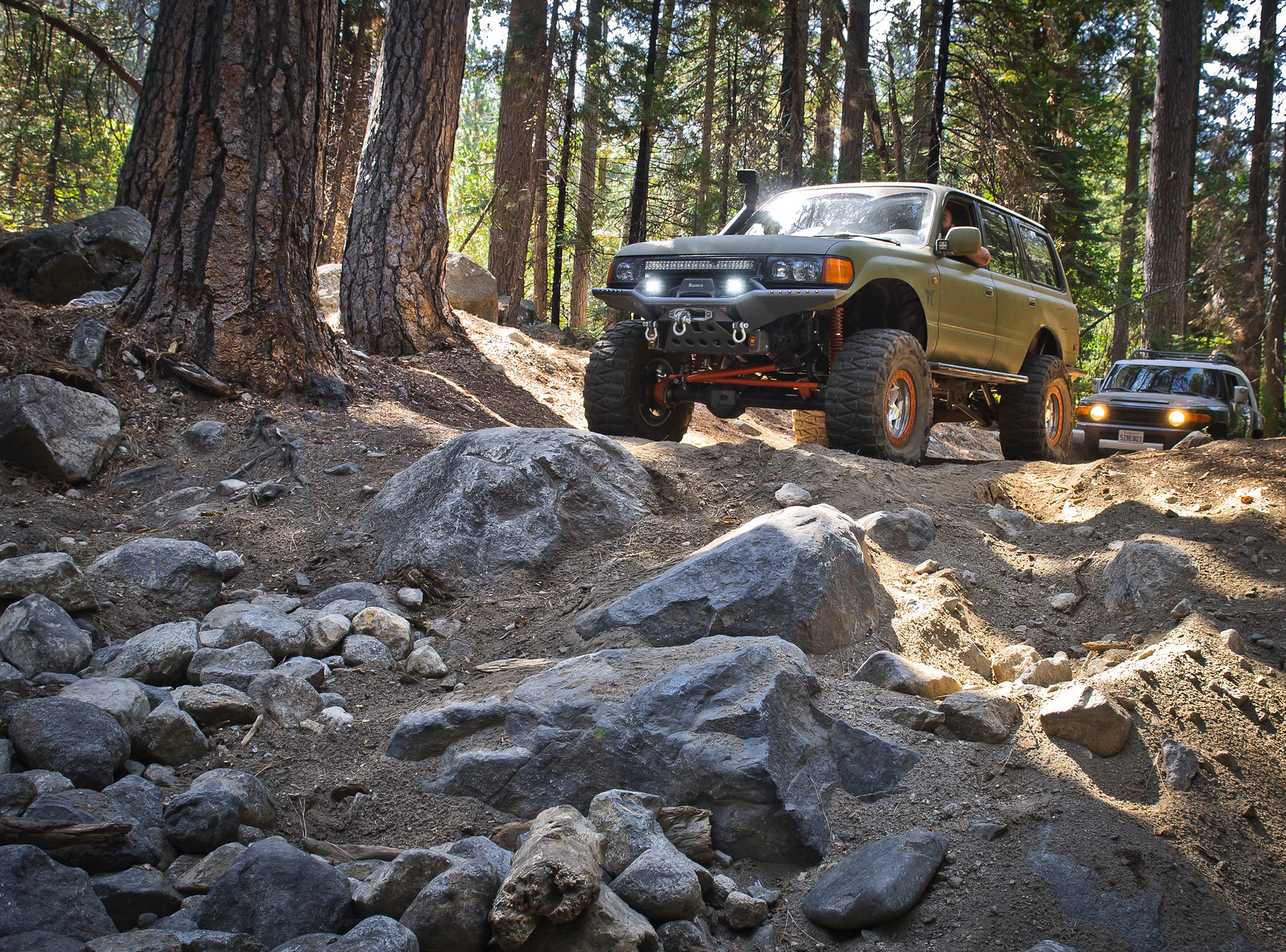

Made a quick run with the brother in law up to Sourgrass. He's new to wheeling so I figured this would be a good trail to get his feet wet. Fun little trail, about 2.5 miles long with enough obstacles to challenge a newcomer. Wish it were a bit longer though, reached the end in about 45min.
You are beond Blessed to live so close to Sierra Nevada Mountains where some of the best wheelin is.
Is Sourgrass the trail they use for the fj45 Run? There is more spur trails is there not?
You camera always take great pictures.
Yup, that's the trail, and thanks! I don't think there are other trails off this one, maybe just some fire roads. But Slick Rock and Deer Valley are just a couple miles east of here.
