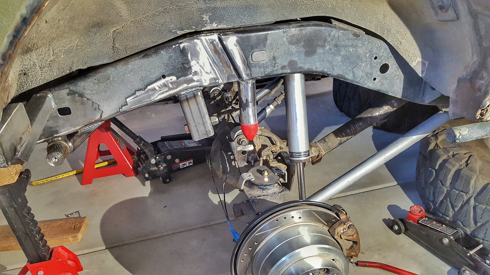

Here is a photo showing how the bar housing is attached to the frame. There will be another piece towards the rear but my jackstands are currently in the way.
I also built a small channel notch into the frame. The more I welded things up the more I started to notice the tip of the arm would get really close to the frame to the point the bolt would get caught underneath the frame. Now the arm has plenty of room with no worries of getting caught. Lesson here is to have them make the shaft about an inch longer overall (they base it on frame width and account for thickness of the arms).
I also built a small channel notch into the frame. The more I welded things up the more I started to notice the tip of the arm would get really close to the frame to the point the bolt would get caught underneath the frame. Now the arm has plenty of room with no worries of getting caught. Lesson hear to have them make the shaft about an inch longer overall (they base it on frame width and account for thickness of the arms).

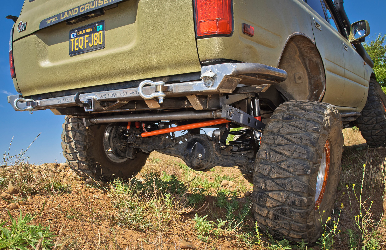

Sway bar project is complete! Still have a few things to button up like adjust panhard, weld one more bracket behind sway bar housing and finish painting, but at least it's driveable. First impressions, this thing is great. My rear bushings are original and in really bad shape. I can feel the axle 'rear steer' a bit and feels a bit loose in the back. I have a new set of poly bushings I'll be installing shortly. Even with the bad bushings this sway bar made a big improvement in road manners. I still get body roll obviously because I don't have a sway bar up front, but the difference was immediately noticeable. The body movement is a very firm, controlled sway and feels controllable while jerking the wheel back and forth at about 40mph. I'm sure that with a splined sway bar up front this thing would drive really really well.

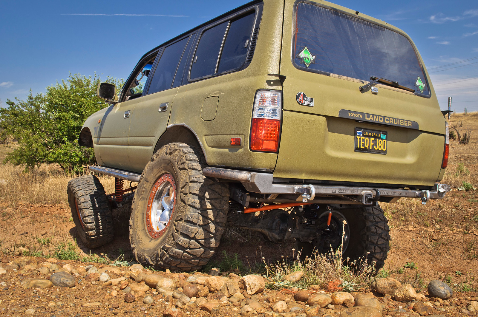

1.5". Probably wouldn't have room for the sway bar with anything less.
Just for posterity - and as you know but for anyone stealing this idea for themselves - you're also running wider wheels with less backspacing. For a lot of people, this could be considered equivalent to a 2.25 or 2.5" wheel spacer on oem wheels. Something to consider as far as packaging goes
