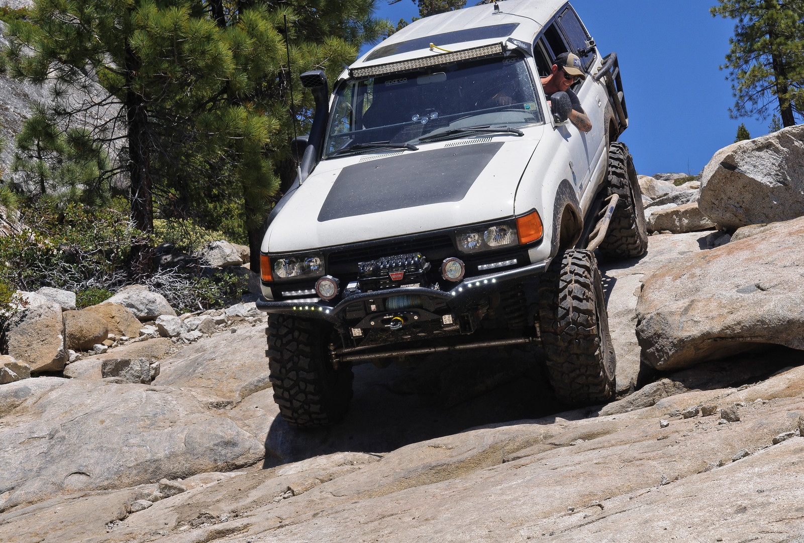

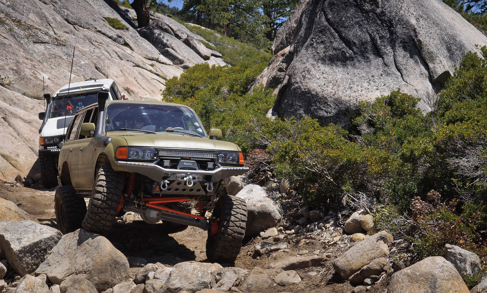

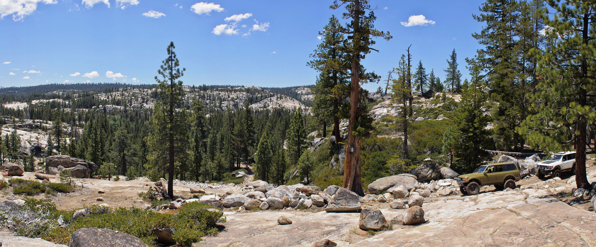

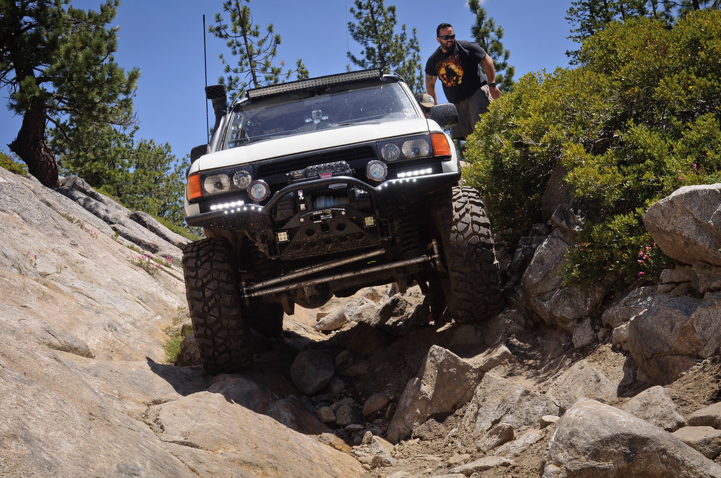

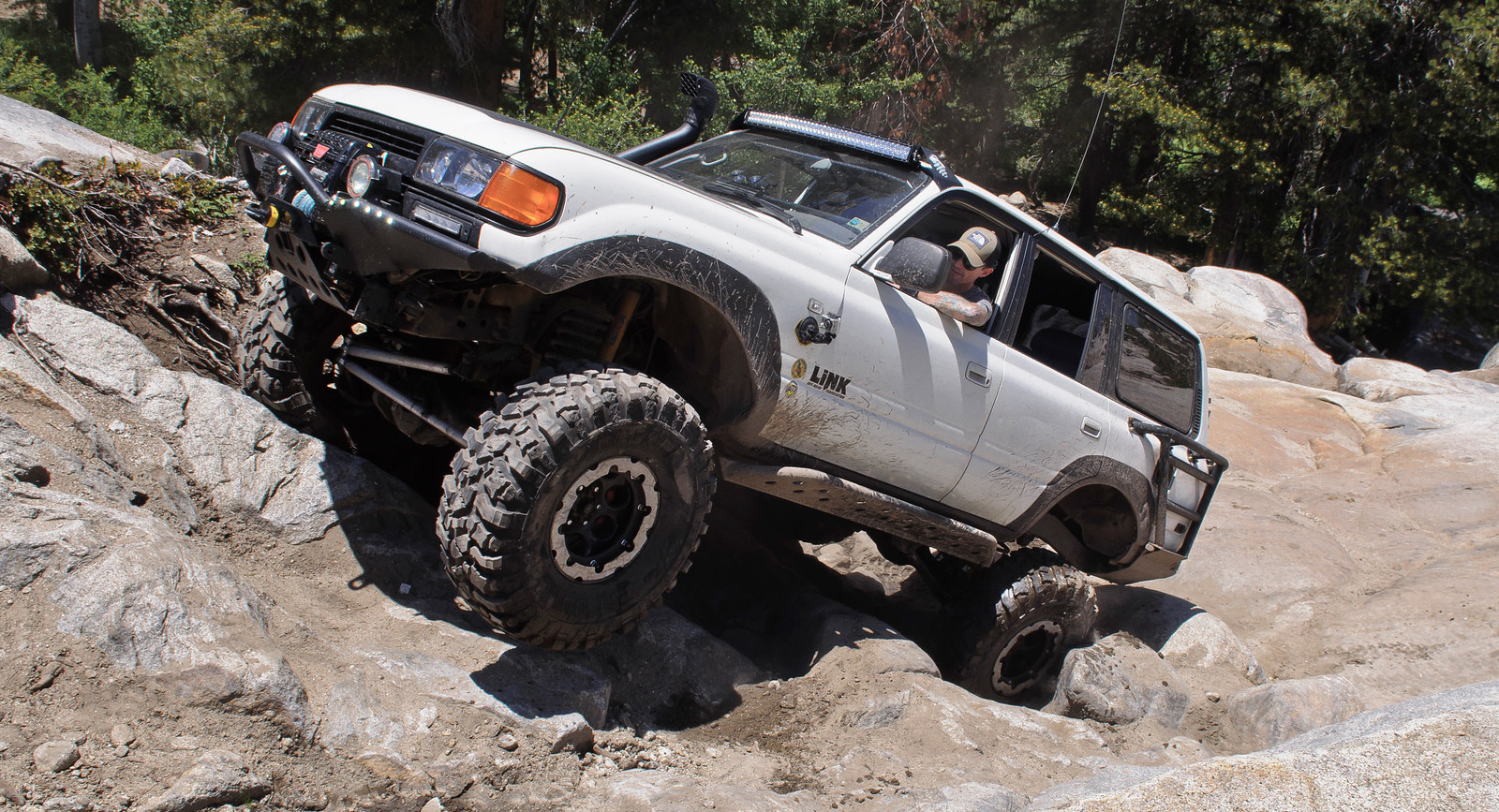

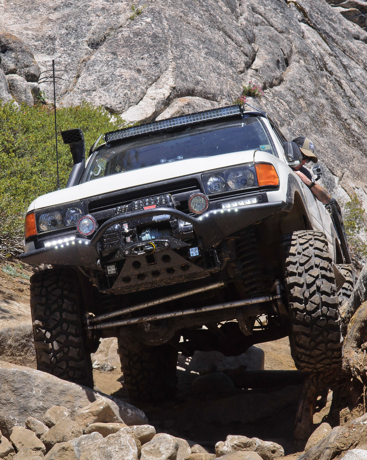

@AMMO and I did another quick day trip to Slick Rock. Haven't been to this trail since 2012, the summer I bought my 80. Trail sure seems like it's gotten worse. A lot more chewed up and dug out since my last visit. That actually made it fun! Pretty quick run, made it from Alpine to Utica in about 2.5hrs and that included waiting for traffic on the Staircase.
First real obstacle, slope walled canyon
Top of "Slick Rock" road. Really steep descent. Towards the bottom you can be standing on the brake pedal and the truck just slides. Good times

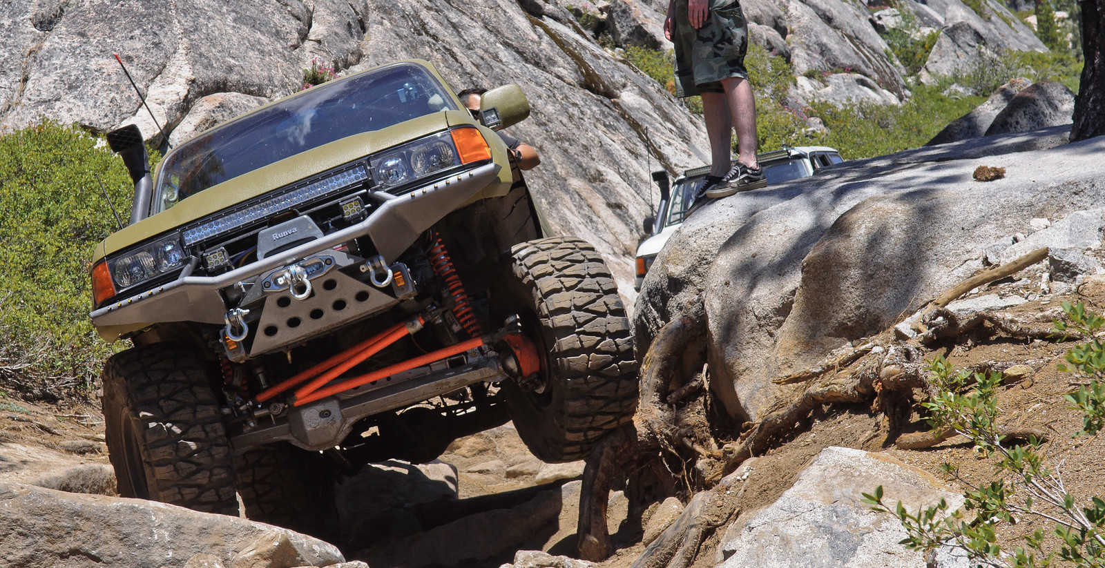

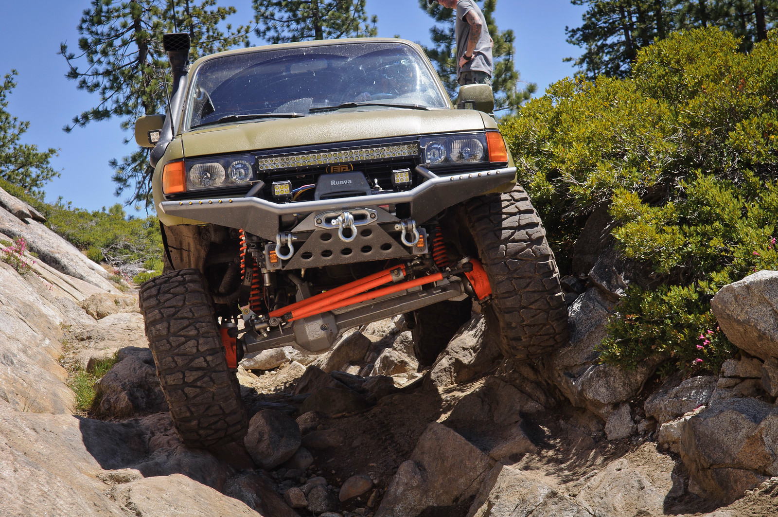

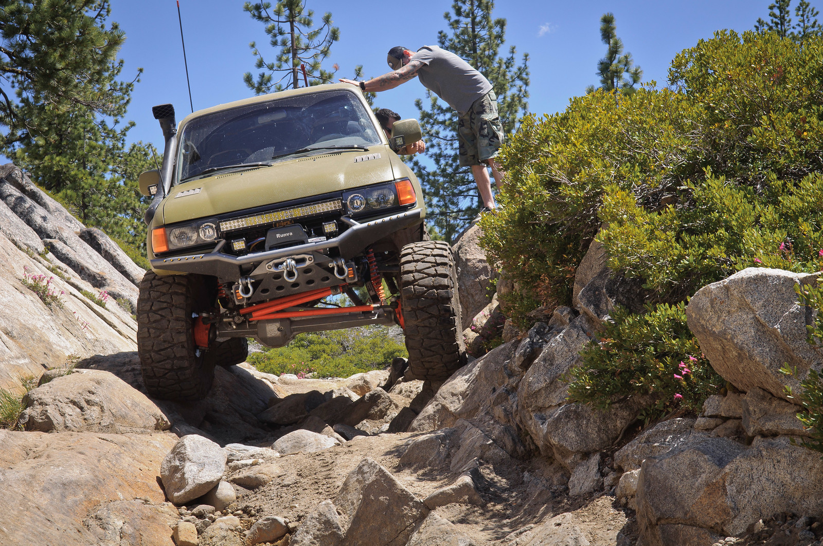

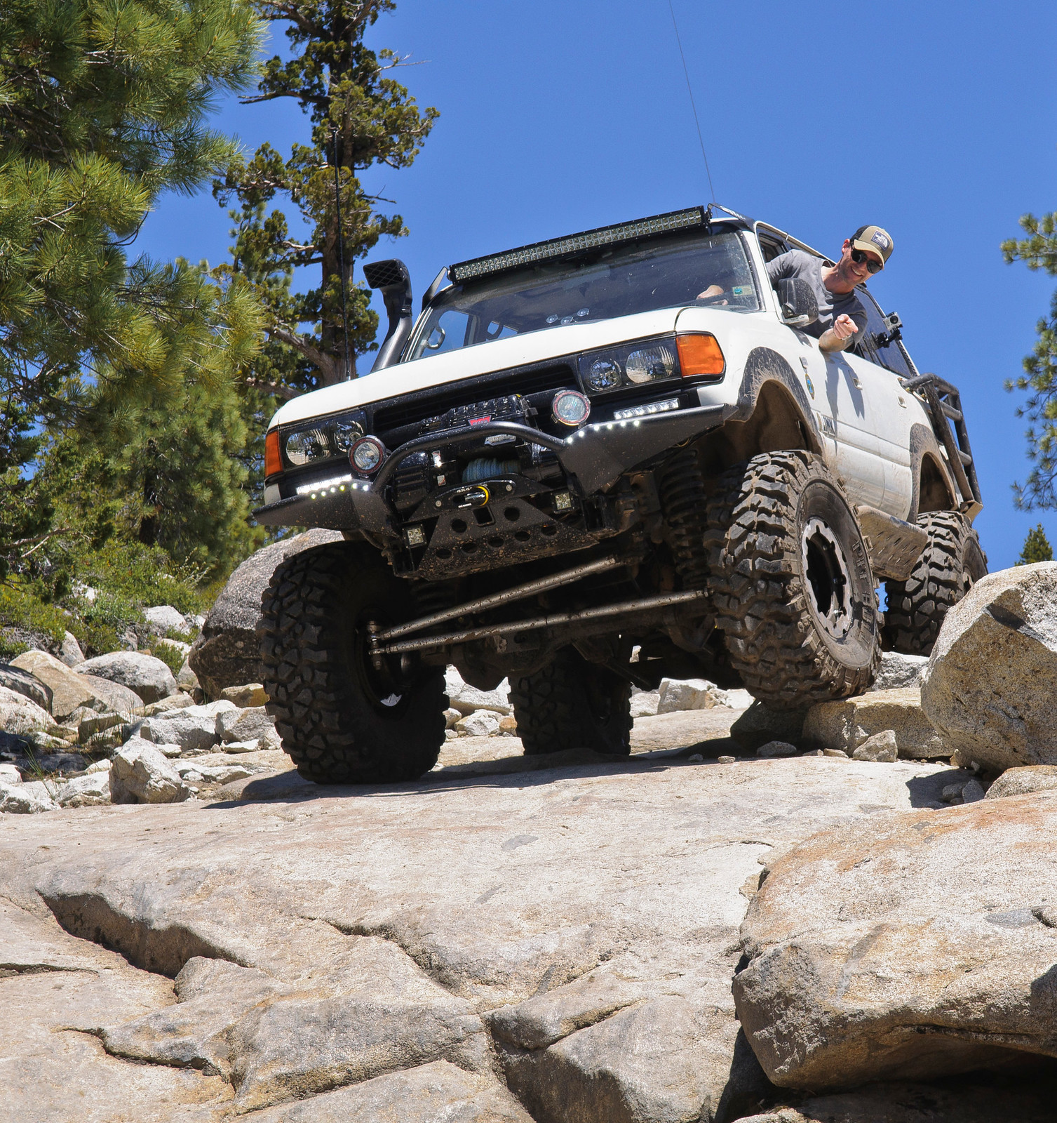

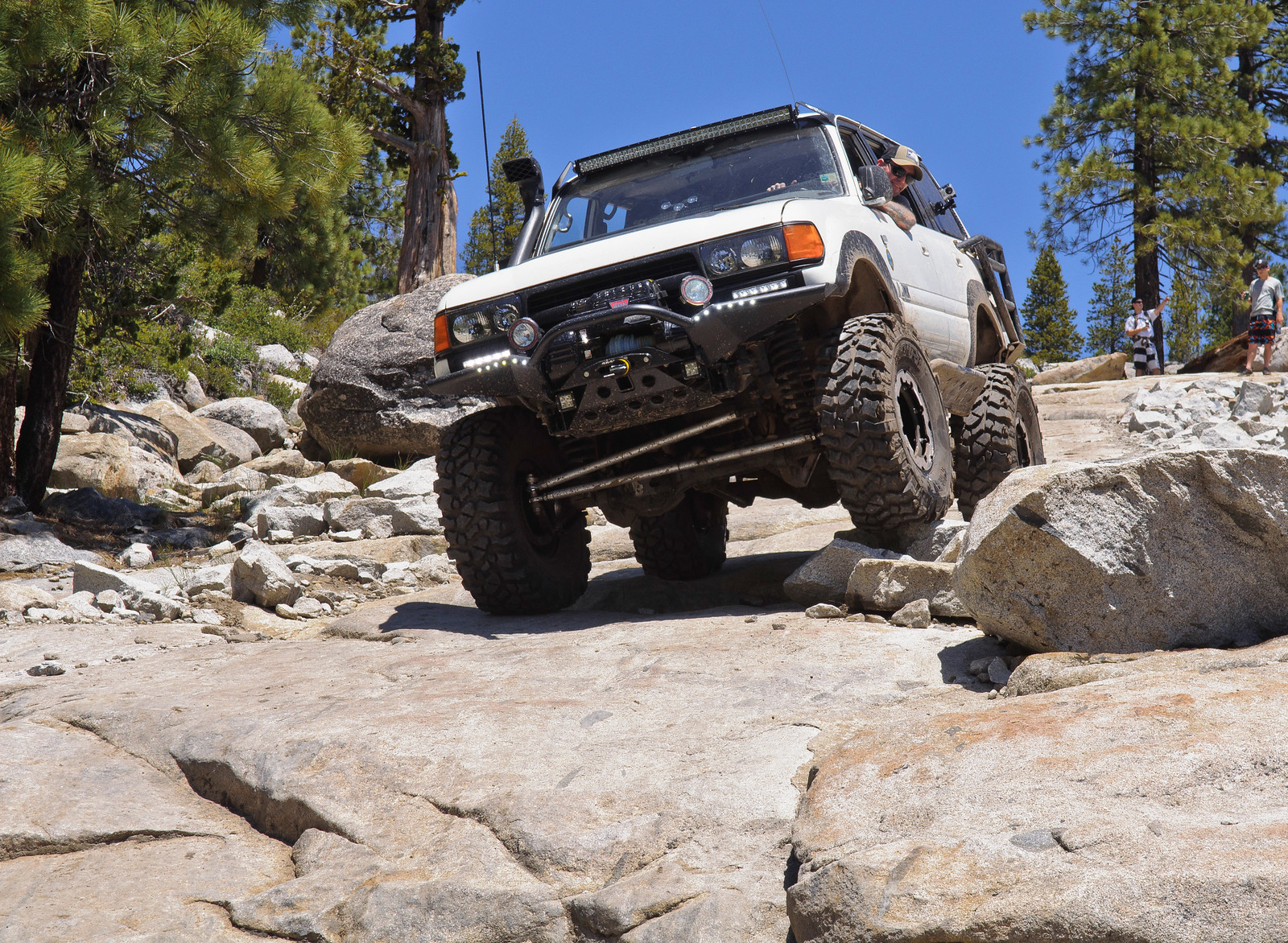

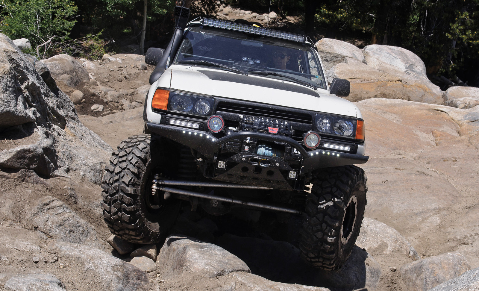

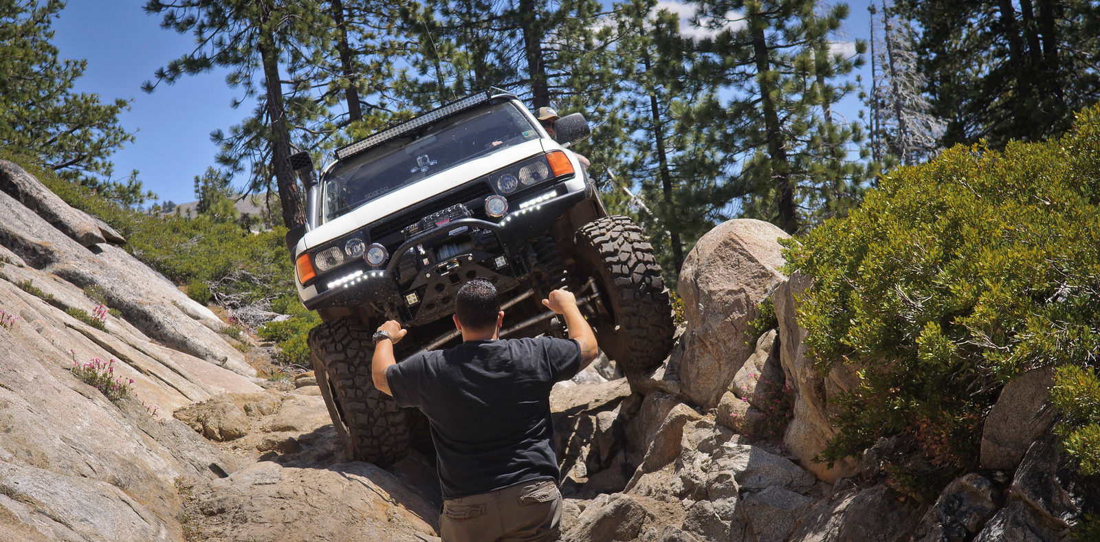

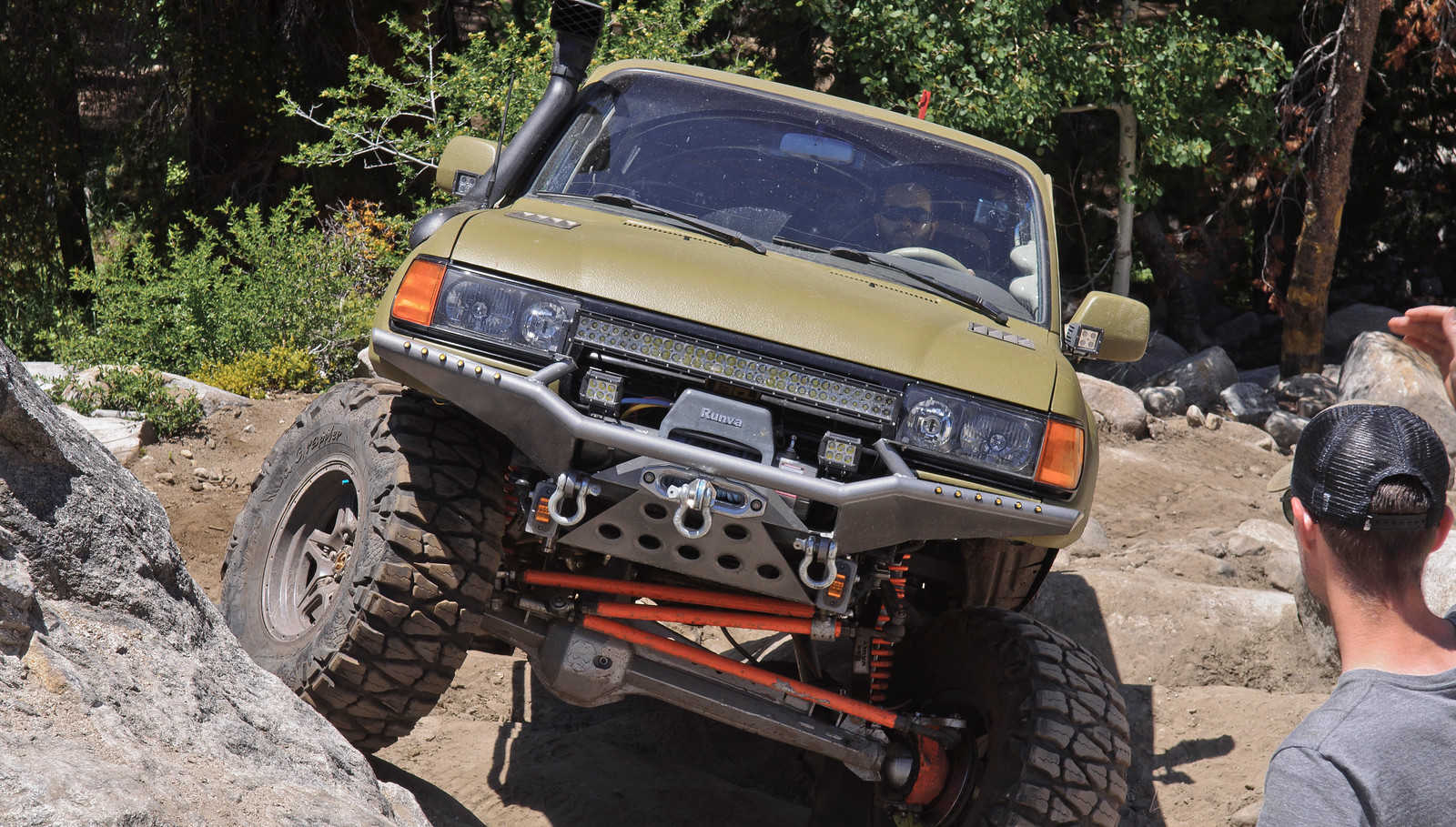

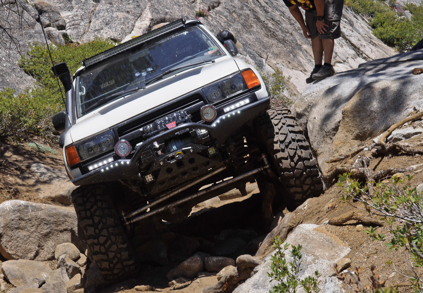

I wanted to point out also for those 3 link "na sayers"
If you watch the staircase vid, and notice in this staircase pic I lifted my front drivers several times taking basically the same line as Jose...
He never lifted a tire.
Tires in the air look cool, but provide no traction....
