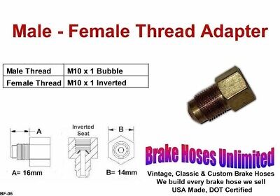

Are you going to use a metric Wilwood proportioning valve? If so, can you explain
and show your setup? Specifically what adaptors did you use? Where did you source the bubble fitting adapters?

Thanks! And yes, I've actually always had the Wilwood prop valve since I deleted ABS and the LSPV years ago. For the first setup I simply cut and reflared the lines in a bubble flare. But since I'm redoing everything now again I used these bubble-to-inverted flare adapters:
