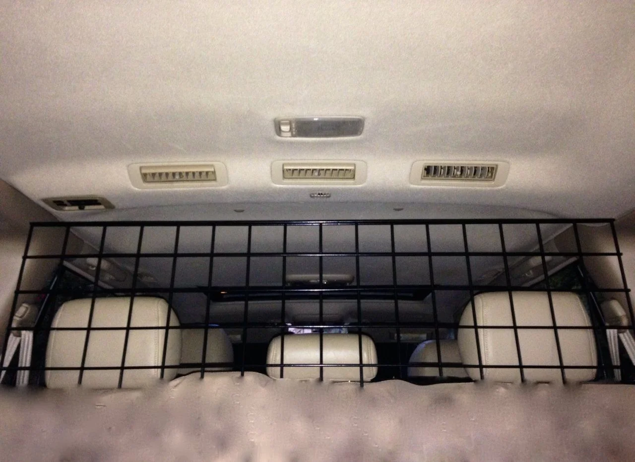

Have you thought about buying another grid, cutting it in half, and welding it to the first one to create a 'barrier' between the passengers and tools (picture below) in case of an accident?
With all the gear and its weight in the back the grid would have to be a pretty heavy gauge steel to hold... but if properly installed it would work sweet.
then you could mount more to the vertical grid too
I have. Been thinking about this a lot lately. Thought about buying a Raingler net. But $200 for a net is absurd. Then thought about building a Speski-style barrier, then another grid like you mentioned. Still not sure which route I'll go, but I do want to add something. Would work good as a dog barrier too so I don't have to keep my a****** mutt leashed, he'll have his head over the seats the whole time and make a slobbery mess. For simplicity's sake I think I just may get another grid like you described. But I'll need to figure out how to mount it. I don't want to weld it so it can be removed. I'll also need to figure out how to mount the lower portion of it.
Not necessarily. You'd be talking about the perfect storm where the whole grid broke loose and all tools went flying forward. That is highly, highly unlikely. Worst case scenario would be one tool breaking loose.
I was planning on buying another one and mounting it to the first by 4 door hinges. This would allow it to fold up toward the rear if I needed to put something back there and I was in one of the seats, but the headrest would stop it from folding toward the front so it would protect you from everything that is back there in case of an accident. Of course now I have to think of a latch system so it doesn't just swing back and forth with every rock I roll over......but just an idea!

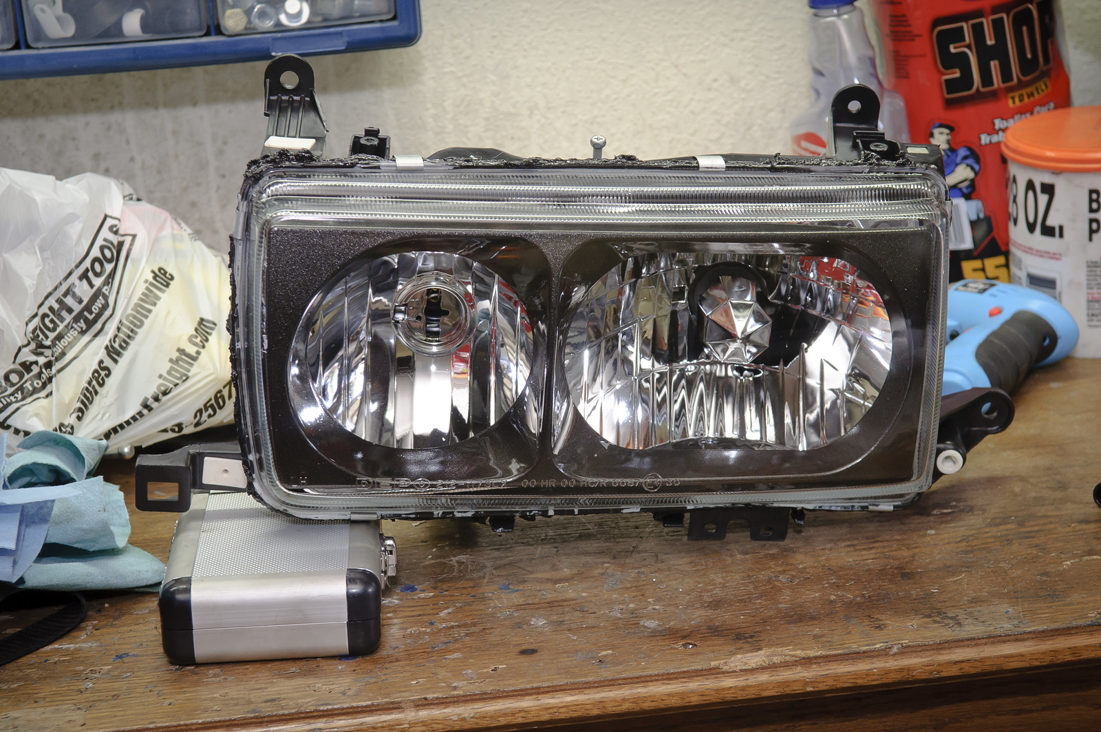

Started with a set of shiny new Depos from eBay. These things are nice! Only complaint is the mounting tabs feel even weaker than the stock plastic. Very bendy. I hope these don't crack as easily. These really should have some sort of metal backing at the very minimum.

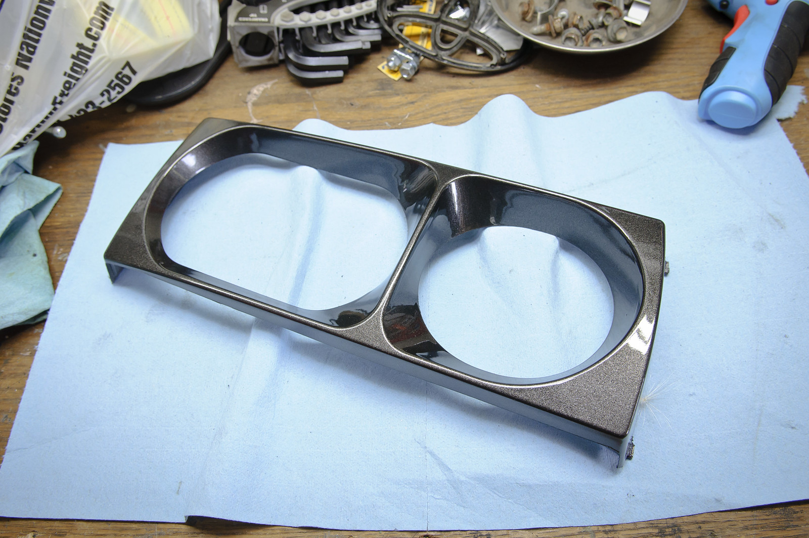

And of course, I can't leave anything alone. While the Depos look great, they're way too shiny. Remember, chrome is for faucets. Not trucks. Got to work with the heat gun and tore these bad boys open.

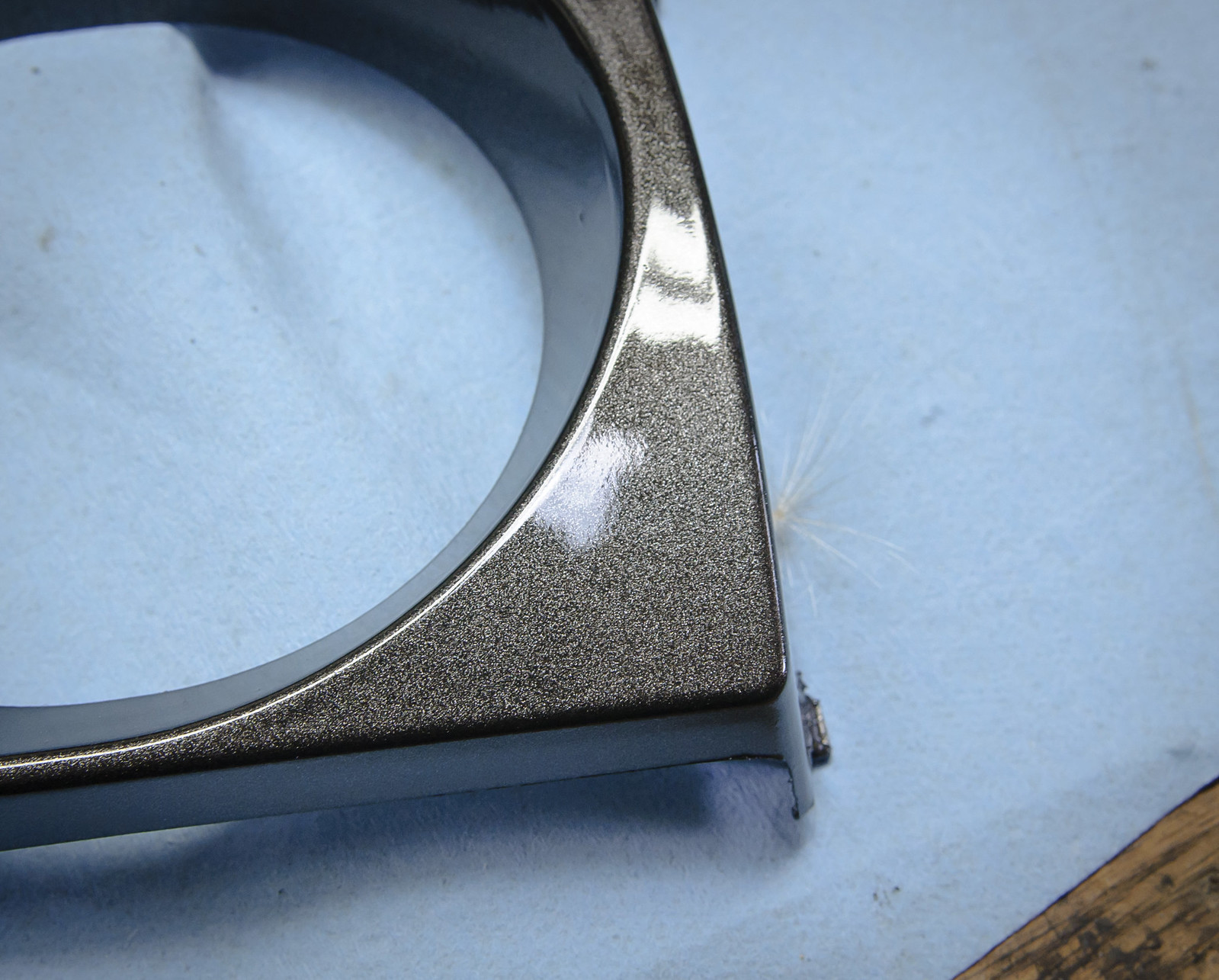

Scuffed, prepped and painted. Color is Rustoleum metallic "Black Night".
Purtty
Before closing them up I ran a bead of black silicone to make sure I don't get moisture inside. After letting it dry I cleaned up the excess.

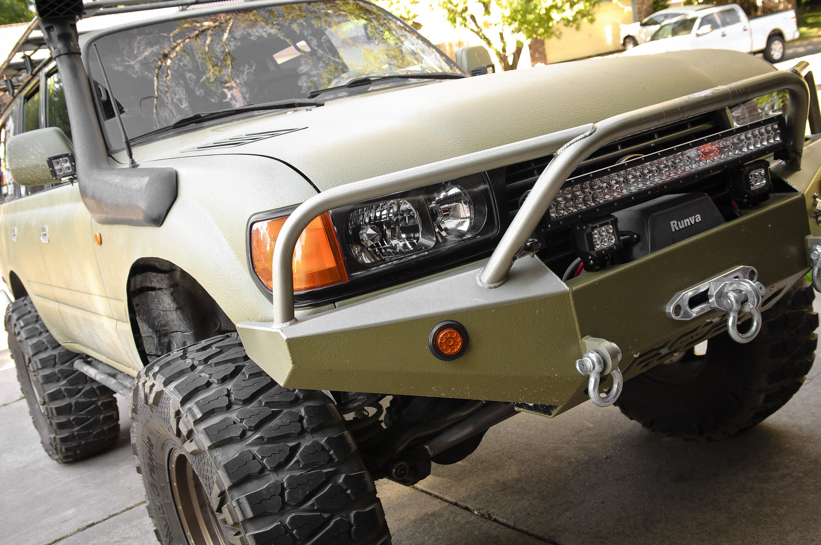

Installed! Huge difference. Makes it look like a whole new truck. Should look really sharp once I paint the bumpers dark gray.
Vs the 90s look :)
Dang Dude!!! That looks mean! I like it ;-)
Love the new lights. I have a few questions though. Are the lens made of glass or plastic? The OME lights appear to be a very durable hard glass. do you think the new lights will hold up? Also what are you going to do about the corner lights? Clear with yellow bulbs?

Thanks! They're glass just like OEM. Really well built. I just don't like mounting tabs. But they suck on OEM too. Stick with the Depo brand. All the other eBay flea market headlights look like the crappy plastic type that leak and turn yellow after a few months. I've always stayed away from aftermarket headlights because they're such terrible quality but these Depos are a nice alternative.
Corner lights I'm going to leave amber. I like the amber look, matches with the side markers and turn signals.

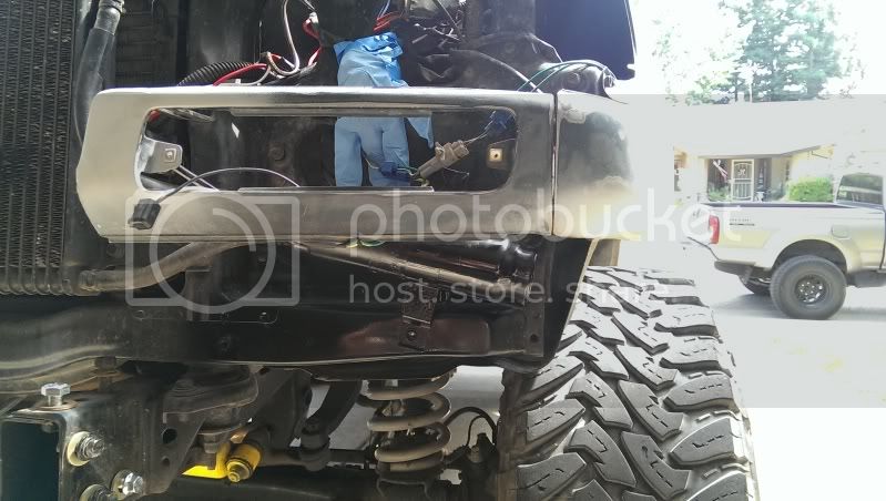

Thanks to the tips provided by TYM4FUN and FJFOOL and I finally have this damn dryer out of the way. Prior to this I pushed it up a few inches and cut of the lower part of the bracket but it still hung too low, especially since I have very high-clearance AOE bumper. The dryer stuck out below the bumper.
Since everything is taken apart for paint it made it real easy. Slowly bent the lines to rotate the dryer counter clockwise until the bolt hole on the left side of the bracket lined up with the mounting hole on the right side. Easy as pie!
Pics make it easier to visualize what I did.

Did you just use the one bolt to hold the bracket in place or did you use somehthing to hold it in up top too?
