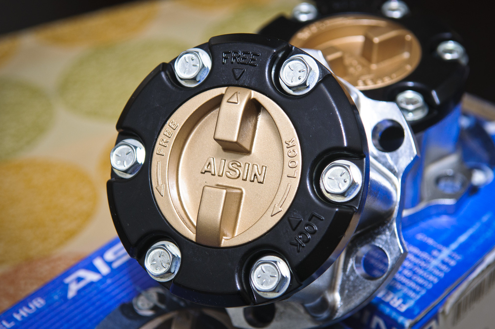

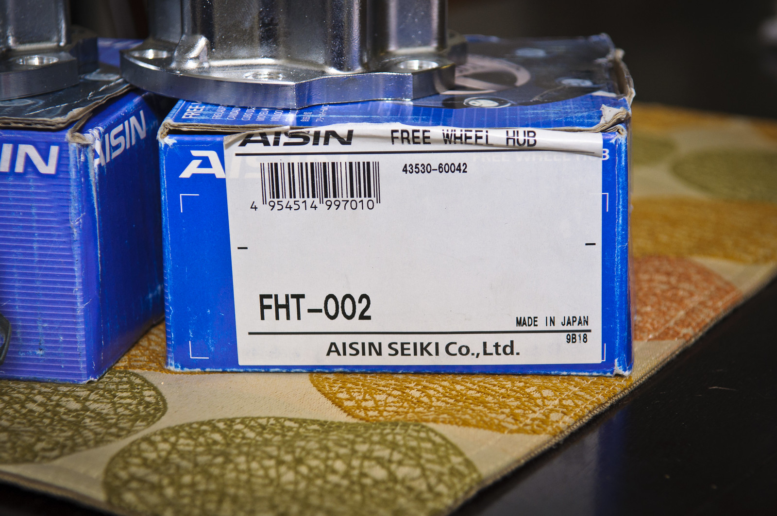

PART-TIME HUBS

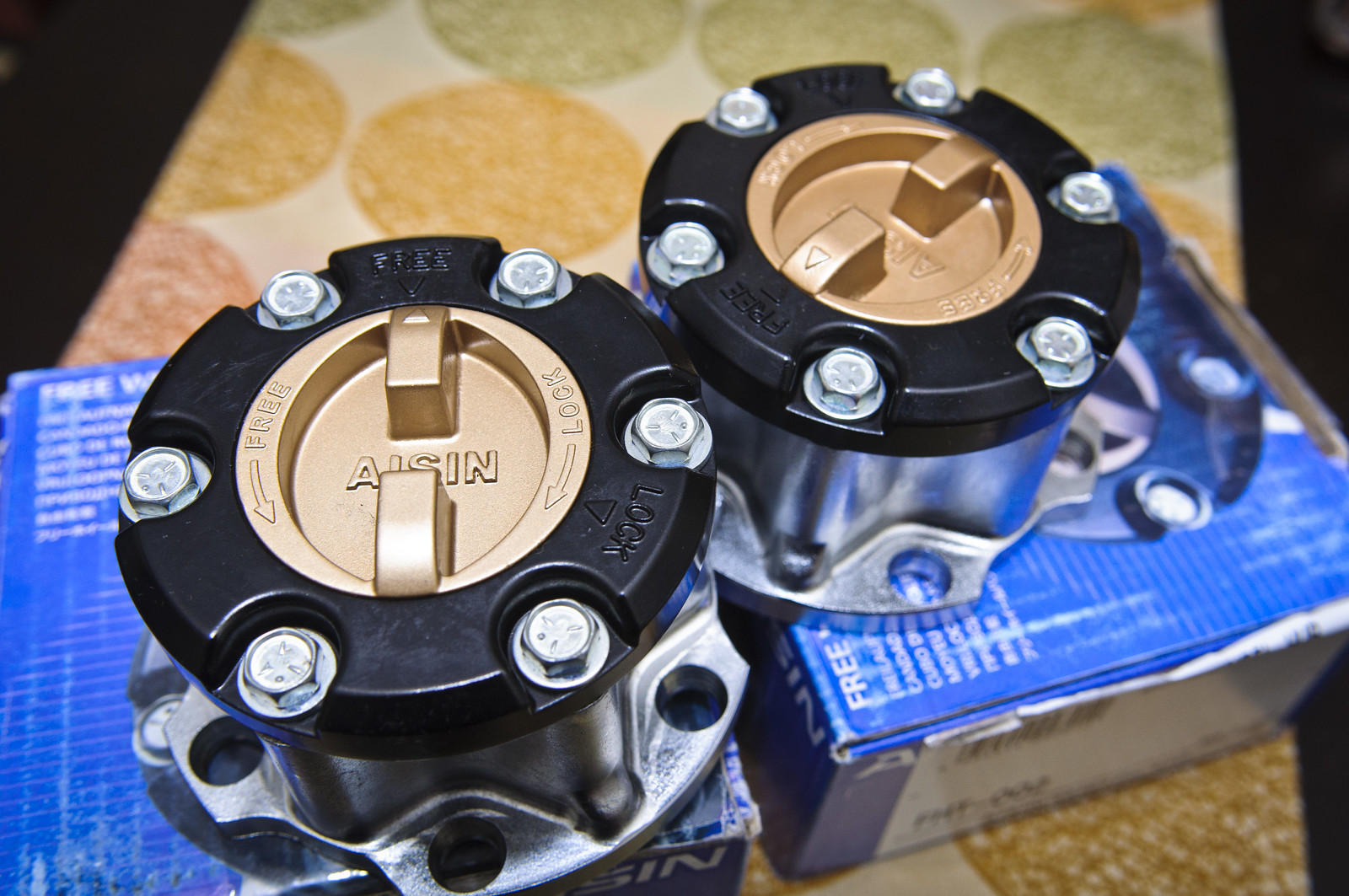

In preparation for my part-time 4x4 kit I decided to start off by picking up a set of the Aisin 43530-60042 hubs that are a direct fit for our 80s. Only thing I'll need to do is machine a new groove in the birf since I have the longer ABS style. I'll worry about that after I purchase the spool. In the meantime, these are getting stored in the parts cabinet until I'm ready.
At $126.50 each, plus a 5% discount (use code IH8MUD), you can't ask for a better deal http://shop.cruiserparts.net/index.php?main_page=product_info&cPath=2731_2720&products_id=24443
what part time kit you going with?

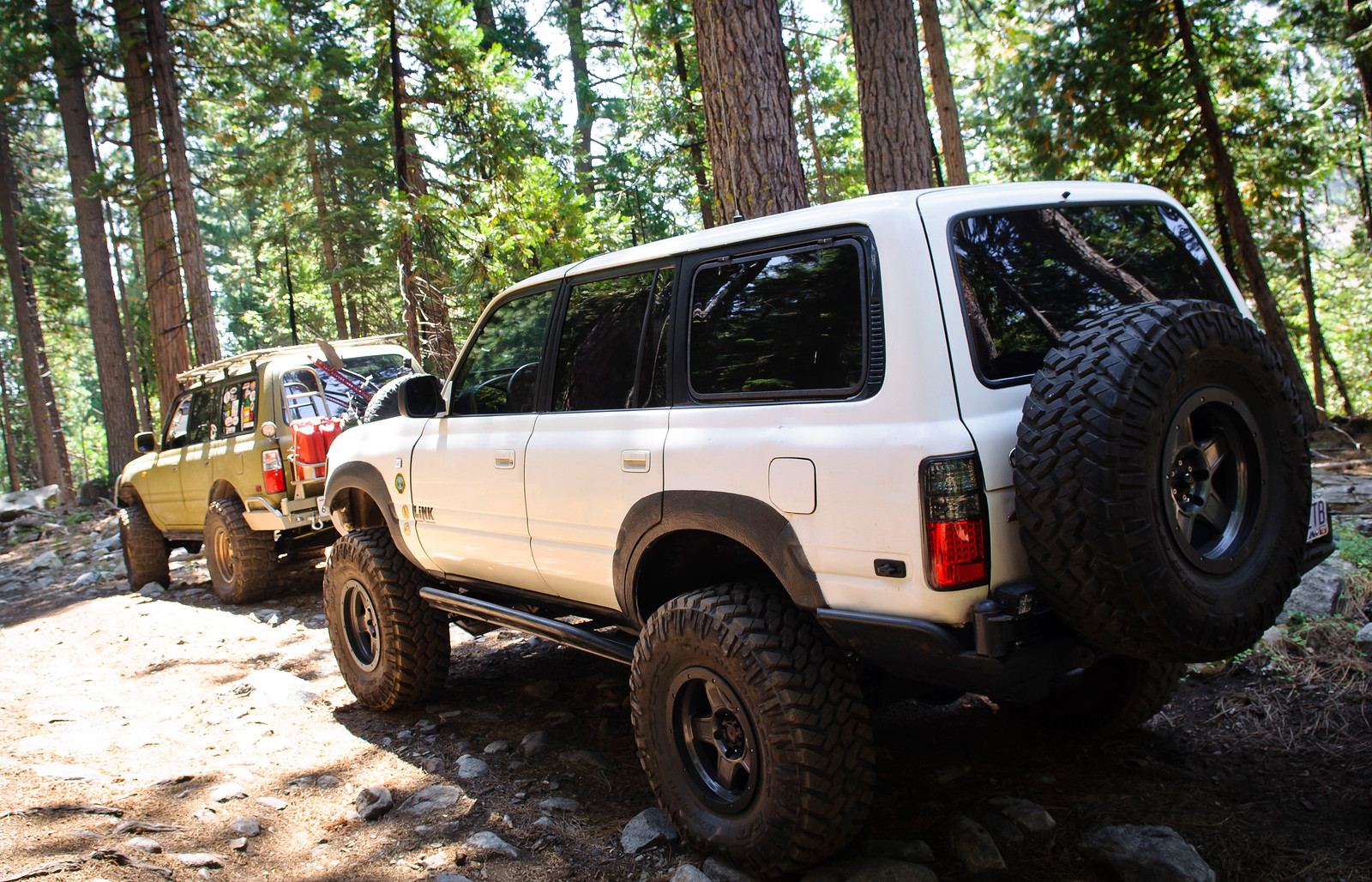

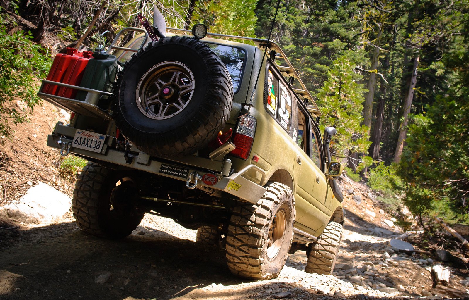

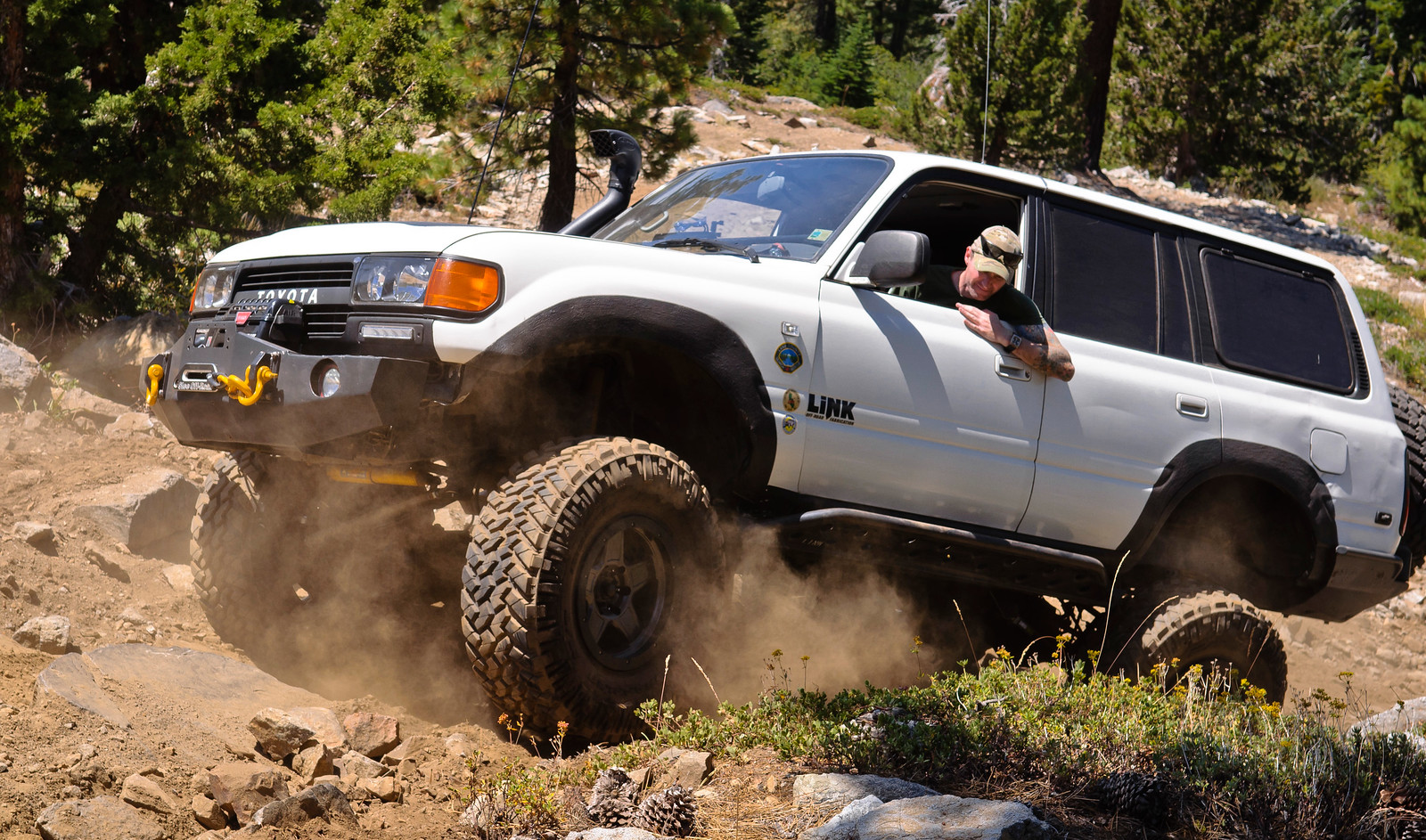

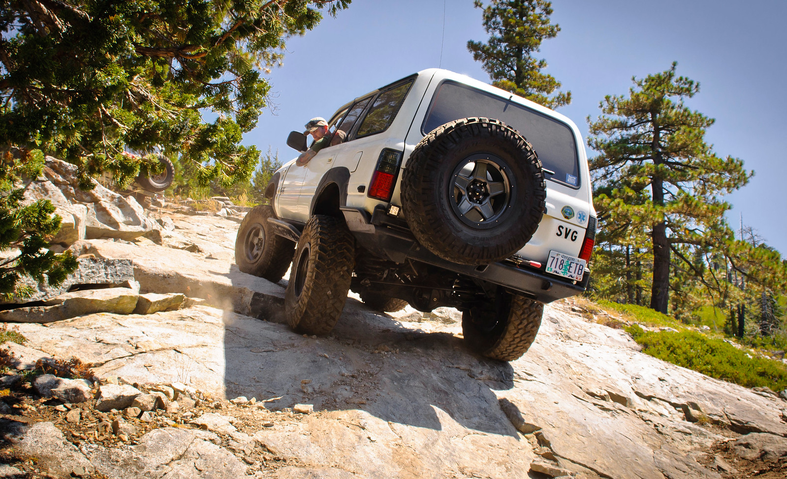

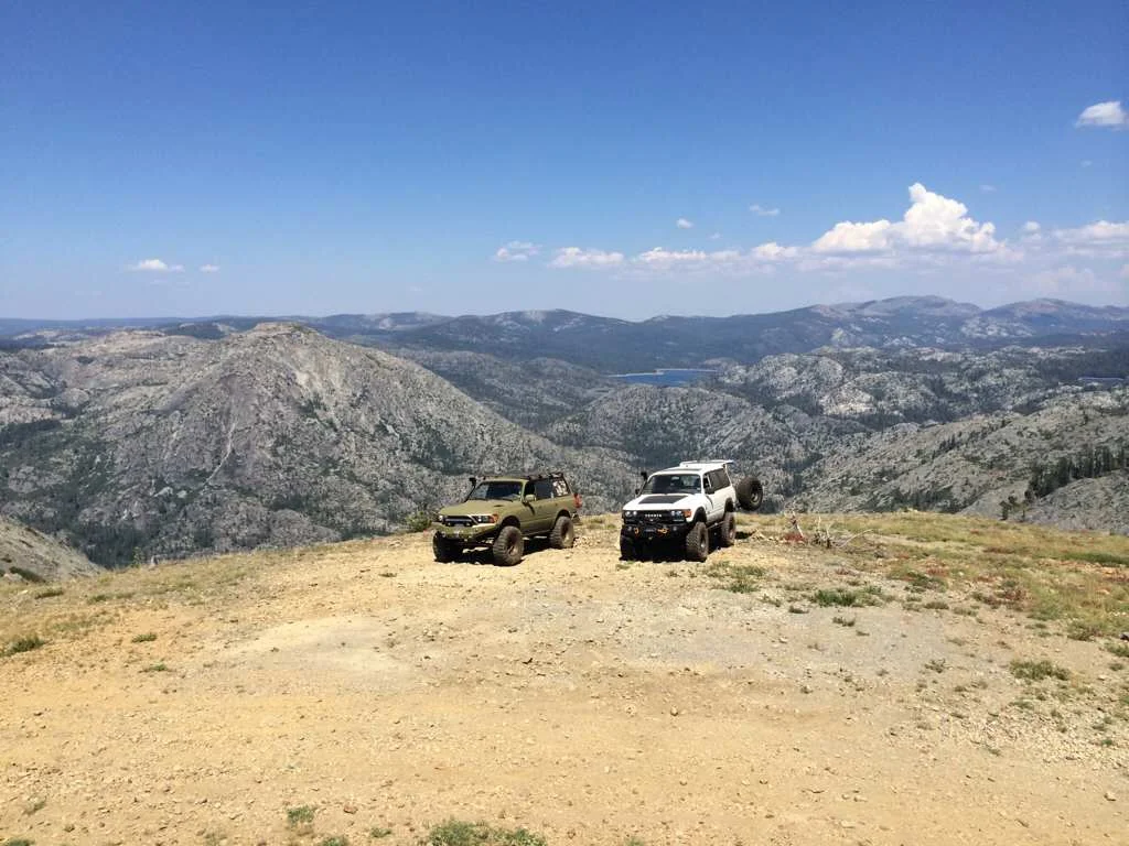

Made a quick day run to Signal Peak yesterday to welcome @AMMO and his bad ass rig to northern California. Good times Matt, need to plan the next trip :cheers:

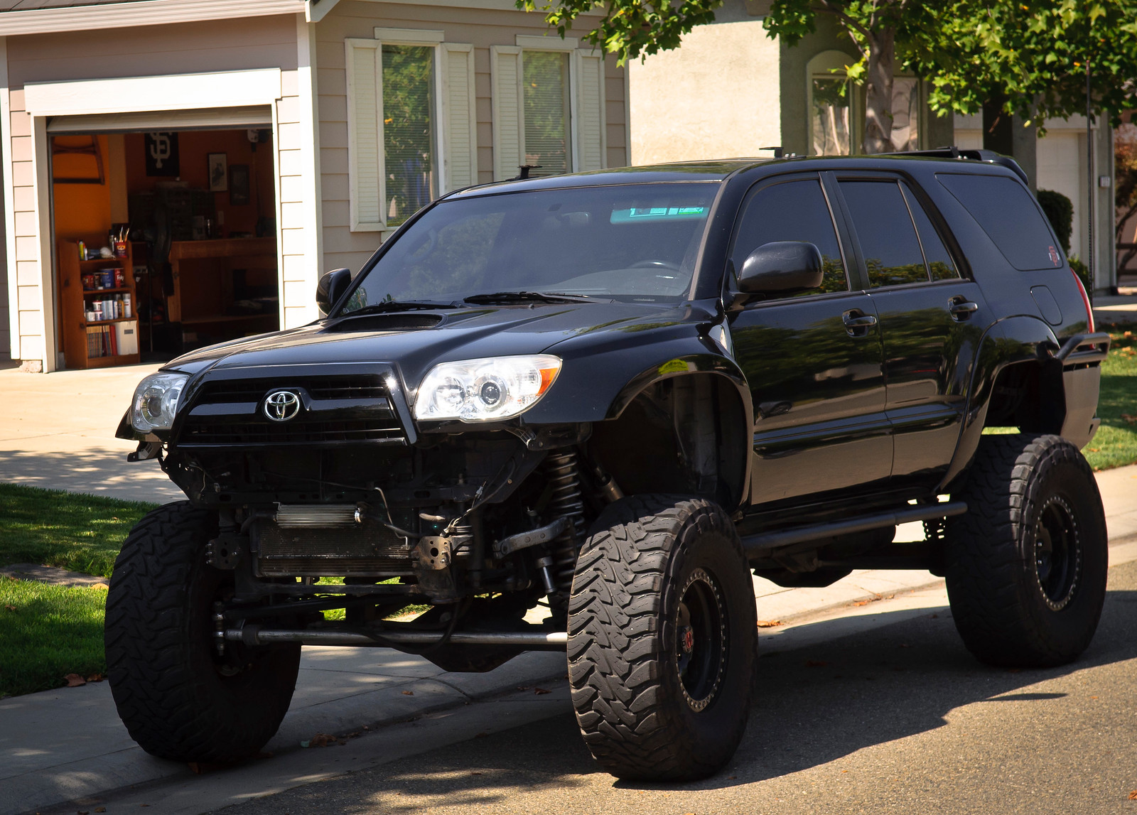

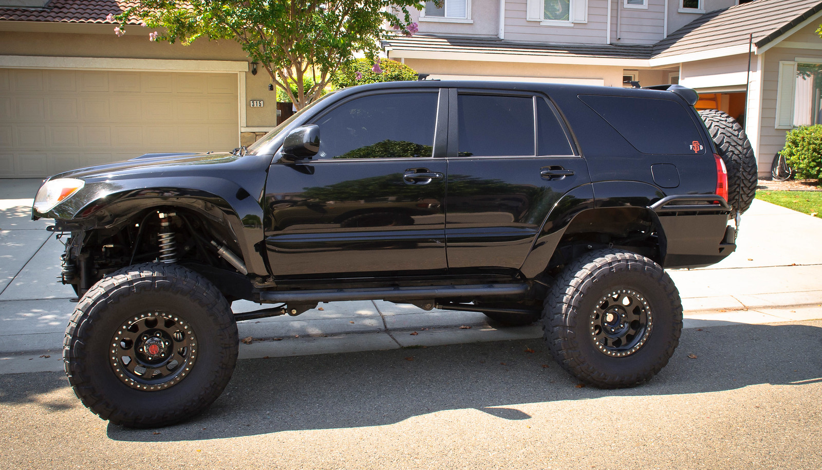

Was treated to this incredible 4th gen a few houses down from Matt's place. WHOA
Great pics once agian. I am jealous of that outing!

Thanks again for running the trail with me, it felt great to get back into some trails.
Most def count me in on the next run. I promise I'll get the GoPro vid up somehow some way shortly.

That is a great deal on the hubs! You should fire up your new welder for the spool.
I was just looking at Beno's old thread about that a few days ago. Still not sure if I'd be comfortable doing that myself. May just bite the bullet and buy the whole spool.
Going with the Lokka as well most likely ordering in the next month, let us know what your experience is with them.
