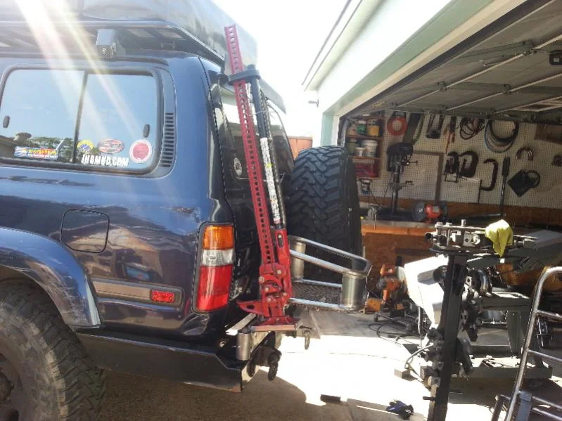

It's here! Man what an awesome bumper. This has to be one of the coolest things I've bought. Like everybody says, it's a work of art. Everything is very well thought out and put together and sturdy. I love how rock-solid the swing outs are. Huge thanks to Sean for continuing to build these for the community. He's a great guy to deal with.
The bumper will be left bare steel. When I get the time, I'll be polishing it up then slapping on some clear coat. I've never been a fan of black armor because you lose all the awesome detail that makes up the bumpers. I still need to order a new rim and get a spare tire mounted. I'll probably run the factory spare just so it doesn't look empty. The issue will be seeing if it all fits in my garage since I don't feel comfortable leaving this thing in the driveway with all the money I've put into it.
I also need to figure out the license plate lighting. That's TBD. Bolting this thing up was pretty difficult since access to the bolts inside the frame is very limited. Had to use some tape on a wrench and get creative.

The monster crate you get from Sean, picked up at a local freight terminal
And it's installed! Did this all by myself so it took me a few hours. I'm in love :eek:

Thanks! Oh and a follow up about the jack...I don't think there's another way to mount it. You can't flip it down and it sits too close to the tailgate to slide the lift point upwards. It really isn't bad though. It just depends at what angle you view the taillight from the rear...
The other option would be to have him mount the jack vertically like in his earlier version. But I'm not sure how a 60" jack would fit in this position
