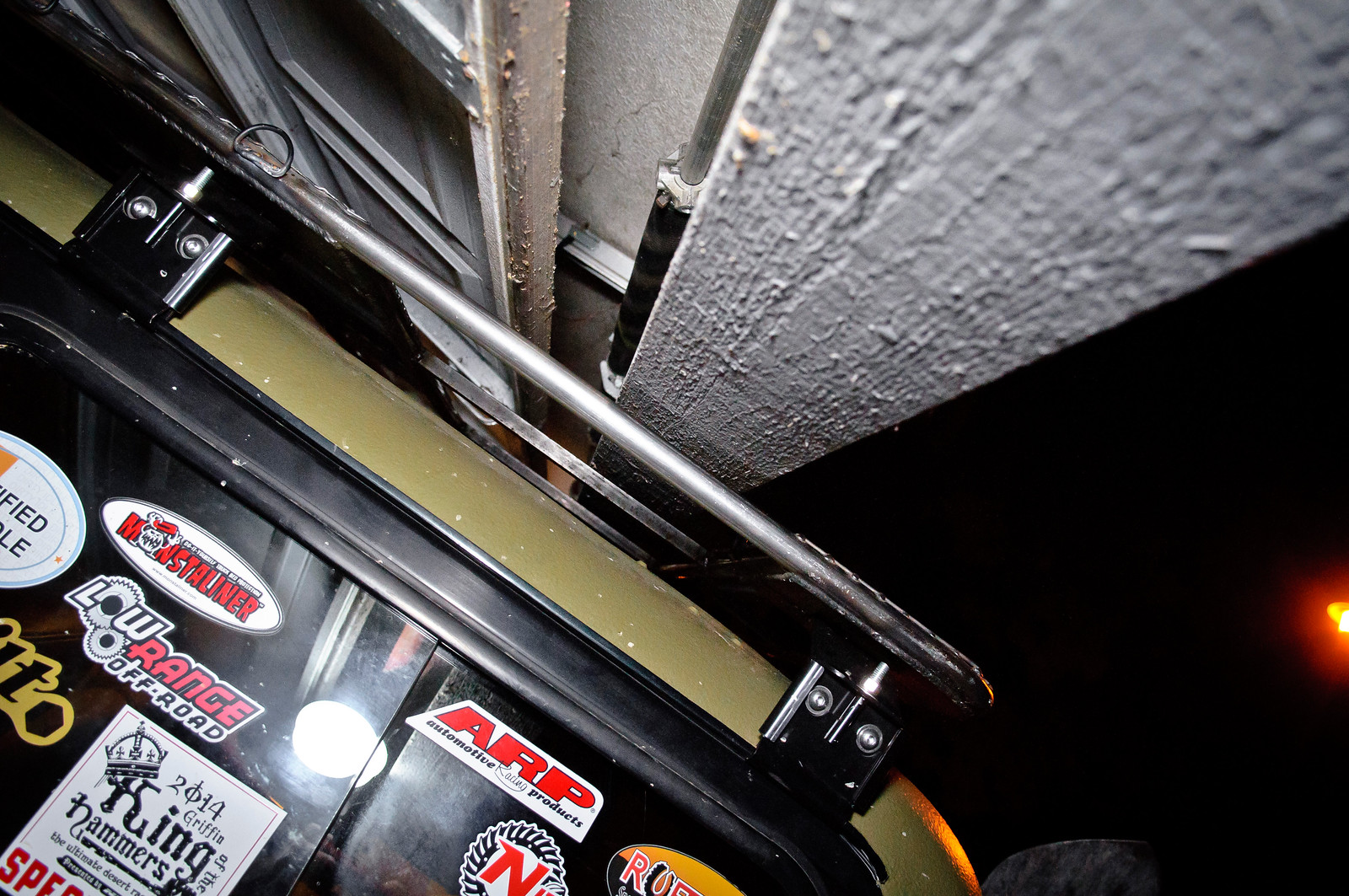

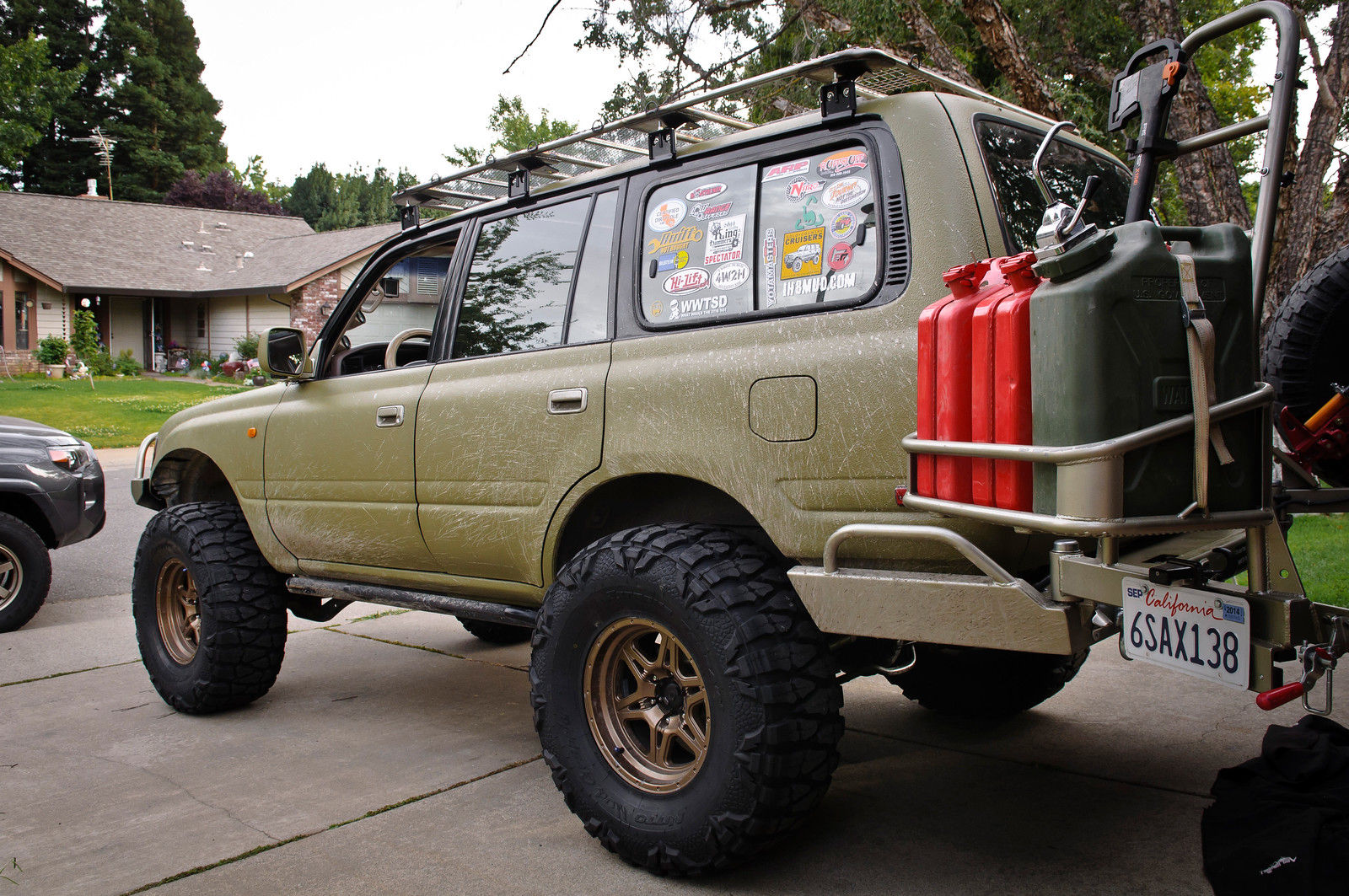

I also pissed off the internet and gave them all blue balls since I didn't post pics of it installed. I installed it last night after work. So without further adieu, here's pictures on the truck! At this point it wasn't bolted down. I just laid it on there to mark the holes in the mounting plates. I then had to take it down again, drill the holes then get it back up there. All with one set of hands. That really sucked. Good thing I had the Monstaliner otherwise I would have destroyed the paint.
I'm getting anxiety just thinking of taking it down again for painting.
Check out the clearance :eek: Not even room for a bee's dick. The most rearward d-ring actually scrapes the whole way in. Grazed the paint of the house. The truck can absolutely NOT go higher if I want to keep the rack on and fit in the garage. If I take a big enough dump in the morning and relieve myself of 5lbs I may not make it out of the garage.

Perhaps you could slot the towers where the two button head bolts are to lower the rack? Not that you'd want to do that for eight towers.
Any chance accelerating into or out of the garage would cause the ends of the racks to touch the lintel/head part of the garage door opening?

You know, I have been thinking of that. I think that will be my next route if the truck needs to be raised a bit. But I'd have to cut the studs down too since they're already making contact with the mounting plates of the rack.

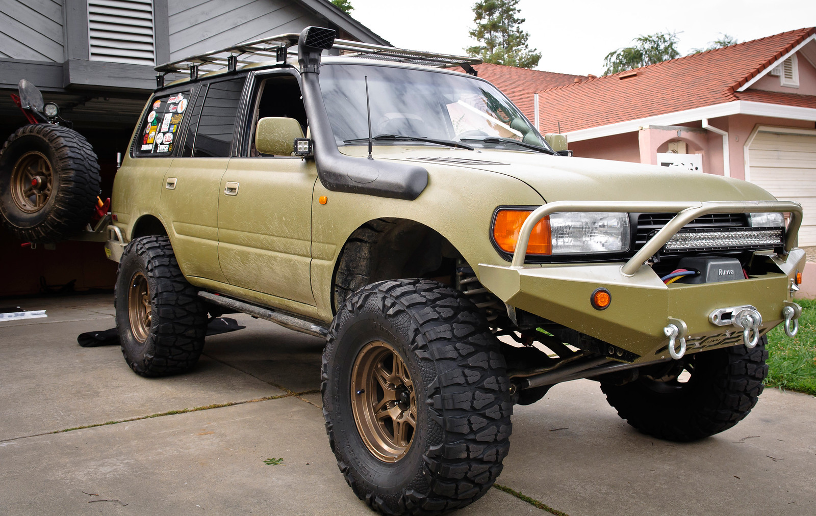

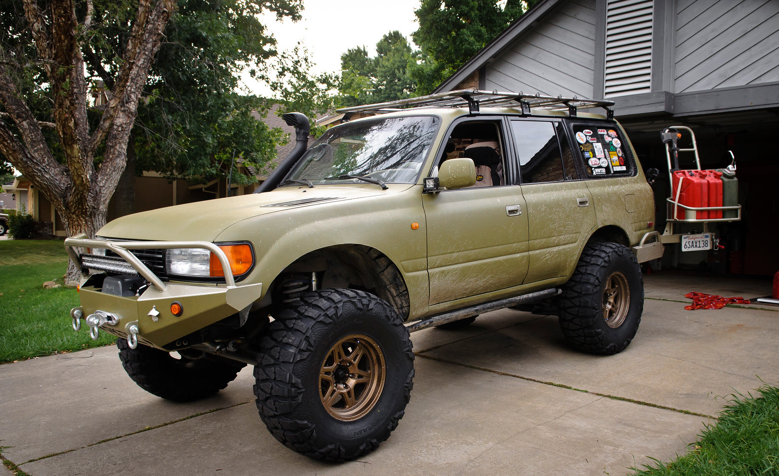

Since I never really did post full details of the tire install here we go. This is what the truck looked like right after installing the tires. I could drive it, but barely. The tires would rub at even the slightest turn which I was expecting.
As I've mentioned before, I don't want to lift the truck any higher. For one, it has to fit in my garage. Two, it's already tippy enough and all the trails in my area are off-camber over rocks. I don't feel safe going higher. And lastly, handling on a lifted 80 is already crappy, I didn't want to make it even worse by going taller.
So I took off the fender and saw what I was working with. The entire inner fender would need to move up and out of the way. You can see the tire was also hitting my slider. I ended up cutting about 2" off of the slider.
I made several straight cuts into the inner fender then proceeded to bend it up and out of the way.
I then cut a 3" arc out of the front fender. This should be enough to clear the tires for most of my driving. Crawling won't be a problem now, but we'll see how it handles hitting a big bump at decent speed. I'll also need to come up with a plan for attaching the inner fender to the outer fender just so it looks decent.

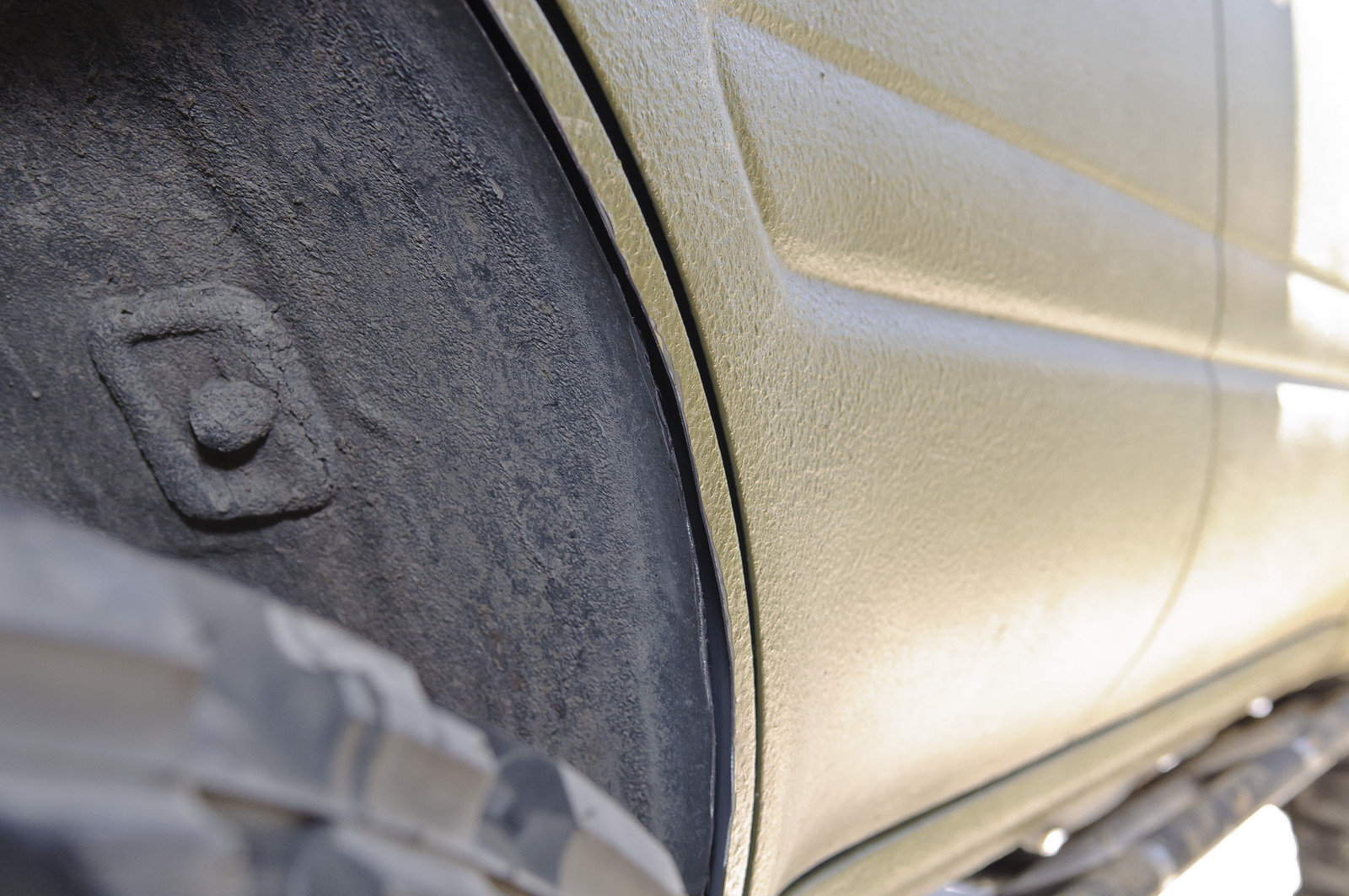

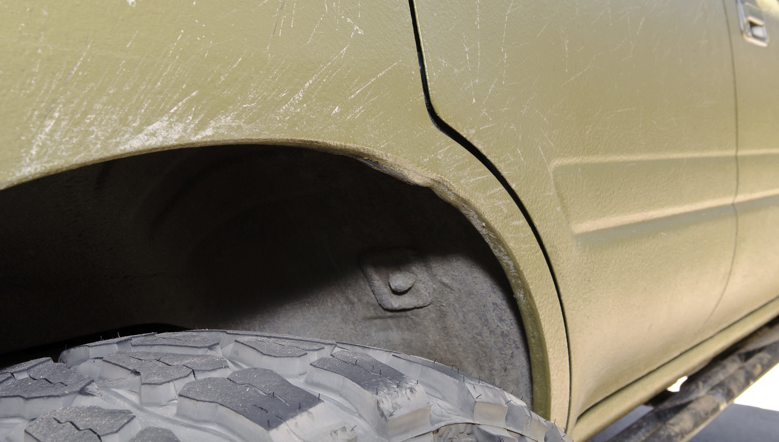

With 37s the fender was NOT having it. The tire stuffed inside and on the way out it caught the lip and bent it pretty bad. It even warped the body panel a bit.

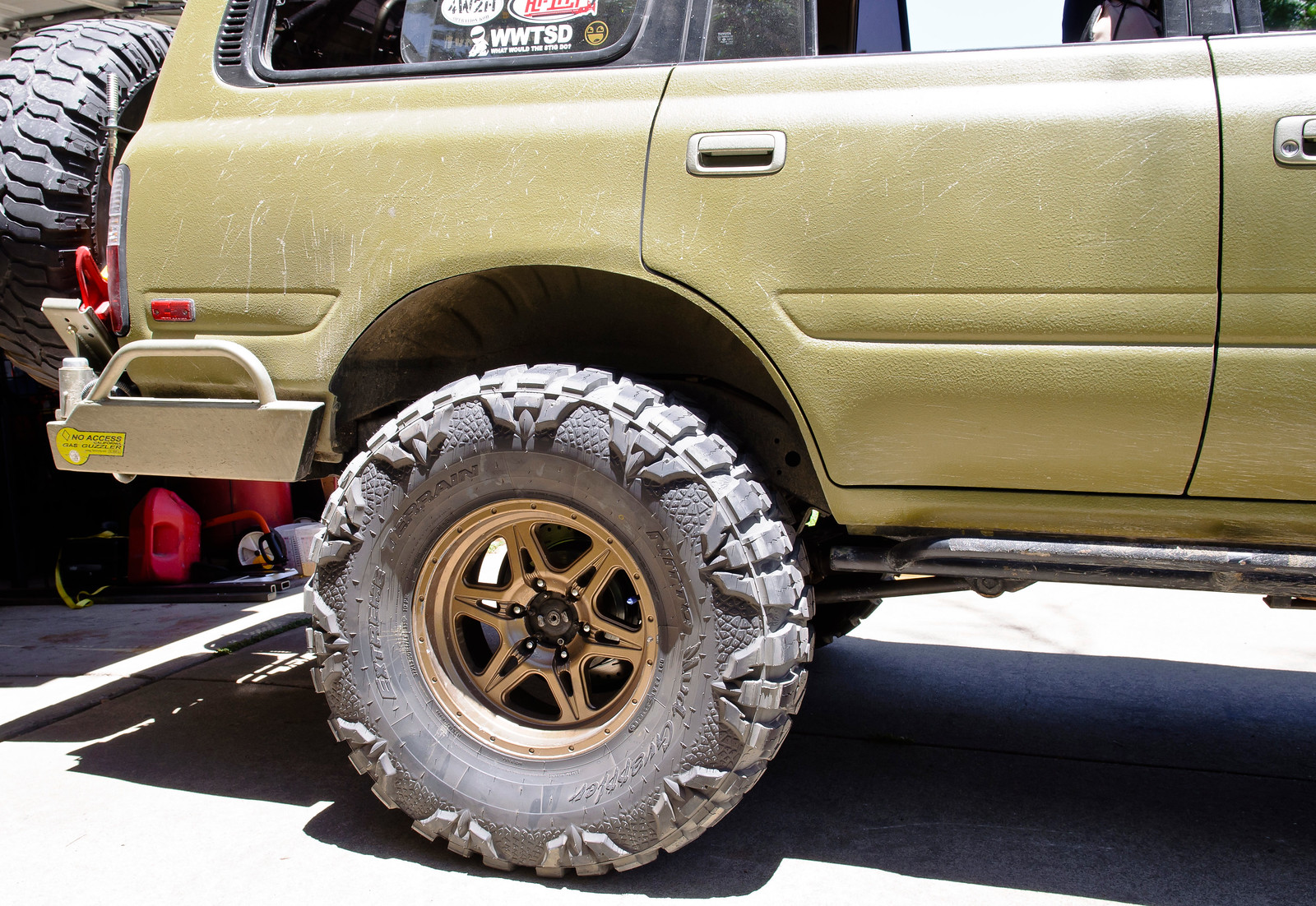

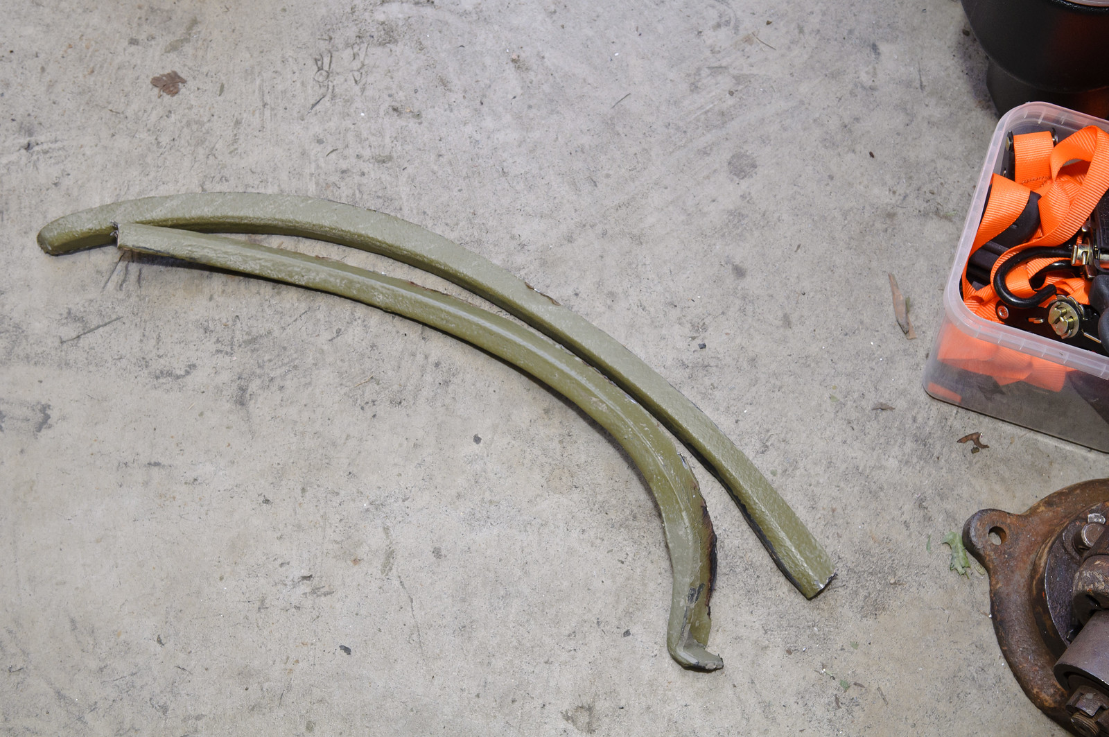

Now what? Out comes the grinder. I cut about 1" from the rear fender, removing the enter lip that curls in. If you look inside your rear wheel well, I cut so curve of the inner fender is flush with the outer fender.
This is the gap that's left after cutting. I plan to add a thin strip of metal and weld the two fenders shut again. I'll need to do this sooner rather than later as the inside of the cab is now exposed to dust and mud and water.
After cutting! If you look closely under the door you can see where it's a bit warped from when the tire was stuffed. This should give me plenty of room now. Nothing for the tire to get caught on. Worst case scenario is that it bends the inner fender up more while flexing.
Wish I could cut out more from the rear to make it look "level". The truck is level but the amount I cut from the front makes it look uneven. Oh well
