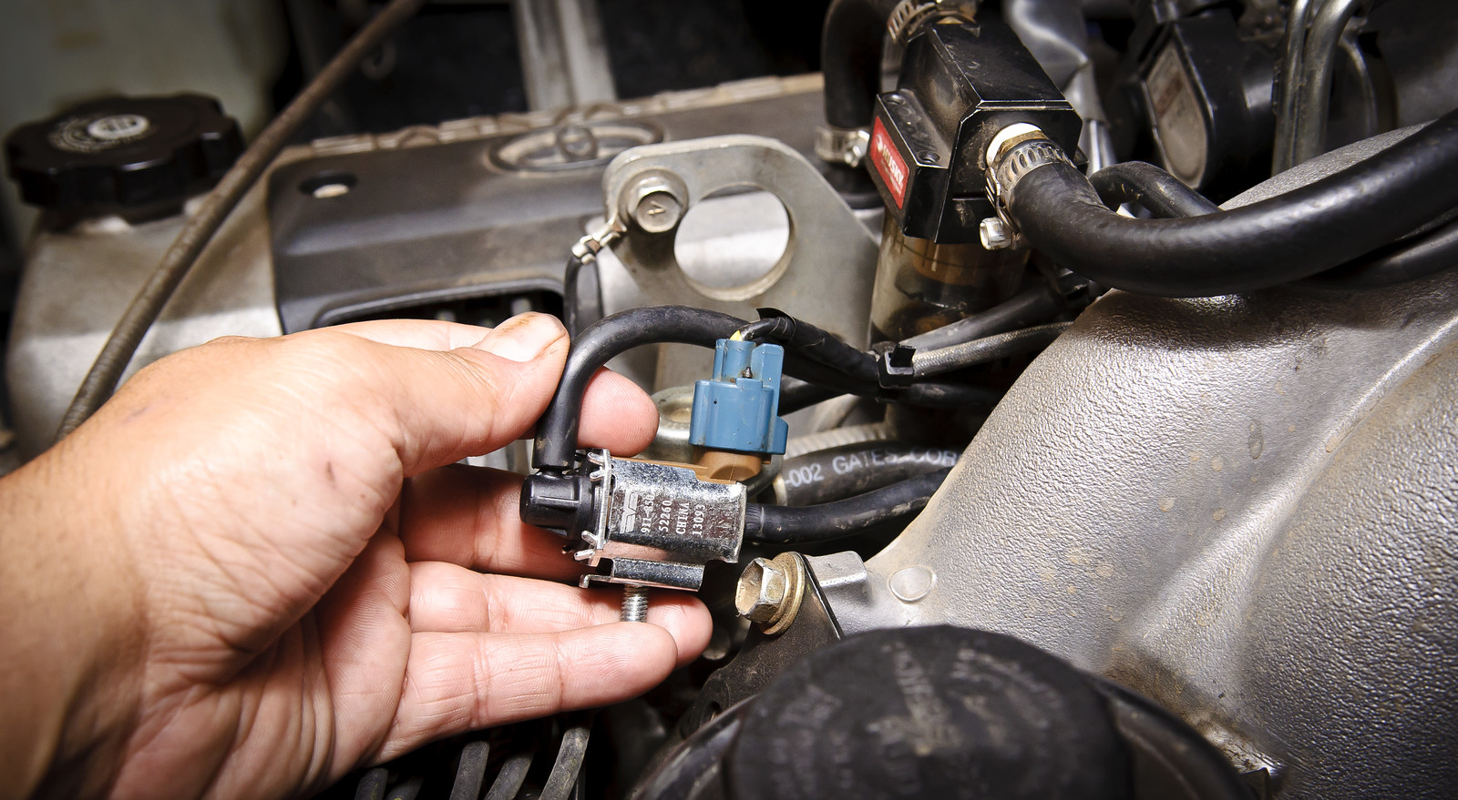

VSV FOR EGR
About 5k miles after my initial P0401 fix the code came back. The first time around the VSV and all other components tested fine. In my case it was old and cracked vacuum hoses under the intake. When putting everything back together I relocated the VSV out by the PS reservoir because I knew it was only a matter of time.
Sure enough, the light came back! First thing I did was test the VSV by applying 12v to the terminals. Nothing, DEAD! With 12v power applied air would still flow from one side to the to other. You couldn't hear a click either.
Not wanting to pay Toyota's stupid prices for a simple vacuum solenoid I ordered the Dorman 911-850 unit from Amazon for about $26. Tested it with 12v and it worked fine, you could hear the audible click. Let's see how long this thing lasts and hopefully the CEL never comes back!

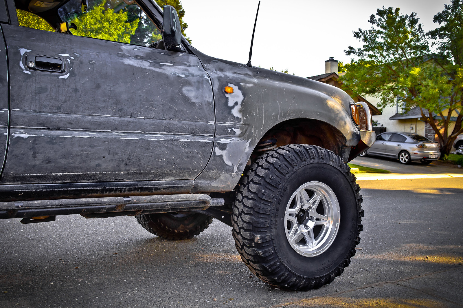

Just kidding :flipoff2: Kinda. The used 35" tire I had on my spare came with a leak I tried to patch but it just wouldn't hold air. So I found a used 37x13.50 Super Swamper M16 on CL for cheap. Since I eventually plan on going with the 37s, I might as well get it now so I don't have to pay $400 for a brand new one later.
And of course, I just HAD to mount it up to see how it fits. HOLY CRAP. It looks so awesome. I feel like getting 5.29s and 37s sooner rather than later. Didn't get any rubbing either while taking a quick drive around the block. Oh well, at least these pics will have to hold me over until I'm ready for the 37s :o

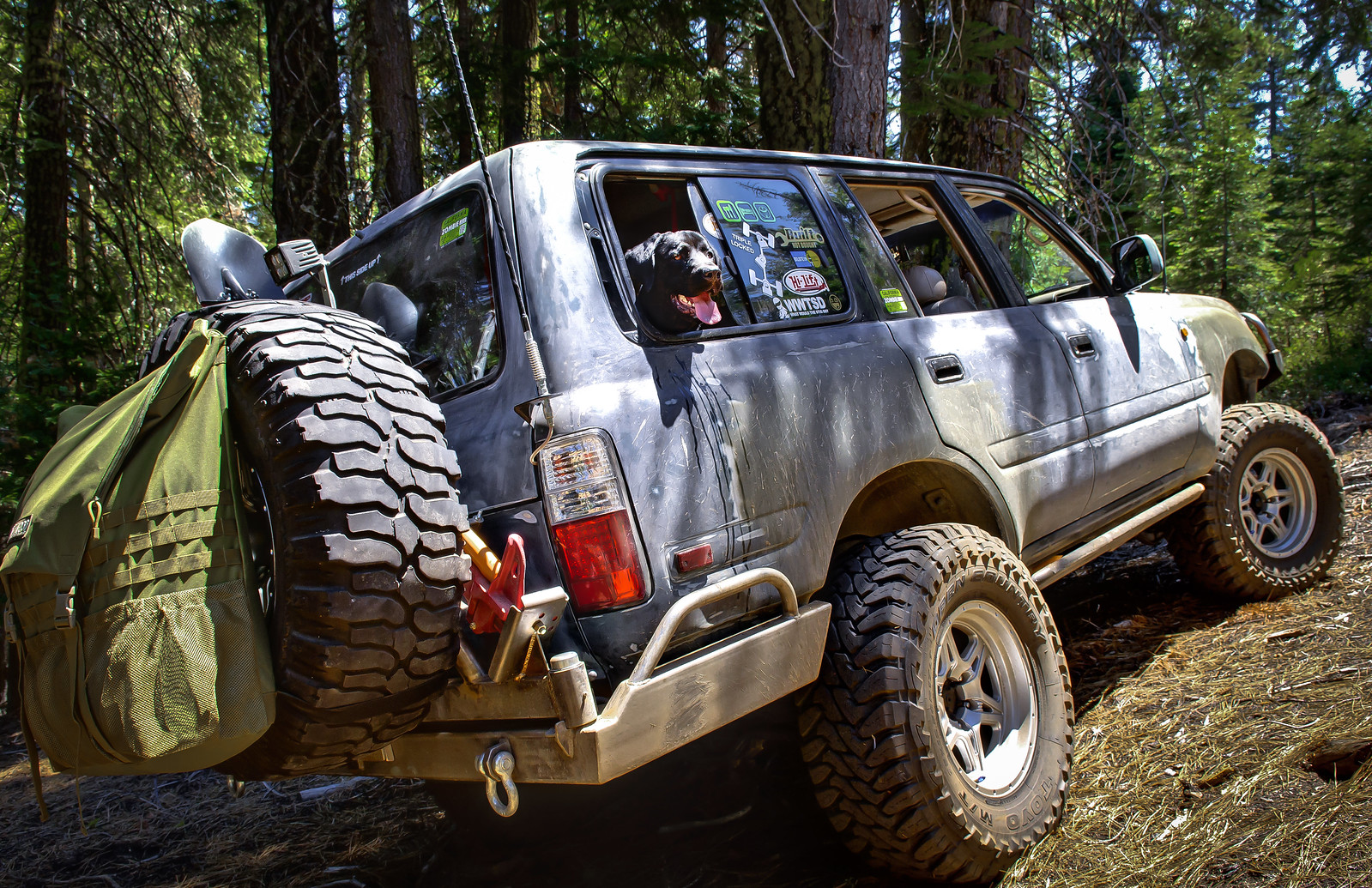

Wife was out of town this weekend so I decided to take the dogs and go play in the forest (Kyburz / Silver Fork Rd area). Good times!
Gunner doing a good job at spotting :D
