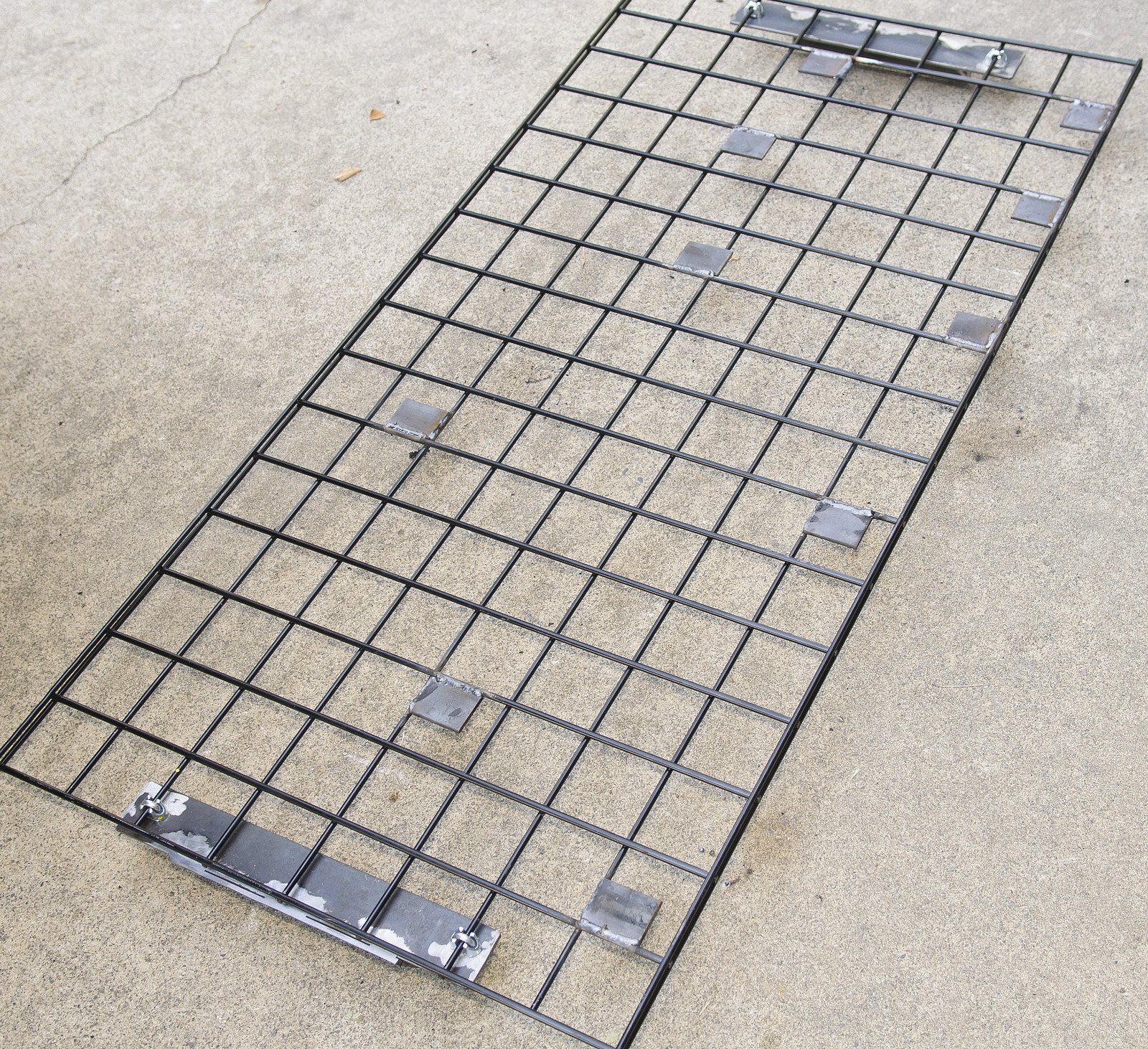

First off you need a grid panel. After doing some searching online this was the cheapest I could find. Lots of places wanted too much for shipping. 2x4 grid panel in black for $28 shipped. Perfect, don't even need to cut it down to size. http://www.fireflystoresolutions.com/p-7856-black-grid-panel-2x4.aspx

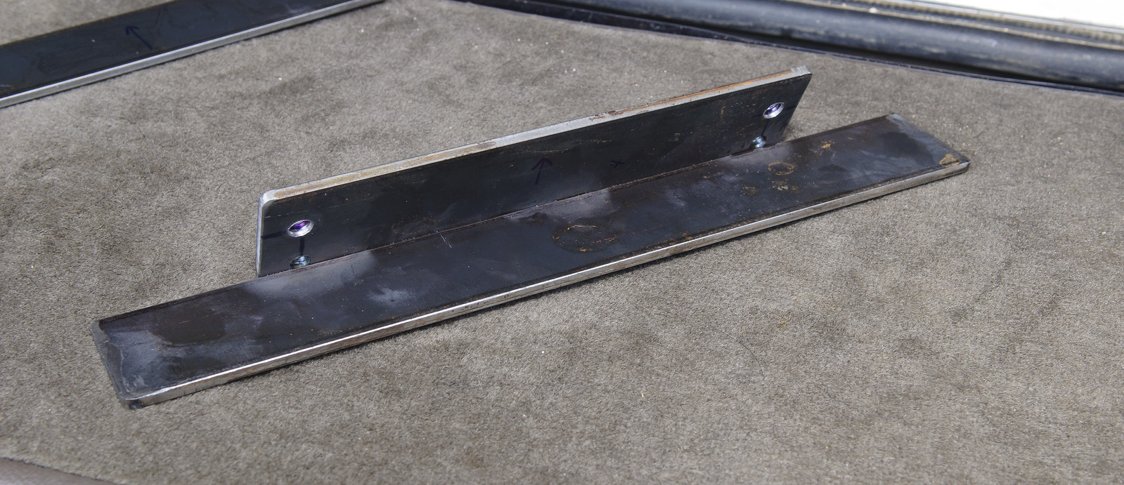

On to the brackets. Scrap pieces of 3/16" plate. Cut to size, welded and drilled to fit the existing grab handle bolt holes.
Ground the welds down cause I felt like being fancy
Bolted in

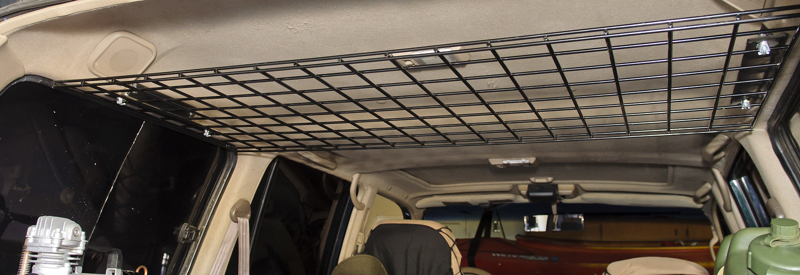

Mock fit

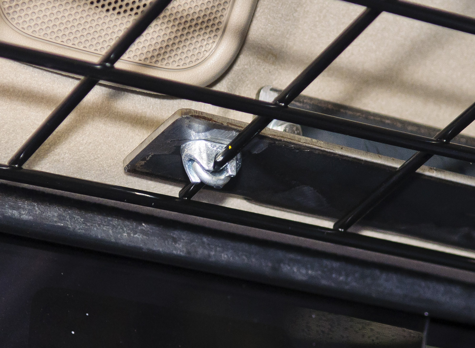

Panel is attached to the brackets using some u-bolt screw clamp thingamajiggers. I forget they're actual name at the moment

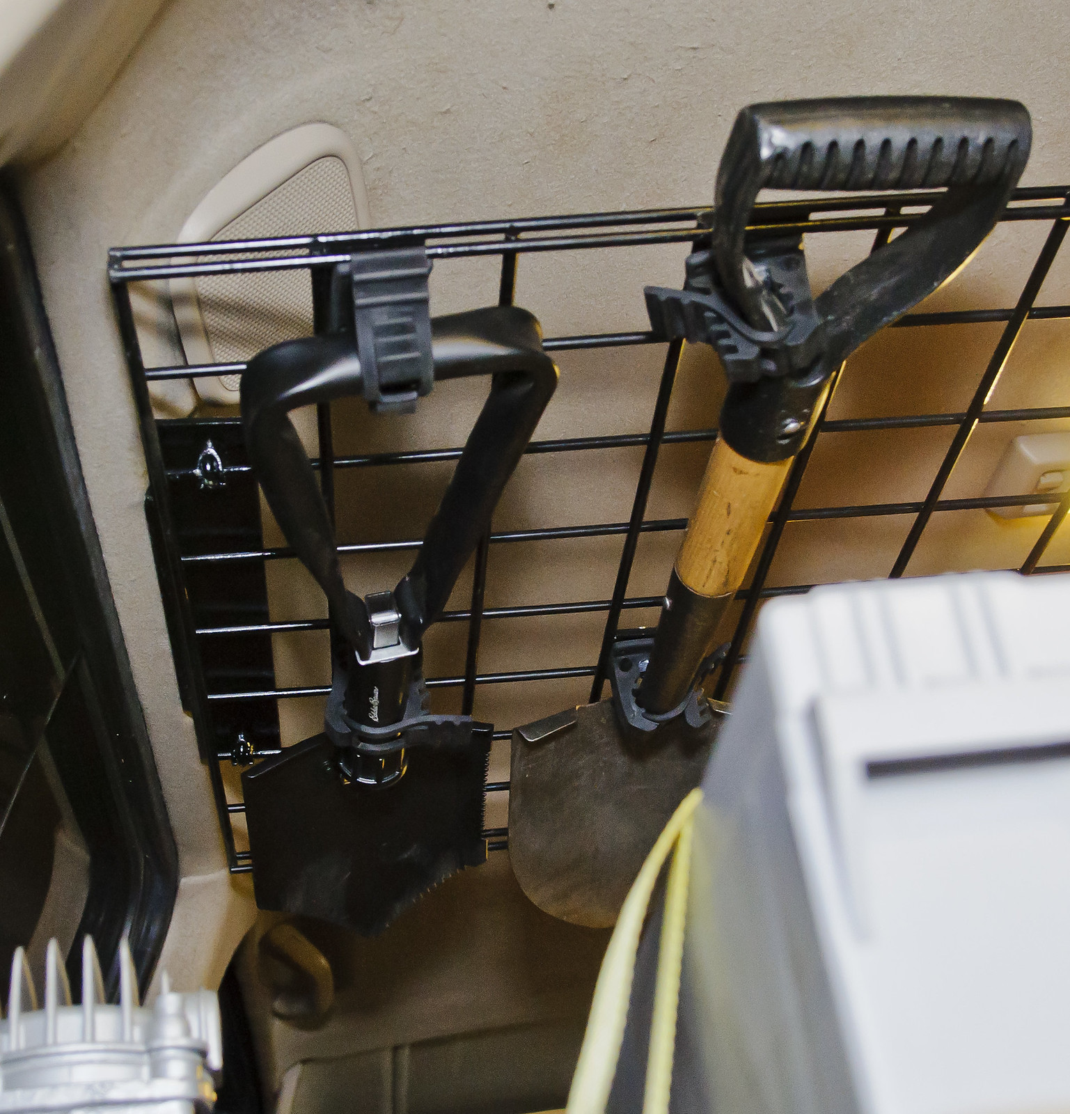

Welded in some more scrap 3/16" plates to serve as mounting points for all the tools. This would hold the Quick Fist clamps.

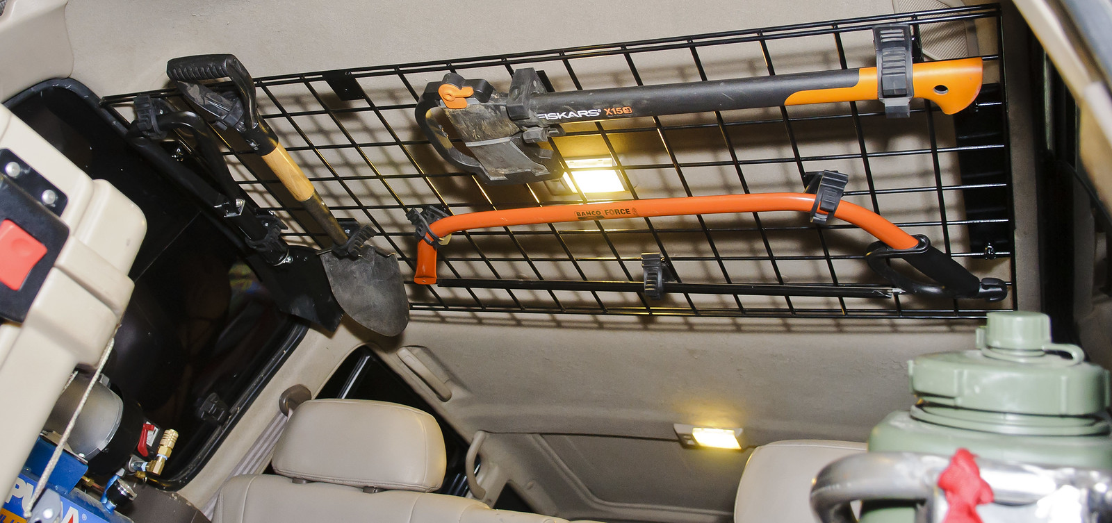

And there's the finished result! Yes Beno, we use all these every time we go camping. Don't be hatin' :)
Why 2 small shovels? One's for pooping and one's for not pooping
Let's see how it long it takes for the keyboard warriors to say these are all going to break loose and decapitate all passengers in the truck Final Destination style, disembowel my dog, flight out the window and cause a multi-car pileup that kills of a bus full of kids :flipoff2:

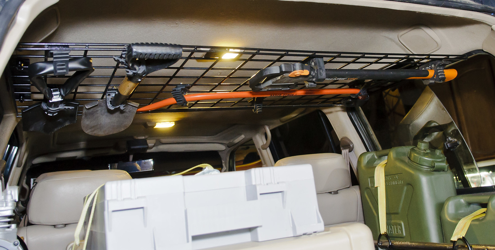

And the final layout of the rear hatch. Maybe I have room for a small half drawer under the dog bed?

What is the clearance between the grid and the roof? Also, is it obstructing the view out the back? If possible could you post a pic of the view from your rear mirror?

May just be me, but Id flip that stuff around. Id hate for you to get your rear driverside passenger's brains on your s*** shovel incase you were ever to go wheeling and hit a bump... knocking on wood.

Curious how the attic rack will handle that weight. I cut my grid a little larger so that might contribute but after lots of washboard last weekend I noticed it flexed and bowed enough for the corners of the grid to poke the headliner and that was without weight. Let us know if the tools cause excessive flex in the grid. Definitely nice to have easy access to the tools like that.

I don't have actual measurements but hopefully this picture gives you an idea. As you can see it really doesn't interfere with the view as the profile of the whole thing is very slim. You could really place it as close to the ceiling as you want by adjusting how you make the brackets and cutting down the 2x4 grid panel to fit within the curves of the headliner.
May just be me, but Id flip that stuff around. Id hate for you to get your rear driverside passenger's brains on your **** shovel incase you were ever to go wheeling and hit a bump... knocking on wood.
No you're right. This is actually a good point and I was thinking of trying to reverse the shovels. But they'd stick out towards the back because of how I put the mounts. Wish I had the hindsight to mount them the other way around when I was doing the welding. DOH! But they are a good few inches away from the headrest of the rear seats. I've never really had passengers in my truck but if I do I'll probably end up flipping the shovels around.
I'm sure it will flex and sag over time but that's why mine is mounted underneath the bracket. Is yours sitting on top of the bracket? Even if it sags a lot the panel will never touch the headliner as it's already sitting below it, almost flush with the rubber window seal. Perhaps this picture gives a better look at it:

Having an AXE and a shovel above your head is a bad idea, regardless of whether you predict people are going to call it out or not. What happens if you get in an accident? Why would you want to risk going from bad to worse?
Everything is a safety issue when you start modifying a vehicle. It's not as if this didn't cross my mind. Of course it did. I'd be more concerned with your hacking of the factory suspension and driving on public roads putting other people's live at risk. And it's funny how people react to this. A lightweight axe and shovel = DEATH upon all passengers but nobody says anything about the heavy compressor. What if that thing breaks loose in a rollover? Surely could cause more bodily harm than a 3lb axe with a plastic sheath (nothing more than a plastic stick at that point). Or the ice chest held down with a few straps. What about the dog? He's not strapped down. That's an instant 85lb projectile.

This is why I built a drawer system and wagon gear tailgate lid ;-). Everything is self contained and locked away, axe and folding shovels fit nicely in a tailgate :-) and a cargo barrier would be nice but you then loose a sleeping area. Been wanting to build a fold up one for awhile. In the down position you could mount axe, shovel, AR ;-) and then fold it up into the roof for sleeping.
On the flip side, nice job on the attic. I've always wanted to do something similar but would only place soft items in the attic, sleeping pad, blanket ect. It also helps to keep your COG low and insulate the roof.
You will notice now with your rack just how tippy you will start to become as you continue to add weight up high. It's hard to resist the urge to keep adding items with the new real estate... Been there.

Great response thank you very much! Now I'm thinking about doing this on my 100 but I have the rear air controls/vents and a couple extra curves in the headliner I will have to cut around. Everyone's saying the tools are going to come flying off but I guess they don't realize what kind of straps you're working with. The grid would likely break off the custom brackets before the fasteners come undone! I might go with lighter weight objects (or at least less lethal) up there such as my tow strap.

Thanks! And definitely, I agree. Ideal solution would be to put everything in the tailgate or a drawer which is what I'd like to do eventually. Tailgate lids are too expensive for what they are, thinking about going the DIY route. I'd put all the shovels and axe in the tailgate then smaller things in the half drawer. Even though I like how the attic rack came out, I'm not thrilled about having all those heavy things up there either. And it's a lot more effort to get them out. Need to pull out the ice chest, climb in and unlatch, kind of a pain. Having them in a drawer would be much simpler. And a cargo barrier would solve the decapitation issue, but then it's even more weight to add. It never ends.
It would be interesting to see just how much force/weight the Quick Fists could withstand without breaking loose. Hope I'm not the one to find out :) I've seen Quick Fists used to hold all kinds of heavy objects inside and out a vehicle including shovels and axes. Recreational and emergency applications. So I'm not the first.
