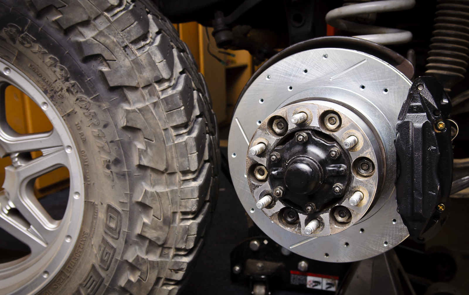

FRONT BRAKE OVERHAUL
While I have the truck torn down in preparation for paint I decided to work on the front brakes as well. My brakes were squeaking badly when doing light braking even with new pads so it was time for a refresh.
Picked up the drilled/slotted zinc Powerstop rotors, their ceramic pads and the Napa "Eclipse" semi-loaded remanufactured calipers. Not even sure if I needed calipers but for $65 a pop, figured I might as well change them now. Just need to bleed all around then take her for a spin. Up next will be the rear!

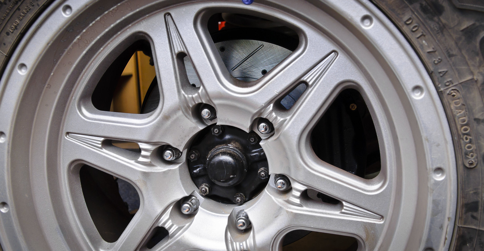

Peaking behind the wheel
Are those factory calipers that have been reman & painted?
