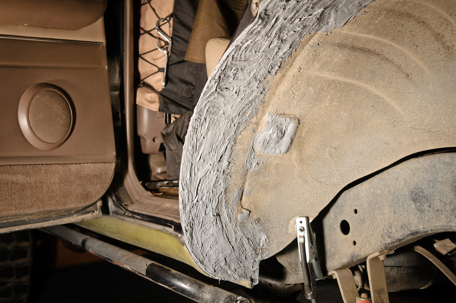

REAR FENDER SURGERY CONT...
Finally finished one fender! Can't get too excited, still have to start on the other side. Here's the final contour. You can see there's no more edge under the door and it cuts in slightly higher after the door.
On this part of the fender I spot welded small strips of metal to close up the pie gaps
Over here I used a large strip to cover the whole area. These are welded to the outer fender
After all the welding and grinding I slapped on some Eastwood brushable seam sealer. This stuff is super thick and goopy. Covers every gap really well. This can goes for about $30 and should go a long way. The plan is to smooth this out a bit after it dries then coat the entire inner fender with Monstaliner the same time I repaint the outer fender. I like the smooth texture of Monstaliner as it doesn't tend to trap dirt in the crevices.
