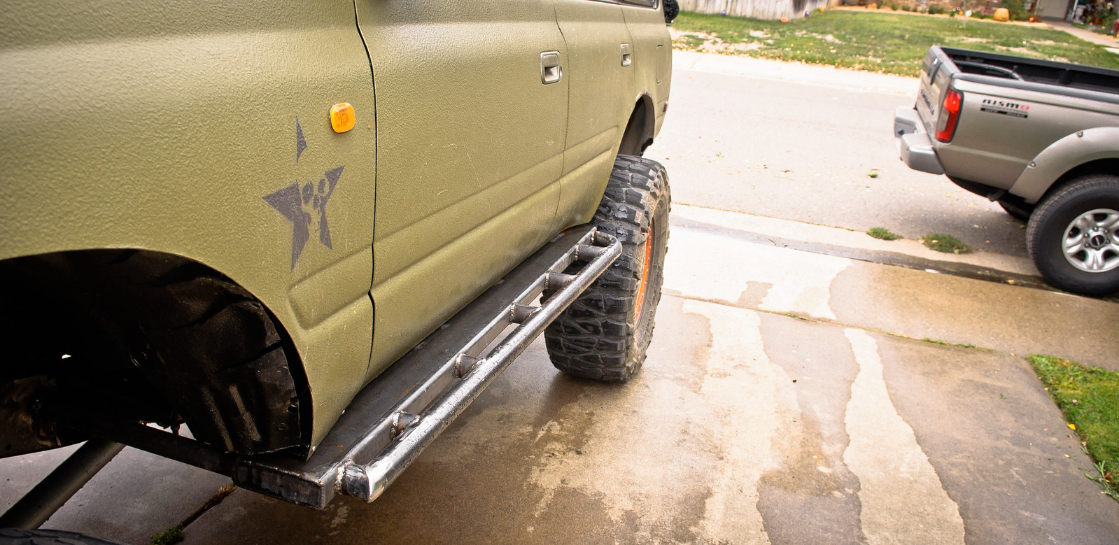

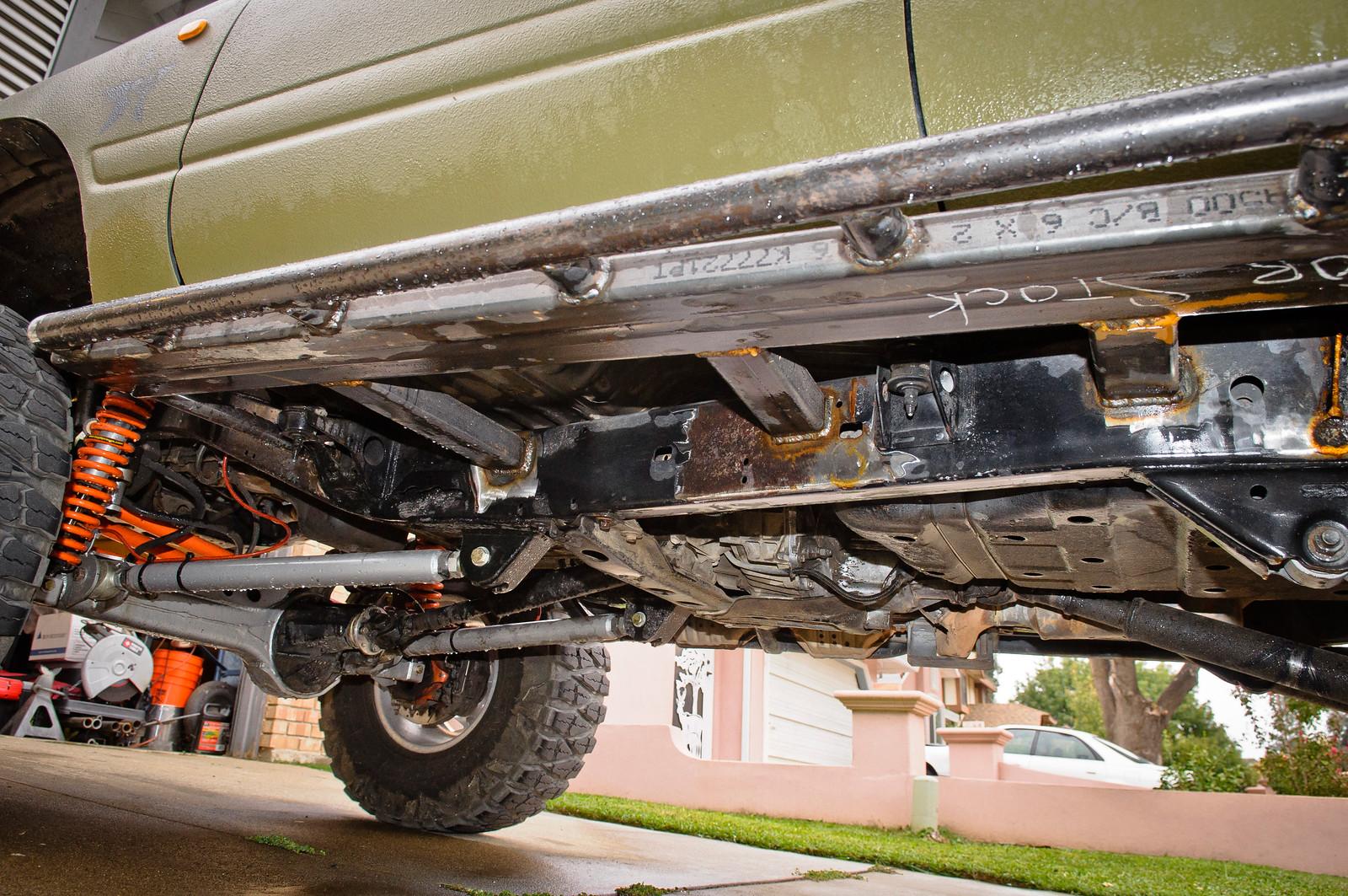

Finally got the driver's side slider done. Now I can get to the rocker chop on the passenger side. Main slider is 3/16" 2x6 plank with a kickout in 1 1/2" sch. 40 steel (1.9" OD, 0.15" wall).
With no scab plates on the frame I would add some good 1/4" gussets if I were you.

Curious your thoughts to the square front corner on the outer hoop...
Seems it's asking to reach out and snag vs slide...
Nice taper tho on the the hoop, I like that idea!
Nice work. I'm also a fan of protection without loosing clearance. Or in your case gaining. What do you plan on painting them with? And I'm with cruisermatt about adding some support. Can't wait to see your inspiring pics of them in action. Keep up the great work.
Yeah I actually have a few gussets already cut out ready to get welded in. Those will go in before paint.

No transfer case /tranny armor????
Still on my to-do list! Luckily I have enough ground clearance that it hasn't been an issue yet.
-A
Well it was a little bit of a design choice, and a little bit due to trying to get the taper in real tight towards the front. Because of large bend radius of my die, I would have had to cut the tube at a super extreme angle to get it in that close which would have made it hard to weld. I really don't think that square corner will pose any issues but only time will tell. I think the flat face of the 2x6 plank from the front would be a bigger anchor than the square front corner of the kickout.
