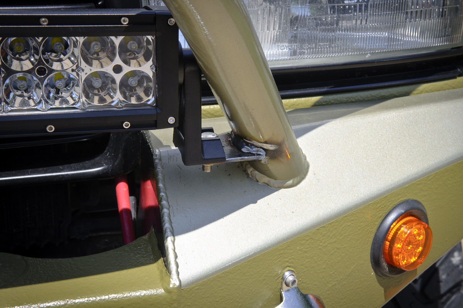

The AOE bumper needed some tabs so I picked up a pair from here: http://shop.weldtab.com/category.sc...B350B3AC05CD4D605.m1plqscsfapp05?categoryId=4
Good thing I bought a welder. Makes little projects like this easy and gives me a chance to practice my welding. These welds didn't come out pretty, but the thing is solid. Oh, and bright as heck too.

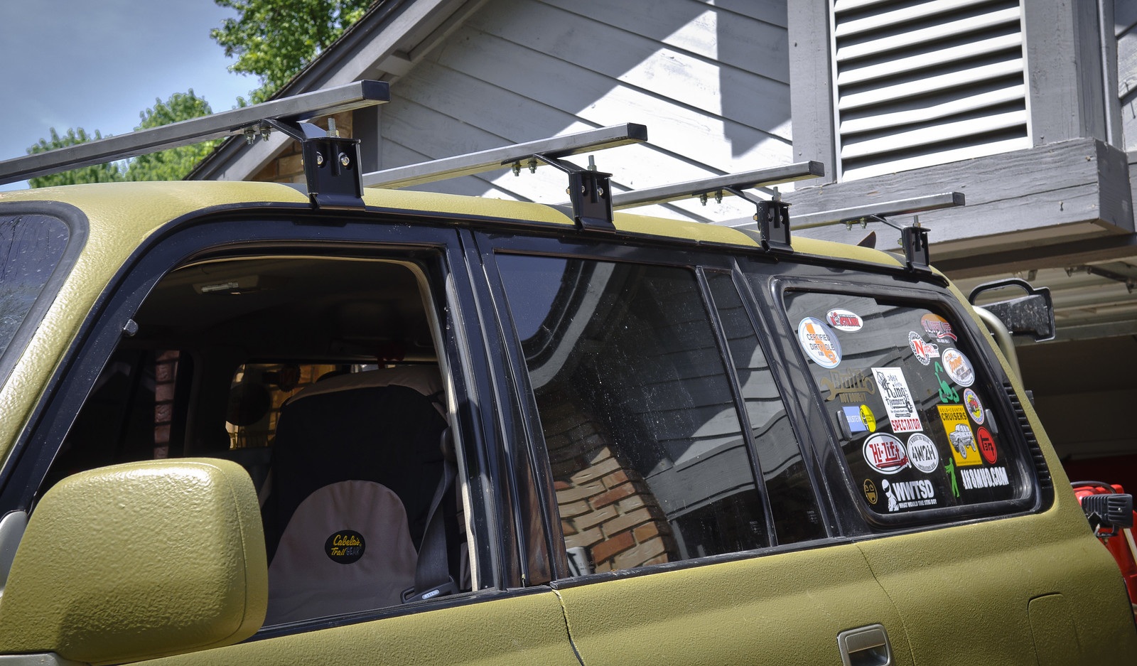

And here's better pics of the Gamiviti gutter mounts and load bars. Bought some plastic end caps to give it a finished look.

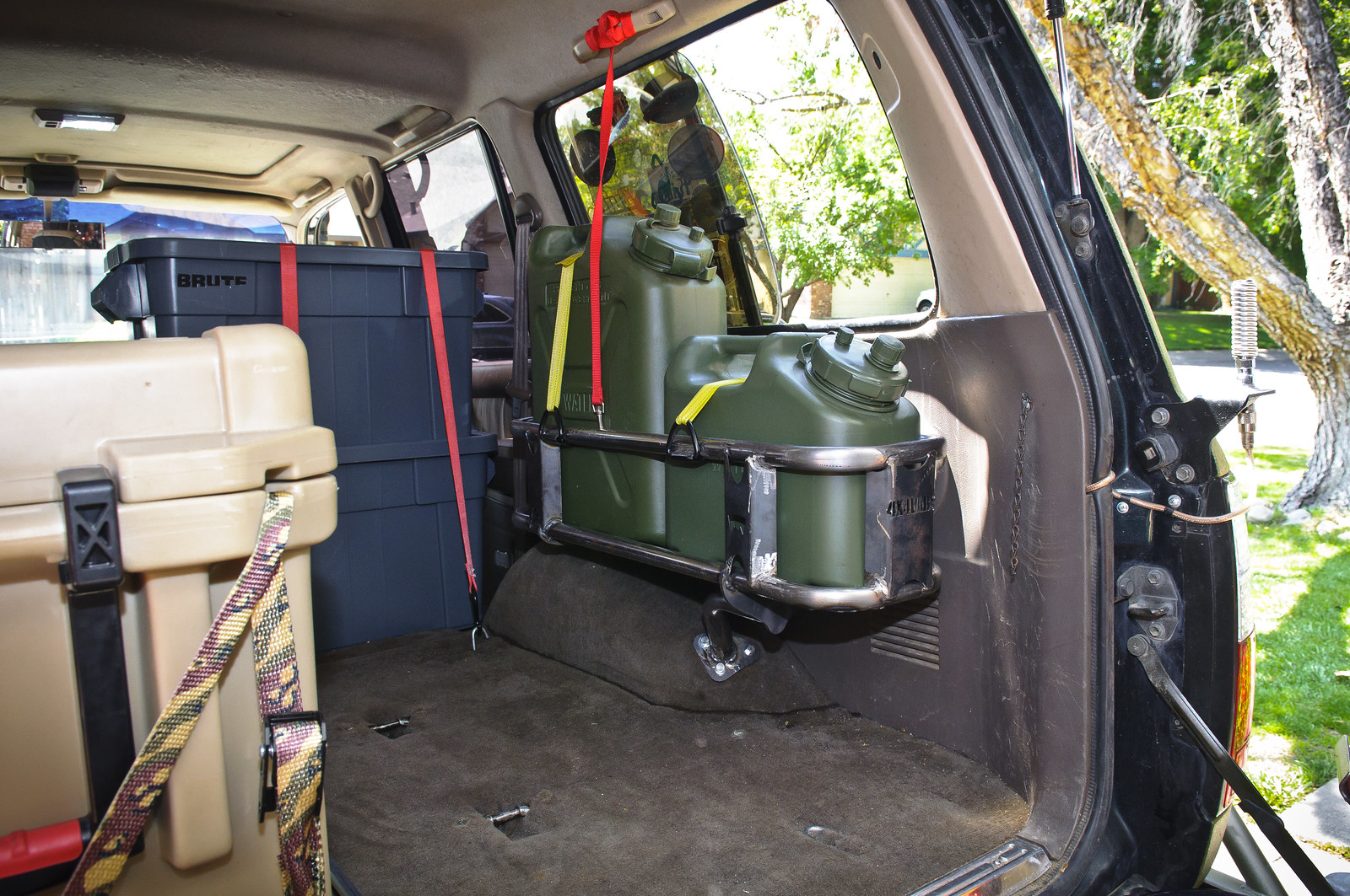

Better pics of the jerry can basket DIY kit from 4x4Labs. I'm running a 5g can and a 2.5g can so that dog can still stick his head out the window. The cans are secured with the some d-rings that I welded on myself.

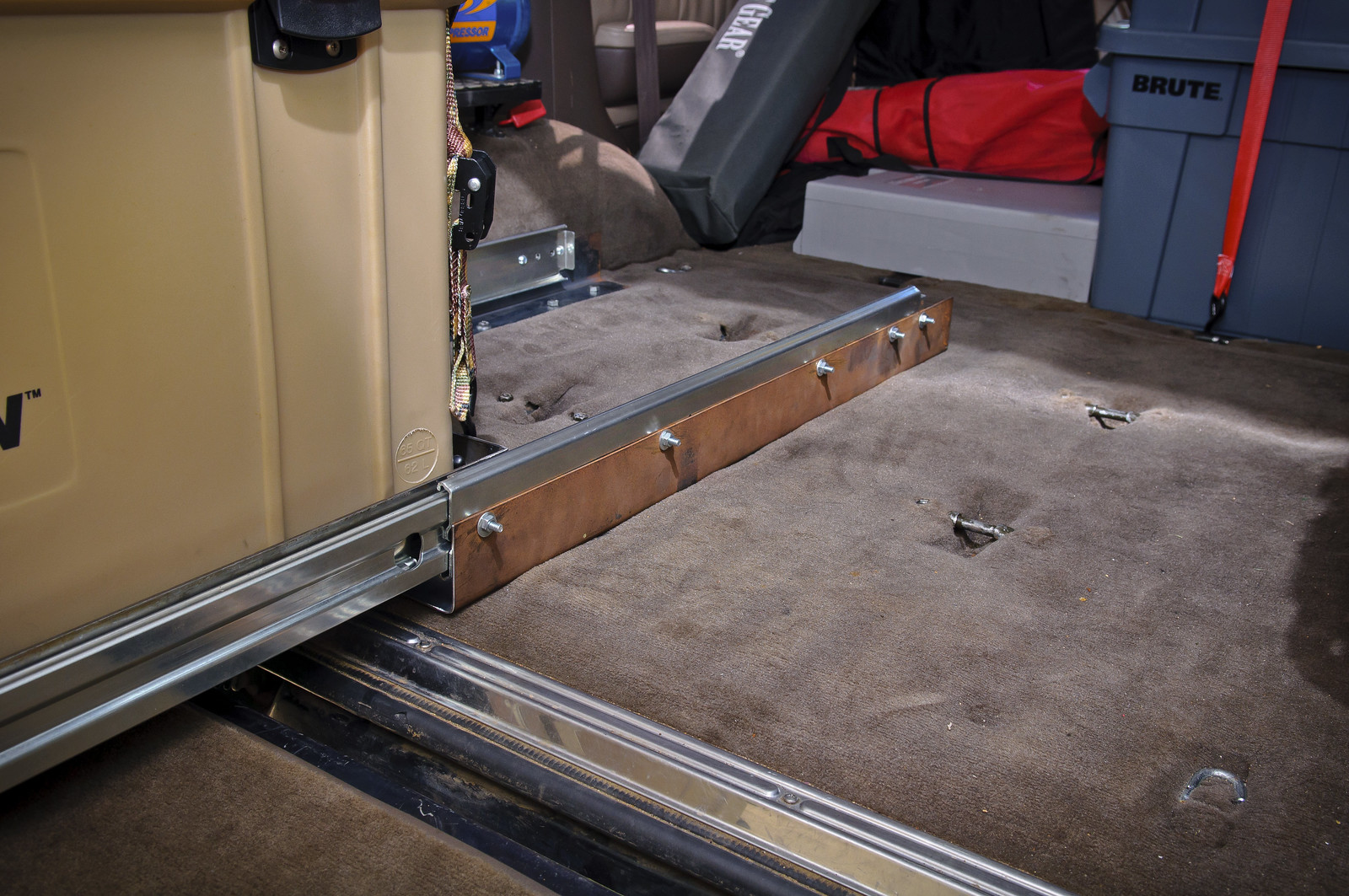

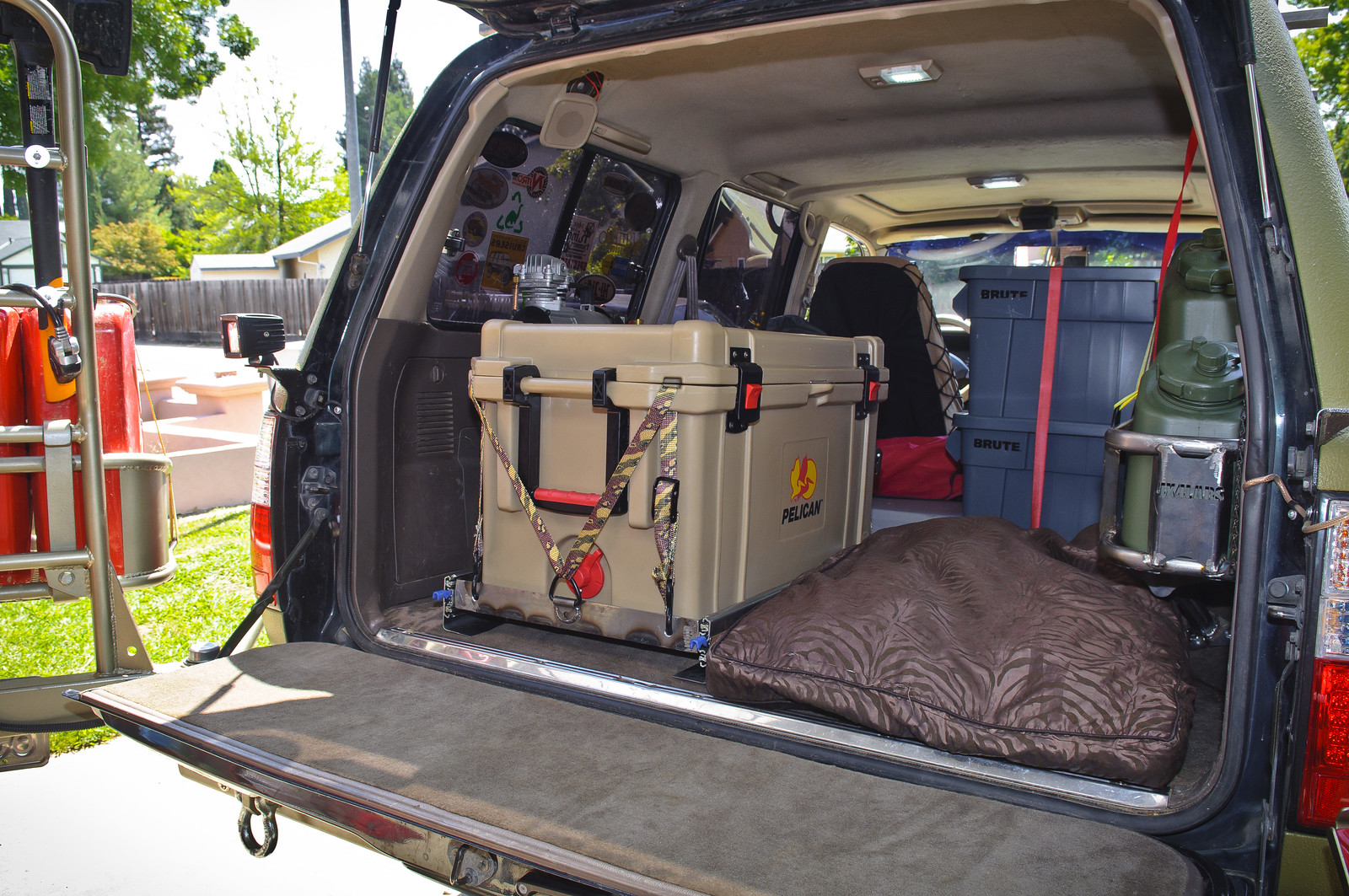

And lastly, my drawer slide for the Pelican cooler! This thing has been on my to-do list for a long time. Didn't really want to make it out of wood so I waited until I bought the welder. Metal is heavy, but it will last forever. It was a lot of work. I don't feel like unbolting the whole thing to paint so I may leave it raw and rusty for now - I kinda like the look!
The slides are Ryadon 3600, 30" long. Purchased them from drawerslides.com They are rated for 500lbs so they're extremely stout. They're also locking. They lock in the closed position and lock in the fully extended position, perfect for this application.
The base of the tray is 14ga, the side walls are 10ga and the angle supports are 14ga I believe. Basically all the cheap scrap pieces at a local metal shop. Spent about $38 in metal including the cutting. Not too bad! I'm really happy with the way this turned out. Welded everything up myself including the d-rings. It's rock solid and brings the ice chest out the perfect length - easy to reach in and grab stuff without having to climb in the truck. And good thing too cause these Pelican ice chests weight a ton, even when empty.

Hey Jose, Did you think of any other way to mount the 30" to the space in the AOE without welding those mounting tabs?
Also, any way you could post up some pics on how you wired the whole thing? I know I'm asking for a lot but your thread has pretty much been the basis for how I'm doing mods to my 80 and I admire all the work you do! If only i were as competent as you! :clap:
Thanks for the kind words :cheers: Yeah, I looked at few options before deciding to weld the tabs. If welding isn't an option, you could make it work by bolting it to the bumper as shown in this pic. You could drill where the Xs are. The upper X lets the mount sit flat, but the light bar ends up sitting right up against the grill. You could move it forward to the lower X, but then the mount is sitting on the curved edge and not perfectly flat. Either would work if you're okay with how the light and the mounting bases sit. I just liked how it looked when elevated on the light tabs.

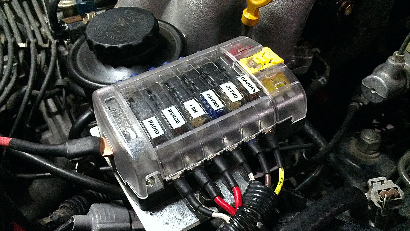

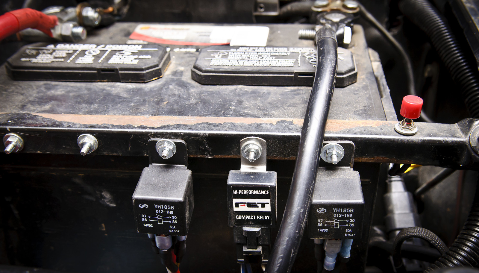

For wiring, I had it easy since I just used the existing harness from when I had the round lights. This light bar actually came with a full harness, relay and switch which I didn't use - most China light bars don't include this. Wiring is simple just like any other set of lights. Ran the wire through the grill and mounted my relay here:
The power wire is fused at my Blue Sea block:
