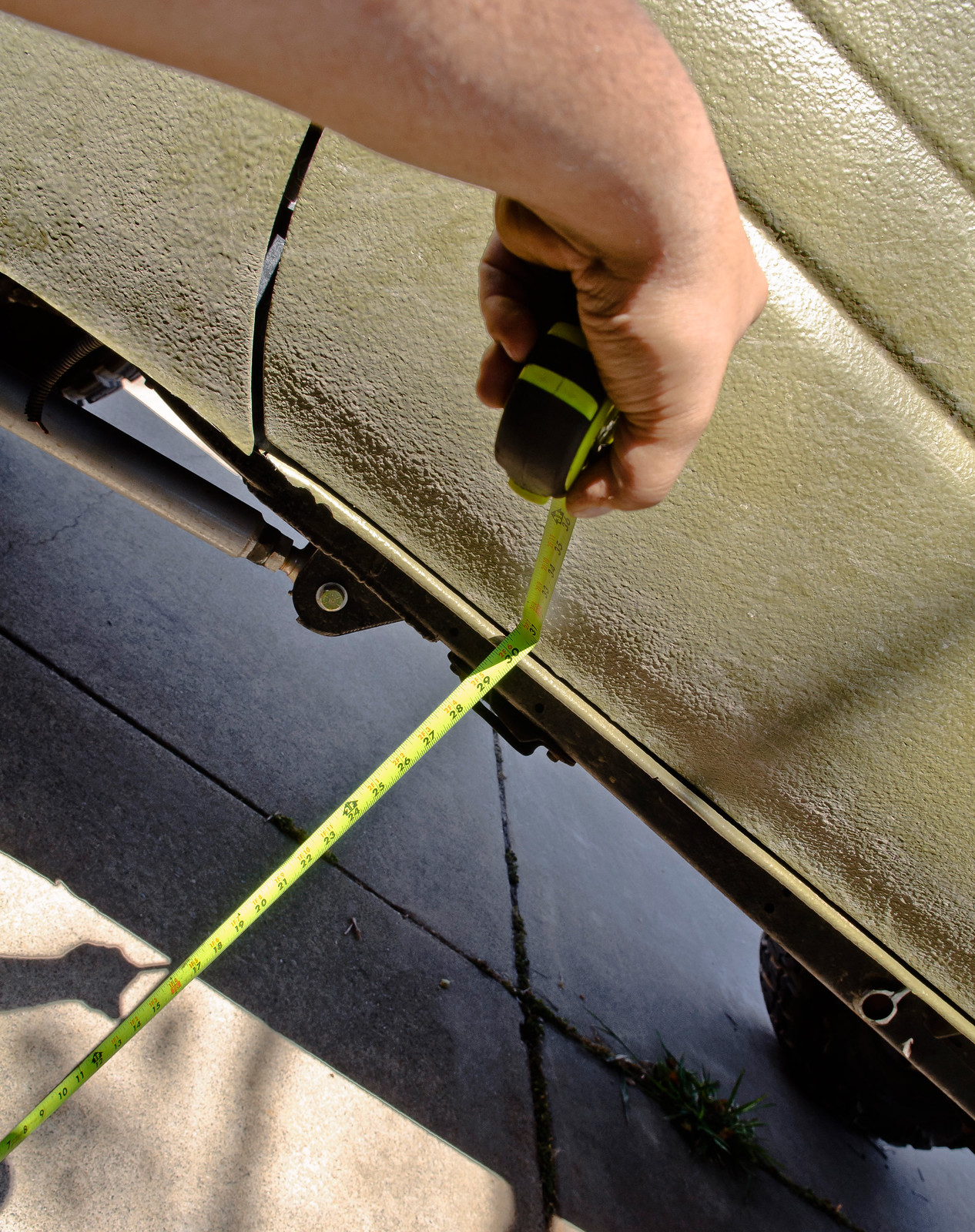

Today I finished the rocker chop on the driver's side. Went pretty quick. Used a grinder with 4.5" cutting discs and a sawzall for the pillars. I think I'm going to cap off the entire rocker area with steel plate then build my sliders underneath. I still want a slider attached to the frame as I'll be making some fender railing that will attach to the sliders and eventually an exo cage. So I need something tied to the frame instead of just welding the sliders to the rocker.
Loving the difference in clearance. It's really impressive when you see how much room there is under the doors now. So far I rolled the lip back under the rocker and it looks pretty good. I may just leave it like this as it looks quite finished.
Big difference
From the ground to the bottom of the door sill now is 30"!!!
And here's what it looks like after you cut everything away. I'll be sealing this back up, maybe with some 3/16" plate
It's up to you but I wouldn't think anything more than 1/8" is necessary to plate that area. I'm undecided on whether to weld to the body or frame. It's an endless debate but I'm not sure you'd want a cage tied to the frame anyway.
Big difference

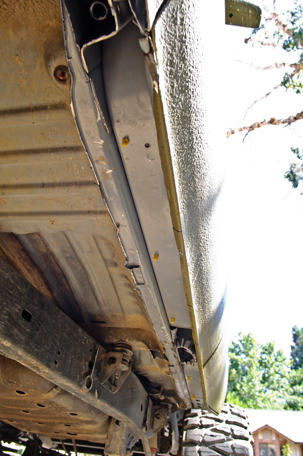

Thanks for posting these pics!!. I was wondering what it looked like in there. I had a 3rd gen 4Runner that I dented the rocker on before I got to put sliders on. I ended up cutting the rocker out just as you did under the doors except I left the pinch weld area. I welded in a piece of 3x6 x3/16" rectangular steel tube the full length on both sides of the truck. It came out awesome and was hardly noticeable. It gave me something to stand on and you could use a highlift anywhere down the side of the truck between the wheels without hitting the body. It looked really clean and had as much clearance as no rocker guards. i put them to good use a few times with no movement whatsoever. Anyways I have a rotted spot on the rocker of my 80 and was thinking about doing the same thing I did on my runner. But wondered what was under there and if I'd run into any issues. Thanks for putting that worry aside. Lol. And as always your truck looks sick!! A beast!!
I think you are a smart man for considering an exocage as soon as possible. With the way you wheel this thing it is only a matter of time till you roll it and an exo really would save you from major damage. I would hate to see all your work damaged. Cheers to your ingenuity and awesome build!
Thanks for these pics! Makes the process to do this pretty clear. After seeing these, I almost just headed outside and started cutting on mine myself, but then got to thinking about the cat and exhaust routing outside the frame on the passenger side.
