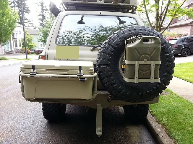

Great thread! The best thing I ever did was to put my cooler outside! The whole family is happy! An extended 40 gallon tank and a 5 gallon jerry is all I need to get there and well, refuel and back!
What do you do about taillights? They both look covered.
Great setup, always a treat seeing pictures of your rig! I have a big Pelican ice chest mounted inside on a drawer slide system, but having the ice chest outside is a really convenient. I'd done that on my previous bumper for short day trips to the lake. I'll have to do it again with this one, just a matter of finding a smaller ice chest that fits.

Thank you! The feeling is mutual! I ended up going with axe and shovel up front on the bumper with the jack in the front, also. And, a front receiver hitch has made moving the boat and RV easy! :)

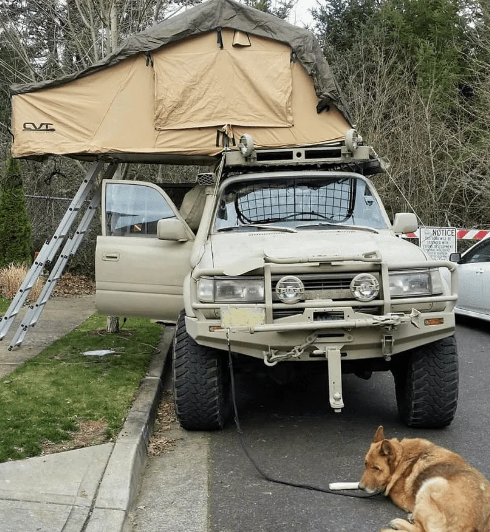

I feel like with two kids and a German Shepard I have to keep moving stuff outside the LC. I need a kennel mounted to the rear hitch. My wife says it will fly with the cops and someone will call. I have seem some pics on the net of rear hitch mounted kennels. I got the tent because we ran out of room in the back. Any thoughts on the kennel on the back? ;)
I'd put a child in a kennel in the back before I'd put a dog back there...
OK, I wouldn't actually put a kid outside like that. I just don't like the idea of the dog being out of the vehicle.
HA! Didn't Romney do this recently? I mean, I don't see is that big a deal since many people ride with dogs in the bed of a truck. But I don't see that going well with the general public. I imagine they'll call the cops right away and probably vandalize the truck. People be crazy.
There are plenty of dogs on flat open beds without a leash and no issues, but that's in the country! I know in the future I will be pulling a small trailer with the dog and other stuff to avoid PETA issues. I know he would love it, because he loved riding in my Tacoma in the kennel. He was never allowed to be on a leash or run free back there. A sudden stop and he would fall out, so the kennel secured to the bed was more safe. He would sleep during most of the trip. He is an old boy and it is hard for him to even use the ramp I have for him to get into the LC. A kennel would allow him to get in and out easily to breaks. As it is, tree hugging idiots hate my LC. A Dog kennel in the back would only draw more unwanted attention. :) http://www.fiber-pro.com/page3.html
Yeah I'm sure the dogs would love it! My concern though, how would one of those kennels hold up if you get rear ended by the mayhem guy in the Allstate commercials? I could see the headlines on Facebook already: DOOMSDAY PREPPER WITH MILITARY HUMMER ROMNEYS HIS POOR DOGS
Trailer seems like the best option.
Rear collision and spray from puddles, mud, debris on dirt roads, dust on dirt roads, and possibly exhaust getting in there would be my concern. It doesn't seem like a good place for a living thing. The fiber pro looks like a well thought out product so maybe it takes everything in to consideration. Maybe build a longer ramp so the grade isn't as steep for the dog?
With my lift the ramp will have to be 25 feet long!;) I think a trailer is in my future. It is a little more than the fibrr pro but i can put other stuff in it. Of course, she will be khaki.:)
