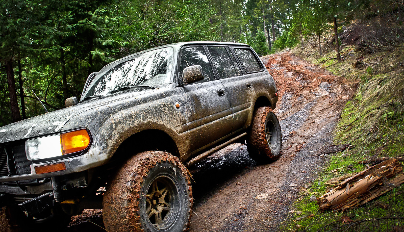

All this body work is depressing. I needed to take the truck out. Bolted the lights back on and went to play in the mud. This was at the La Grange OHV park and some random forest roads in the Stanislaus National Forest.
