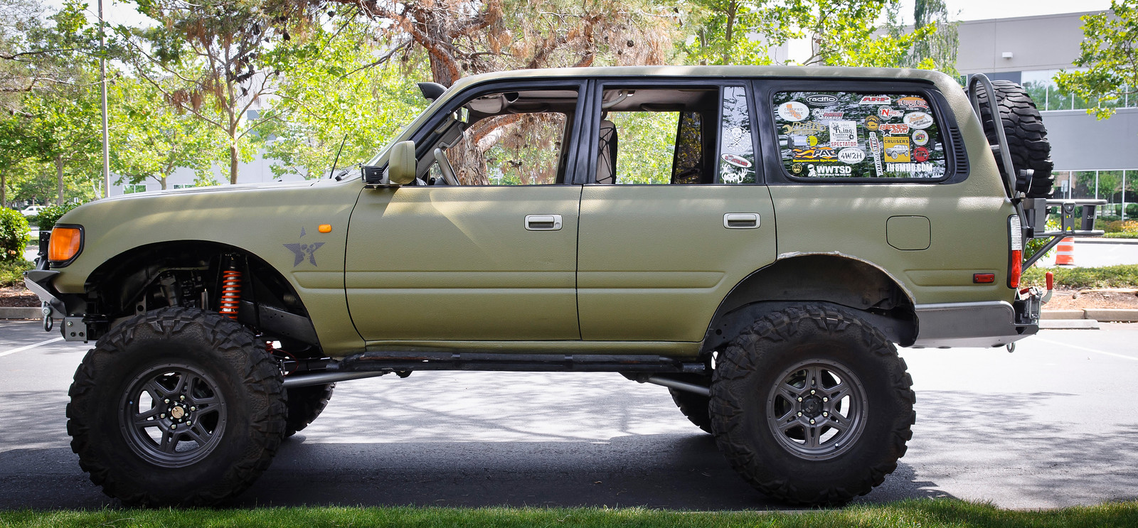

This weekend I took care of the rear end. Installed the 5" OME Comp coils and the 2.5" Radflos. Suspension feels MUCH better now. Old shocks were total crap. And the Comp coils are not stiff at all. Just a firm, non-floaty feel which is what I was after. Also painted the wheels and gave her a bath.
Comparison of the old, shot Bilsteins
And the coils
Fresh and clean. I think it's been a year and a half since I washed this thing

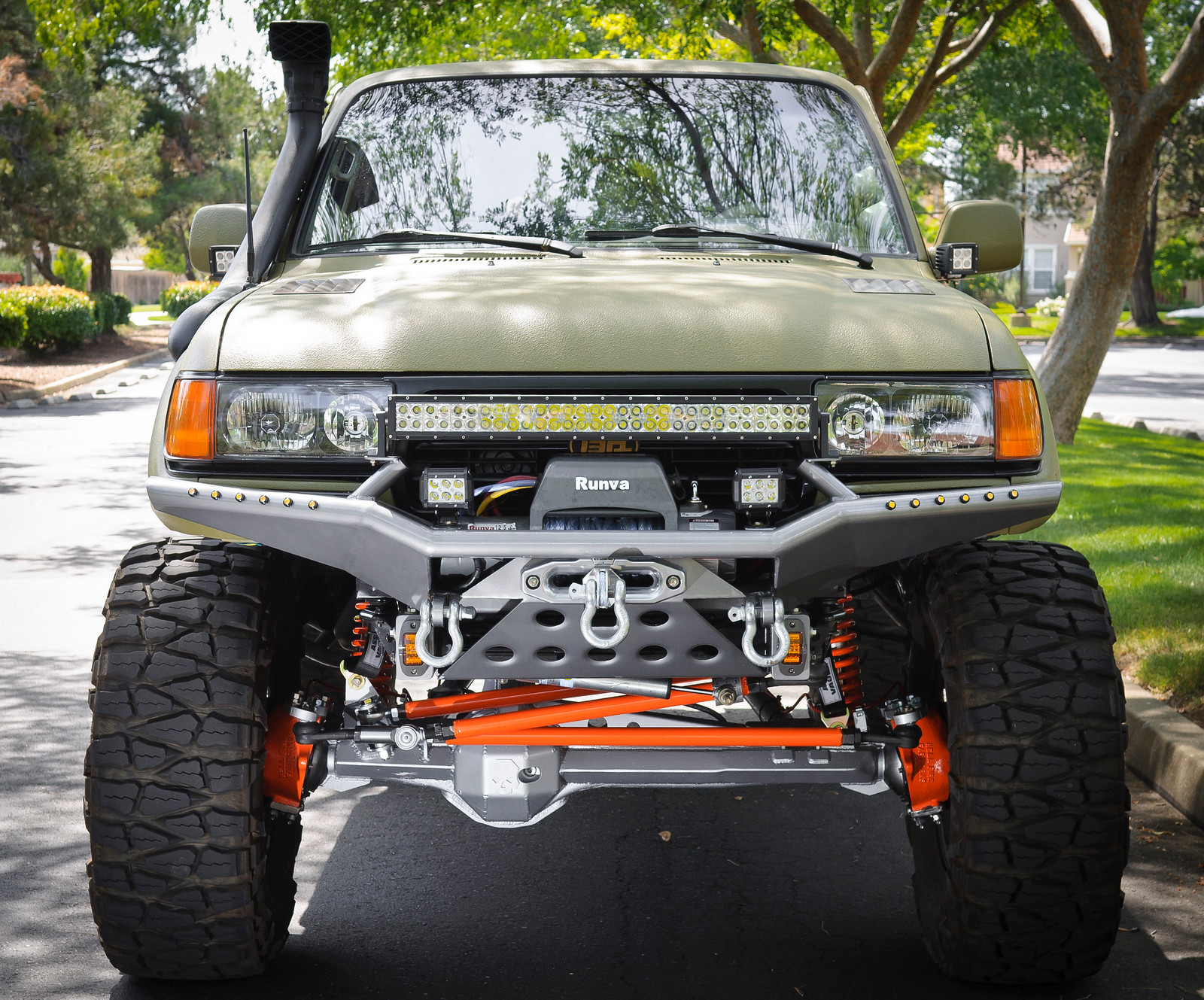

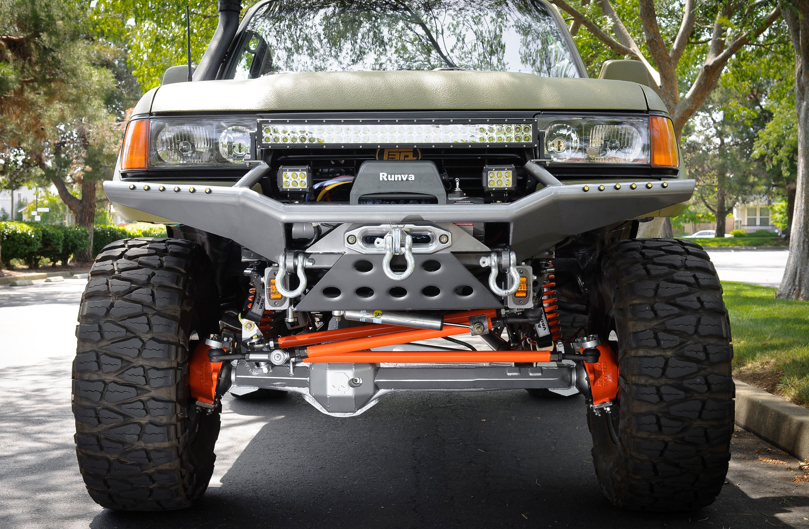

Nice visual of how flat the new front links are vs the back
Looks like art work from the front! Great work. Bet you can't wait to test it out on the trail. Can't wait to see the pics!

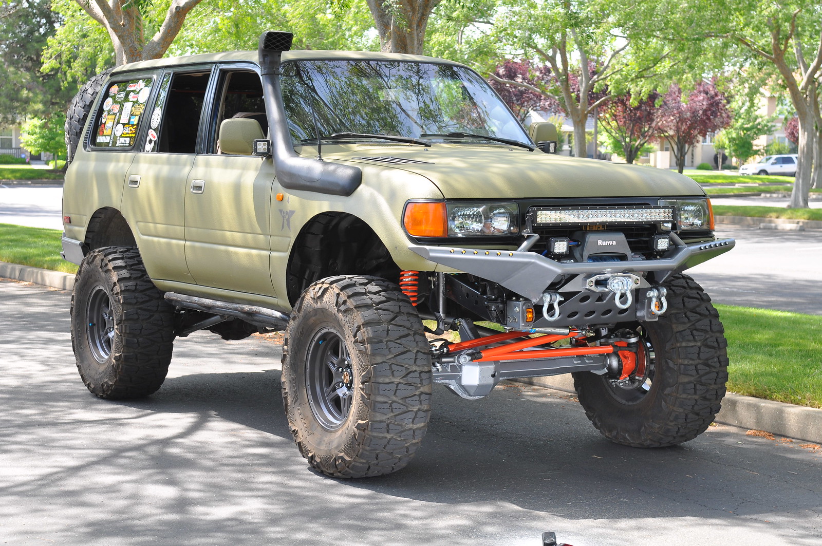

I did do some more bro-crawlin last week after messing with the dual rate sliders. It's easy to see why guys with linked 80s say how bad the rear suspension becomes after you link it. With the stock radius arms, the front is so stiff that it forces the rear to do all the flexing which gives you the false impression that the rear suspension is awesome. NOT the case.
In this pic you can see that the front flexes so well now which means the rear isn't even doing anything because it's not being "forced to" by the stiff radius arms. I still had plenty of down travel left in the Radflos but until the front was maxed, the rear isn't gonna flex.
