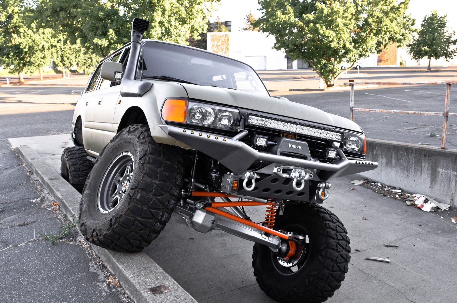

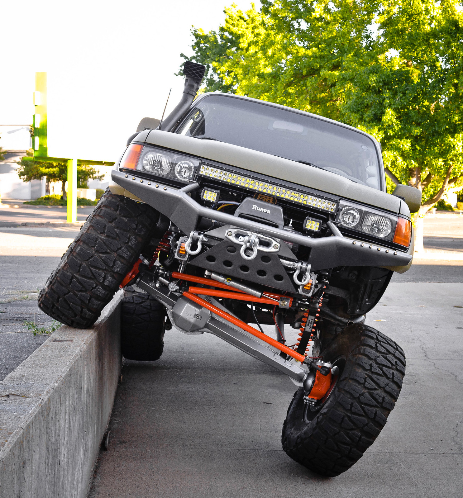

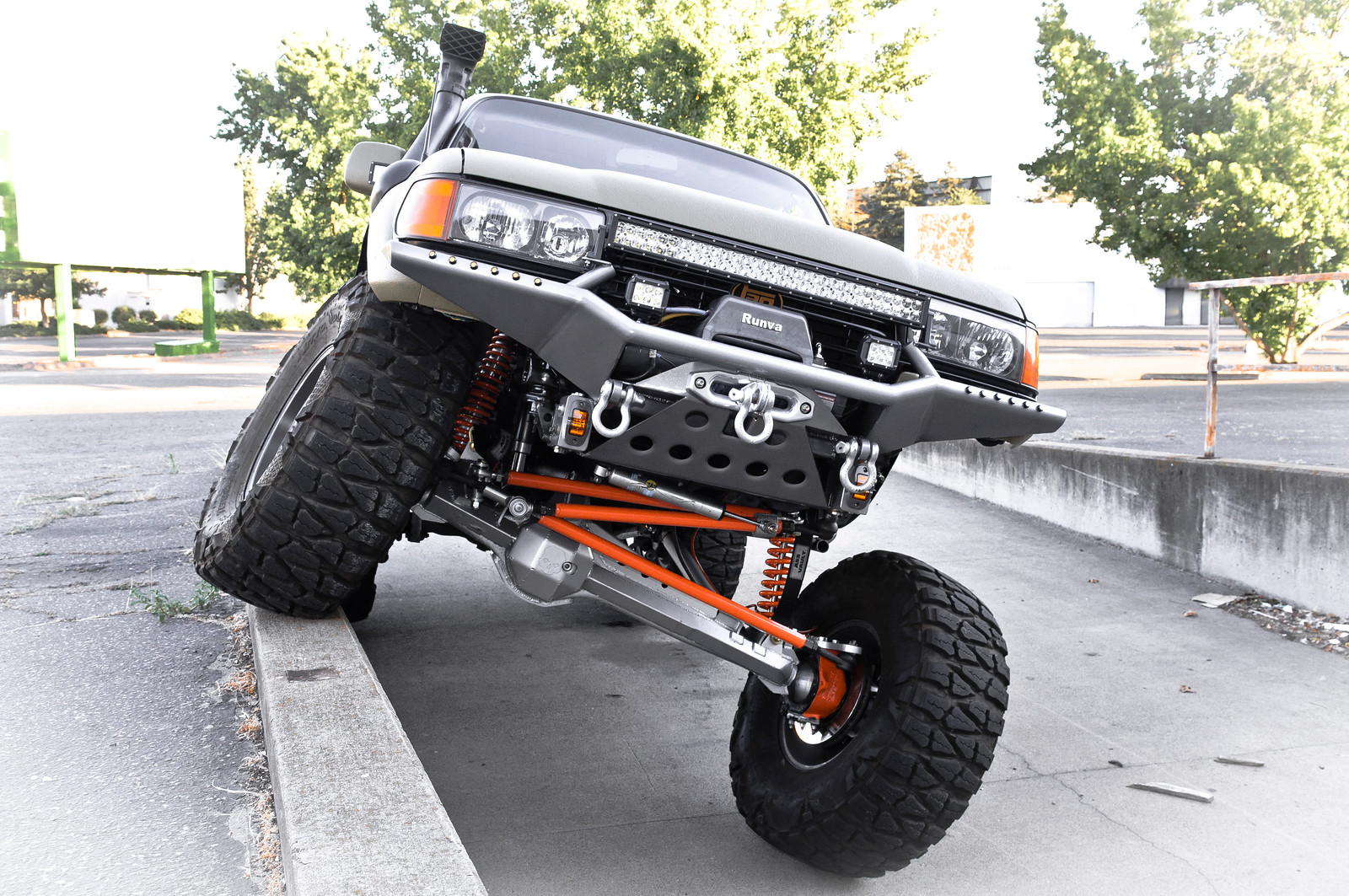

Hoping to do an inaugural wheeling trip this weekend, but in the meantime urban crawling is a highly underrated sport. Don't need to pack food or tools or spare parts. Don't need to drive for hours. And don't need to fill up the tank :flipoff2:
For educational purposes I should come replicate your pics to show your flex vs mine in the same situation and location.

I think you're kinda scared to take it out now that it's all purdy! :princess:
It was a lot of work to do all that painting!

When you coming on down? :)
