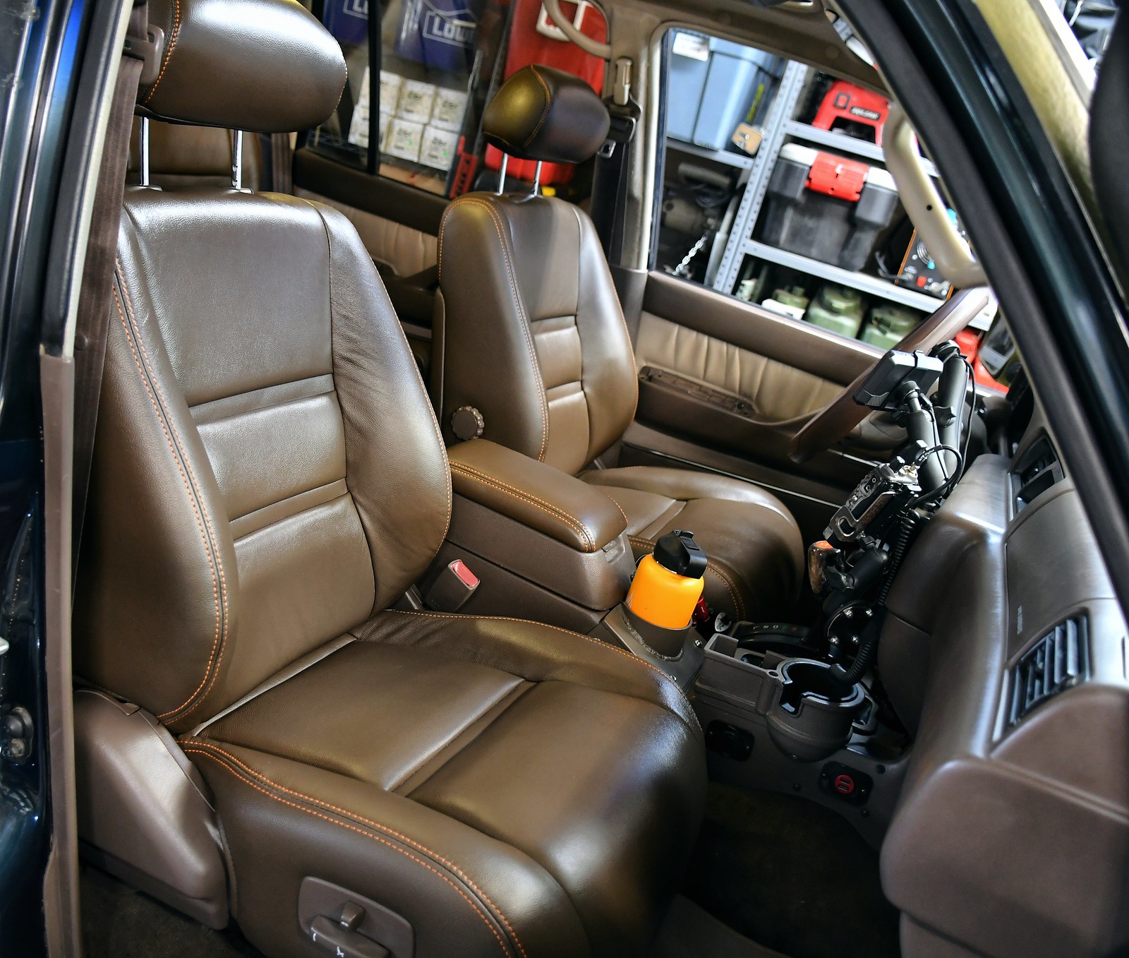

Leather has finally arrived. It's so beautiful! Had to wait a few weeks for the brown color as it was out of stock. After much back n forth, I decided to keep it simple with single-tone and a simple contrast stitch in orange to match my truck's accents. Really happy with the color choice. Pleasantly surprised to see it includes armrests, center console, AND door panels. Was not expecting that. Can't wait to get it installed :cheers:
SEATS ARE DONE!
Dropped off the seats and parts and had them back in about 2 days. Local installer was Bullet Audio Sunroofs & Leather in the Sacramento area. Roadwire sent us the incorrect pattern for the armrests hence why those are missing in the pics. Should have them back in a few days. First impressions, the quality of the leather is fantastic and all pieces are very accurate. Looks as OEM as possible for being aftermarket. I do have 2 minor complaints with the kit:

SEATS ARE DONE!
