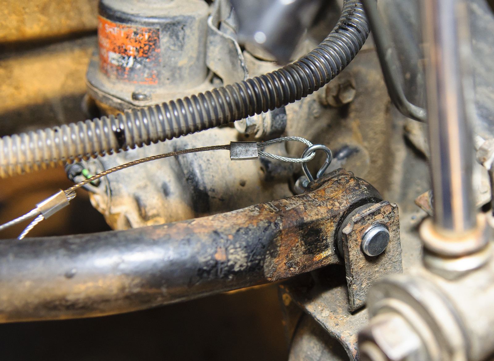

In an effort to make the stiff ass front end flex a bit more I decided to fab up some sway bar disconnects. Credit to Phil because I kinda stole his idea :) And MaddBaggins for his idea on the tab welded to the frame. Probably spent about $7 in metal and hardware. Not bad! Made some simple tabs welded to the frame to hold the sway bar when it's disconnected. Bird turd welds FTW!
Disconnect on the driver's side, 3/8" diameter
Clearance is tight on the passenger side because of the e-locker and brake line bracket. Used a shorter 3/8" diameter clevis pin attached to the sway bar with some steel cable like in Phil's design.

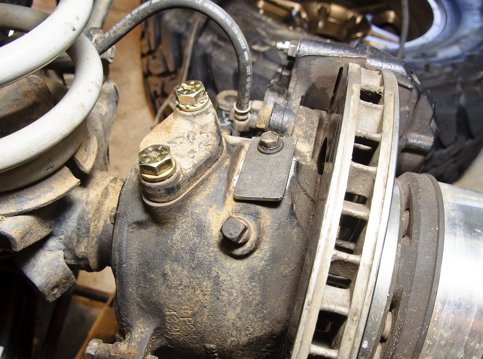

Since ABS is history I also removed the sensors and the wiring harness. Nice to have all those stupid wires out of the way. Used leftover scraps of metal to plug up the hole. Used some gray gasket sealant around the hole to keep the elements out of the knuckle.

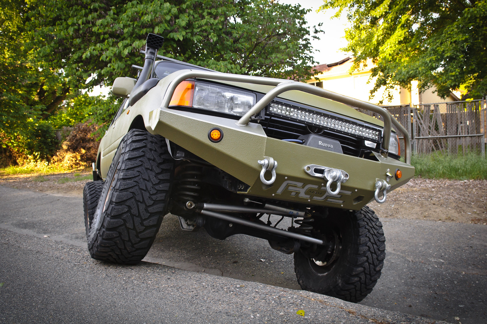

Results? MEH. Wasn't that impressed. I didn't take any official measurements before and after but I really didn't notice any difference in the way the truck flexes up front. The rigid radius arms don't let the axle go anywhere. That thing stays parallel to the body at all times. Perhaps if I had a forklift to measure wheel lift before and after, but using this poor man's ramp I found locally I did NOT see any difference at all.
This is with the sway bar connected. You can see the axle is parallel to the body with no flex whatsoever. These things are STIFF.

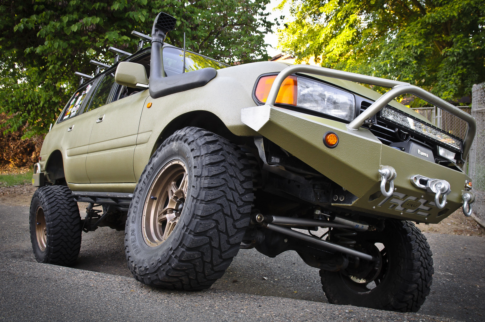

Had the camera set on a tripod so I could get accurate before & after pictures. I didn't even post it because it looks EXACTLY THE SAME! You'd swear I took two photos back to back. So I repositioned the truck on the ramp and drove it up until I ran out of room. Didn't even get the chance to have the rear tire come off the ground. I'll need to find a better place to test.
All 4 tires still on the ground
Tire was rubbing the fender at this point
So to summarize, the sway bar does very little to limit articulation of the front axle - in my experience.

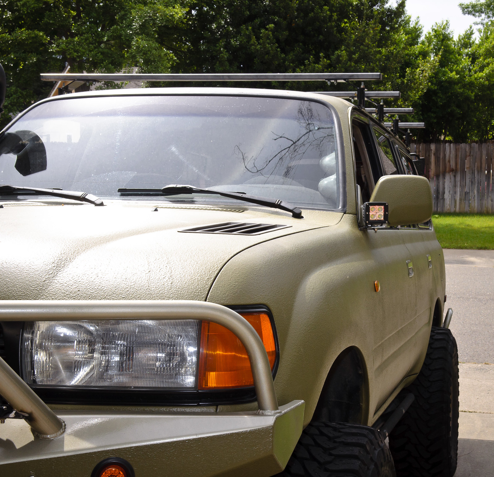

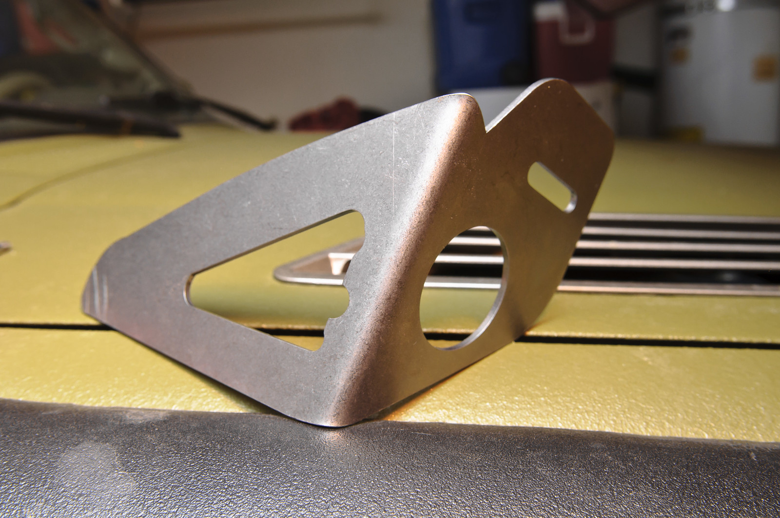

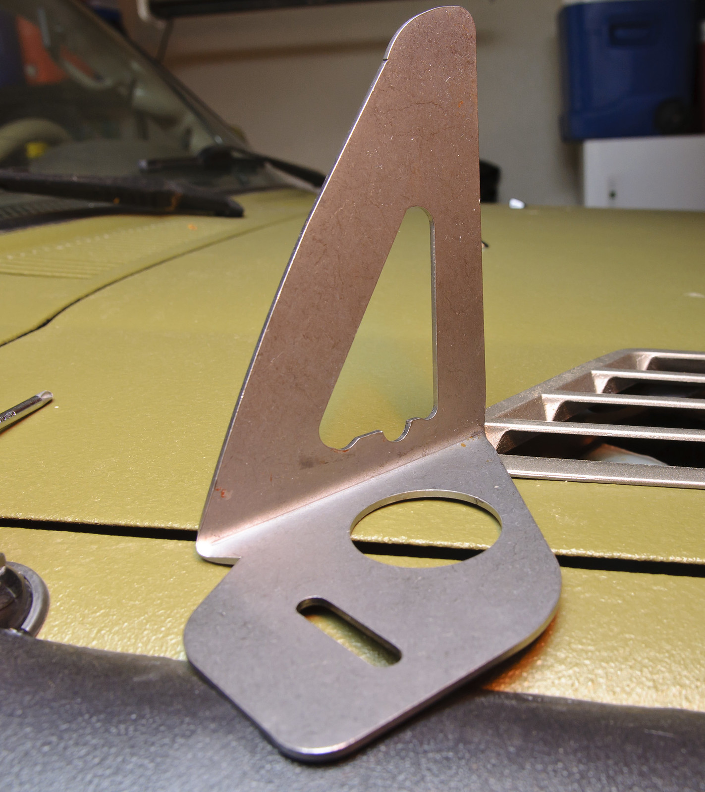

First up, gotta give it to @SoCalFrank for showing the 80-series market some much needed love! For those following the discussion HERE, I was looking to get some ditch light brackets like those made by CBI for other Toyotas. But they won't make anything for Land Cruisers. So I reached out to Frank to see what he thought. And sure enough delivered with an awesome mount that I think a lot of people will like.
Before I get into the details I'll let Frank comment on pricing, ordering and availability. I imagine he'll do production runs just like his antenna mounts.

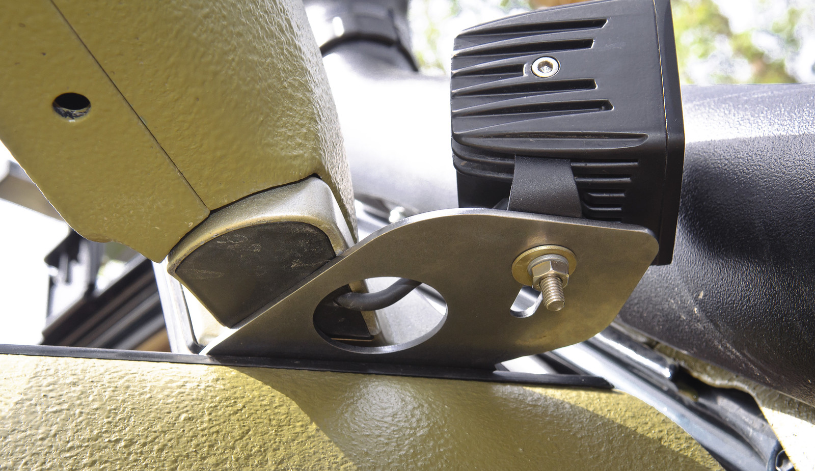

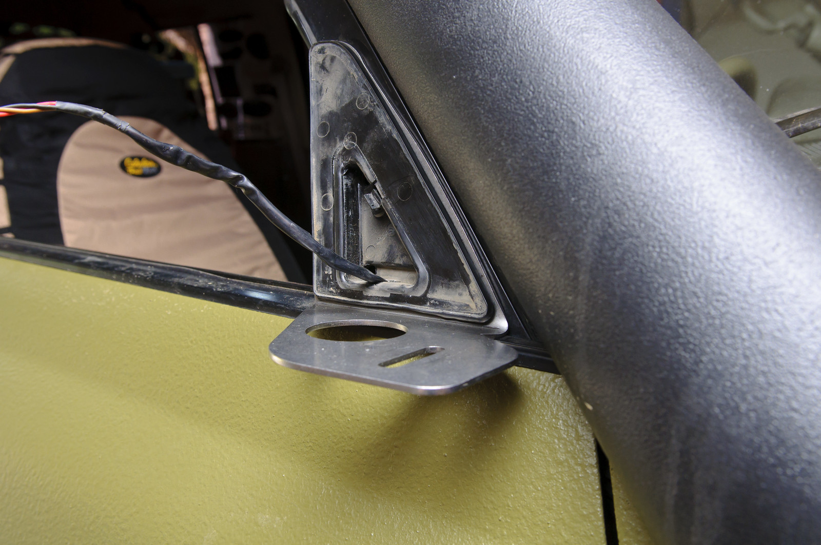

The brackets sandwich between your mirror base. Installation is simple, just remove the mirror, install the bracket and put it all back together. This thing is SOLID!
For wiring, the cable goes back into the door following your mirror's wiring. After that you're on your own. I just dropped the wiring into the door panel. I'll figure that out later.

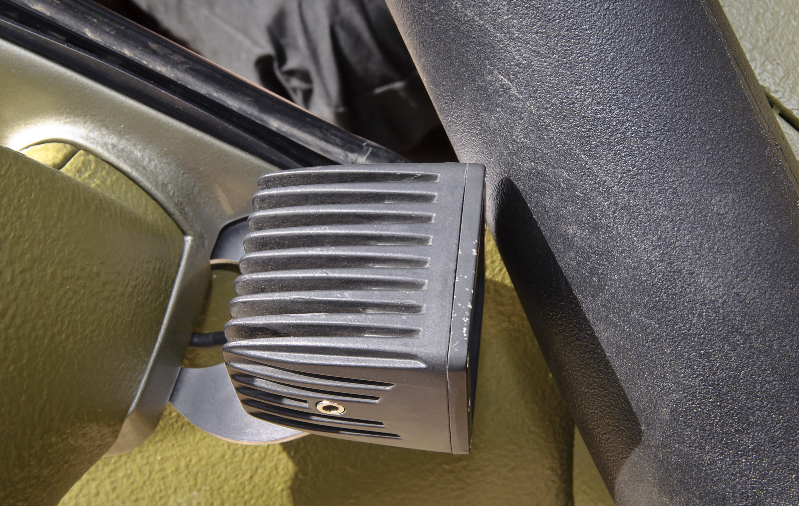

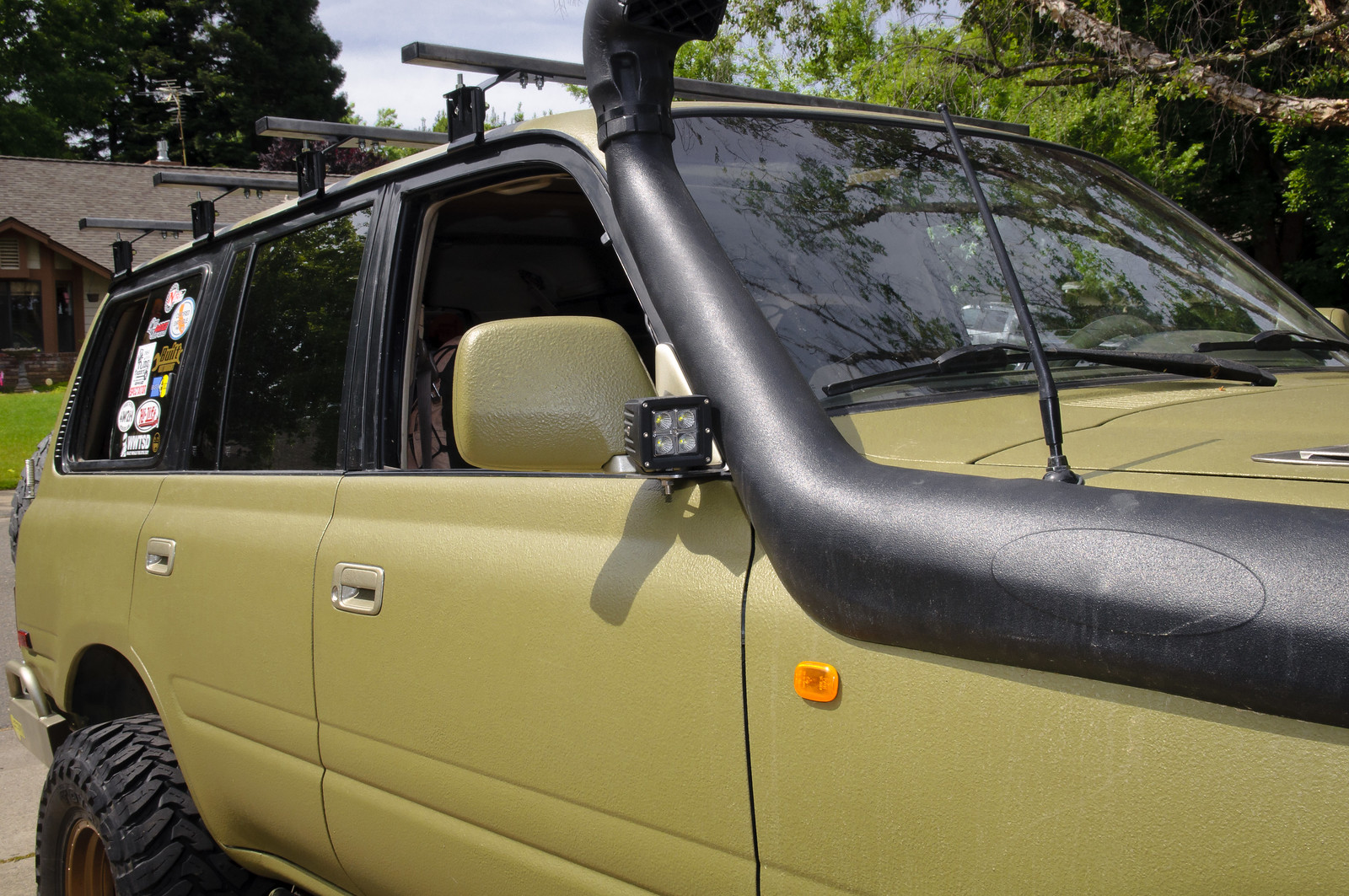

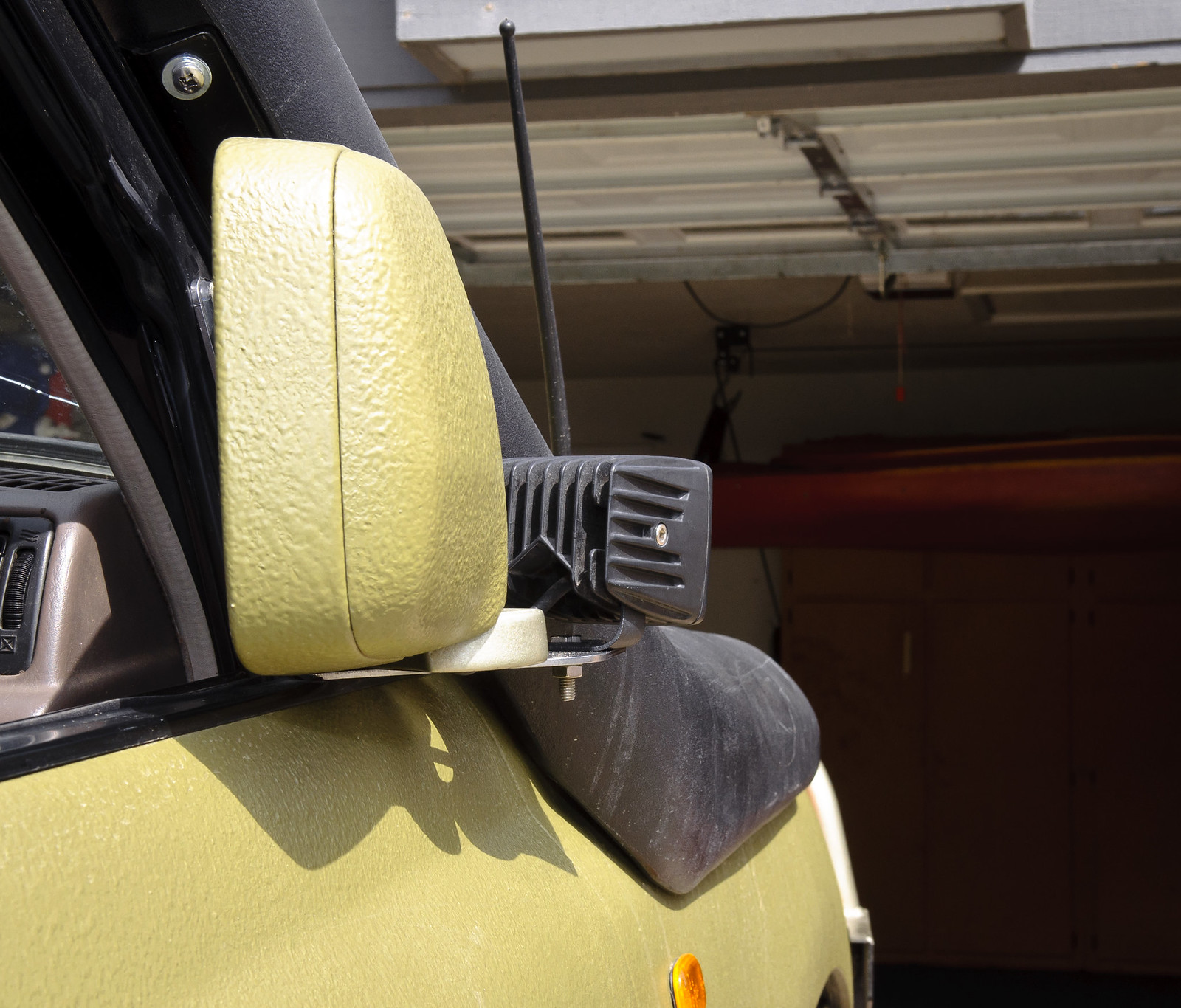

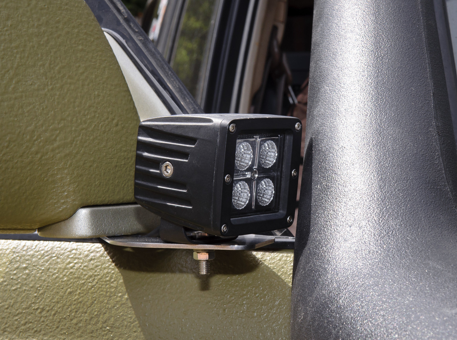

My main concern was how they'd fit with the snorkel. But they fit great! Just keep in mind if you have a snorkel you can't aim the light straight ahead. It has to be angled off to the sides - kinda the point with a ditch light bracket anyways. I have plenty of light in front of the truck with the 30" light bar.

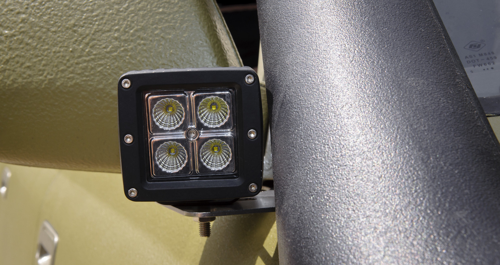

The brackets give you plenty of adjustability on where to put the light. On the snorkel side I went as far inward as I could without hitting the snorkel.
That position gave me just enough clearance with the door open.
With a snorkel, the light will stick out just a bit past the mirror when it's folded in.

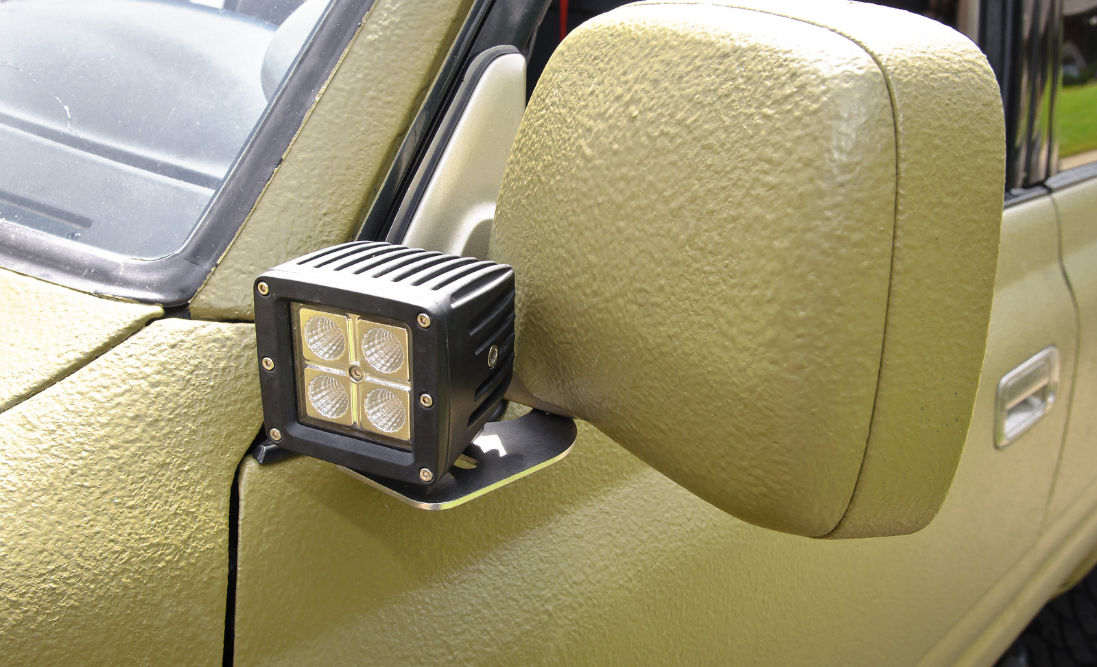

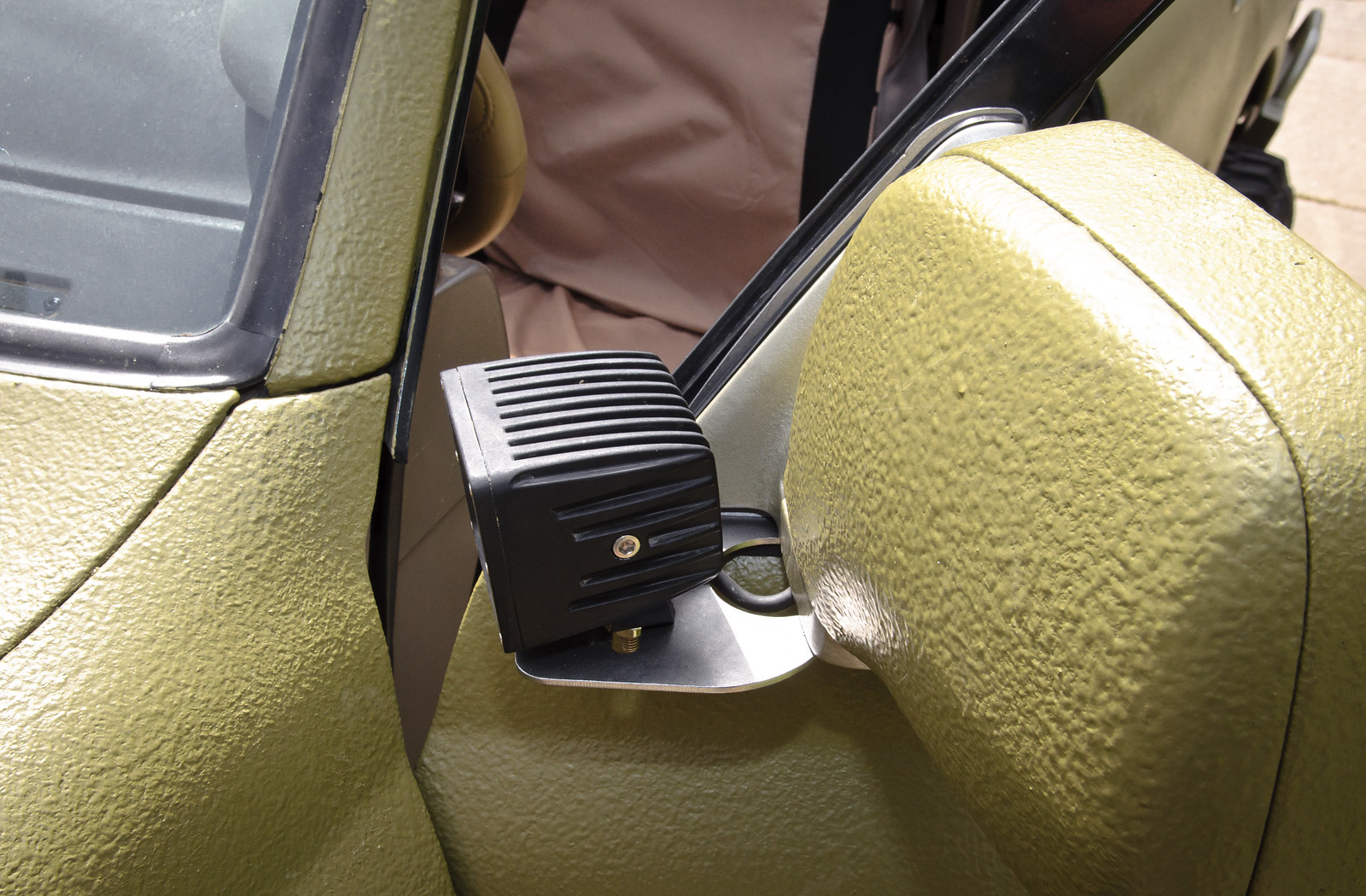

One thing to keep in mind, with these brackets you CANNOT fold your mirror forward anymore. This is about as far forward as you could go.

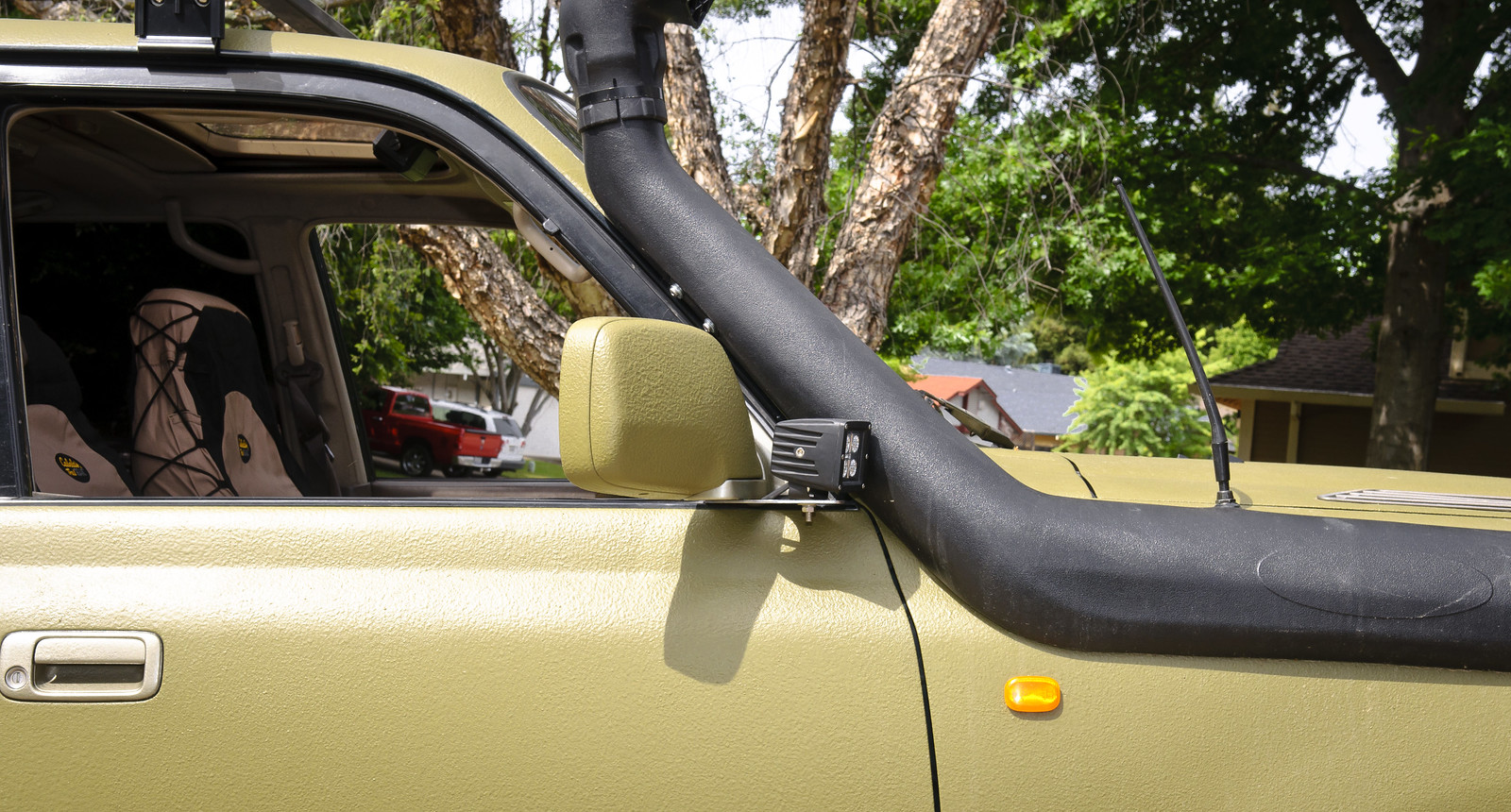

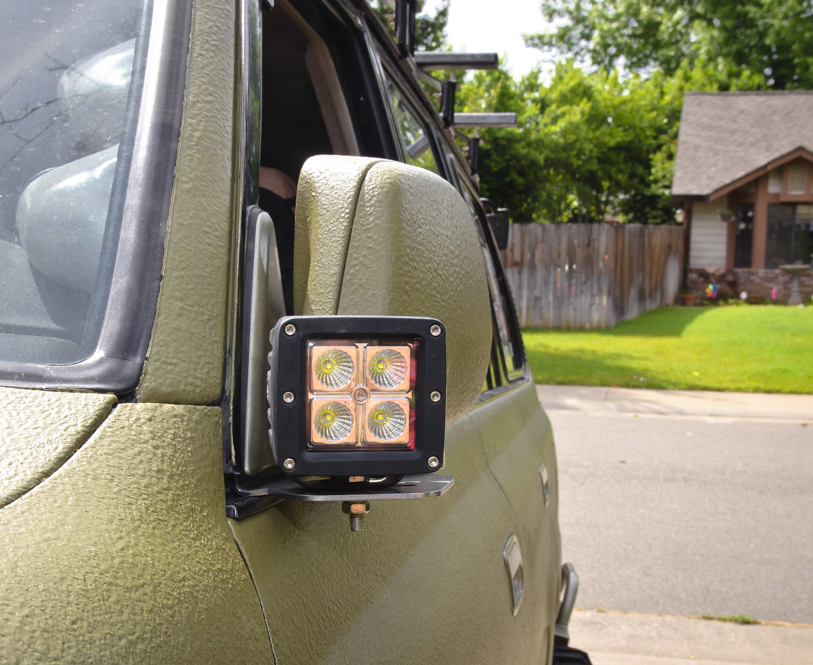

On the driver's side (or for folks without snorkels) you can put the light wherever you want, no clearance issues whatsoever.
And the light will be flush with the mirror when it's folded
