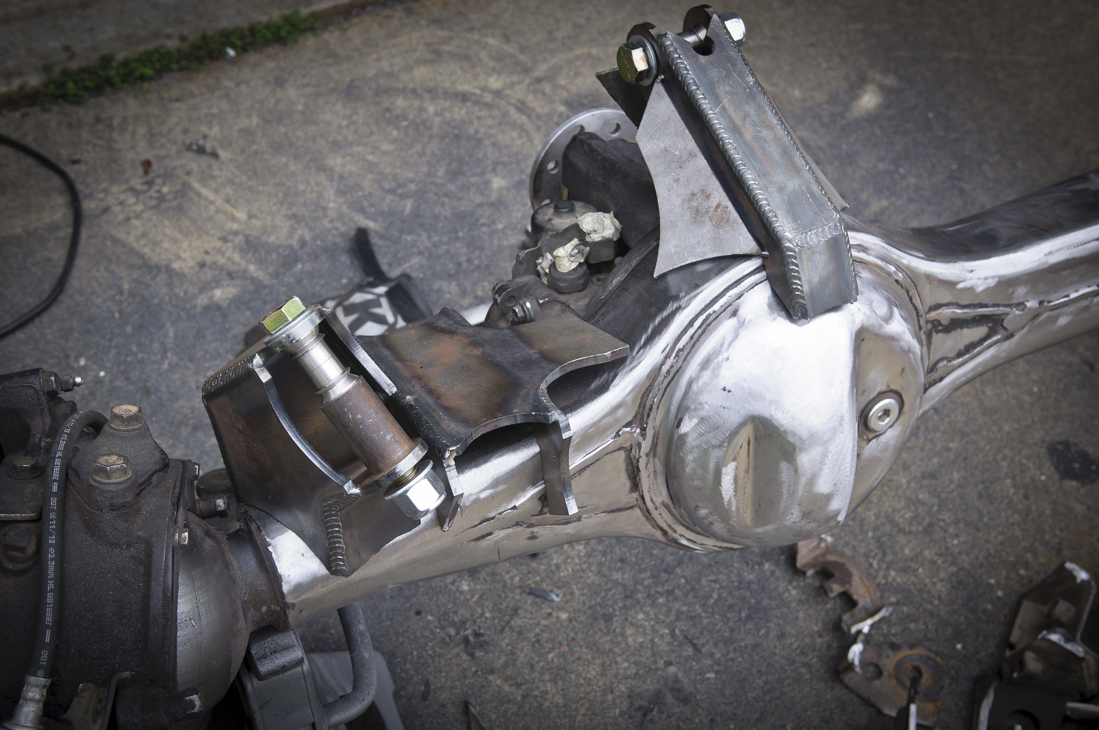

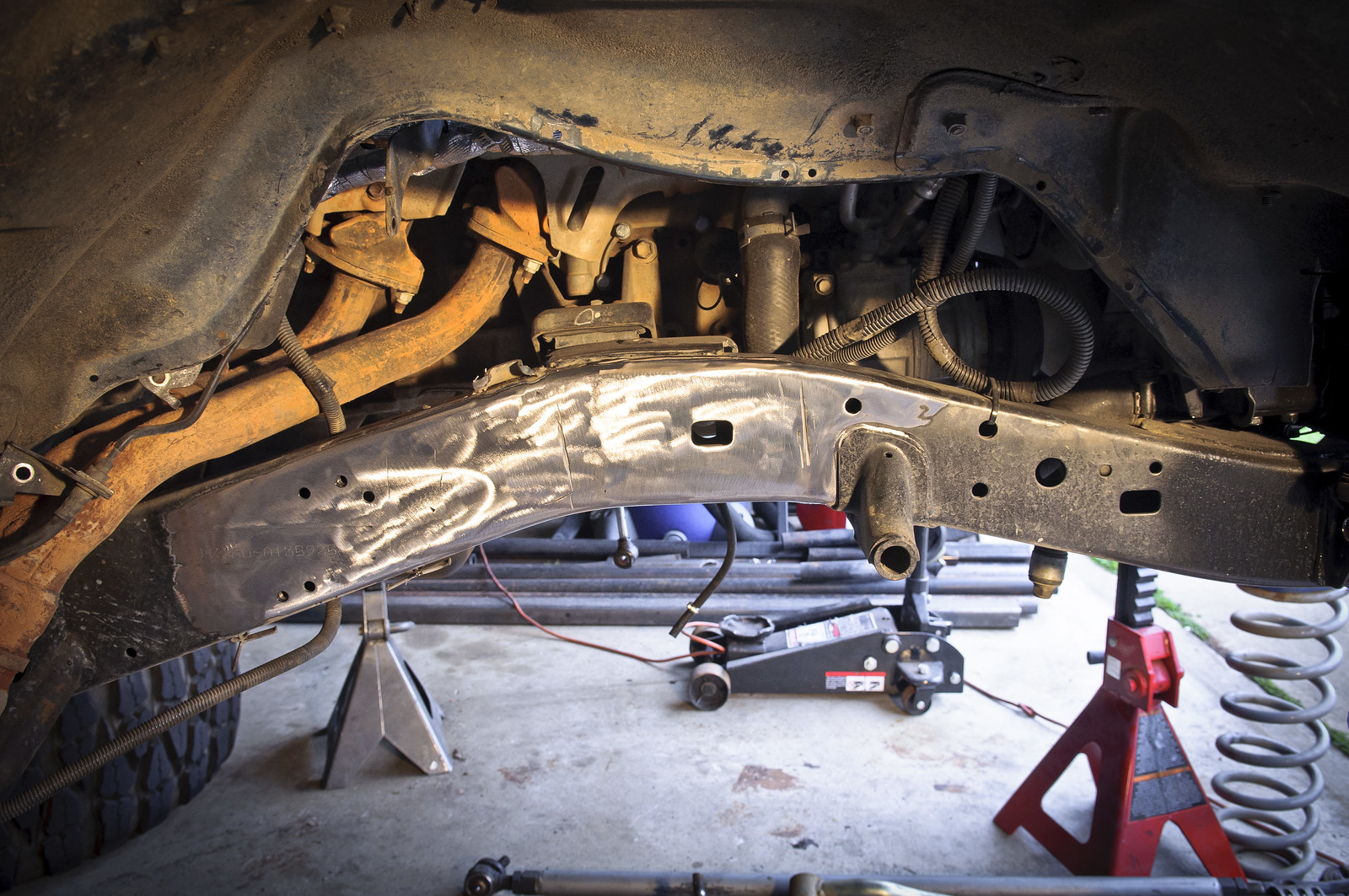

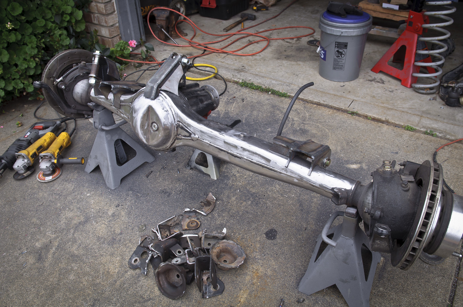

Made some good progress today. Things are going quicker than I thought considering I'm only using a grinder and a sawzall. At this point I just have the driver's side towers, panhard and 2 radius arm brackets to remove.
