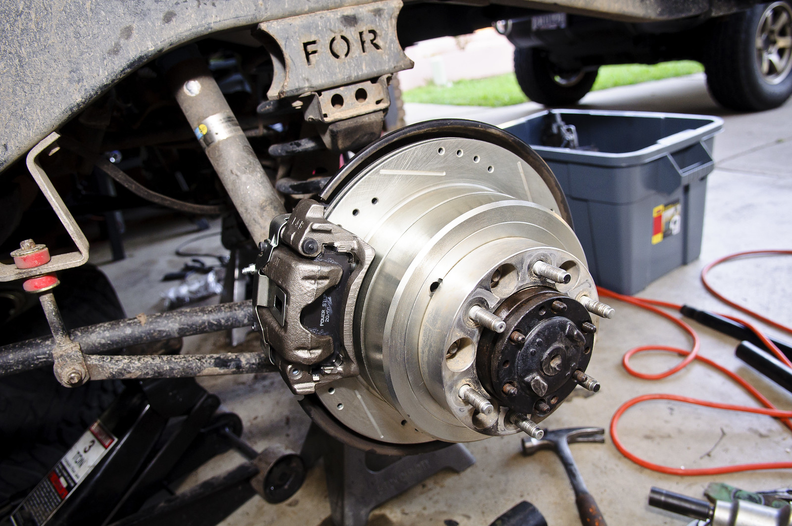

First off, rear brakes. A few months ago I overhauled the front brakes so I decided to take advantage of this while I had everything taken apart. Rotors and pads are the Powerstop K1156 kit. The calipers are remans from Advance Auto. They have a $40 off $100 coupon code and free shipping. Can't beat that!

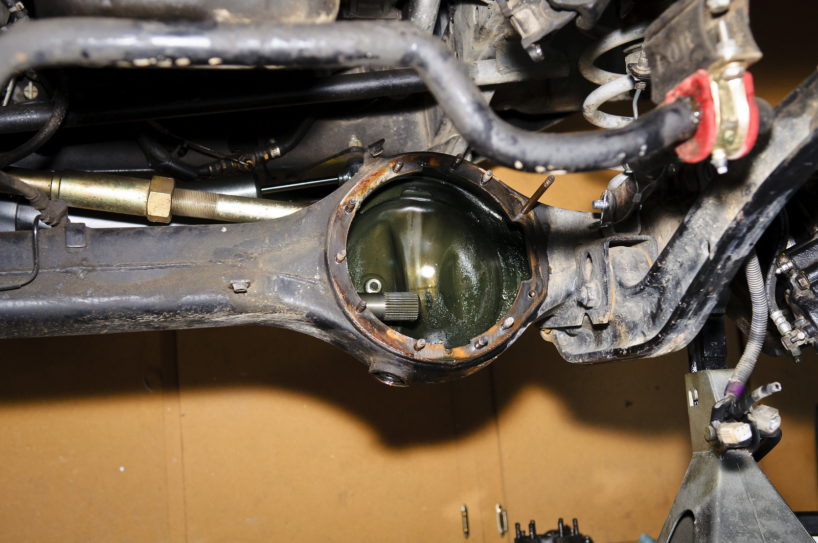

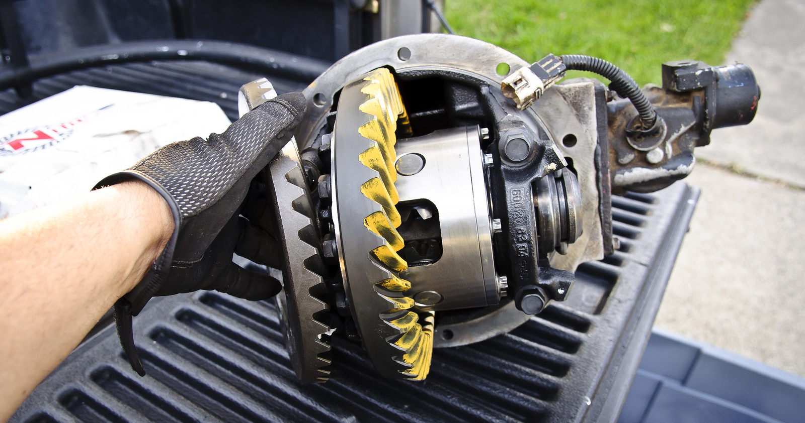

Here's a photo after the 3rds were removed. The rear 9.5" third is an absolute monster. To get it back in I set it on my chest and laid directly under the diff then 'bench pressed' it back into place. Fun times.
The rear third was done by a local shop and the front was sent to Zuk (Ken) since it's the more fragile of the two. I would have sent him both but shipping is a killer, adds about $200+ just to ship both ways.

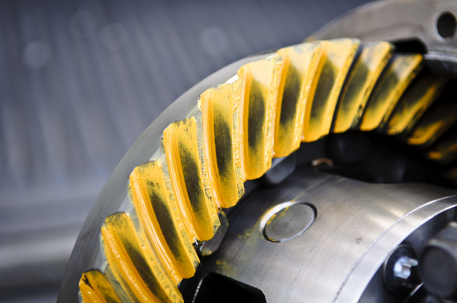

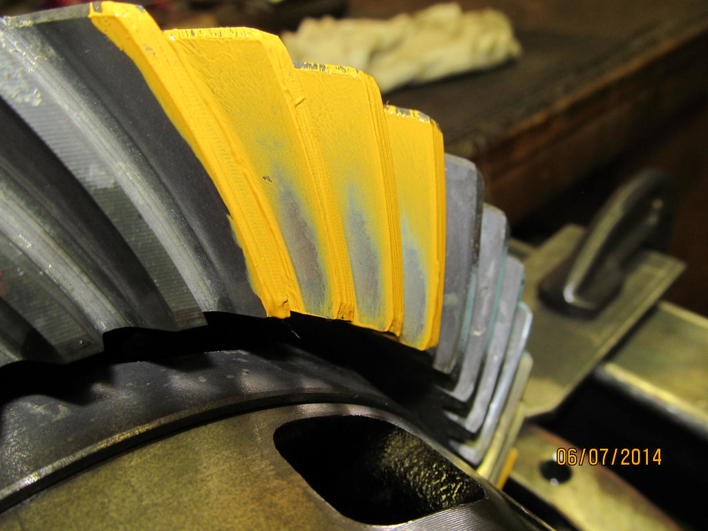

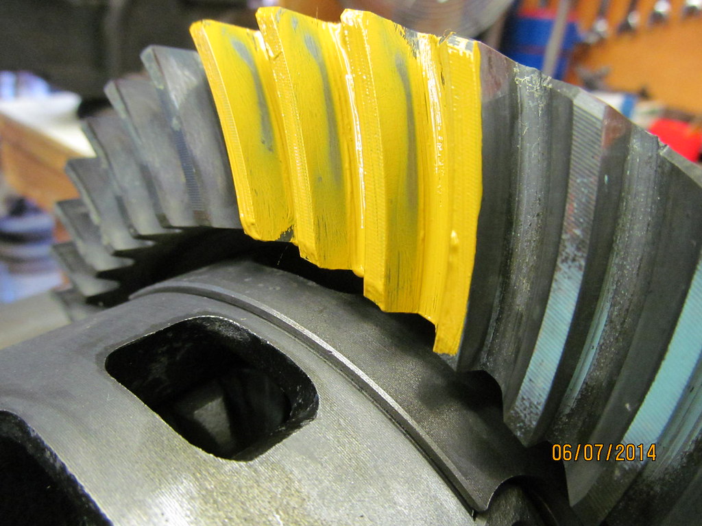

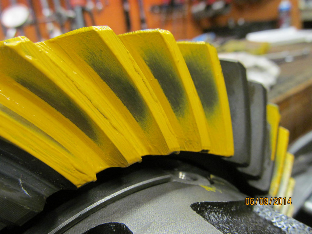

Patterns

Patterns of the stock gears....BAD! He said this is due to old worn bearings

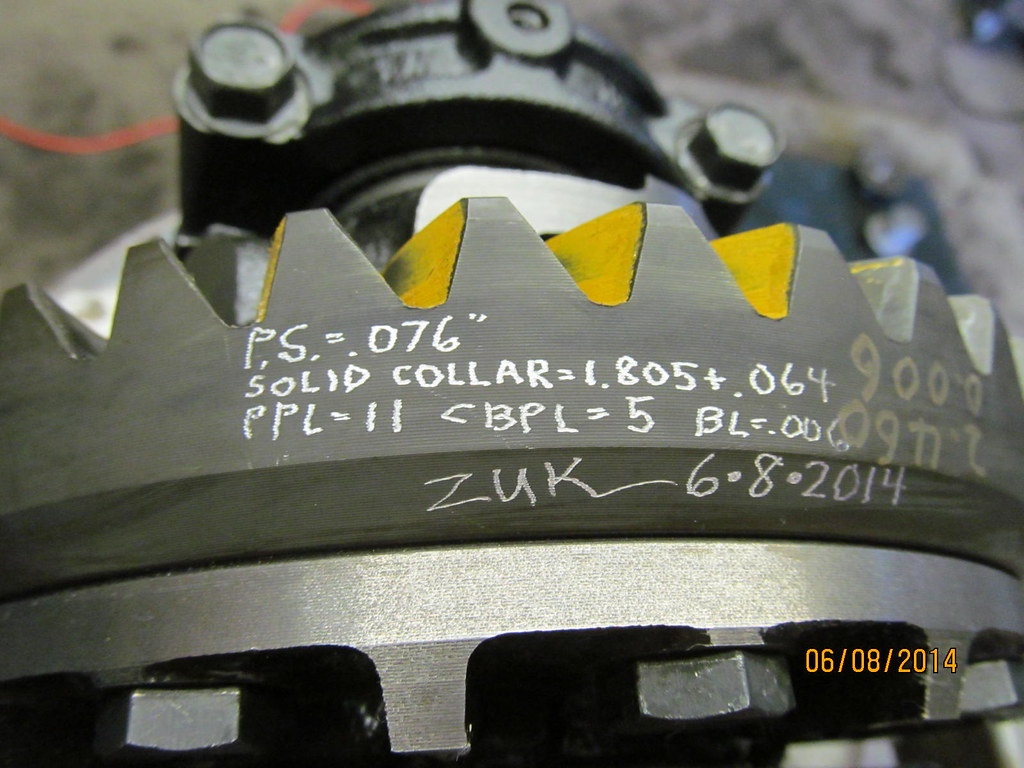

Solid collars were installed front and rear

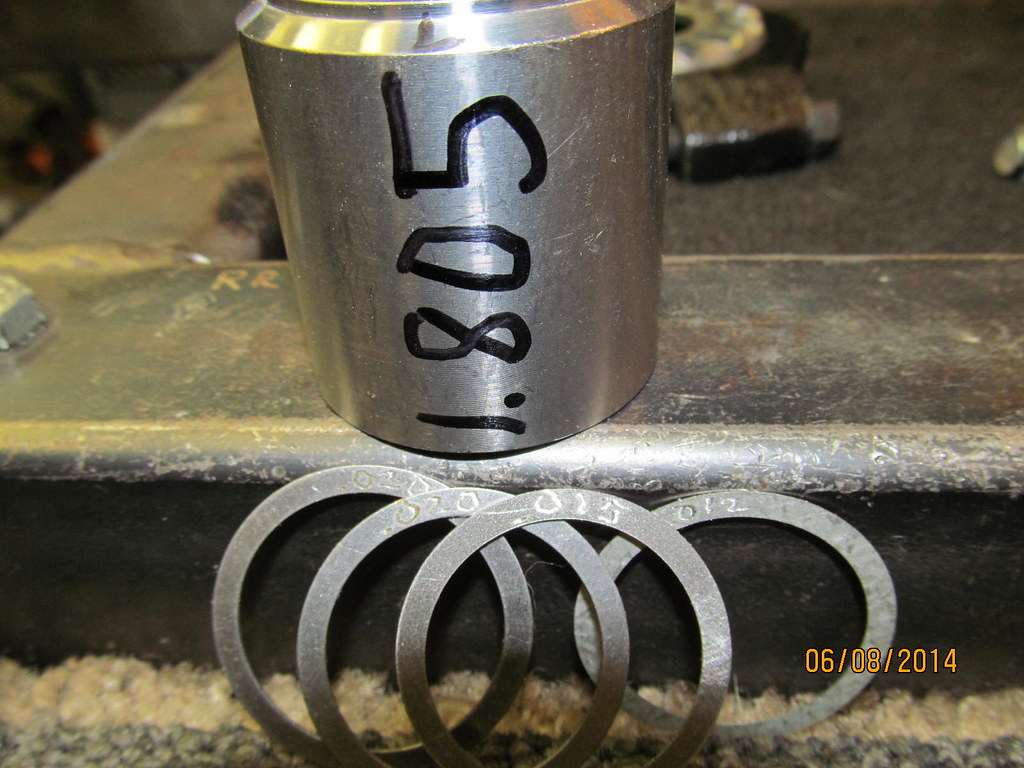

Ken's notes

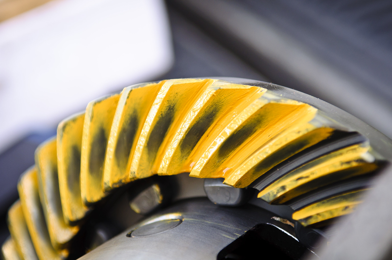

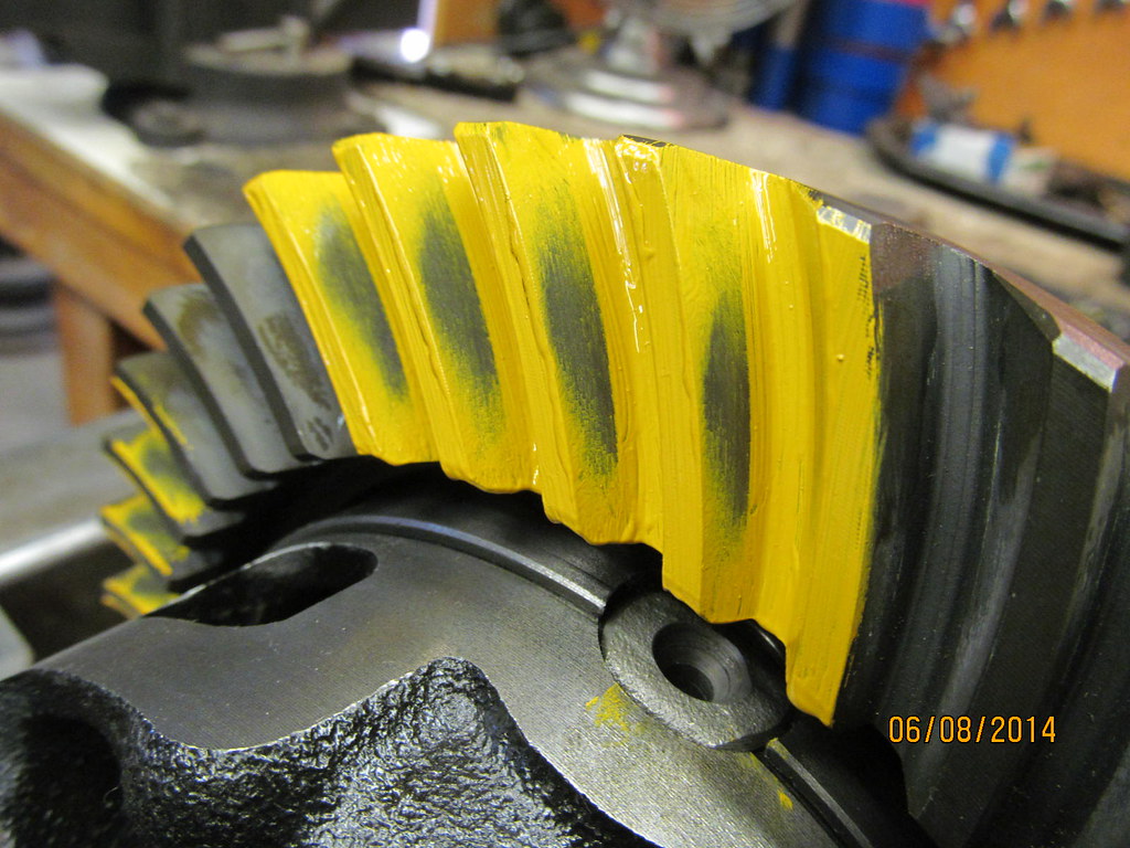

Final patterns...GOOD!
