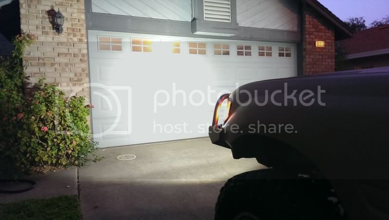

Thanks guys! I love the color too. Much better than OD Green. Not even sure why they call it green. It looks brown at all angles. This color is quite brown too. Didn't look exactly like the color chip I received but it still looks great.
Here's another pic after porting the front end together. Front bumper is two-toned with Monstaliner on the bottom half.
One I finish spray painting the rear bumper swingouts I'll get some high res pics!
Looks great! Ain't the prep work a mutha???
MONSTALINER!!!!!!!!!!
