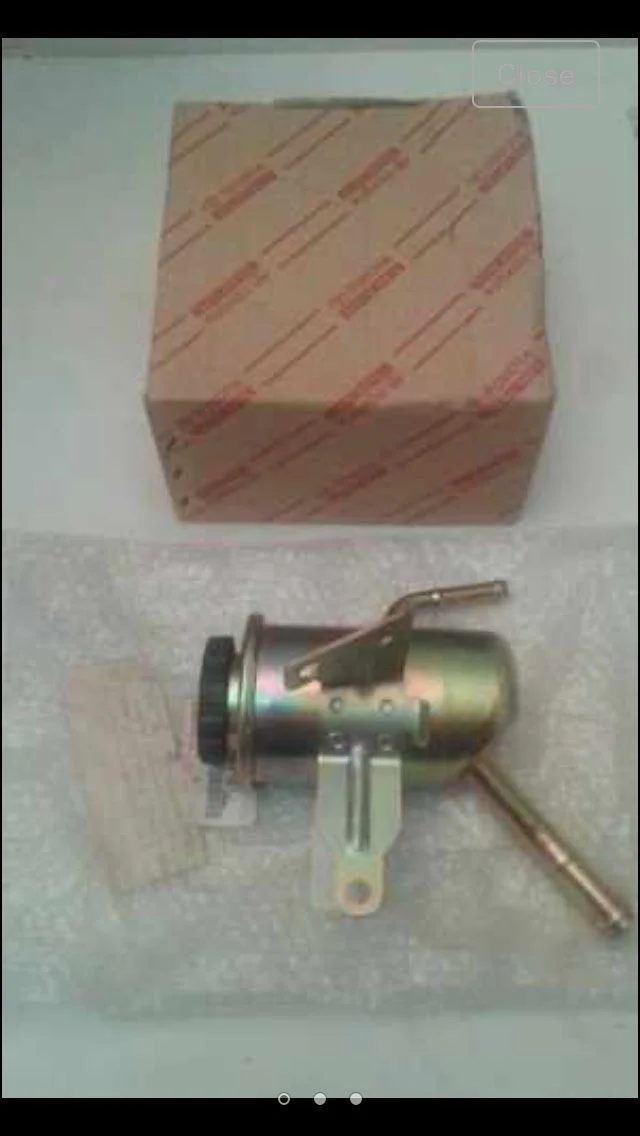

Mine looks very much like yours.

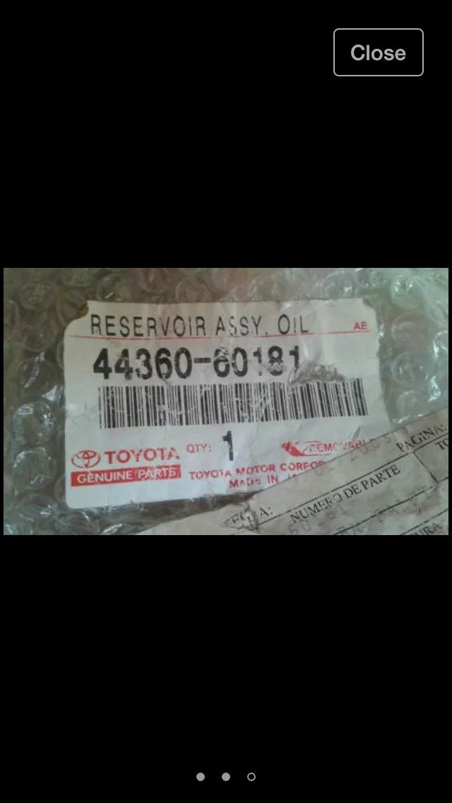

I found this one -cheap-online, from the picture it should be a direct fit.
View attachment 1143606w
View attachment 1143608View attachment 1143609
That looks pretty good! The one I got holds 1qt of fluid. And sorry I forgot about your PM. The reservoir didn't really need any modifications to make it work. You just have to figure out the mounting. And get adapters for the AN-to-barb fittings. The part number you show looks like it goes on the electronic ignition 1FZs, I just can't find that part for sale online. Looks like you lucked out!
Two gifts I got yesterday
@jose... No worries I pm the guy to buy the same one you got but he never replied and looking online found this one for a really good price so I went for it.
I have found several non-US parts randomly online and getting them for a good price.

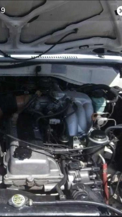

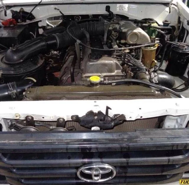

I notice the electronic ignition 1FZs have that one but the brackets are on a different side? From the picture I got this one came out from the distributor 1Fzs (70) series just like ours?? So it should just bolt right in See pics they look different?

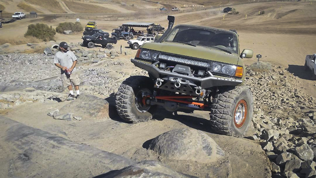

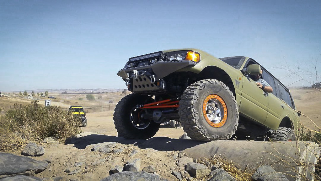

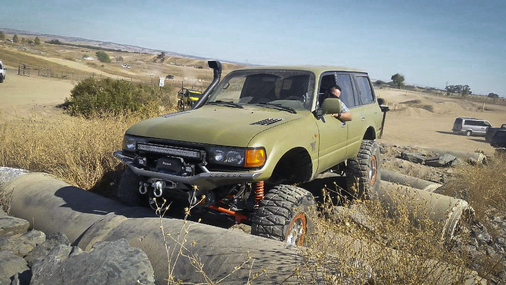

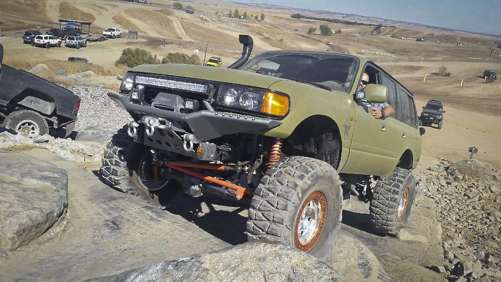

Went out to the Toyota Meet at Prairie City this past weekend. Lots of cool rigs. Played around on the obstacles courses for a bit. Everything worked great (except for the few minutes that my 4x4 wouldn't engage, weird). I'm now realizing that hydro assist is a really nice thing to have. Also nice to be able to air down to 5psi without having to worry about popping a bead :cheers:
Looks like you crawlin 'n style
Awesome work!
