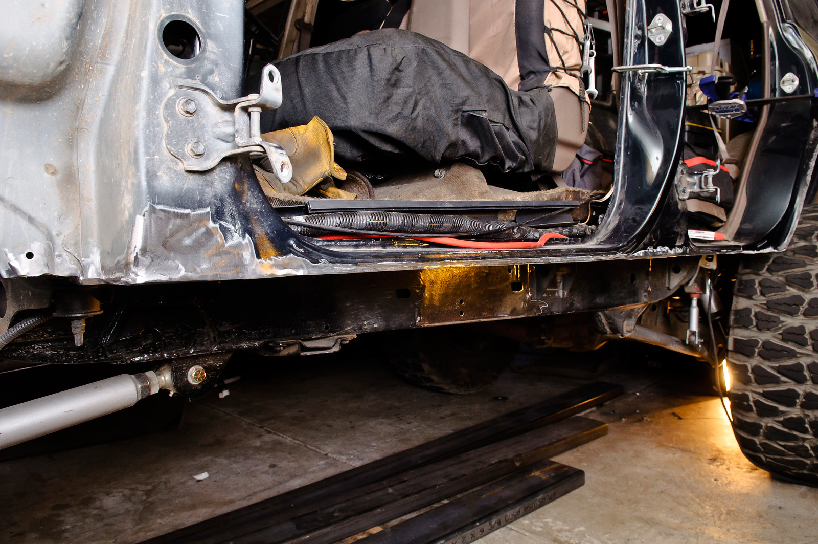

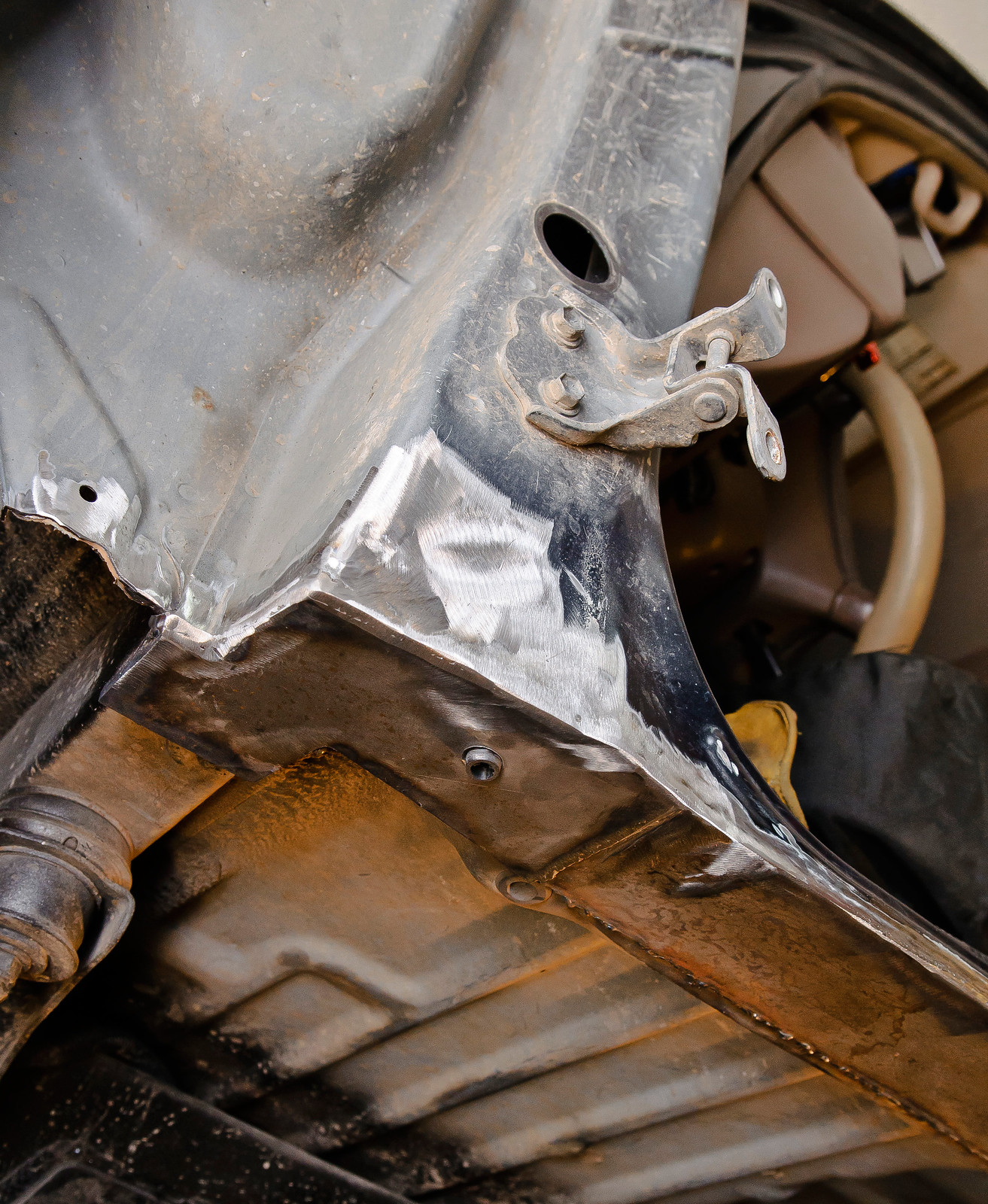

Sorry for the delay in updates, haven't had much time lately to work on the truck. I know I said a while back I was going sliders-to-rocker but I lied. Change of plans again. After I trimmed the rocker away I realized that it didn't lend itself well to welding a big plank of metal to it. It's not perfectly level front to back and not flush from the inside the rocker out to the door sill. I think the only way around it would have been to trim more out of the door sill which would mean having to trim the doors a bit - I didn't wanna do this. Otherwise I'd have odd gaps between the rocker and the 2x6 slider. So off I went to cap off the rockers. The 2x6 plank will get attached directly to the frame. I used 3/16" plate to seal everything off. I'm sure I could have gotten away with thinner material, but 3/16" makes it much easier to weld and my local metal place has it in strips that are just the right width.
This is under the A pillar. The hole you see is a barbed fitting I attached to the sunroof drain tube. It will drain directly to the outside instead of inside the rocker cavity like before.
I ended up cutting off the entire lip of the door sill. So the doors will actually hang a tiny bit lower than the the edge you see here. j
I have about another foot to go then I can start on the sliders. I hate welding upside down.
