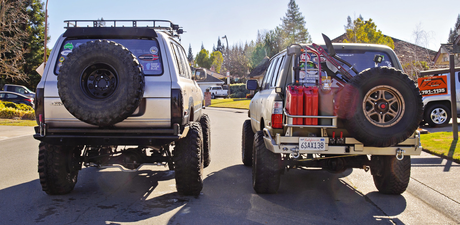

Met up with js93cruiser today. Parking my truck next to his was downright embarrassing. My tires look so tiny it's sad.

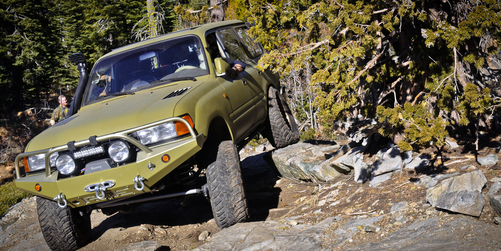

The tie rod actually sits higher in the front than it does in the rear. And even out back it's not immune to rocks. Several people have bent the tie rod behind the axle. For me, this has several benefits:
- It puts the tie rod where it should have been from the factory and like every other straight axle SUV on the planet. Having the tie rod in the back is a very funky setup.
- Easier to adjust toe with the weld-in bungs
- Gets rid of the clearance issues when trying to correct caster on lifted trucks, mine is rubbing already.
- Putting the tie rod on the front raises it a bit, so gets it away from rocks
- GM 1-ton TREs are greasable with a zerk fitting, cheaper and stronger than Toyota and available everywhere since they're widely used.
- I'm not sure what the future holds. Engine swap? Taller lift? Custom 3-link? I don't want to limit myself now. When you go more extreme the tie rod will always be an issue. So I might as well upgrade now.
- Setting myself up with the steering this way gives me more options down the road, crossover steering, full high-steer, hydro-assist, etc.
As for the splash shield behind the brakes, I haven't had any issues, and we did a lot of wheeling in the mud/snow yesterday.

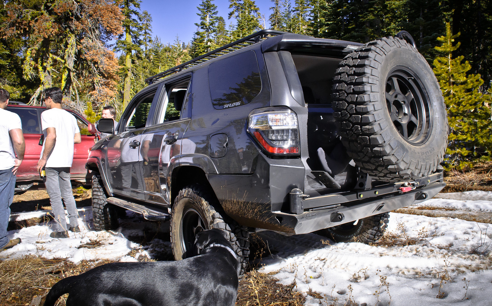

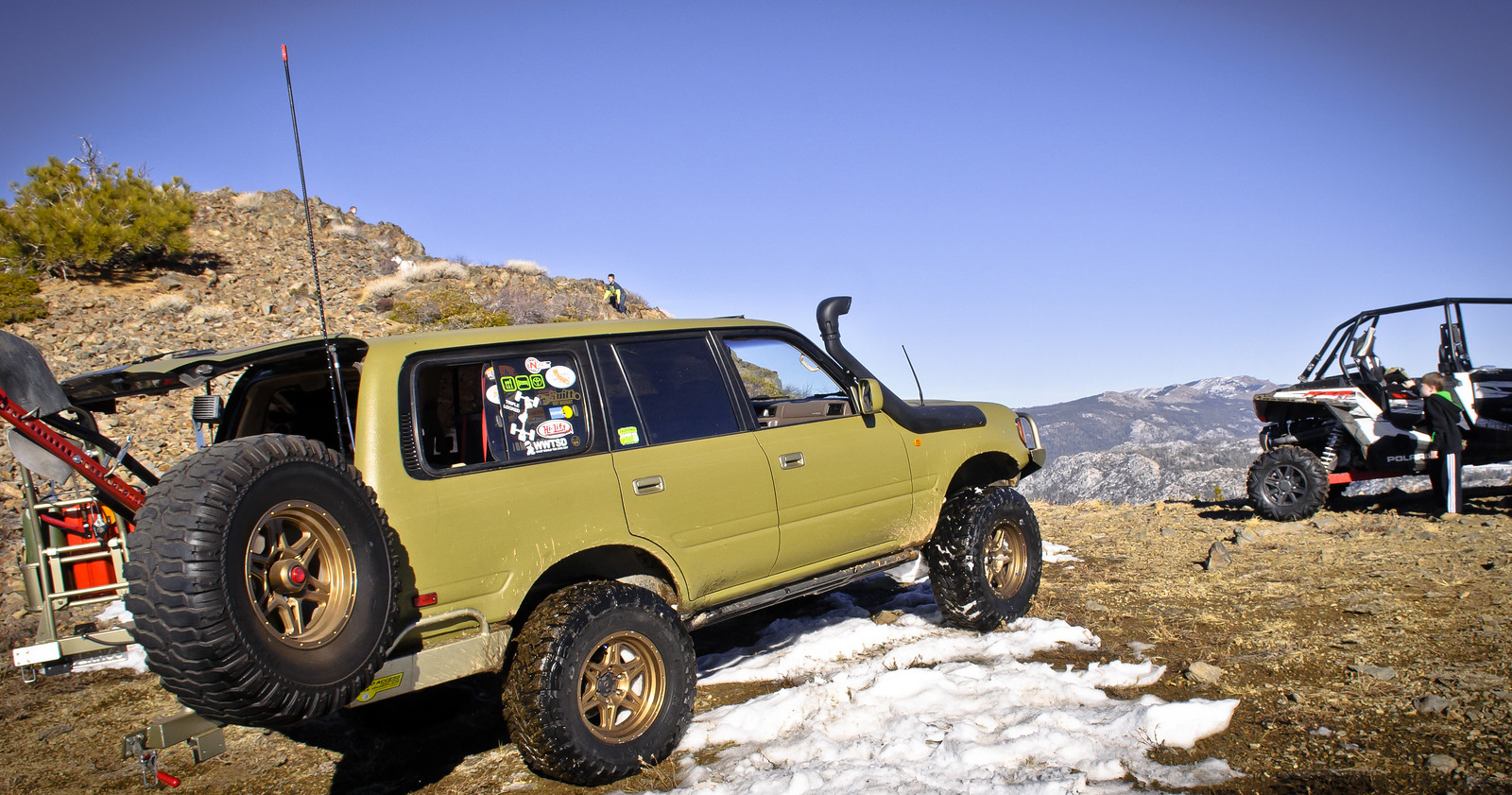

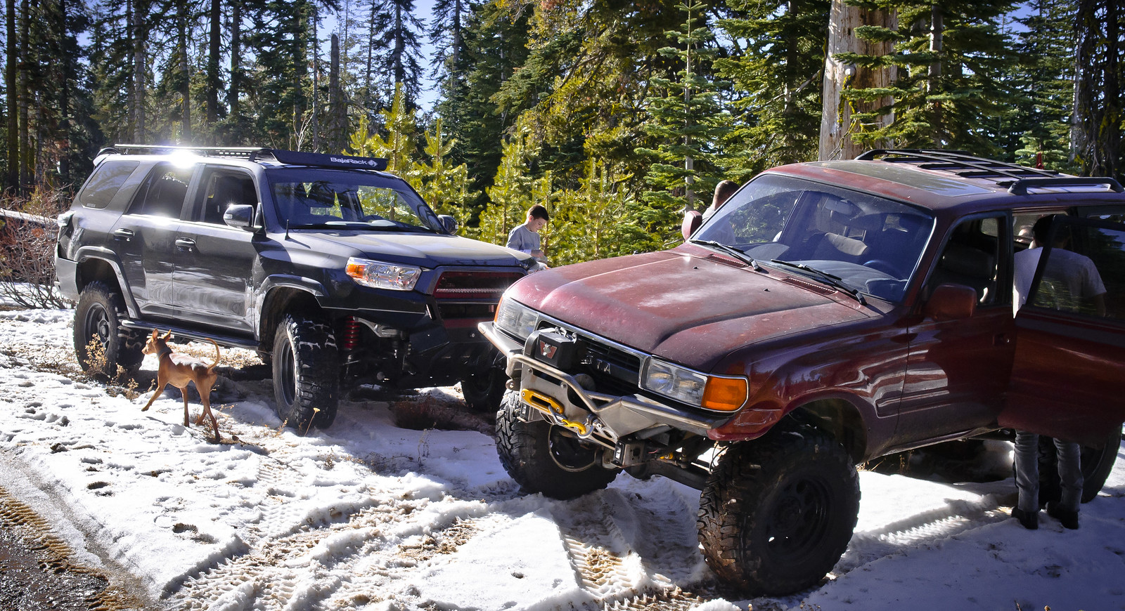

Met up with 'Finnyfam60', Luke from 4x4 Labs and a guy from another board with a really sweet 4Runner.

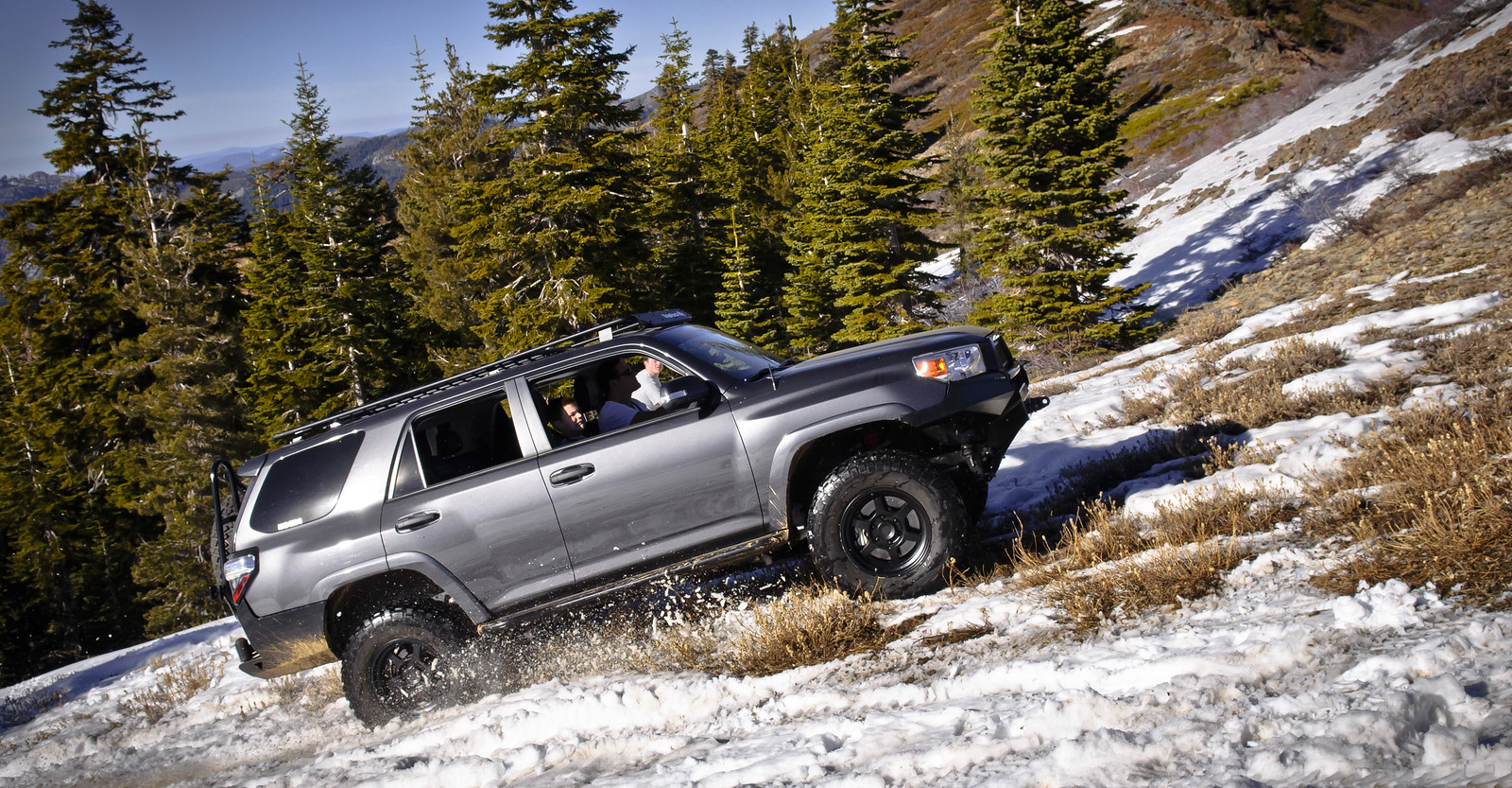

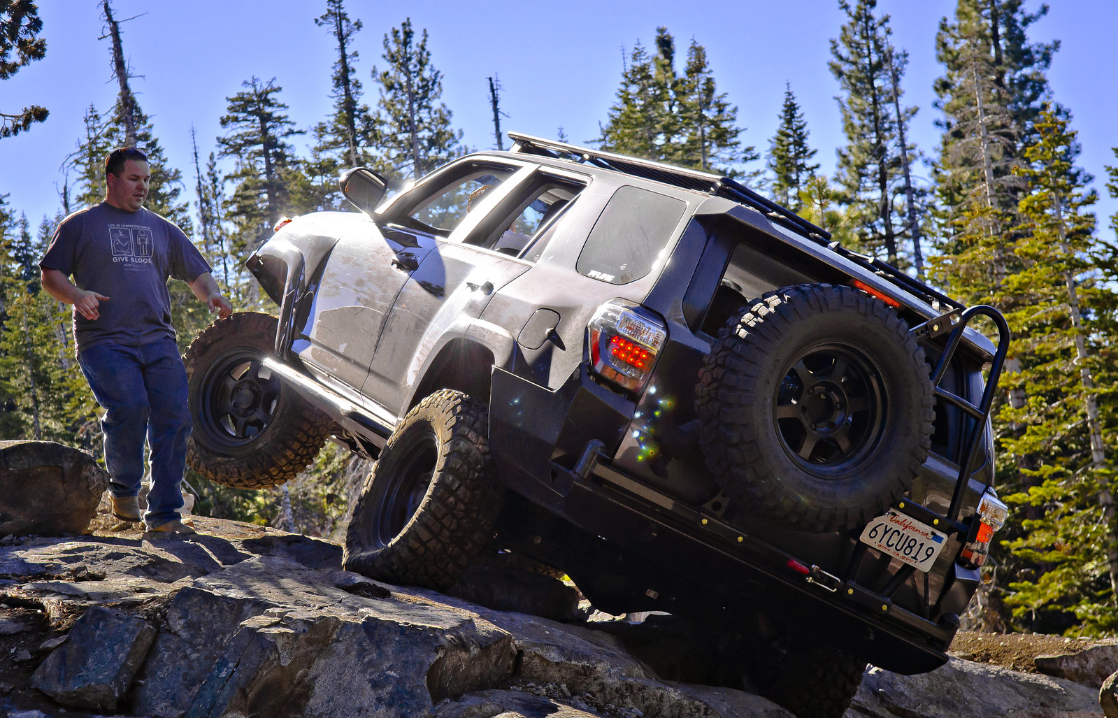

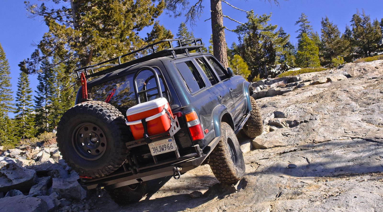

Thanks to the lack of snow this year we set out to do the Signal Peak 4x4 trail in the Tahoe National Forest. The trailhead for Signal Peak is in the same area of Fordyce, Eagle Lakes. This was my first time running this trail. A few obstacles proved to be a lot harder than I anticipated.
There wasn't too much snow, but we were not able to climb the last bit of the trail as it was way too slick. Instead we bypassed it by climbing a steep hill in order to reach the towers at the very top.
