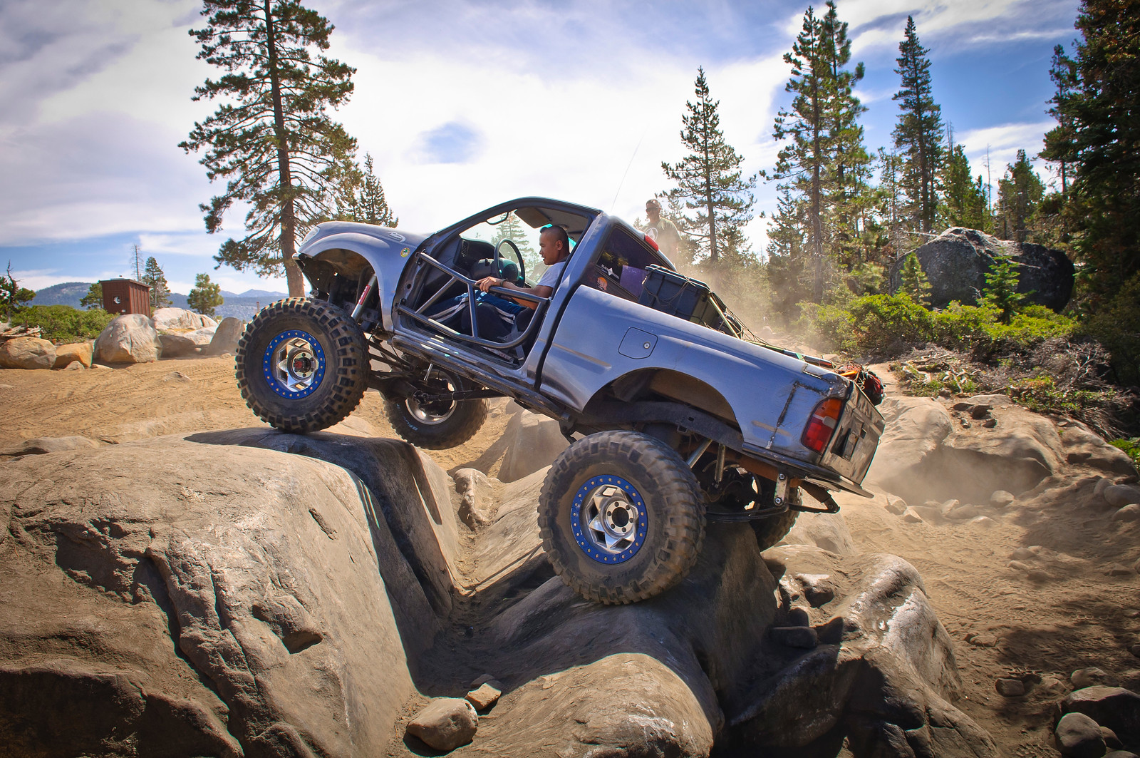

And here's my buddy's bad ass little Tacoma. After watching him walk up the Soup Bowl with the front unlocked, it makes me want to turn the 80 into an all out crawler. But much bigger. And heavier. And lower. With crappier gearing :)

Dang what size tires is that 1st runner running? Those are some fat swampers!
Also how does your buddy like those TG beadloc's?
No idea, found that pic on Pirate and saved it to my phone since it looks so bad ass! As for the TG beadlocks, he really likes them, no issues so far. I like them too. I think they'd look great on an 80. Maybe one day :)
