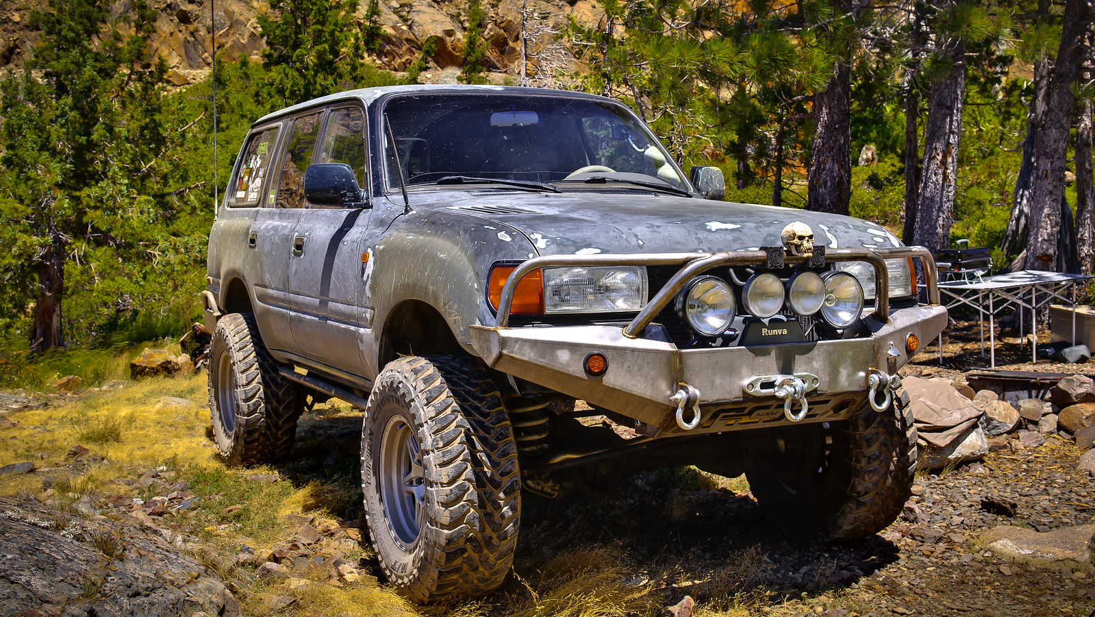

Your rig looks really cool...
Some kind of raw monster :)
I think these fenders would match:
Thanks :) Those are some really cool flares but I've gotten use to the flareless look. Besides, they'd just get torn off again!
