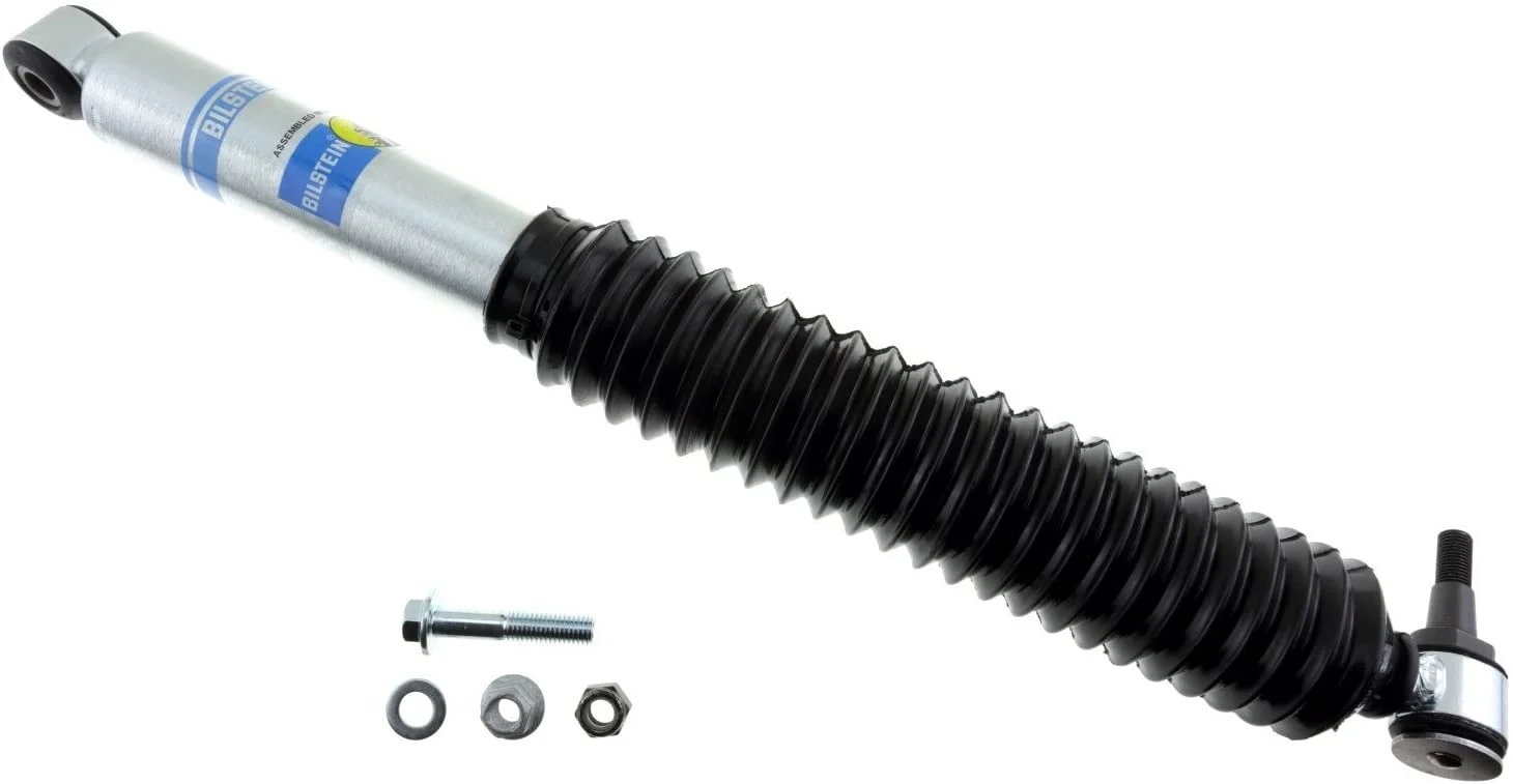

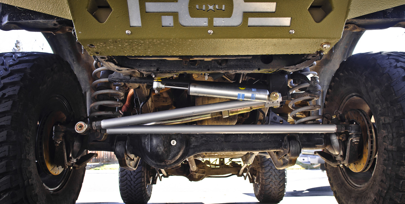

For those interested, I finally resolved this problem with the stabilizer. I spent some time researching Bilsten 5100-series stabilizers and found one off the big Chevy 2500HD trucks that was just the right length.
In order to make it work I had to cut out both bushings and install some new ones so it would fit the big bolt I had welded on the tube clamp and also the factory mounting stud up on the frame.
The shock I used is the Bilstein 33-196619. It has an extended length of 22.46" and is 14.55" collapsed.
Feels a bit better than the old OME I had on there too :)
Good morning.
With the steering stabilizer how did you remove the stud shown in the picture, does it just unbolt, and which bushings did you replace the Bilstein ones with?

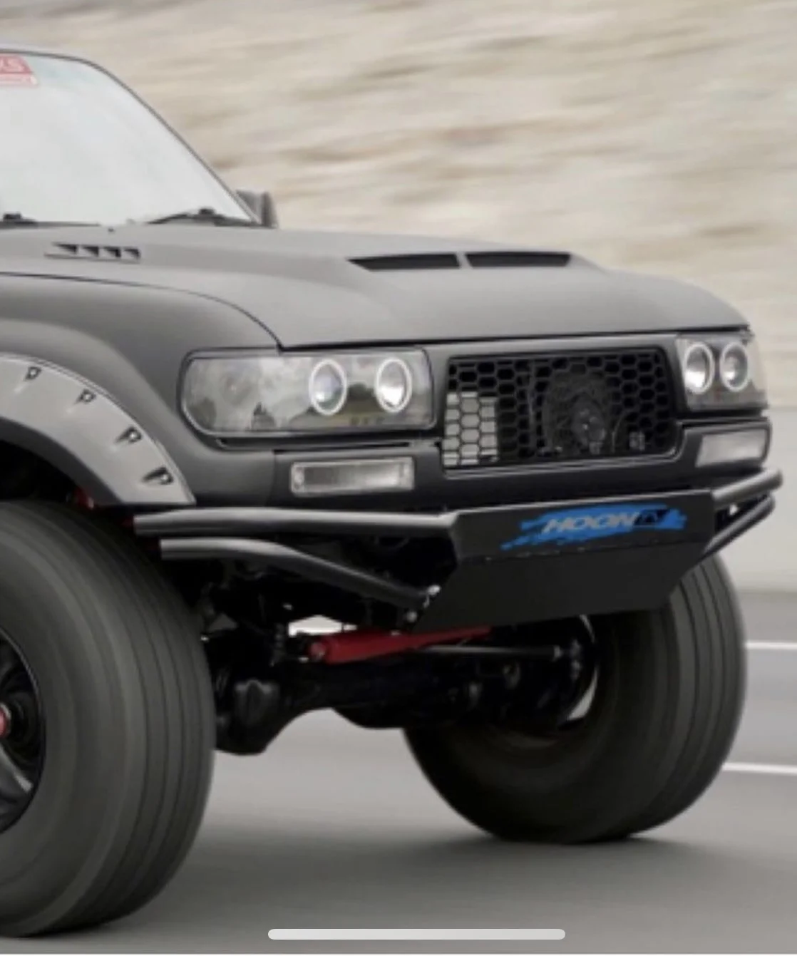

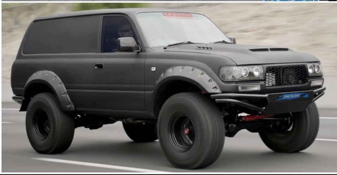

Really digging the round head light bezel & grill.:smokin:

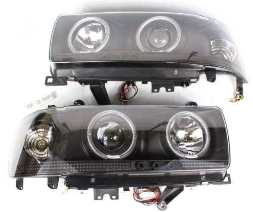

Wh
Where do you get these headlights?
Ebay.
Don't expect anywhere near OEM quality, and don't expect them to be plug and play. Pretty simple install still, but the wiring is not direct plug in.
