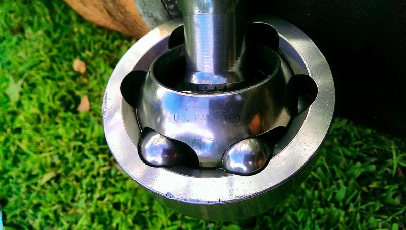

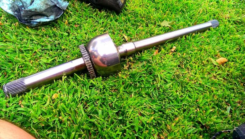

The Monday after running Snake Lake I drove the truck to work and felt a horrible death wobble with very loose steering. Look underneath and sure enough, one stud gone, one on its way out and a bunch of grease everywhere. Luckily this didn't let go while driving at high speeds, could have been BAD!
So I decided it was time to do a knuckle rebuild anyway since I was starting to get a bit of grease seeping past the wipers. Ordered the parts needed from Cruiser Outfitters and got to work! I also ordered new OEM knuckle studs, cone washers, washers and nuts. Ran a tap through the stud holes and used blue Loctite. Nothing exciting, just a MESSY job. I think I'd rather do the head gasket again :flipoff2:
Wheel bearings look to be in good shape so I just repacked them with fresh grease.
Also got the chance to inspect the purtty chromoly Birfs that were installed according to the PO :clap:
