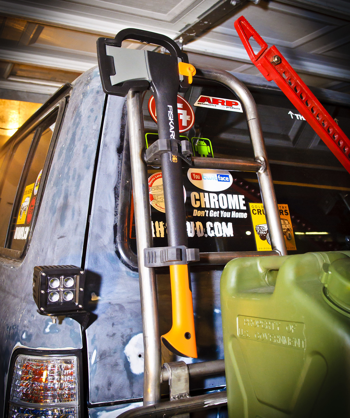

AXE MOUNT
Since I already own The Best Shovel in the World, it was only logical to choose the same brand for the axe. Picked up the Fiskars X15 axe on Amazon for about $32. The axe is mostly bling since I don't think I'll use it unless it's the zombie apocalypse and I'm out of ammo :flipoff2:
Mounted it to the ladder using a set of Quick Fists. It's really sturdy and won't move, but I'll probably still use a lashing strap around it for peace of mind. The axe handle has a hole at the bottom so I can use a cable lock to secure it with the gas/water cans.

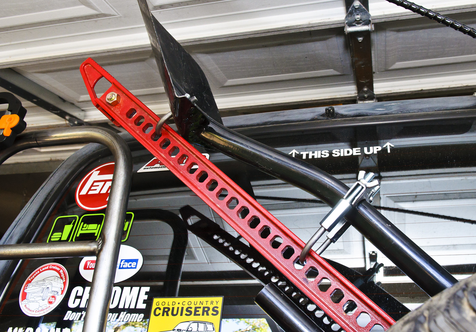

SHOVEL MOUNT

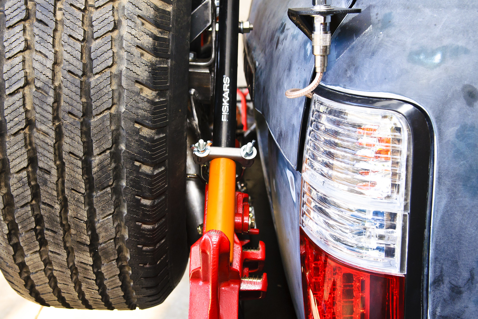

After messing around with this damn shovel for a while I FINALLY figured out a place to mount it. The spare tire mount I posted earlier didn't work well. It works best only with a Hi-Lift jack. When you try to use a shovel only it won't mount securely. So I'll be returning that for a refund.
Ended up mounting the shovel on top of the Hi-Lift and it turned out great. Rock solid. Not even a wiggle. Used 3 muffler clamps with some wing nuts to hold it in place. The middle clamp wasn't long enough so I extended it using a coupling nut and some threaded studs. I drilled two holes into the spade to help secure it for side-to-side movement. Not too bad for about $15 in hardware :clap:
