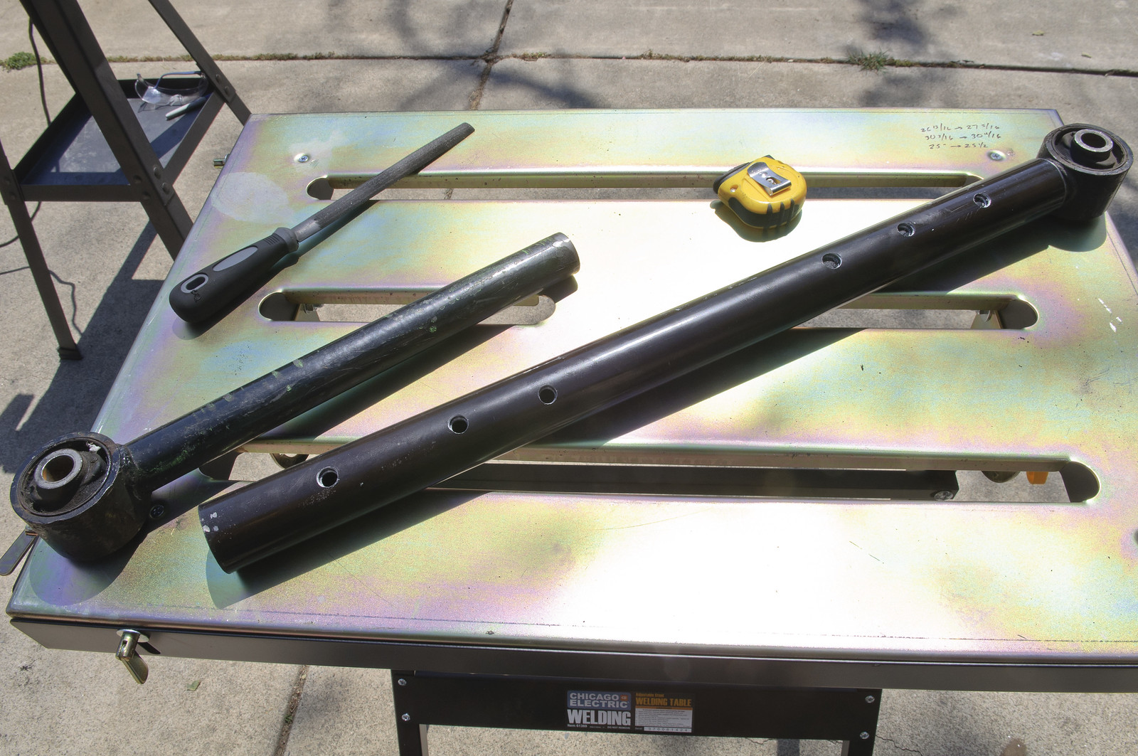

Before I run another fairly difficult trail I wanted to make sure my rear control arms were taken care of. They were beat to hell and one was bent pretty bad. I had an extra arm sitting around that I've been meaning to swap out. But it would have only been a matter of time before it got destroyed again.
So I decided to sleeve them with 1.75 x 0.1875 DOM tubing. This gives it an ID of 1.375" which works perfect as a sleeve for the OEM arms which are about 1.34" OD. Got a few quotes from local shops and they would only sell full 22' sticks. Too much. Checked a few places online and it would cost me about $90 shipped for a 5' stick. Ridiculous. Then somebody gave me a link for DOM tubing on Amazon. $52 shipped, of all places. Sold! Showed up in 2 days with my Prime account.
http://www.amazon.com/dp/B000H9LVAM/?tag=ihco-20

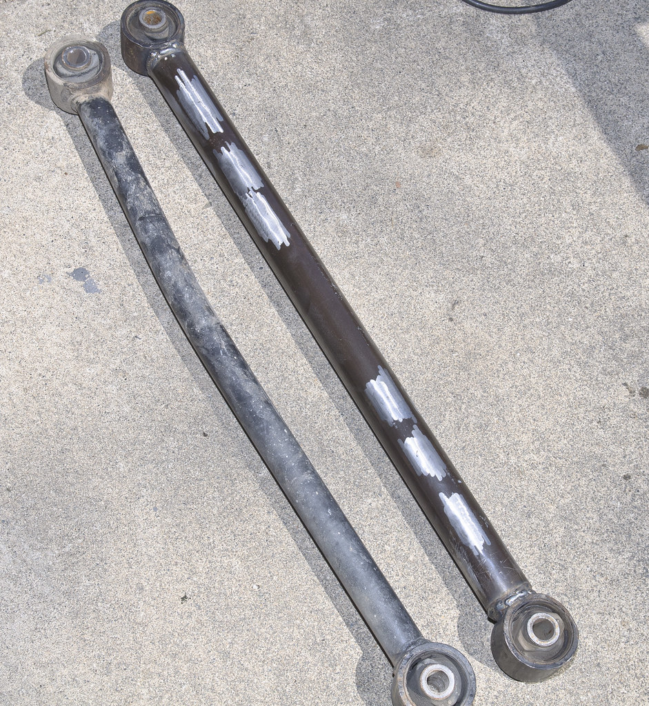

Cut the OEM links in half. I cut the DOM tubing so overall length was extended about 1/2" to compensate for the lift. Drilled a few holes for some rosette welds.
Oh yeah, my little Horror Fright welding table is pretty darn nice for the money.
All welded up. You can see how badly bent one of my arms was.

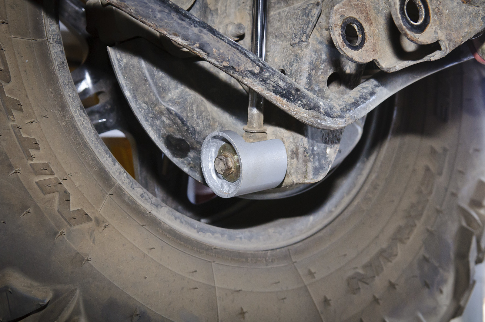

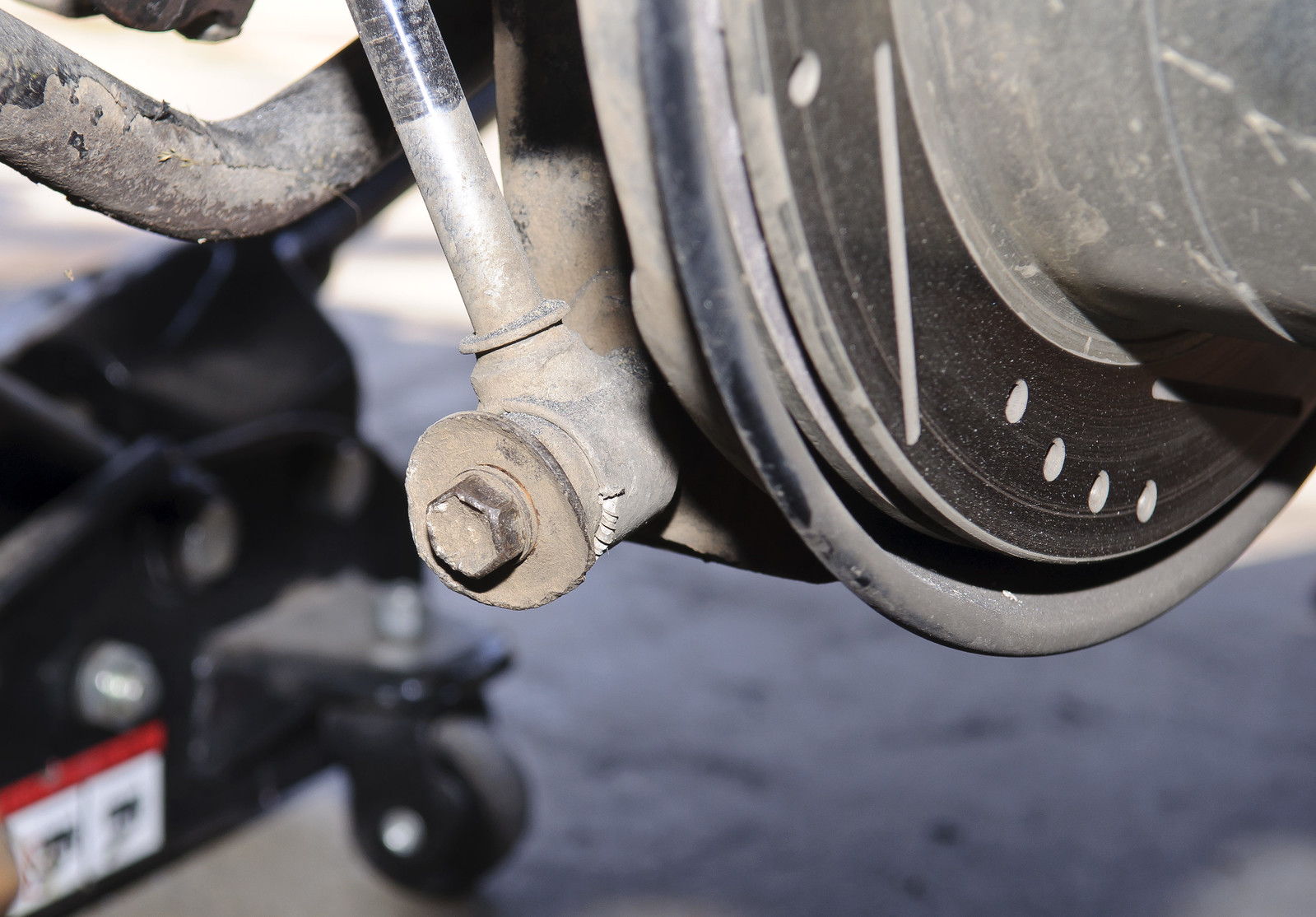

I also remembered I had some shock protectors sitting around for over a year now. I can't even remember which member I bought them from. Were about $25 I think. Nice little solution to keep your lower shock mounts from getting destroyed in the rocks.
