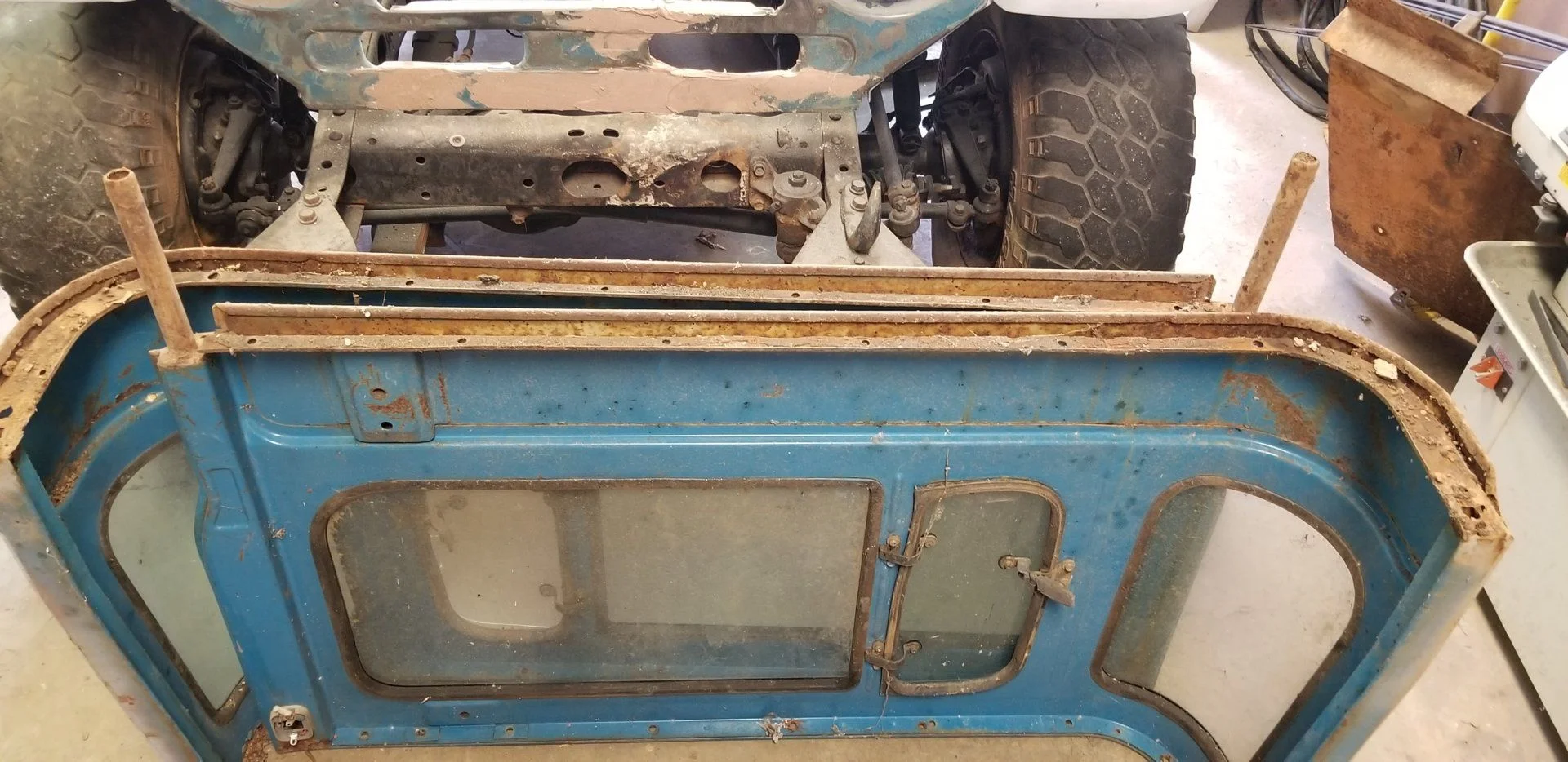

There is a lot of body work that needs to be done. The quarter panels are pretty wavy and I think that it is going to be easier to just replace them. What are good options for that?
The worst of the rust is in the bottom of the hard top sides where it sat in the dirt for a long while.

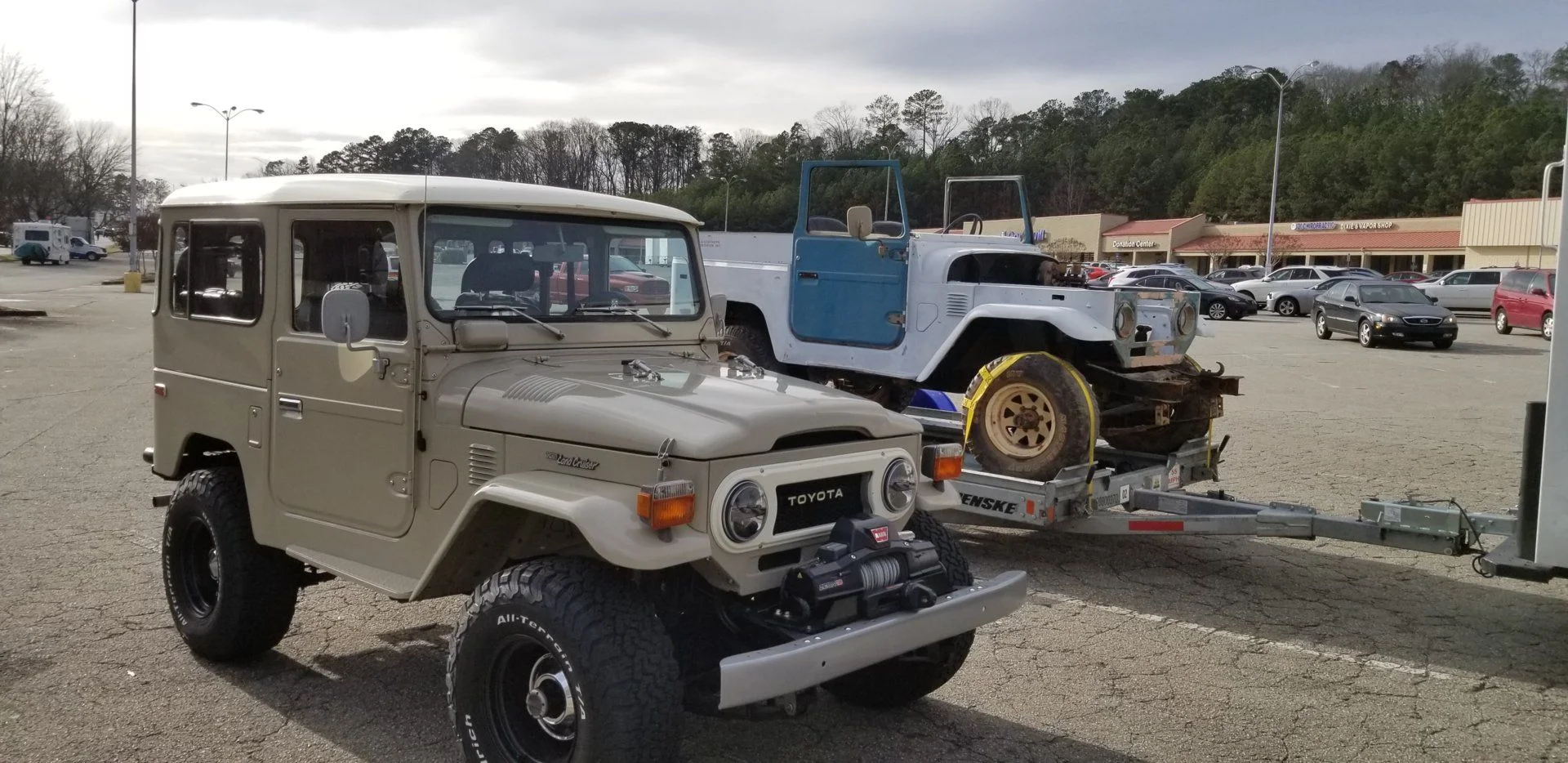

Met with Rick (@GA Architect) and saw his beautiful cruiser. It was great being able to talk to someone else about Land Cruisers without looking like a total nerd.
Here is the new cruiser hoping to one day look 1/2 as nice as its older brother.

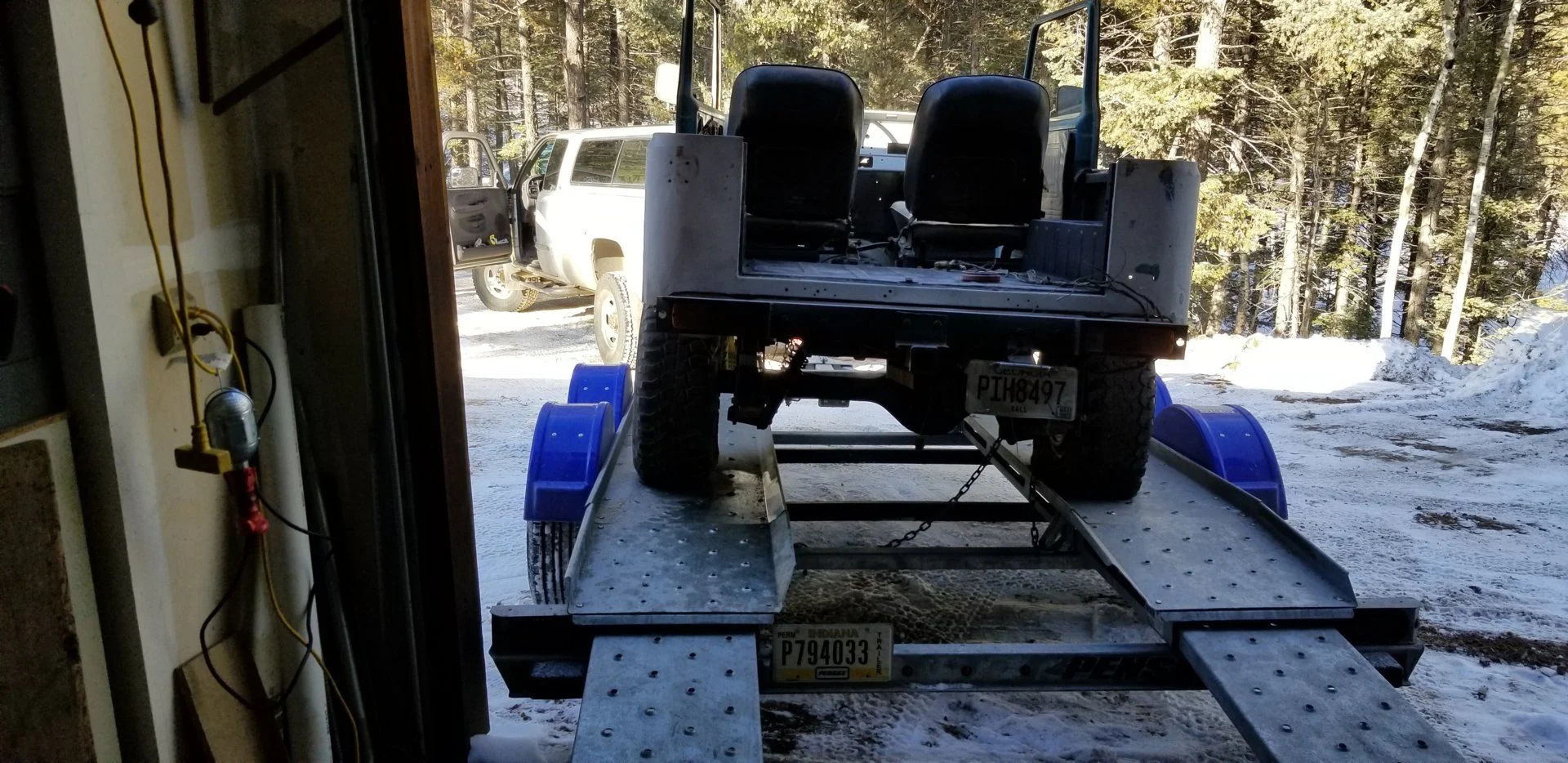

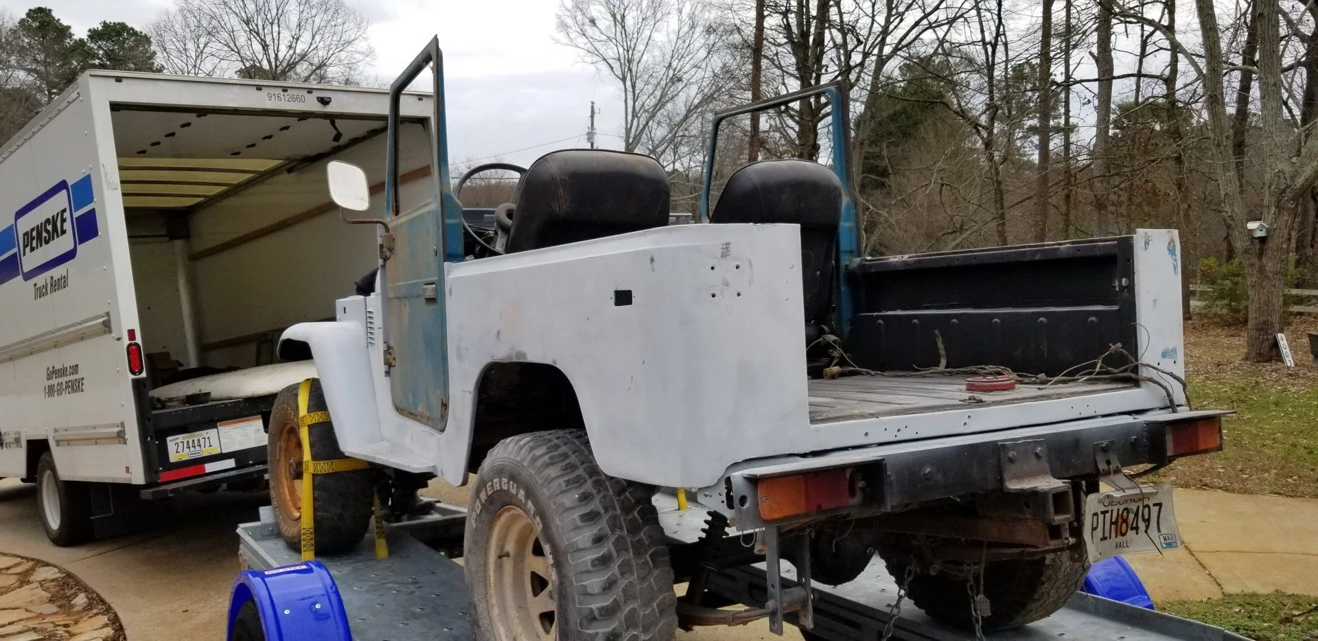

I'm sure you guys are thinking "Did he die? It's been soooo long since he last posted." Well, I didn't die, and things have been happening.

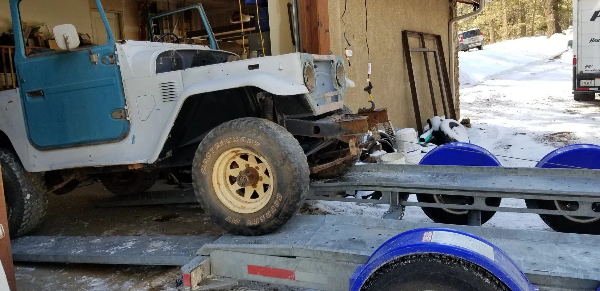

It was fun getting a 2 wheel drive large truck up the roads to our house. It was so fun that I had to pull out the backhoe and go scrape roads. Thank god for heated cabs.
I pulled out the cruiser to follow the truck back and found that the brake lights don't work. Nice! Just another thing to add to the list to fix. I'm hoping that it's just bulbs, but who knows.
We decided that it was safer to pull the trailer with our truck and drive the trucks separately and that seemed to work fine.

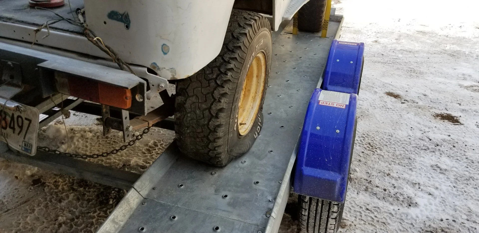

One of the rear tires decided to helpfully go flat before we got it off the trailer, luckily the bead stayed on so we could fill it up.

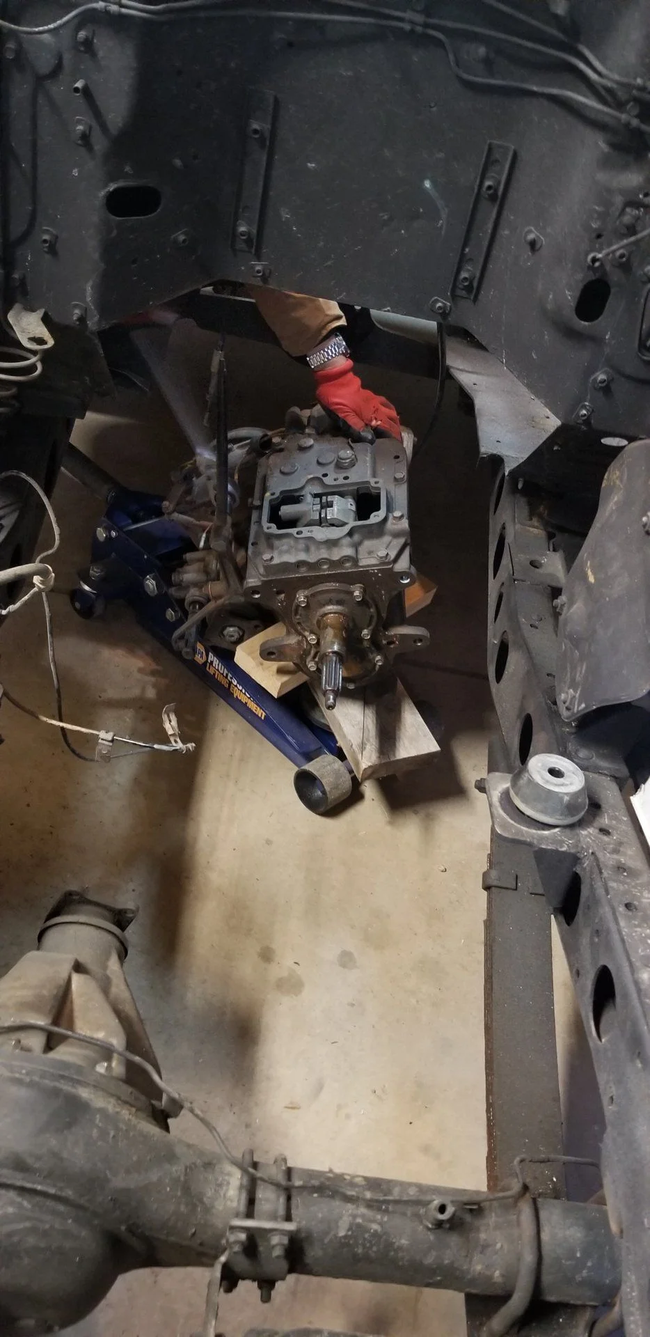

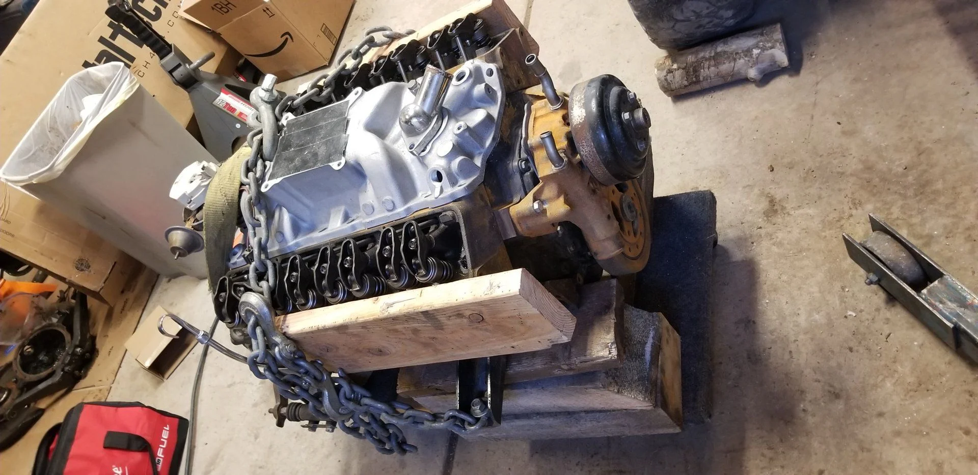

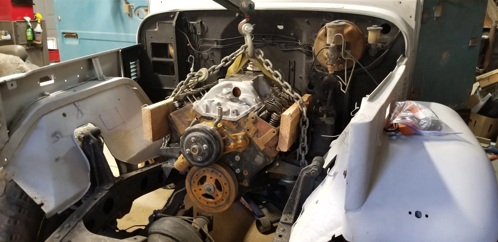

This funny looking thing came out from the engine bay to get a valve adjustment, get painted, and get the rest of the important innards put on. This 350 is getting a Holley Sniper EFI injection system, Holley distributor, and Holley ignition.
How do you guys like my lift method? It works, just sayin.
