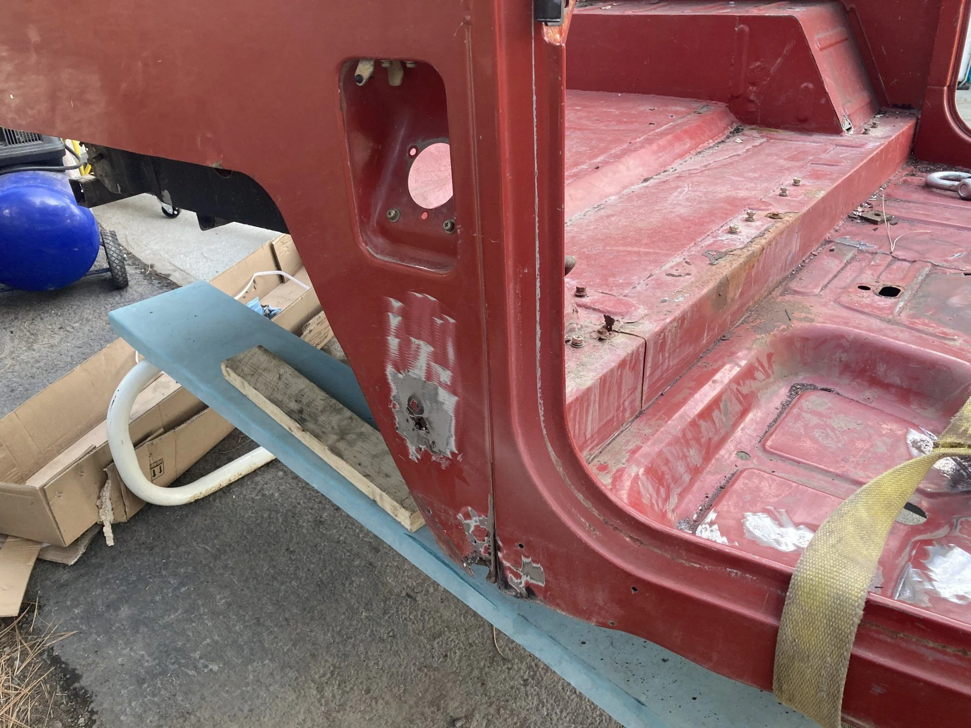

going off to get sandblast and primed Then I will repair. Any words of wisdom. I watched some video from The 40 Channel and he did repetitive sanding and filler and painting. Take a look at my tub. Any advice is welcomed. Everything thing from behind the seat forward is pretty solid. My fenders, hood and front panel are perfect. Thanks.

Looks like the usual rust spots. Blasting will really help before patching. Take your time and make the patches match pretty closely. I like to have max a 1/16 of gap. It makes welding a lot easier. Look at some videos of body patching if you havent. The thicker metal of the 40 bodies is pretty forgiving, but do be careful. Get everything patched and then look at body work. A set of hammers and dollies will really help as well. If you have any questions, just ask. More than happy to help.

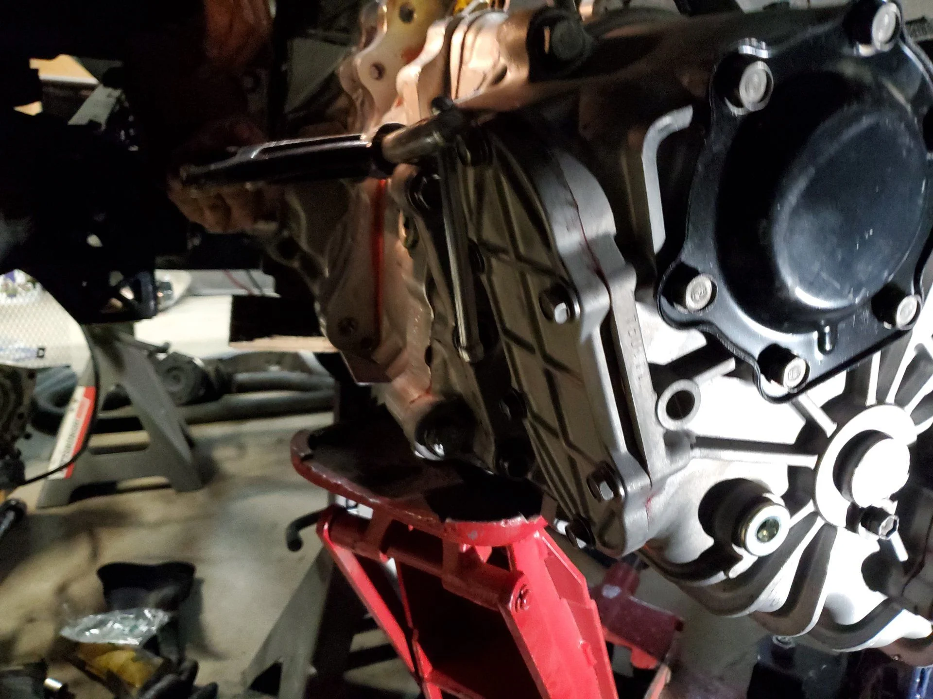

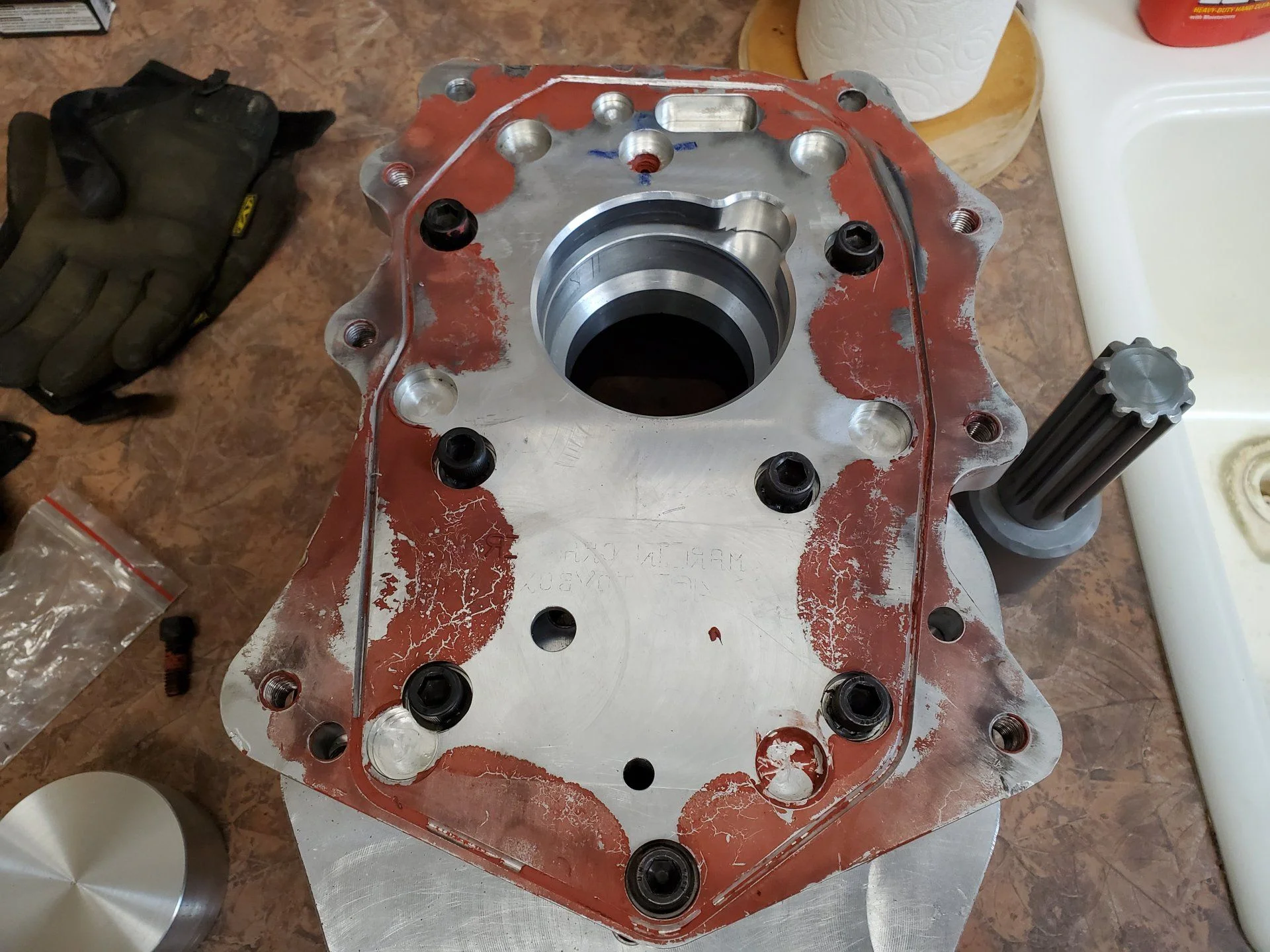

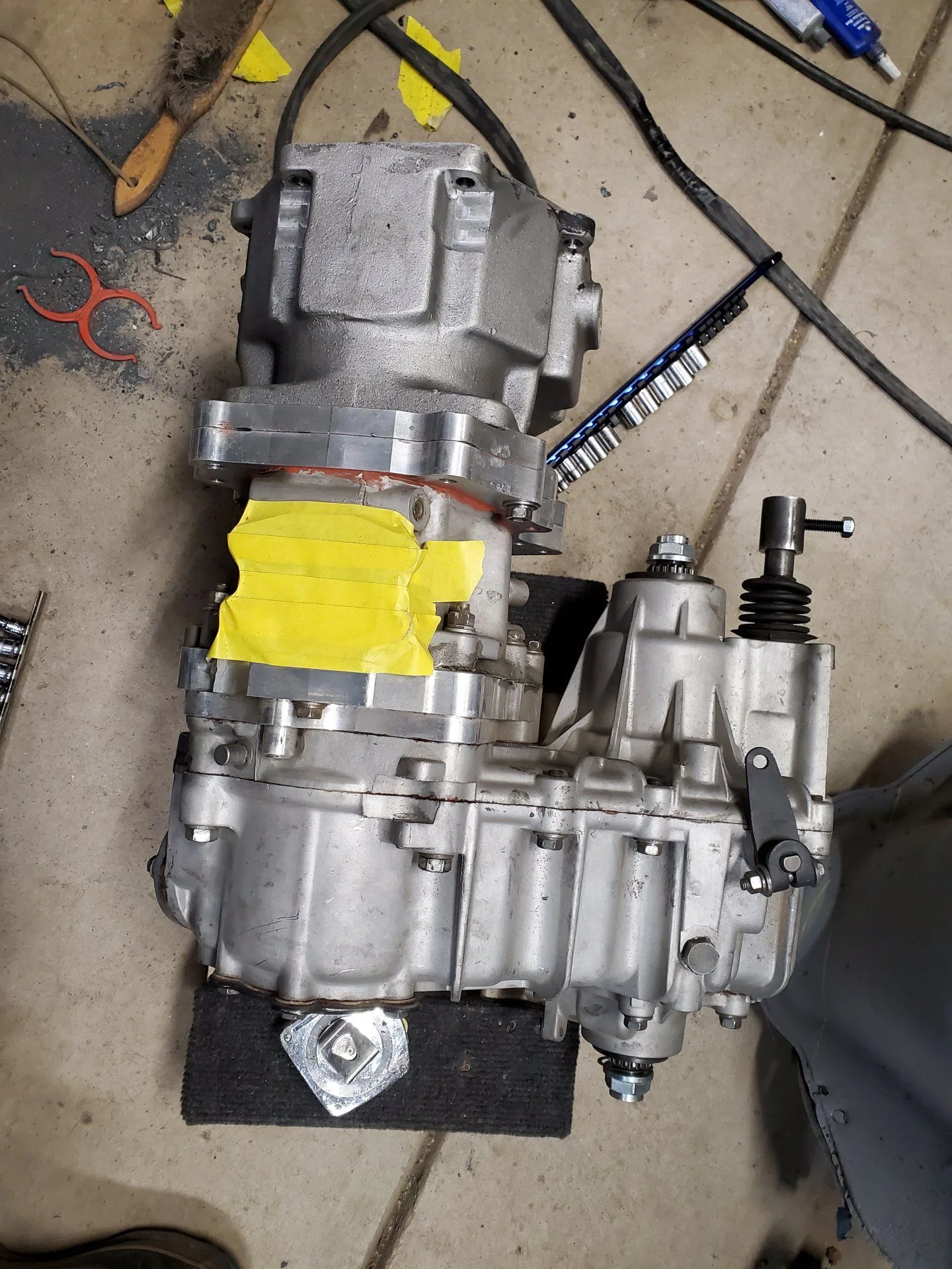

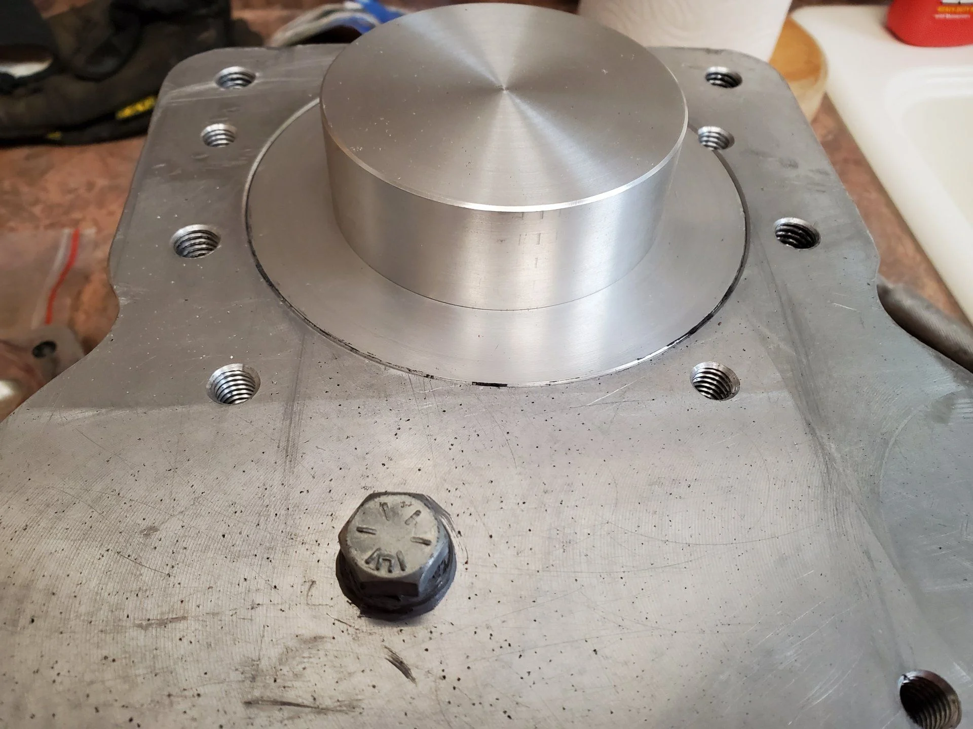

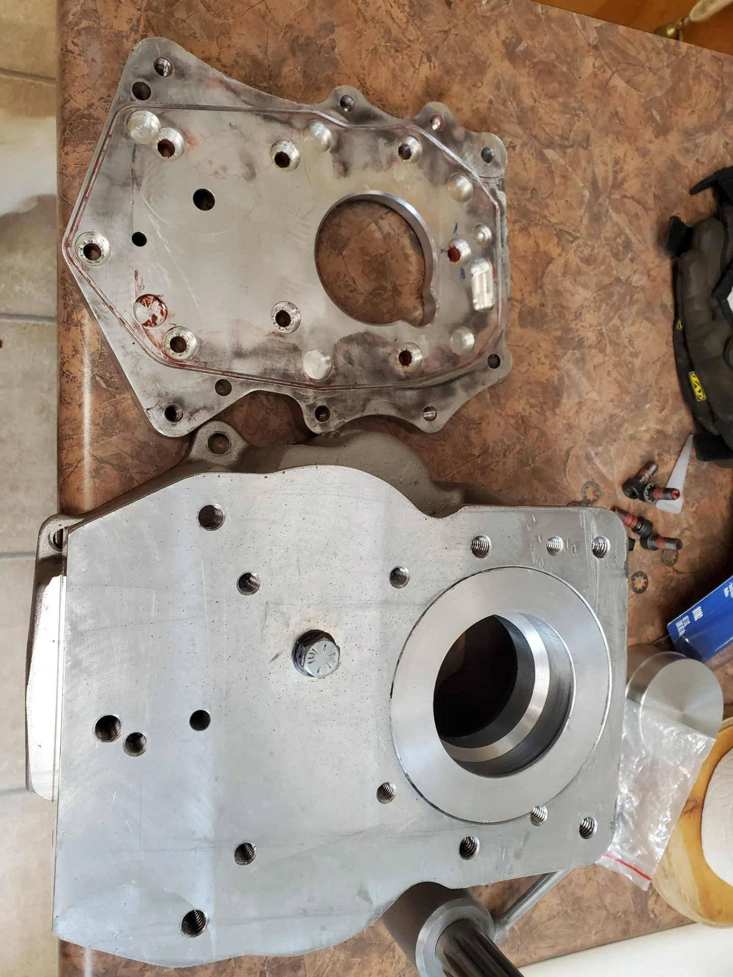

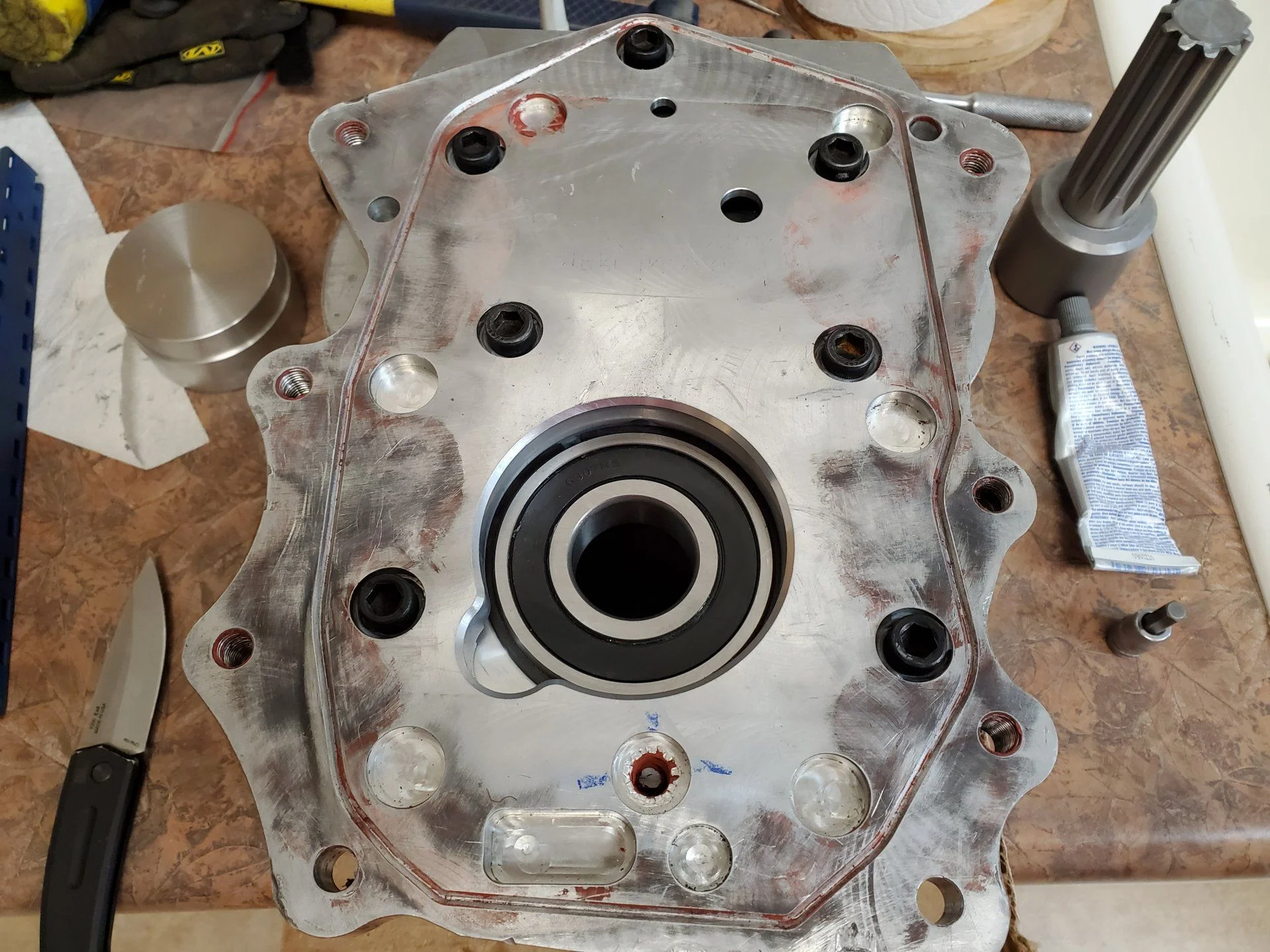

Mating NV and Toybox

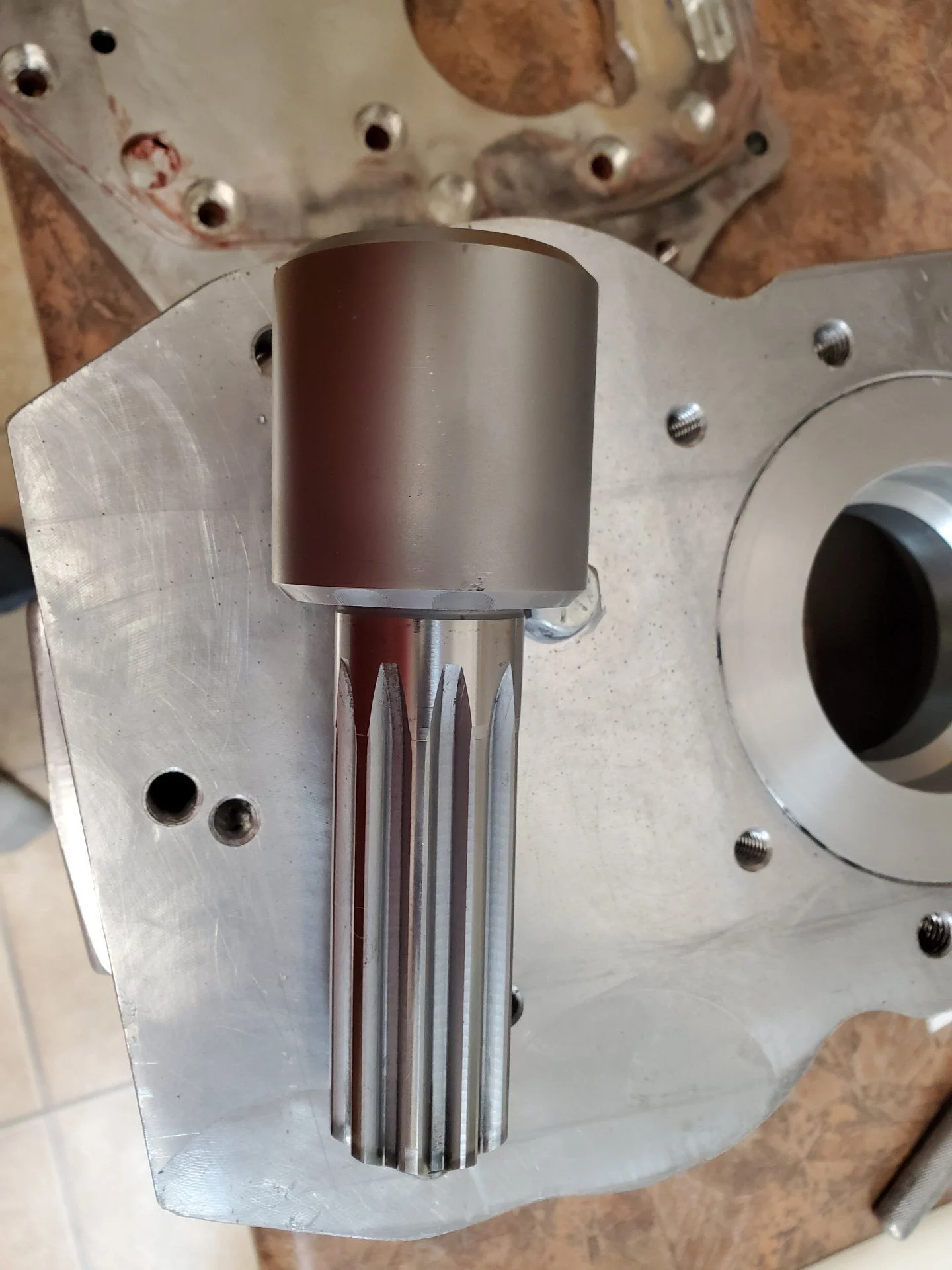

I got the machined adapter plates back today, so that is what I am working on.
The machinist made an alignment pin to keep everything concentric and aligned when machining. The tolerances are great, so it should be pretty well aligned. @Godfather90 , have an opinions on it?
He lathed down the 10 spline shaft, so it has the 2 5/8 stickout of the original SM.
I dumped a bunch of RTV between the plates, and am letting it cure before tighenting it down all the way.
Anyways, I should be putting this in the truck today.

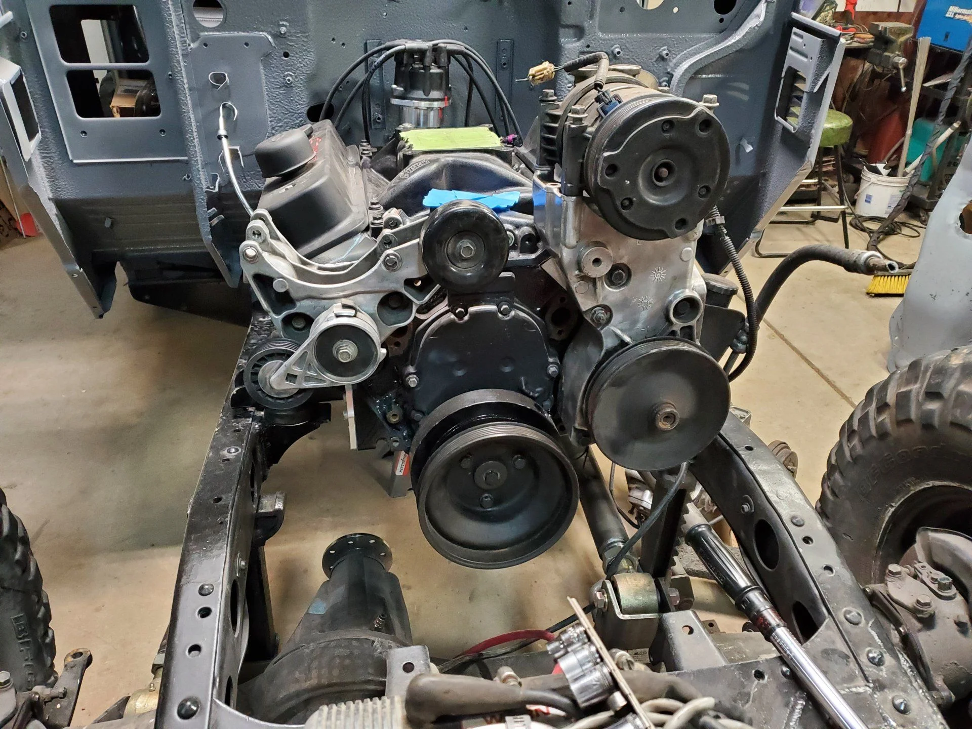

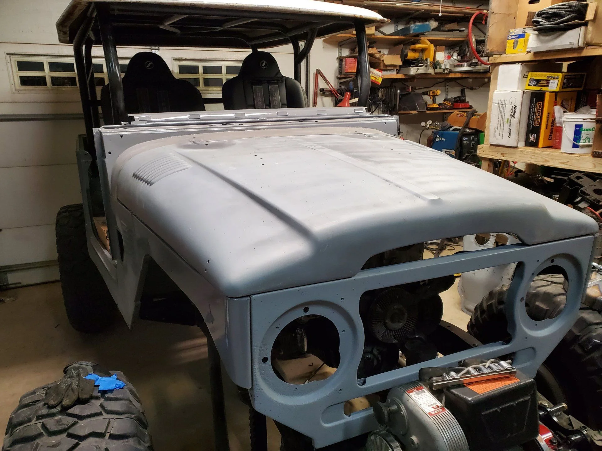

I reassembled the front drive of the engine today, hopefully for the last time in a while.

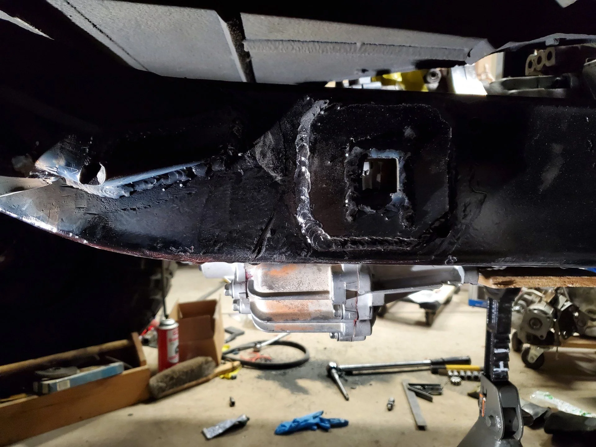

I got my rear diff armor modified and welded up.
I then started working on my radiator fitment.

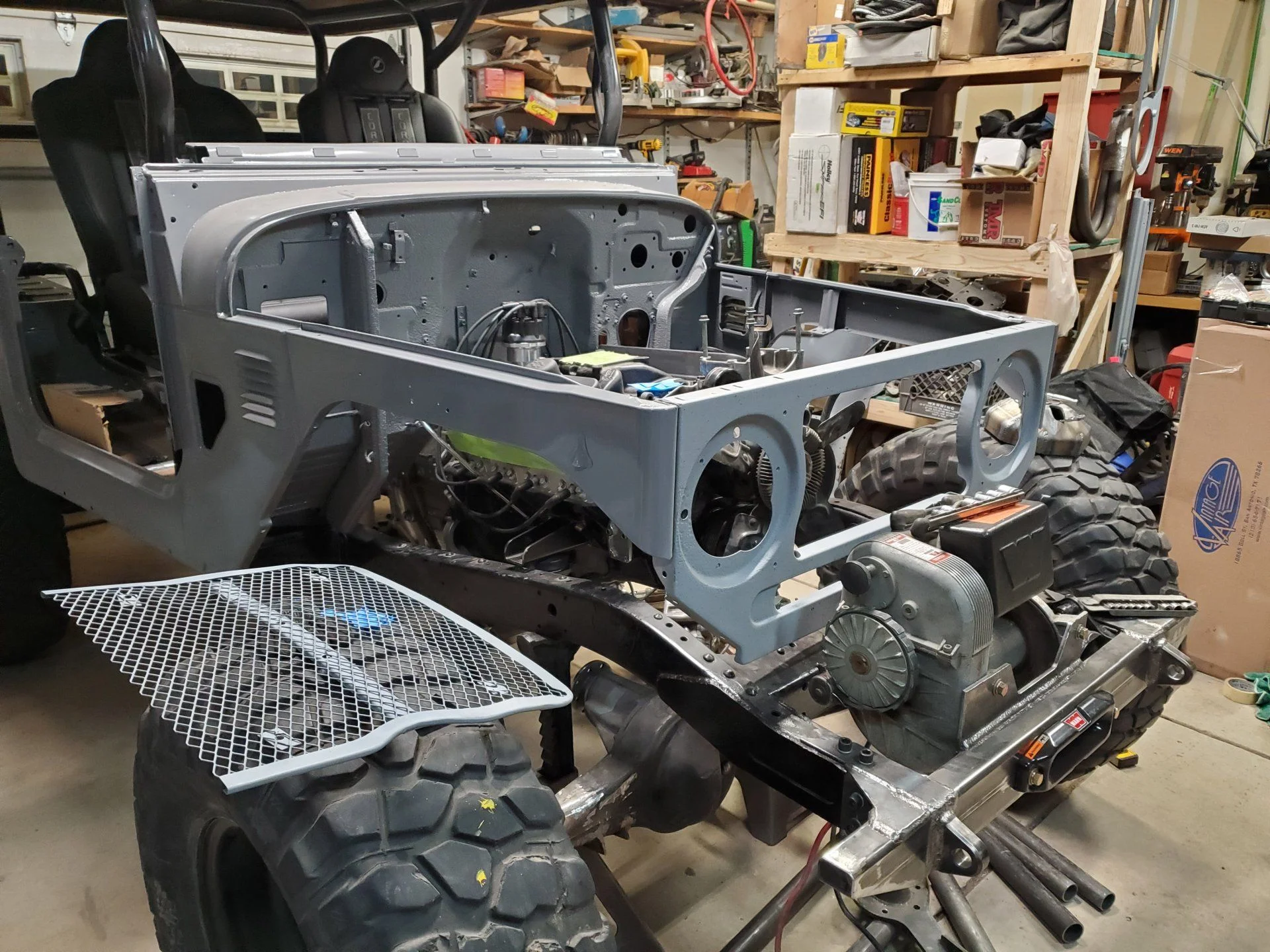

That meant I had to get the front panels on.
Amazing what 4 panels can do to make a cruiser look like a cruiser.

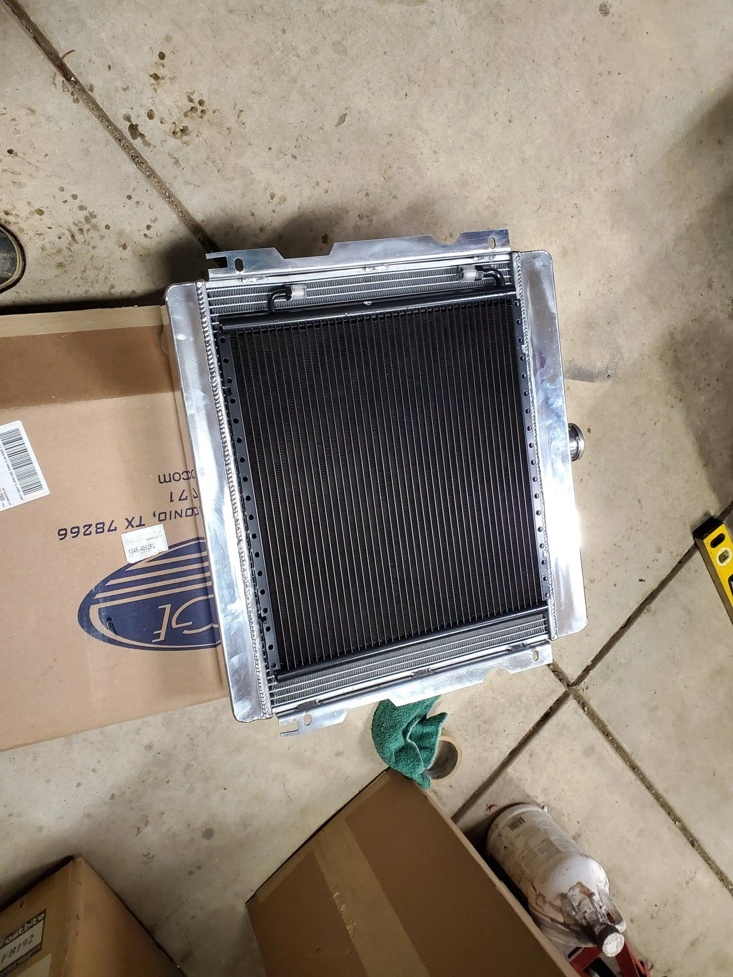

I finally got the radiator and condenser put together so I can start looking at mounting them. I should have plenty of space.
Anyways, thanks for looking.
-Noodle
what radiator combo is that and can you tell me how thick it is? i’m in need of a radiator but have quite a tight space i have to place it in!
This is the radiator. It's about 3" thick I think. Let me measure.
Edit: Right at 3" thick. The black thing is my AC condenser.

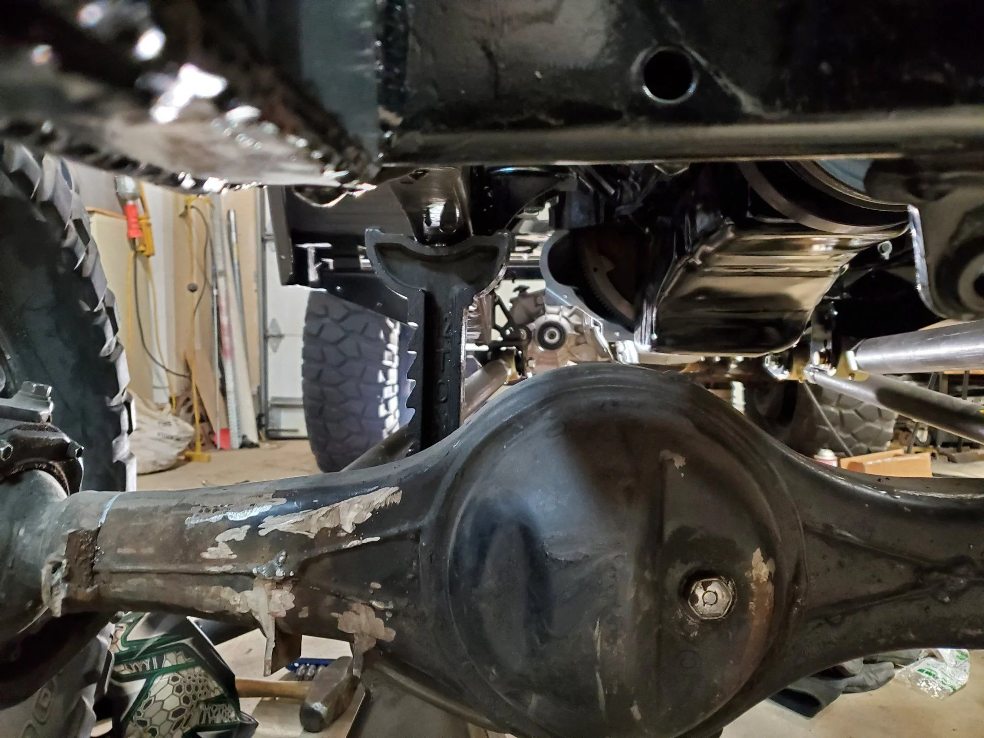

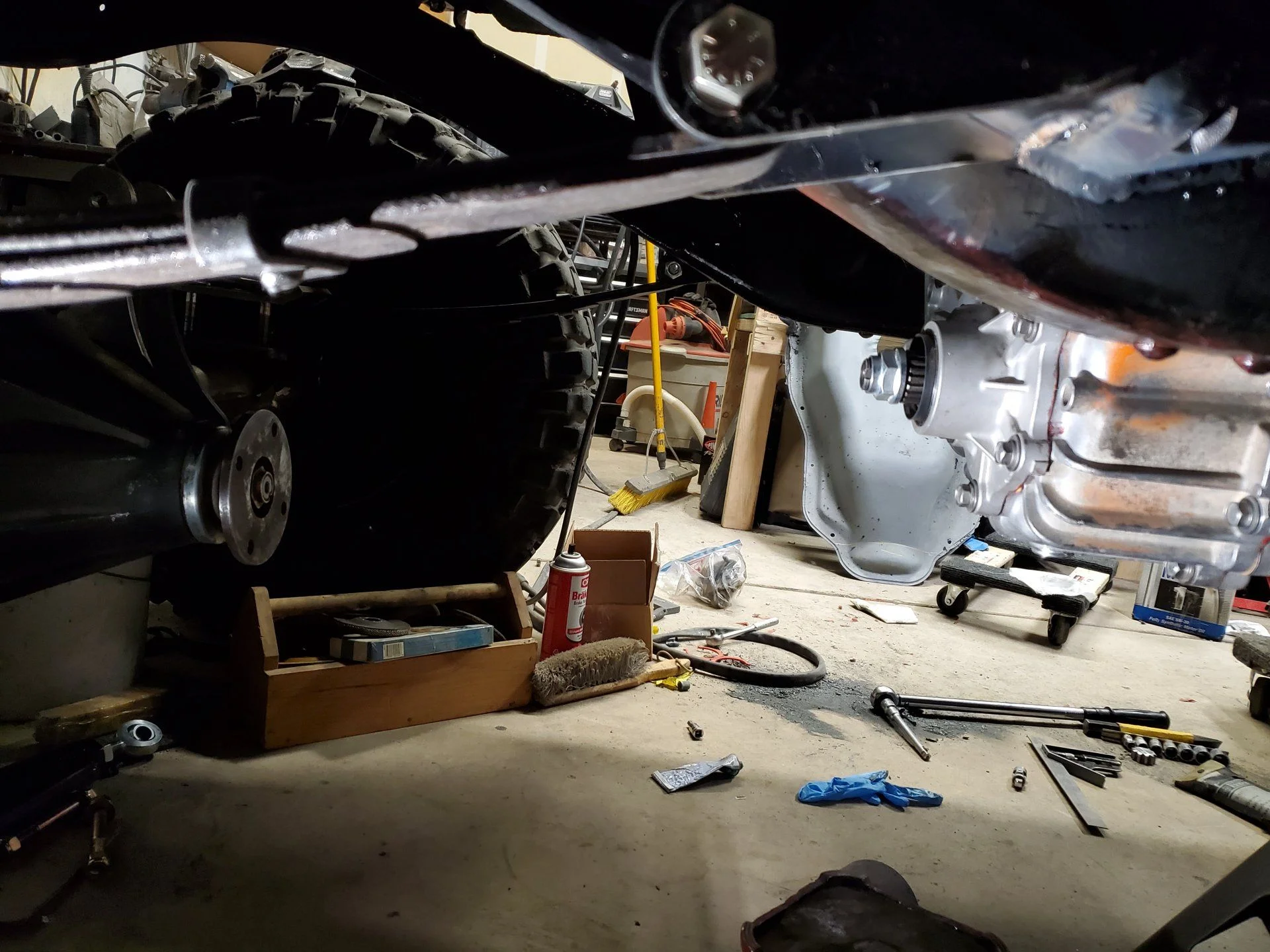

The rear driveshaft is going to be short at about 17". This is going to be interesting.
The front points about dead on. It's going to be about 42" long.
The drop down is a bit more than I want, so I need to notch the floor and get the hump to match. I think I need to raise it about 2"-3" to maintain my breakover angle.
17"? Damn.
Yep. The driveshaft guys said that they can probably fit a DC in 17". I may push the axle back another inch or so.
