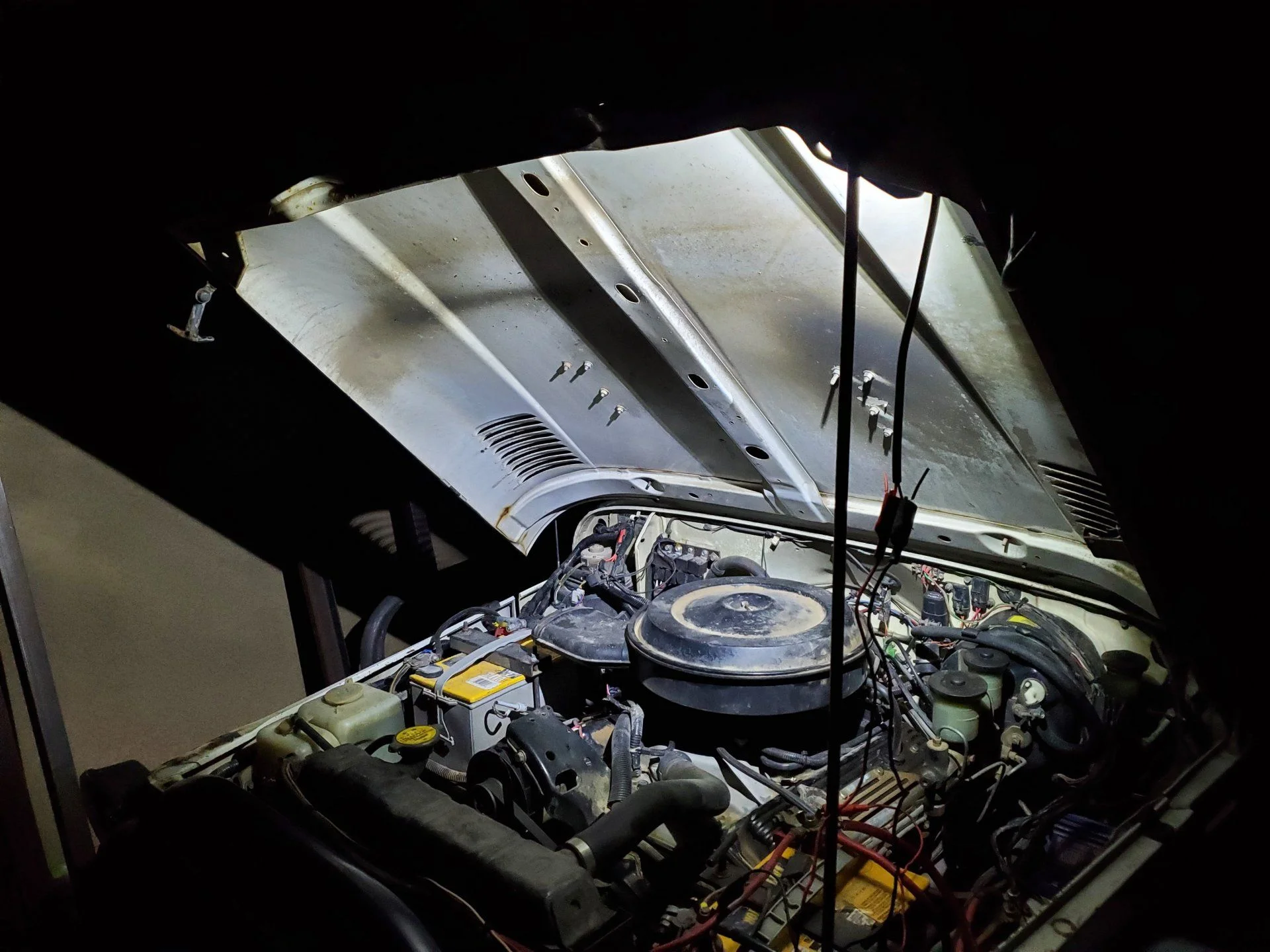

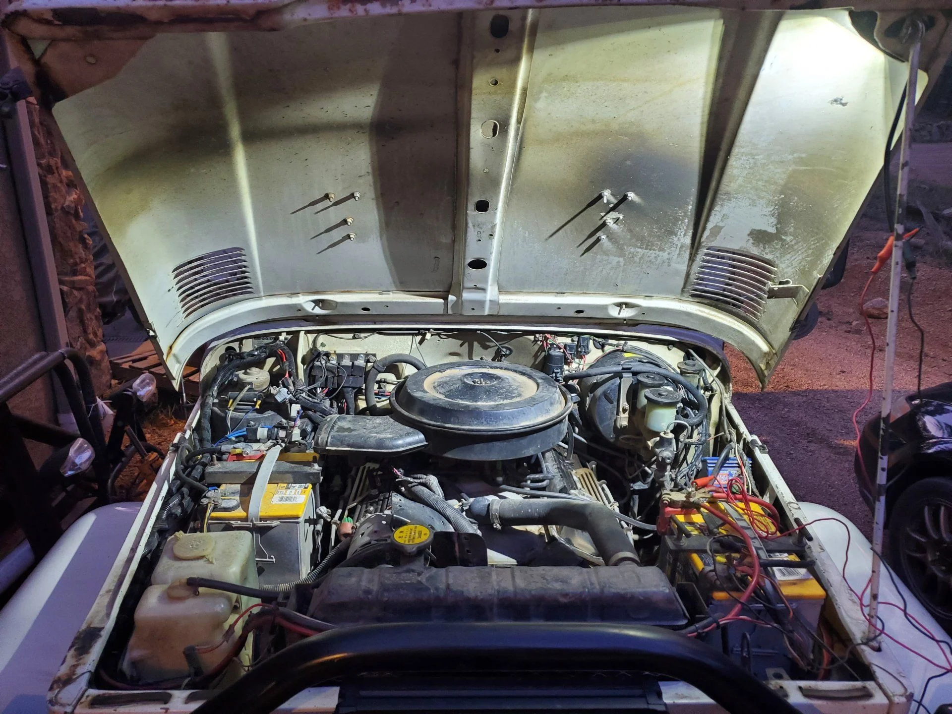

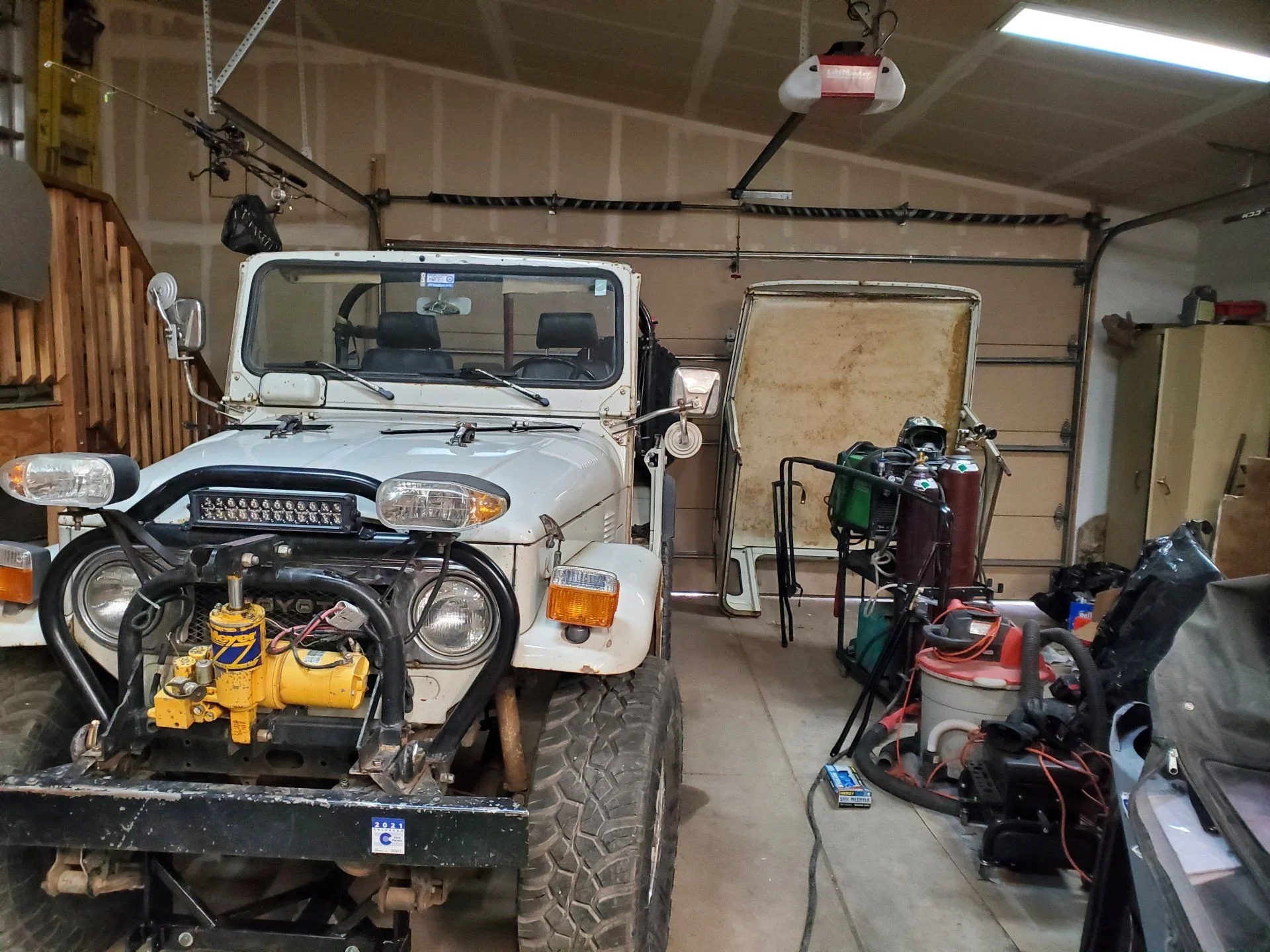

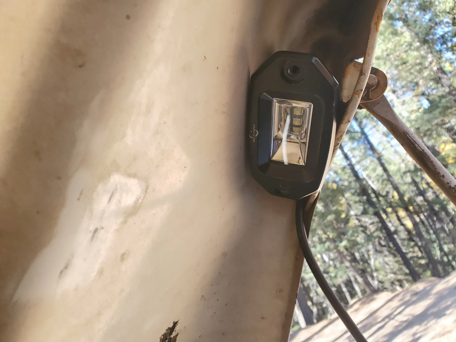

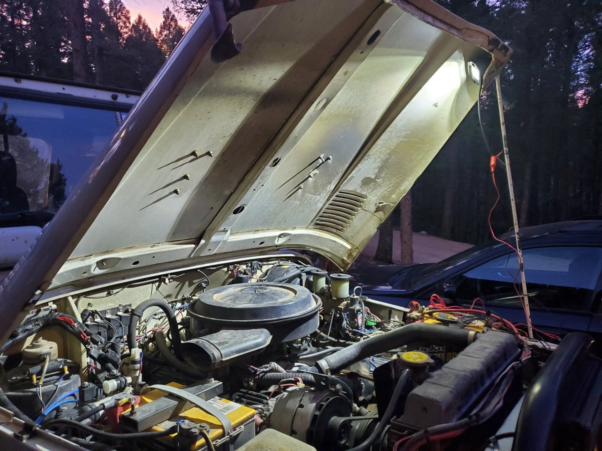

I got some little running lights to stuff in the bumper, and whilst screwing around with them, I found that they fit perfectly in the hood, making for a great engine bay light. They are also 180° throw, so it really covers the bay well.

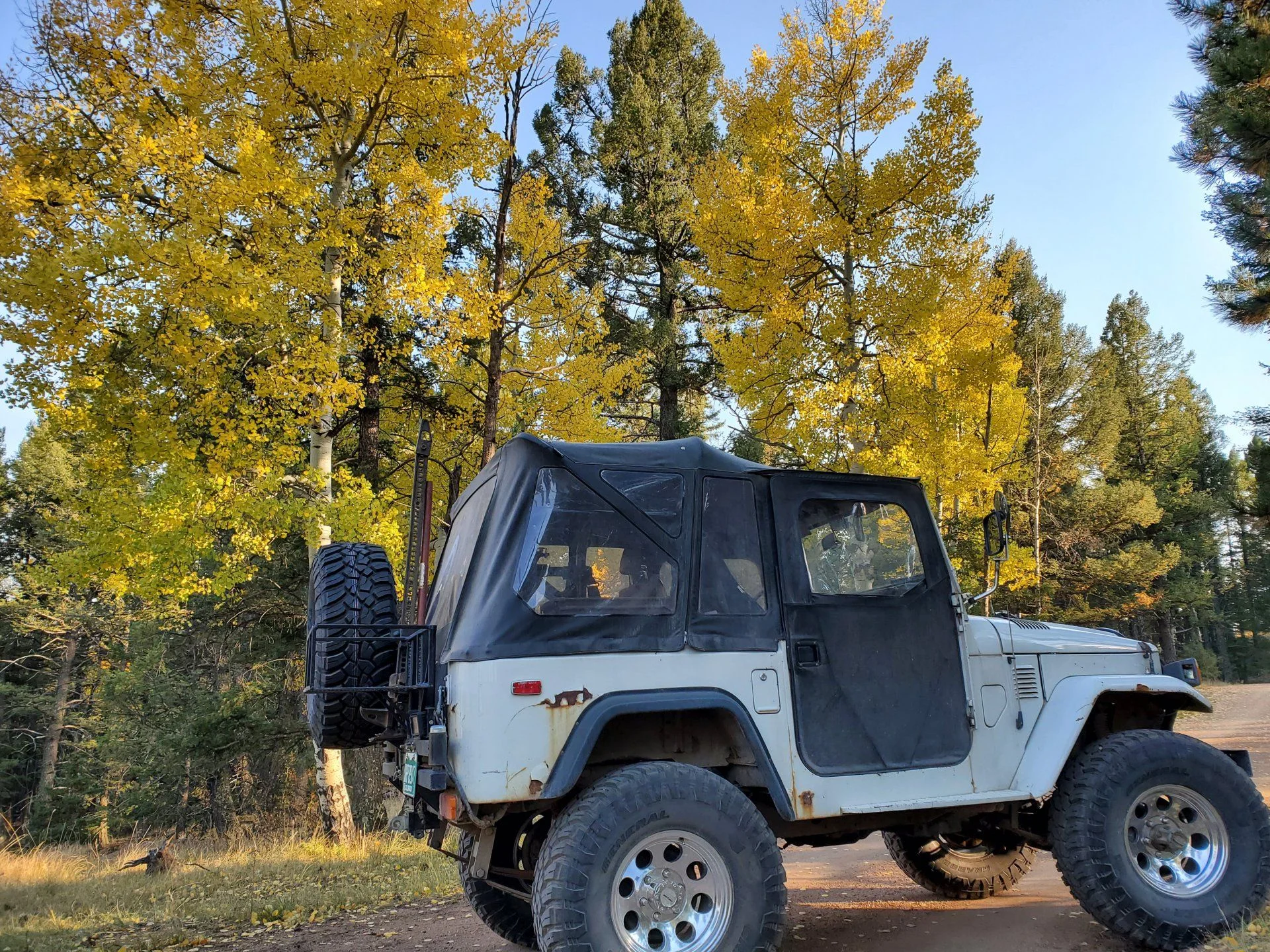

How about a quick break from all these tech posts? It's fall in the Rockies, so I took the white cruiser around the property and took some poser shots today.

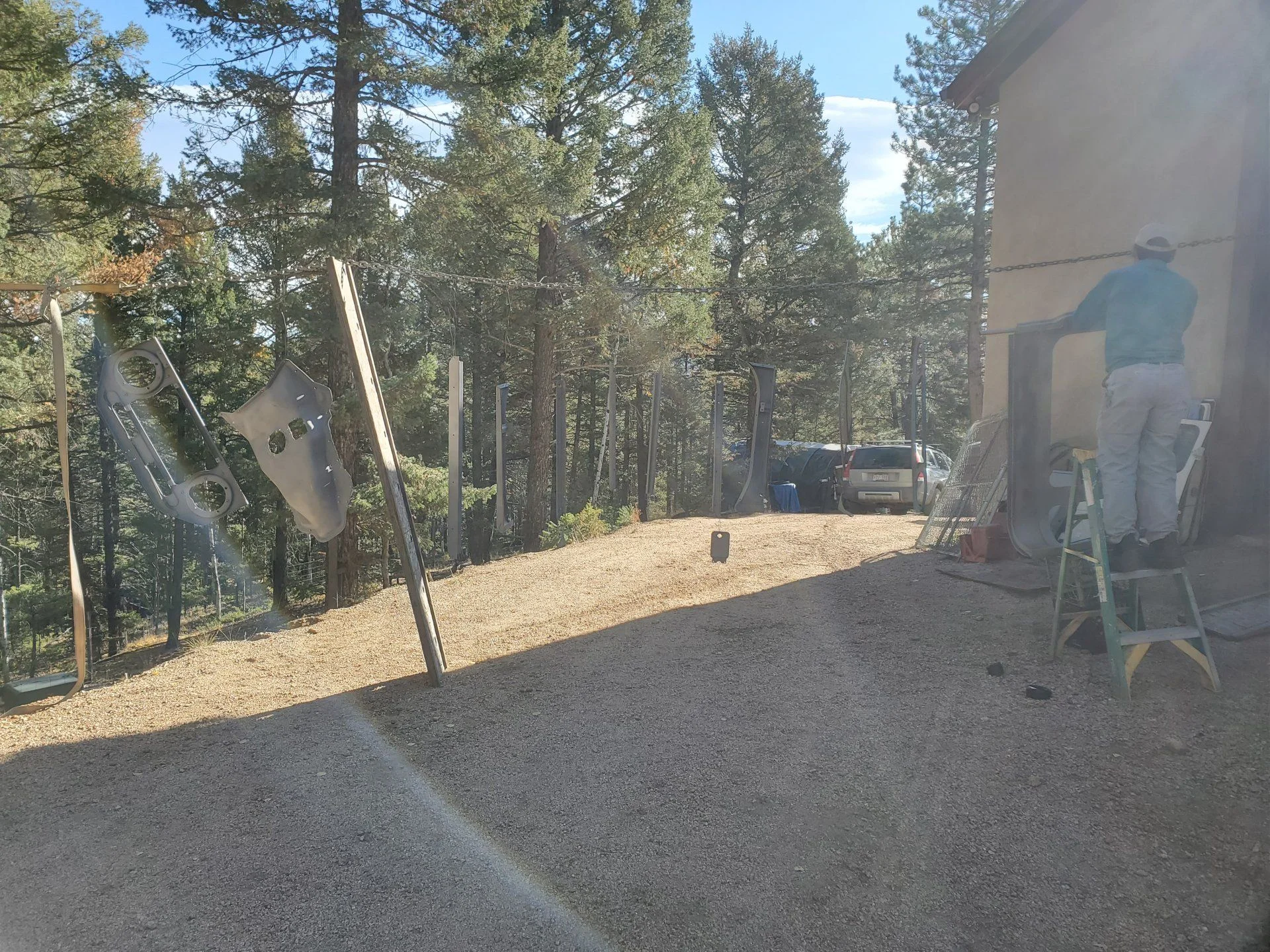

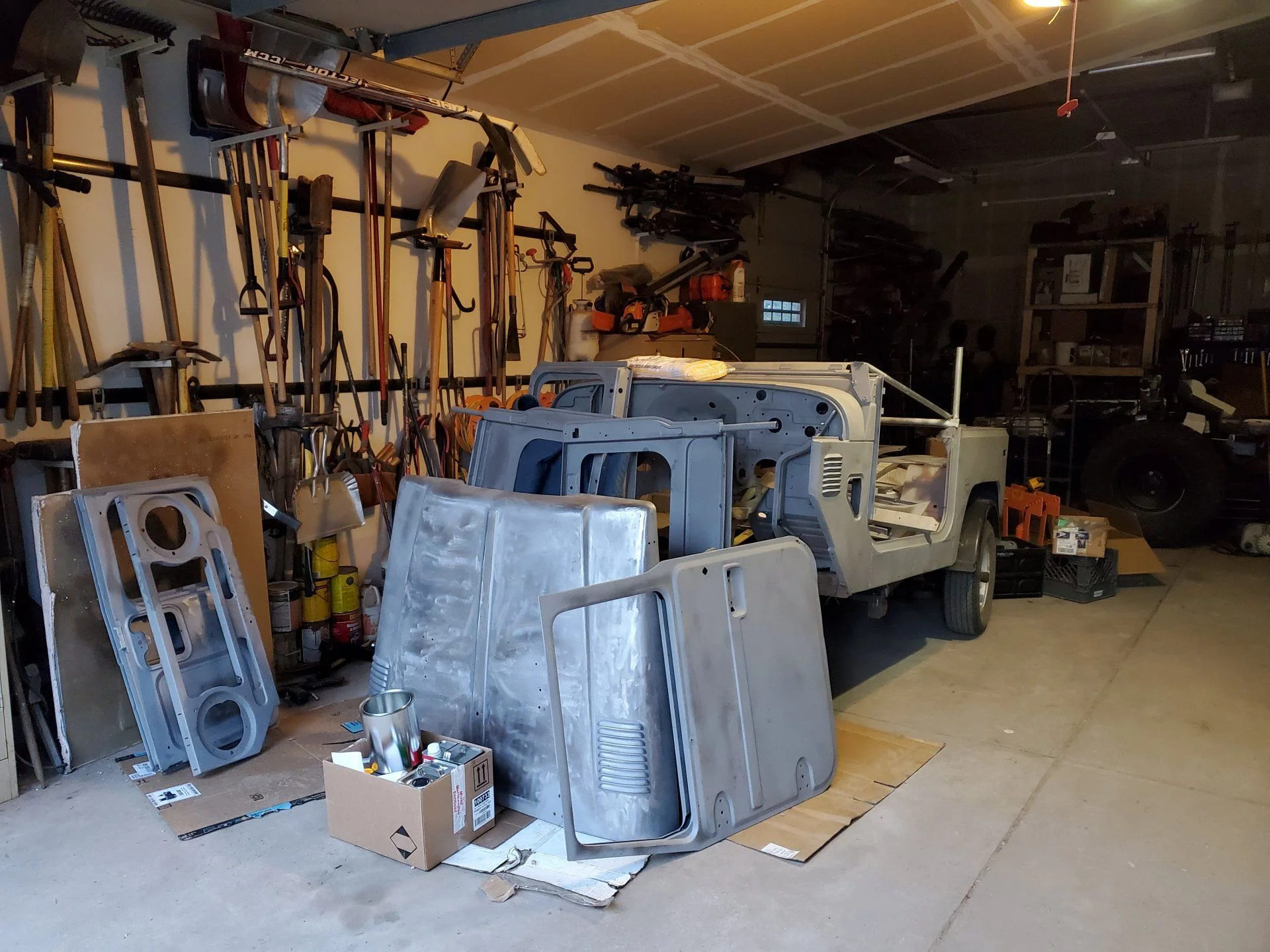

Everthing but the tub just got finished being blasted, and the tub is going to the blaster today.
I spent a while stripping as much of the bed liner as possible with a wire wheel, as the blaster cannot really get it off without a ton of work.
Cage coming off.

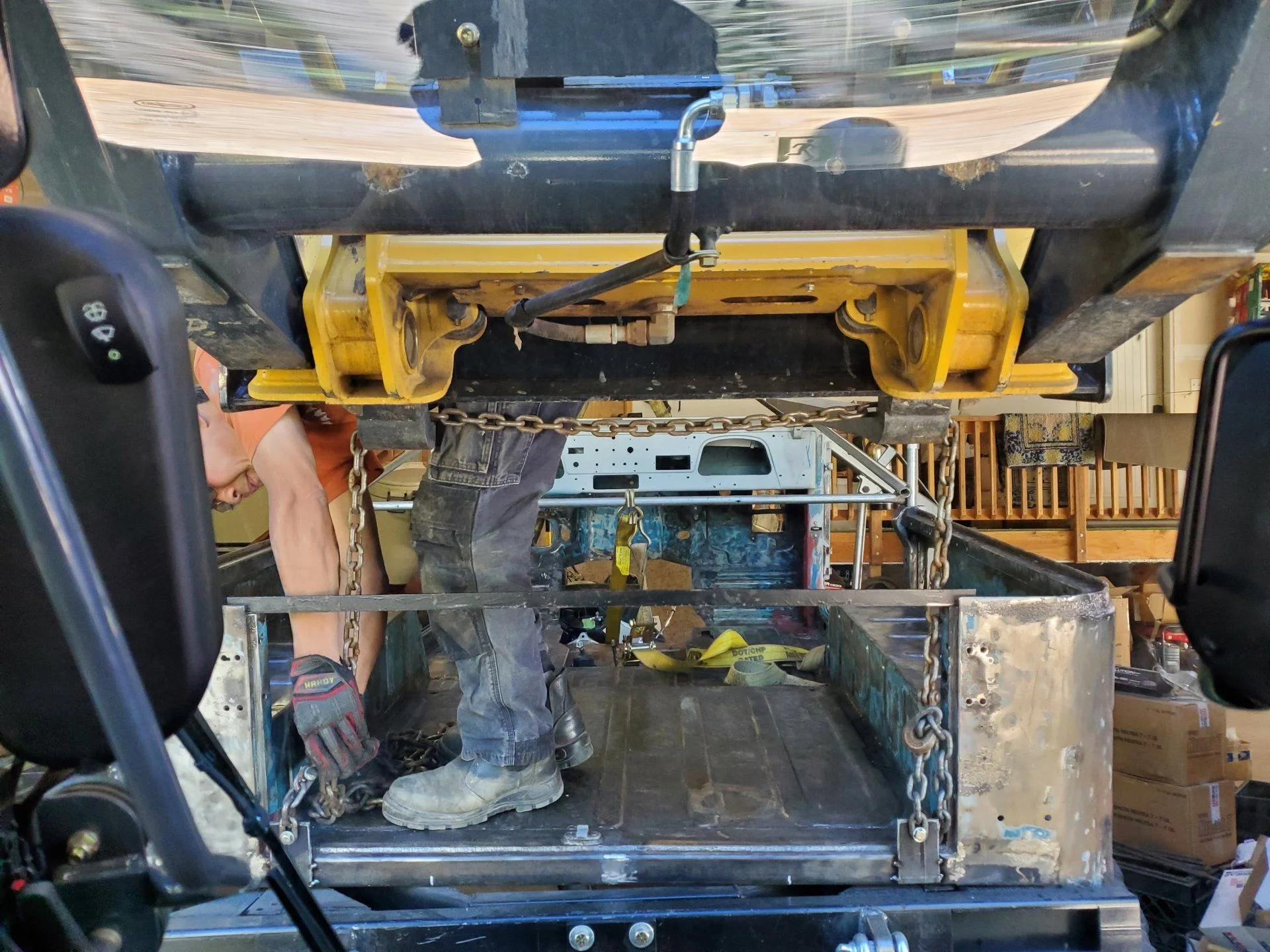

Pulling the tub was a bit of the pain, as the backhoe is on a job right now, so we used the skid instead.

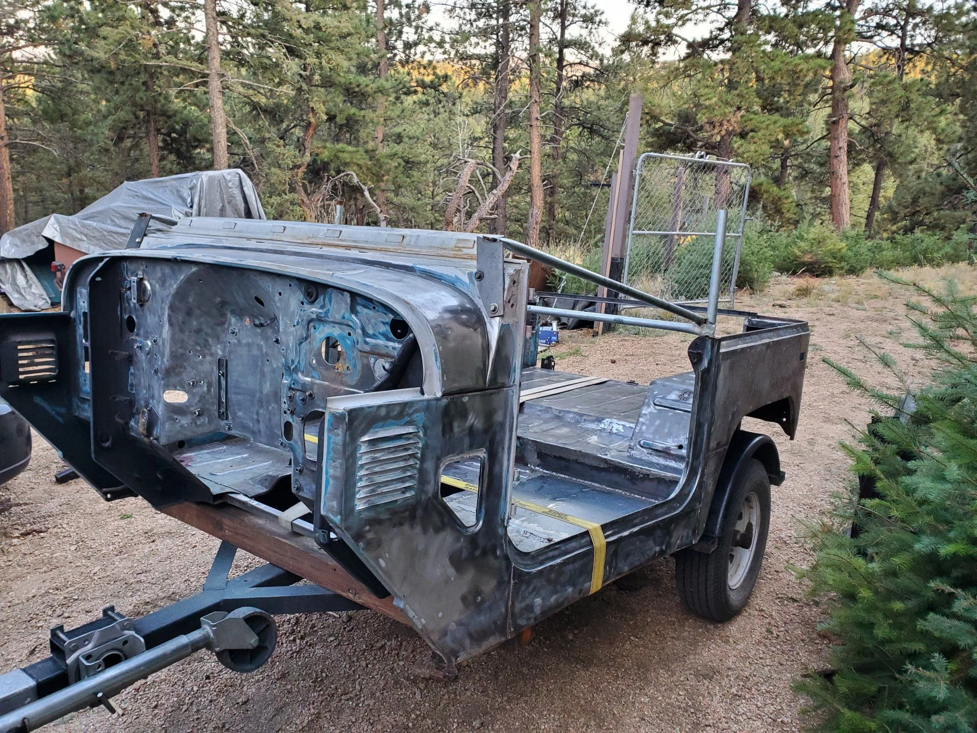

Tub off

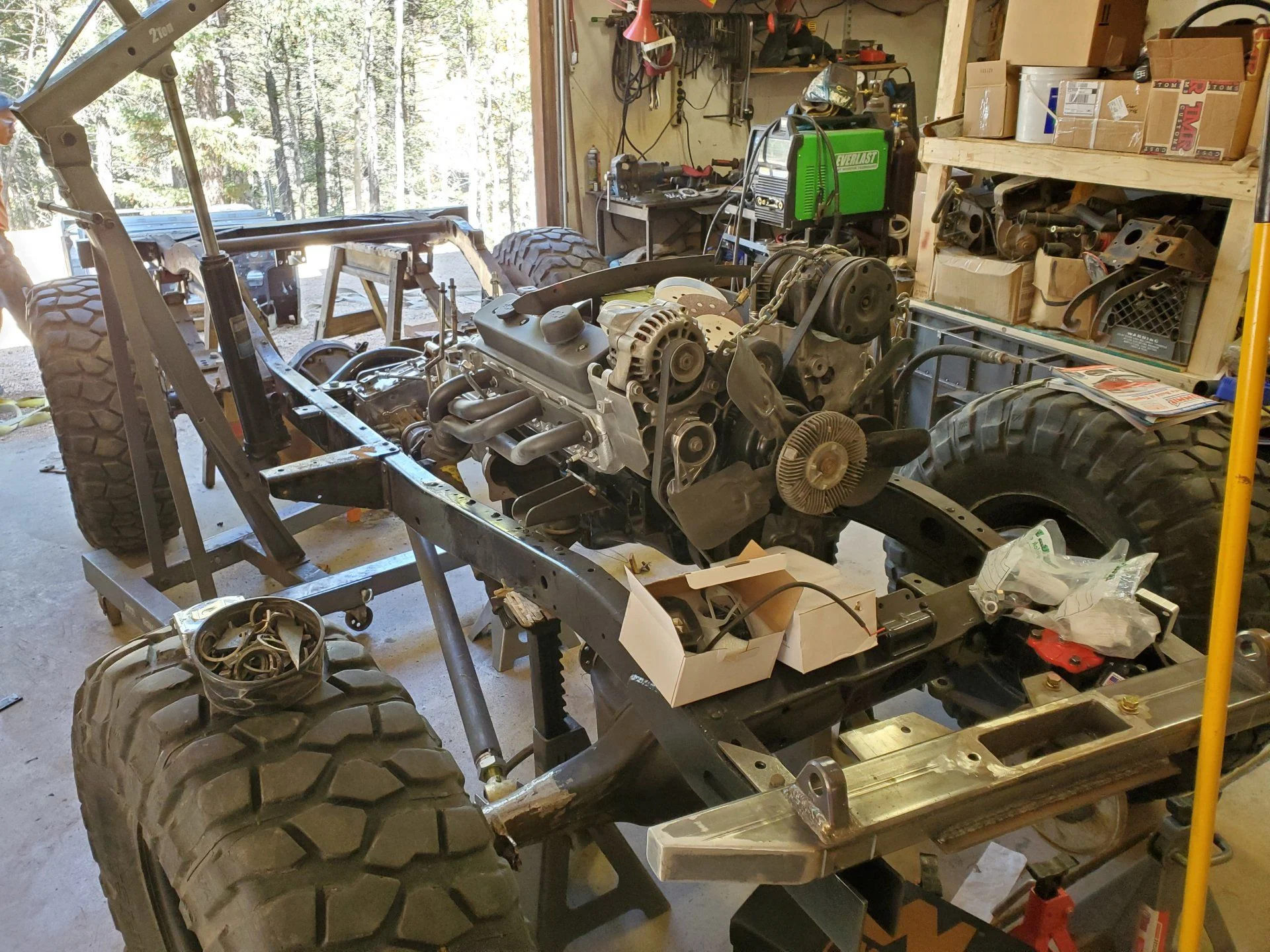

Back to a bare frame.

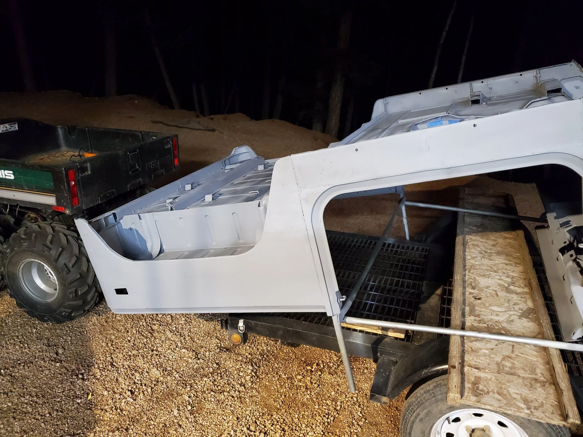

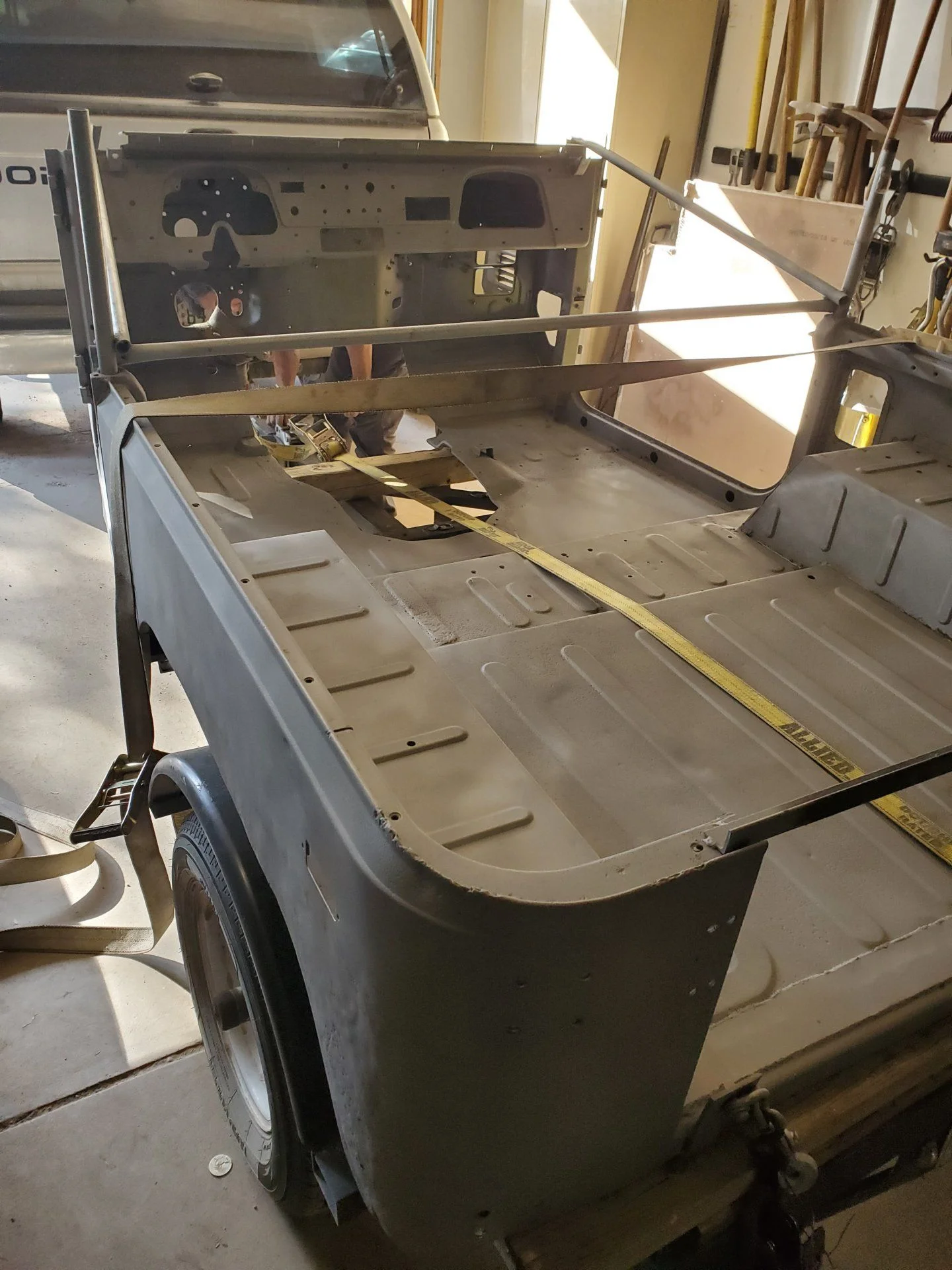

Tub loaded and ready to go.

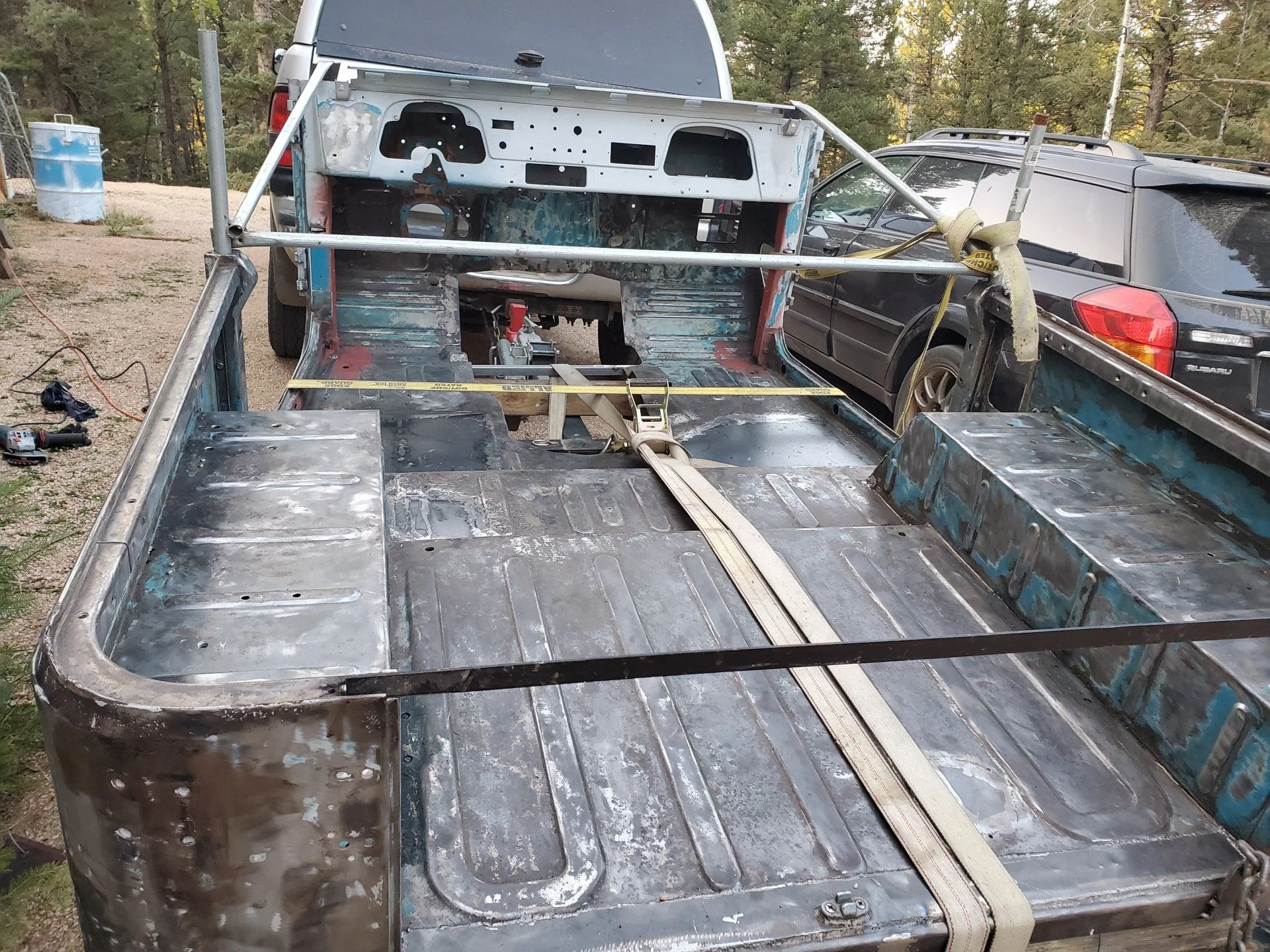

Tub back from blasting. It exposed a lot of cheese, but it isn't too bad overall.

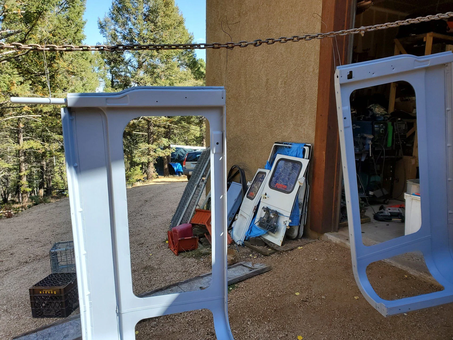

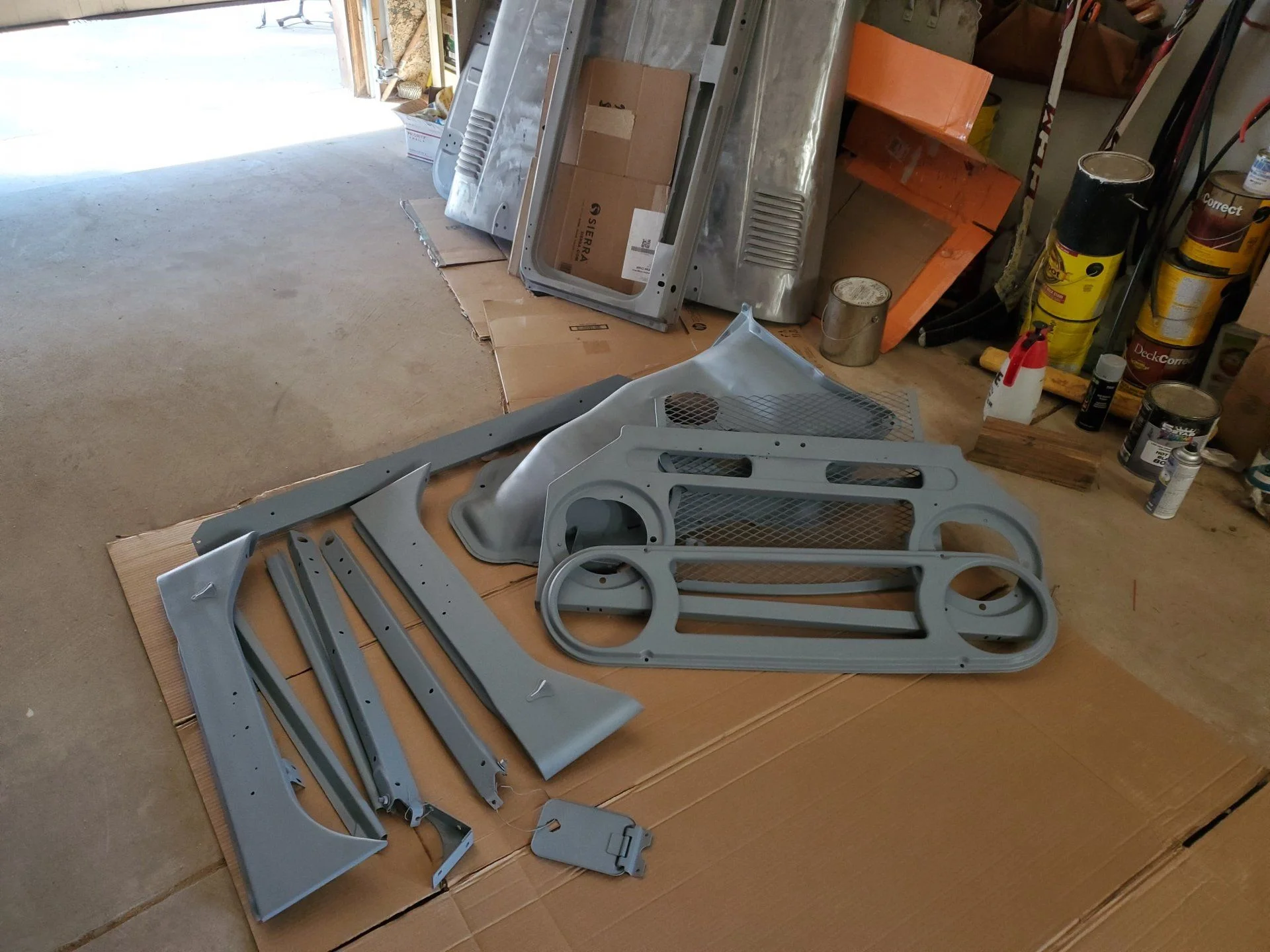

Getting primed.
Everything primed. I still need to do the top of the hood and bottom of the tub, as it decided to snow right as I was about to start on those. :doh:

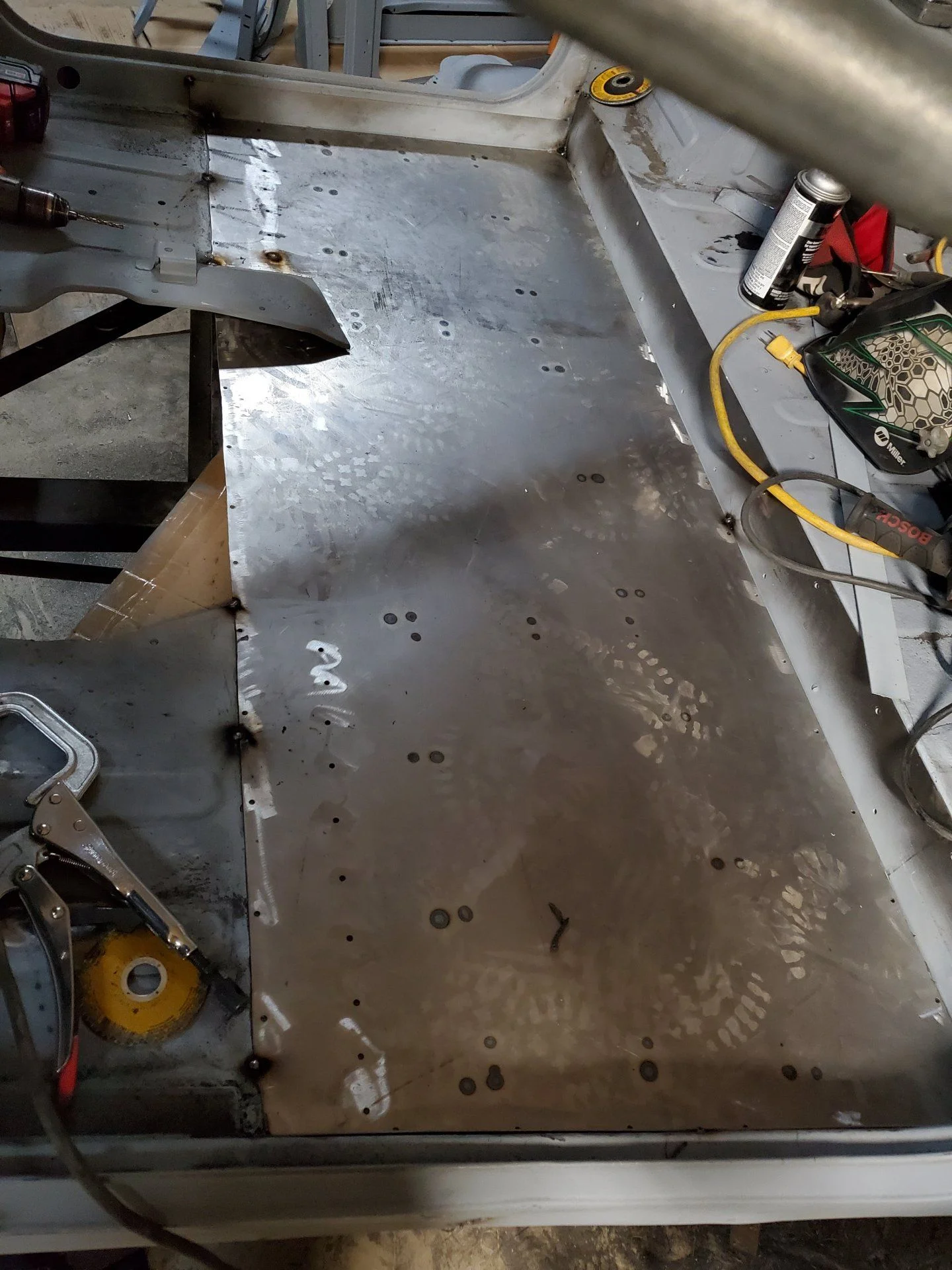

The blasting exposed a ton of cheese in the middle of the floor pan by the transmission hump, and overall I was not happly with the quality of the patches I put in earlier, so I decided to properly replace it. The fuel tank I'm building is going to go all the way across the cab, so I am wanting a good, flat surface to mount it on.
The tub started like this today.

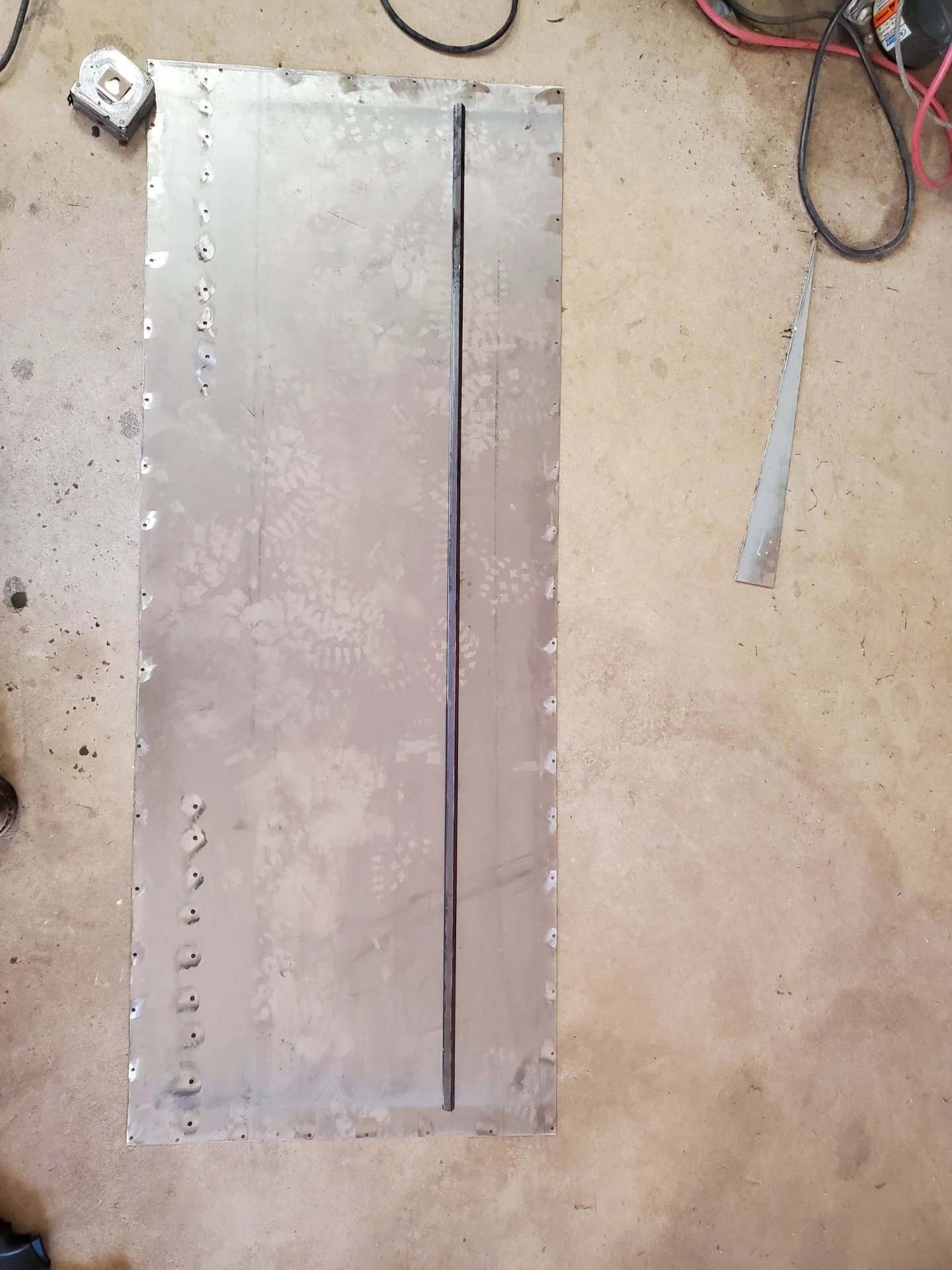

Patch panel made. I decided to go with a bunch of holes to fill instead of butt joints for the panels.
Replacement rear sill going in.
Test fit.
Final fit and partially tacked. I will finish weld the rest tomorrow.

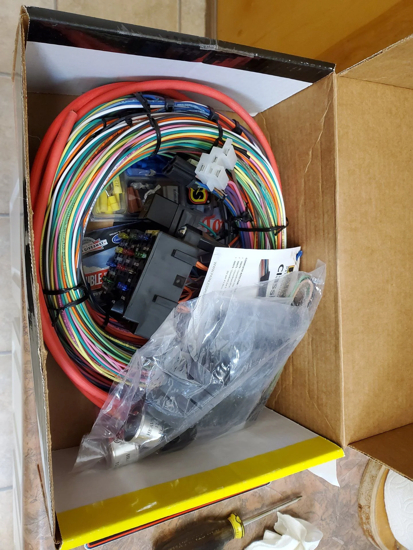

Wiring harness finally showed up too, so another project to get started on once everything is painted.

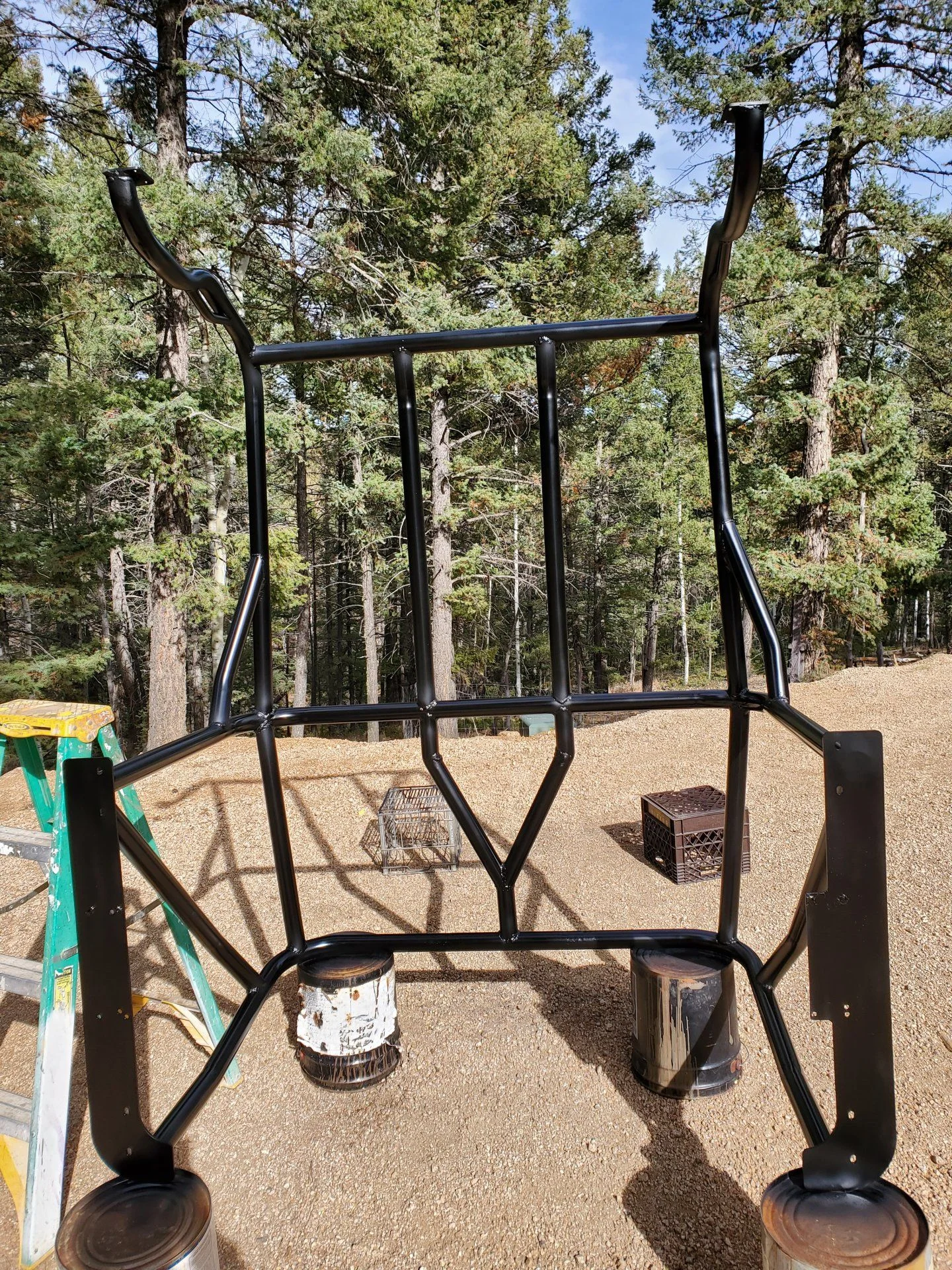

I got the cage painted to keep it from rusting in case it needs to stay outside at some point.

I used a painless harness when I re-wired my truck, so nice to have each wire tagged the entire length. I re-printed the from/to table and write extra details as I went to help with future troubleshooting.
Did you reuse factory connectors when you did yours?
I didn't reuse many factory pieces, but where I did, I plucked the Toyota connector off the old harness and added it onto the Painless harness. This would allow me to replace any Toyota parts and have them connect into the harness. I think the only electrical bits I used from the original truck was the steering column and the wiper motor. I didn't re-use any switches, nor the heater.

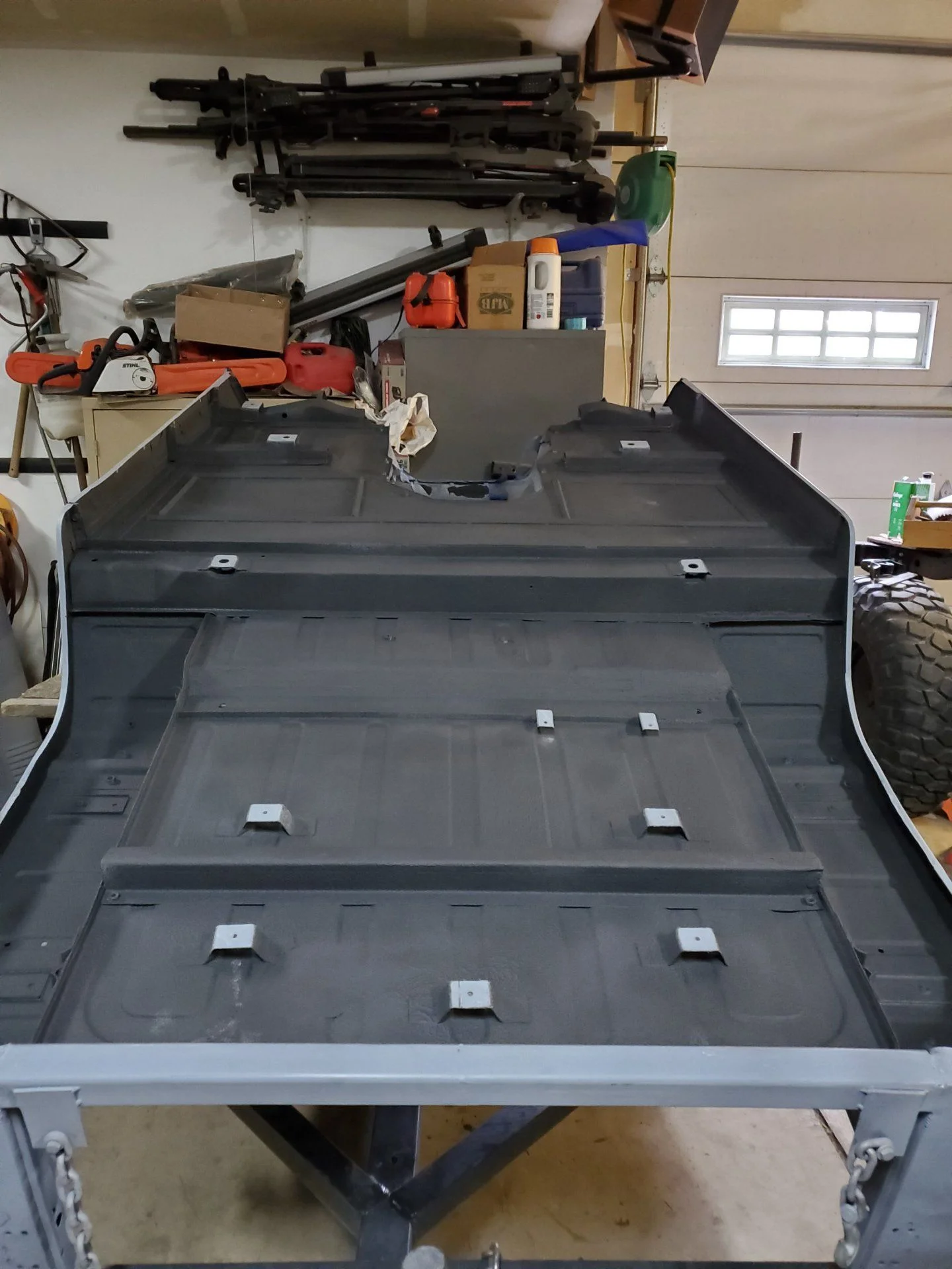

Lizard Skin
First coat of Lizard Skin sound deadening on.
Second coat dry.

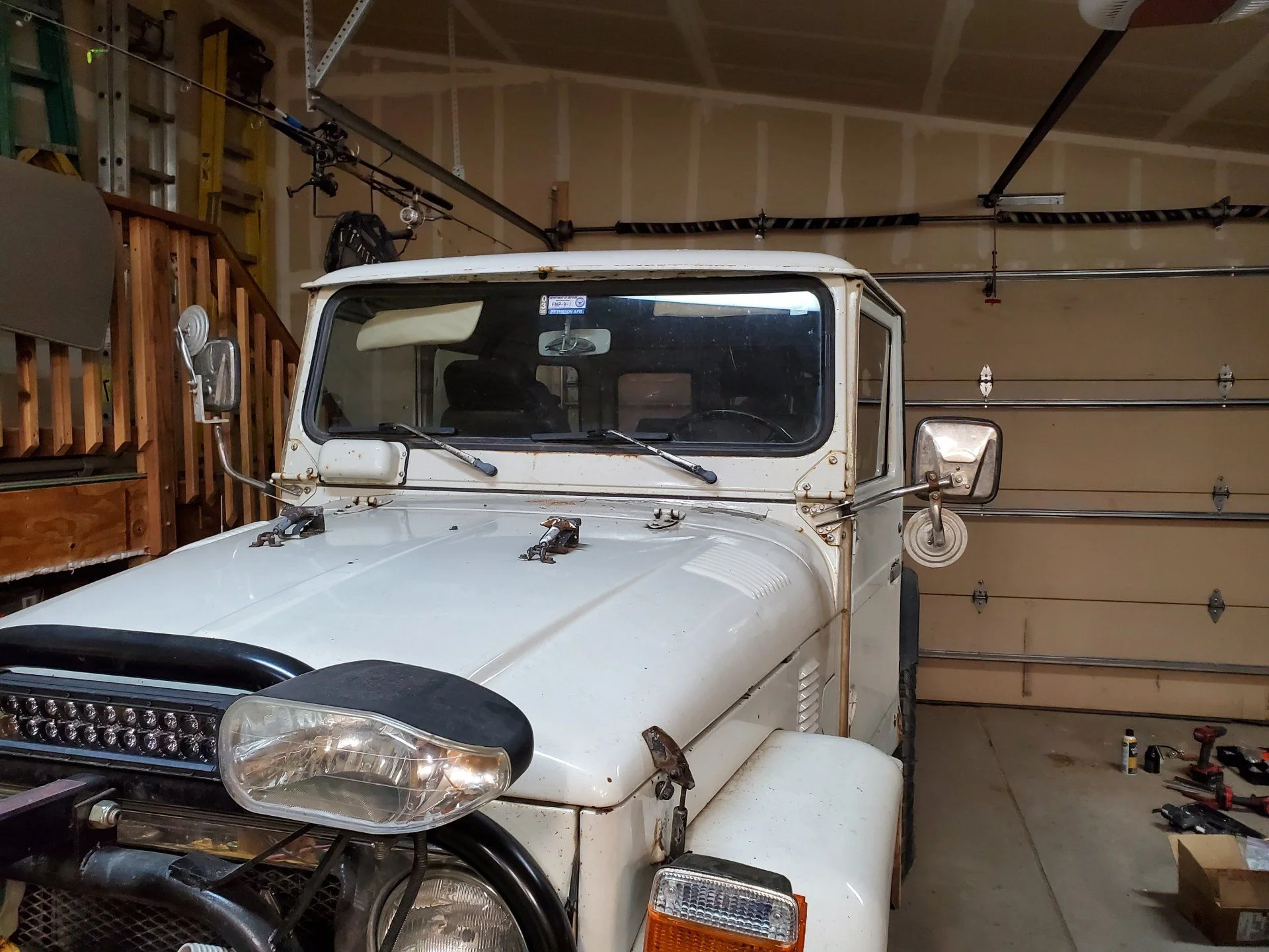

I also get the hard top back on the white cruiser with my dad. It's been in storage for about 11 years, and I'm glad that everything fit on.
