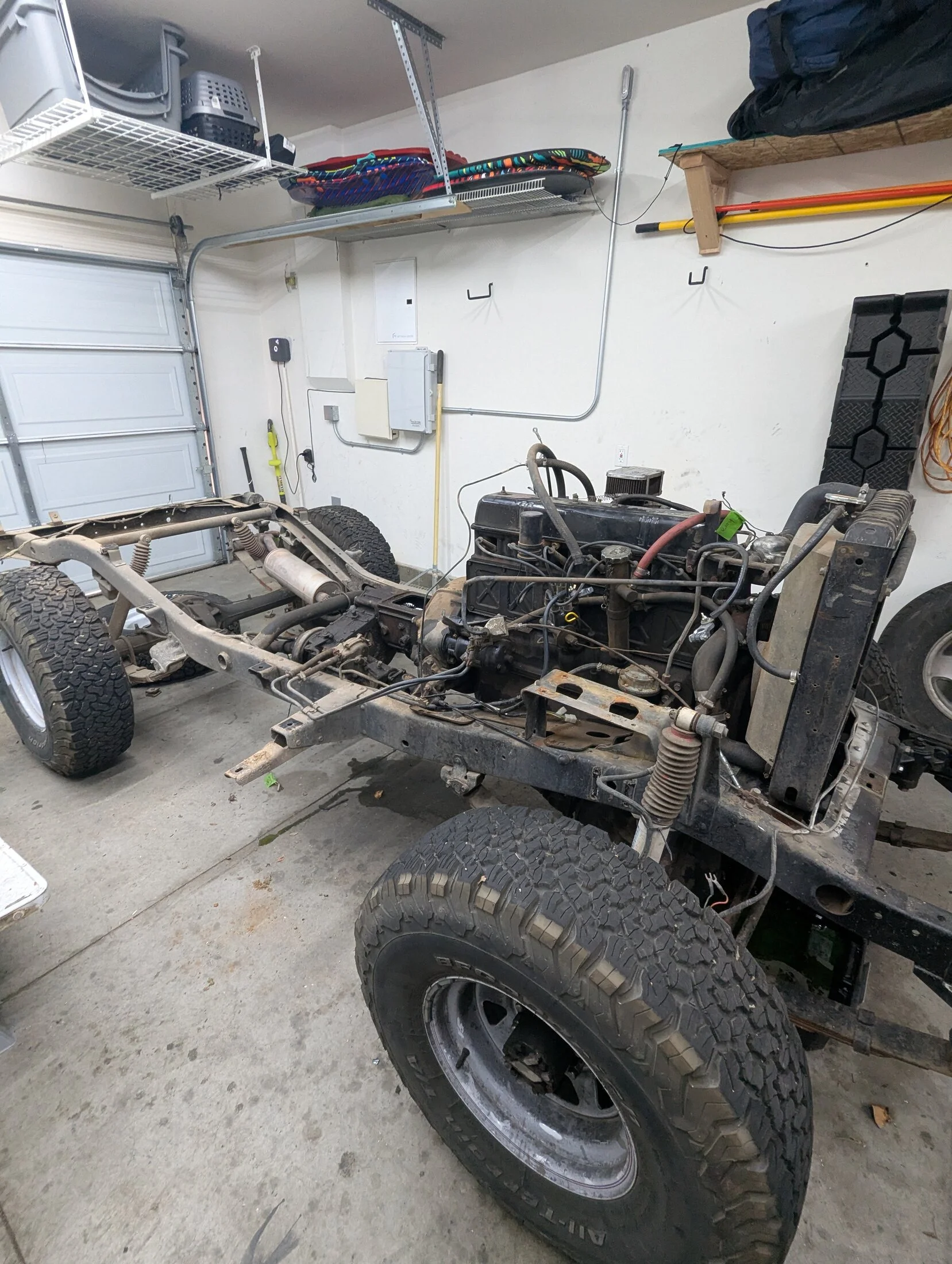

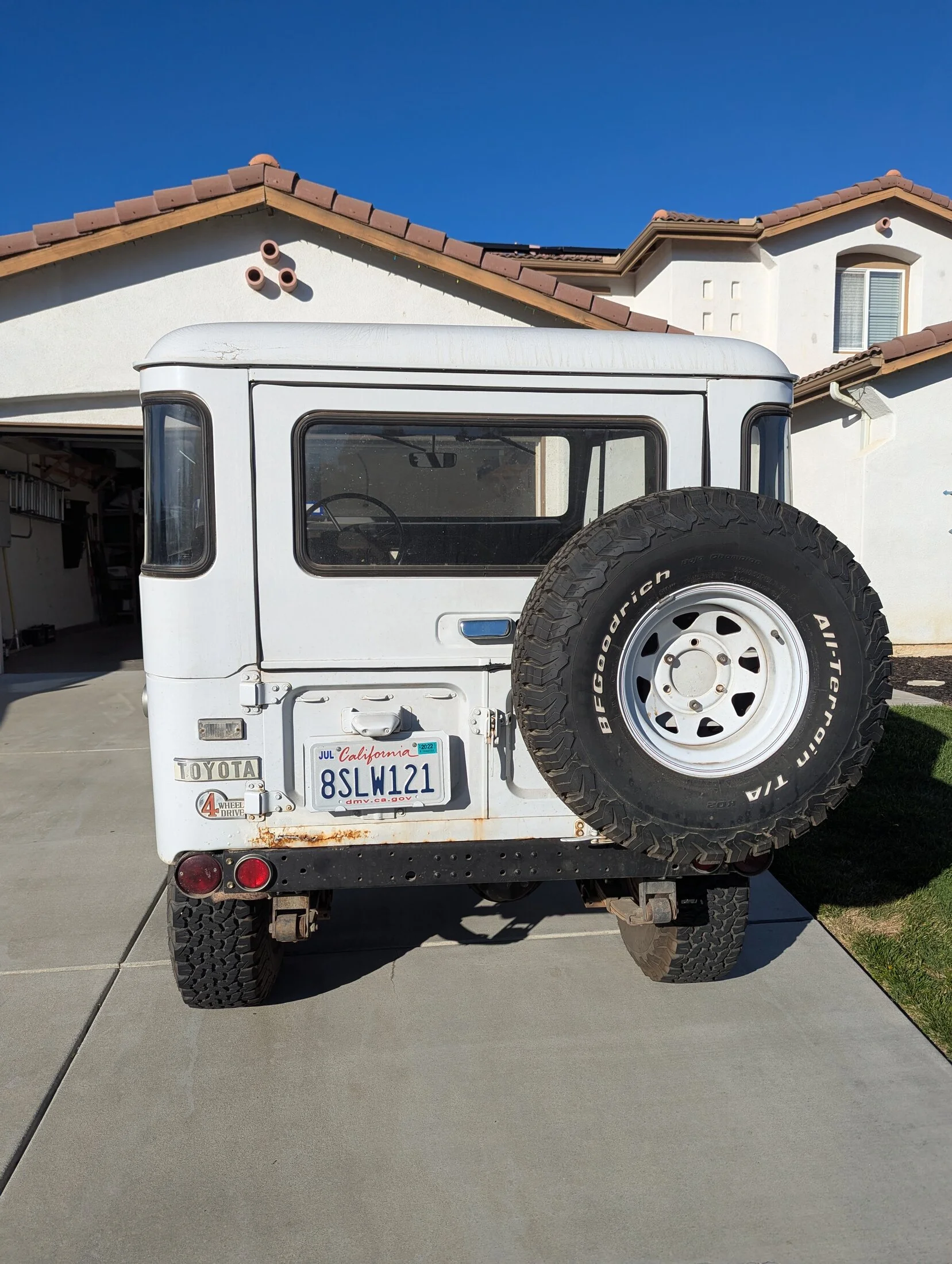

So I bought this 40 back in 2020 from a mud member in Texas with the intentions of doing a frame off at some point. Well that time is now.
Plan is take it back to as original as possible but not attempting to do a concourse level restoration either. Not putting in a 2F or 4 speed. Want to convert it back to column shift. I believe it was originally green. I kinda want to go spring green but will make that call when it's time to do paint.
Plan is to get the body off and engine/trans off and start with the frame. Do engine and trans work second and body/paint last. That will give me time to practice welding before I get to the body. My timeframe for all this is 1-2 years.

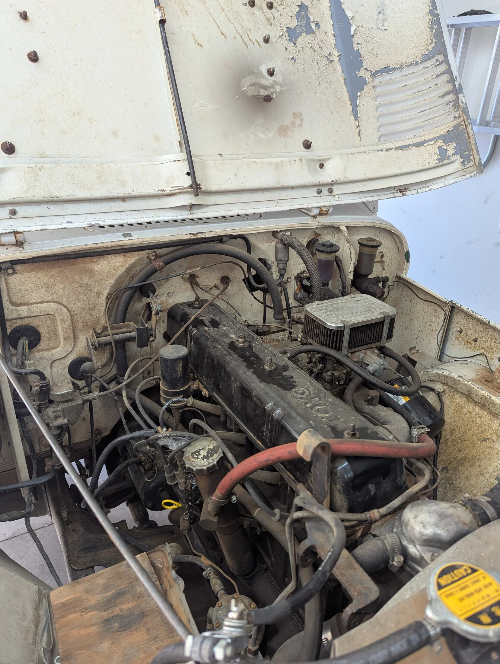

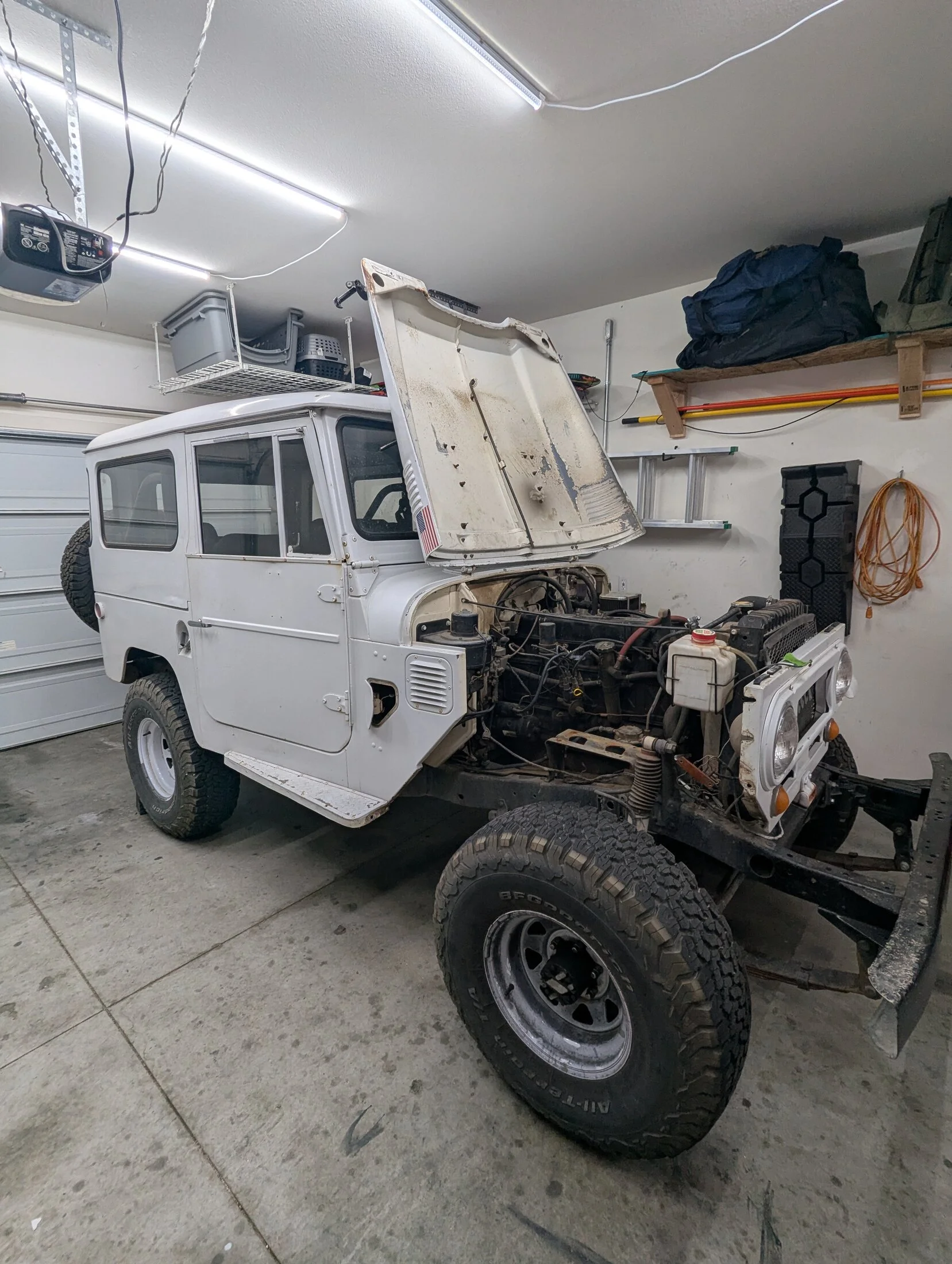

Now for pics. Here is what I'm starting with.

Man, nice rig as is. I get you want to “bring it back to original”. Seems like you could just do electrical and mechanical and drive as is. Many do full resto and get scared to use it.

So I'm actually not a fan of the patina look. Nothing against people who are but not for me. It's gonna get painted and while I have no plans to off-road it once completed it will get driven. I have an 80 for off roading.
As for the modernization comment unless I have no choice on something due to parts availability or something I don't plan on adding disc brakes, power steering none of that. Will consider the aux tank though. Or if something like it needs new pistons comes up and I guess from what reading I've done pistons for 1Fs are non existent then I'll consider going 2F if stuff like that comes up.

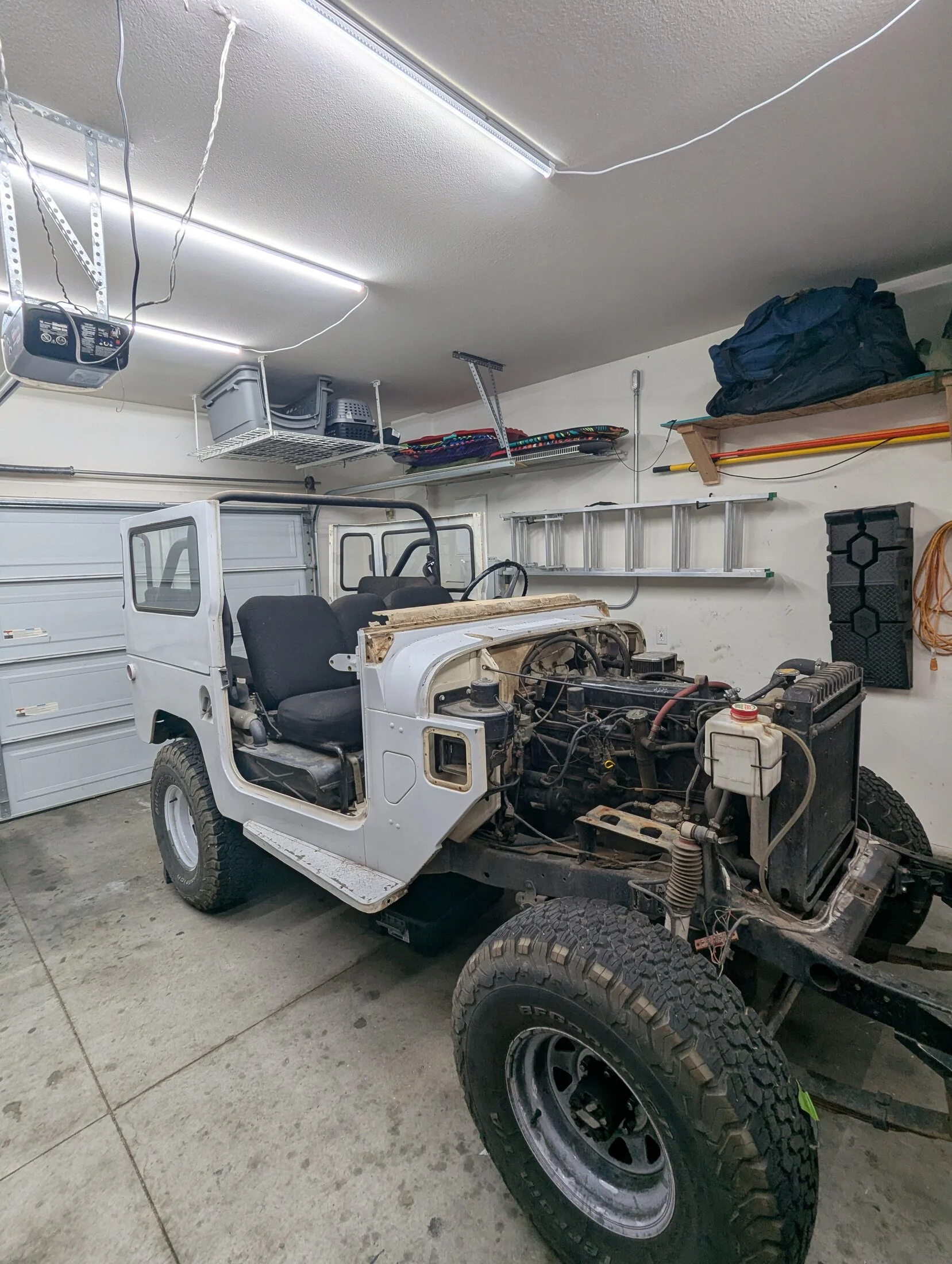

Today's progress.
You got this :cool:

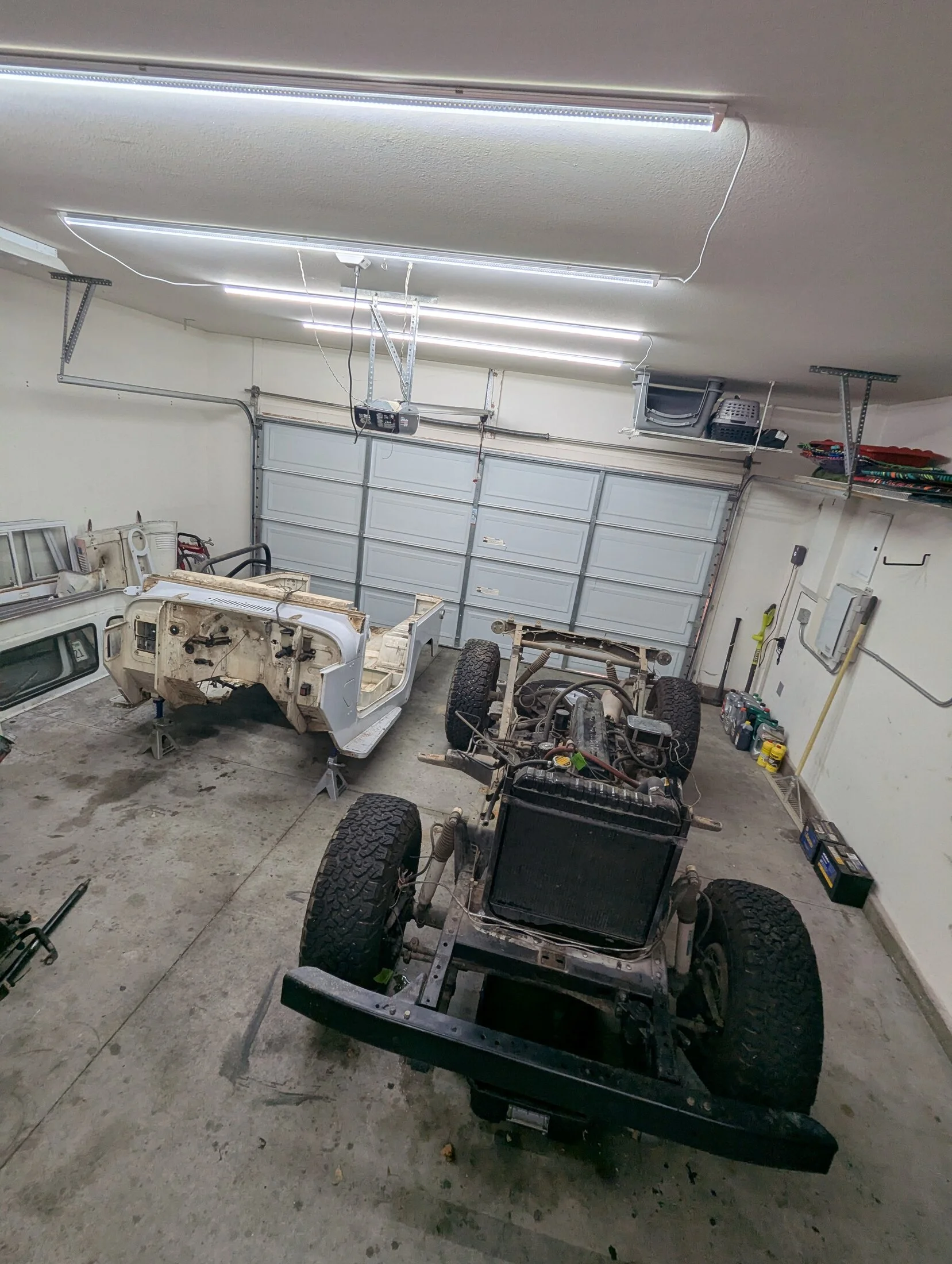

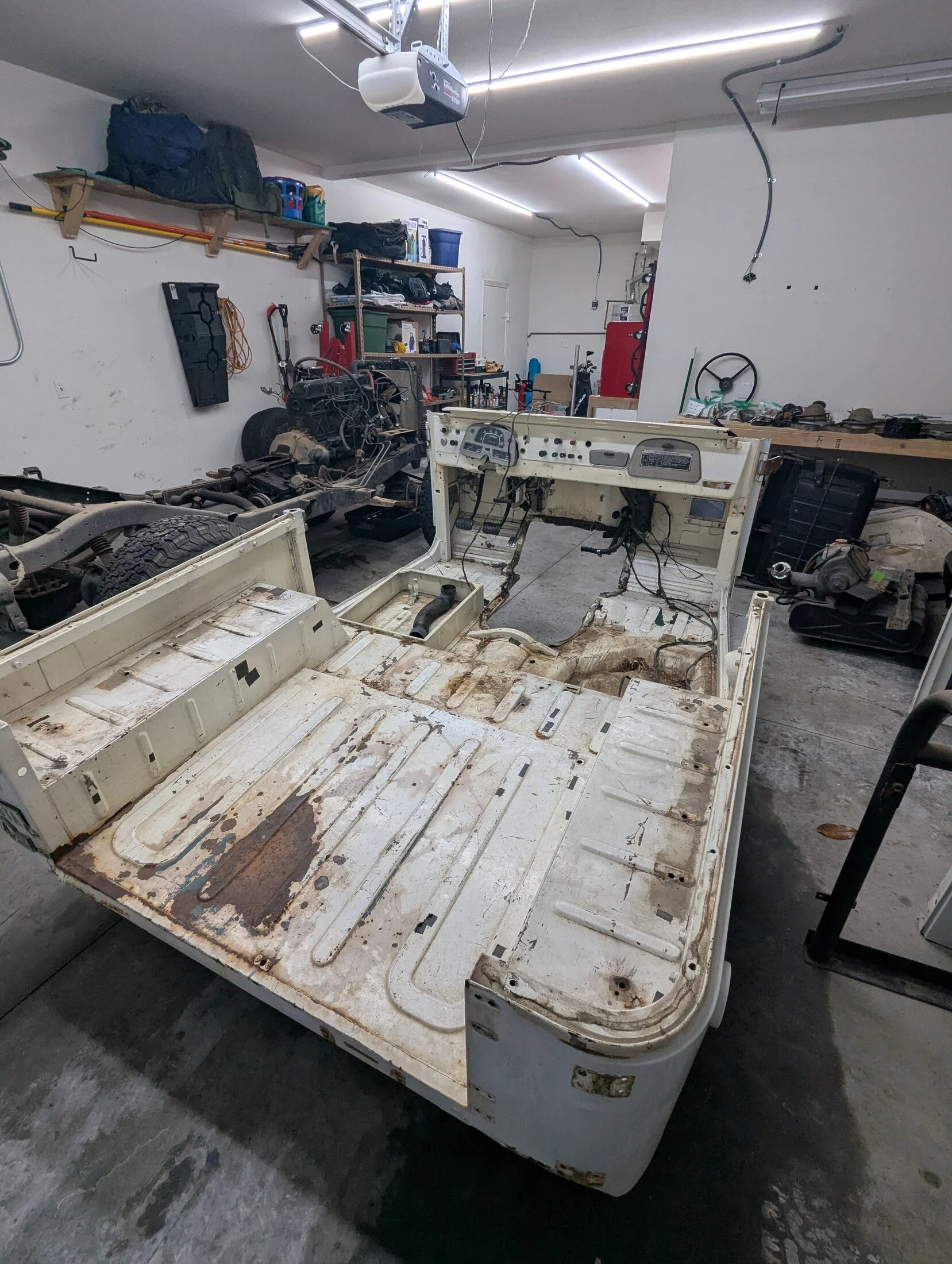

Down to just the tub now. Hopefully get that off tomorrow. Only had two cut two bolts so far and broke one. Plan on replacing all the hardware anyways. Plus everything is mix match to begin with and in some places they used screws instead of bolts. Huge pet peeve of mine when they use different sizes on the same piece. Makes it take so much longer to get a part off.

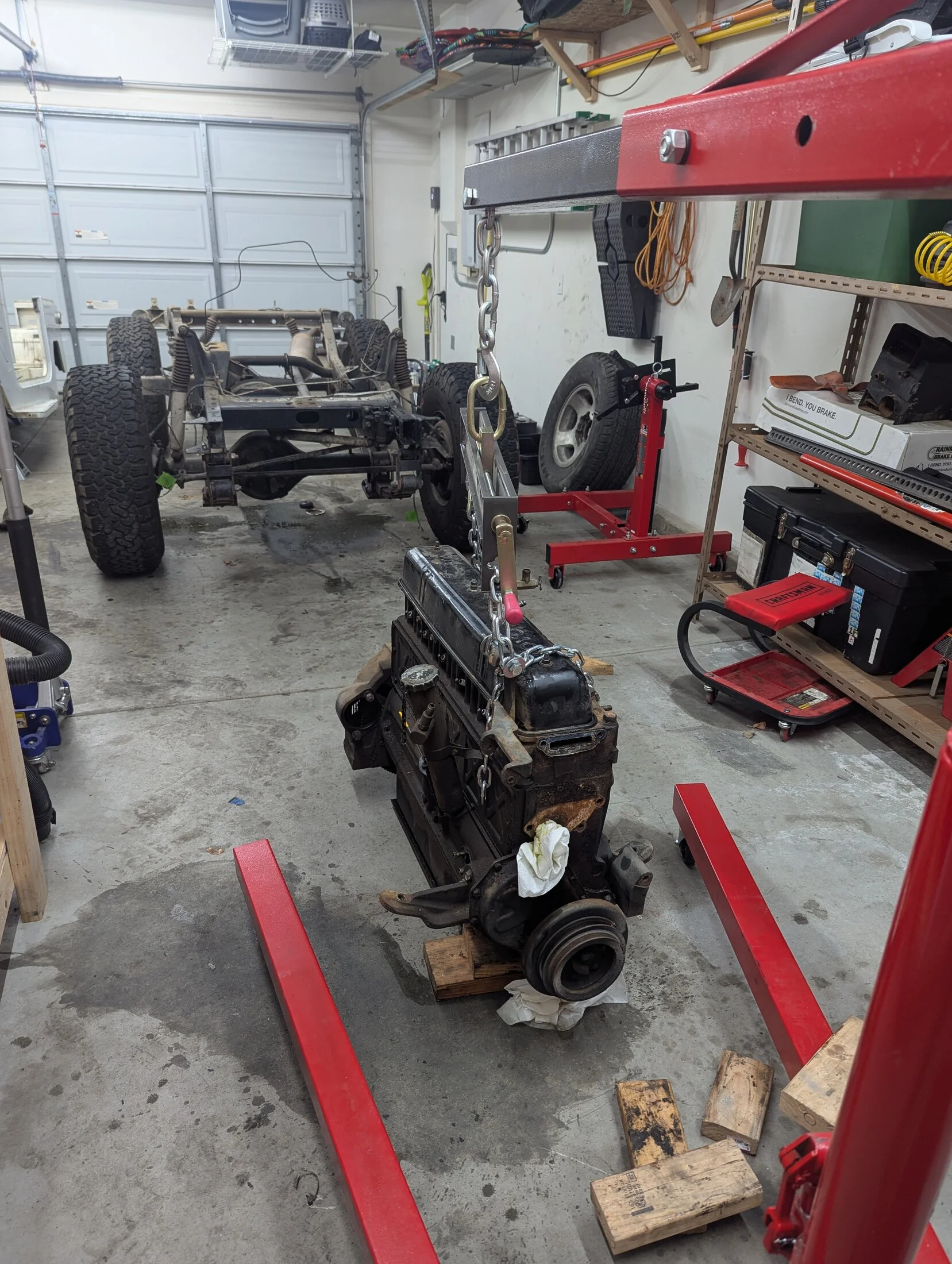

Engine and trans off. I gotta look into how to get the bell housing off the engine so I can put it on an engine stand. Looks like there are some bolts inside the housing i got to get too. That will be tonights googling. Will download the service manuals too since I'm to that point now.
Got the engine on a stand today. Not a fan of the bell housing setup. Feel like they could have made it removable without first having to remove the clutch and flywheel. Had a bunch of ball bearings fall out of the flywheel shaft so one of the bearings is toast.

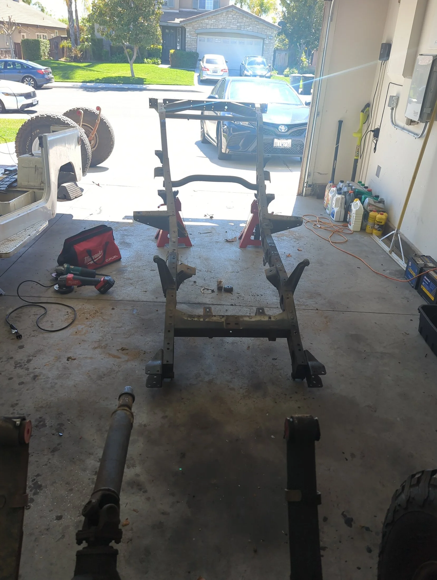

Today is the end of my 10 day vacation too so expect progress to slow down going forward from here. My goal for my next days off are to finish stripping the frame, roll it outside and power wash it. Then the following weekend get the axles off so i can start repairing the frame if needed and painting it.
Frame is completely stripped. Only thing I had to do was cut off one bracket that someone had welded on for some unknown purpose. I'm gonna get it galvanized, already got a quote from a local place, cheaper than sandblasters wanted. See if I get it done before heading out of town this week or do it when I get back.

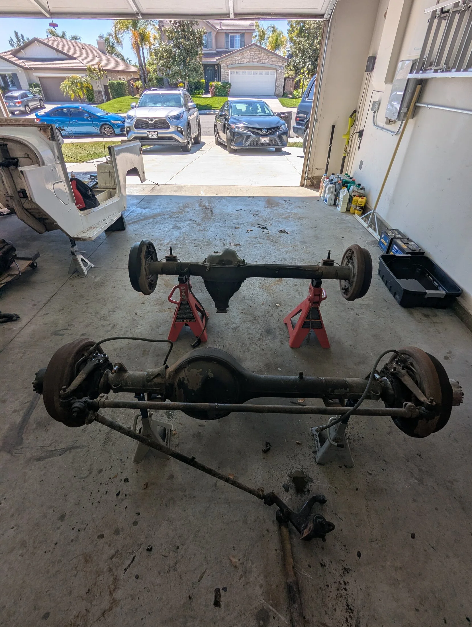

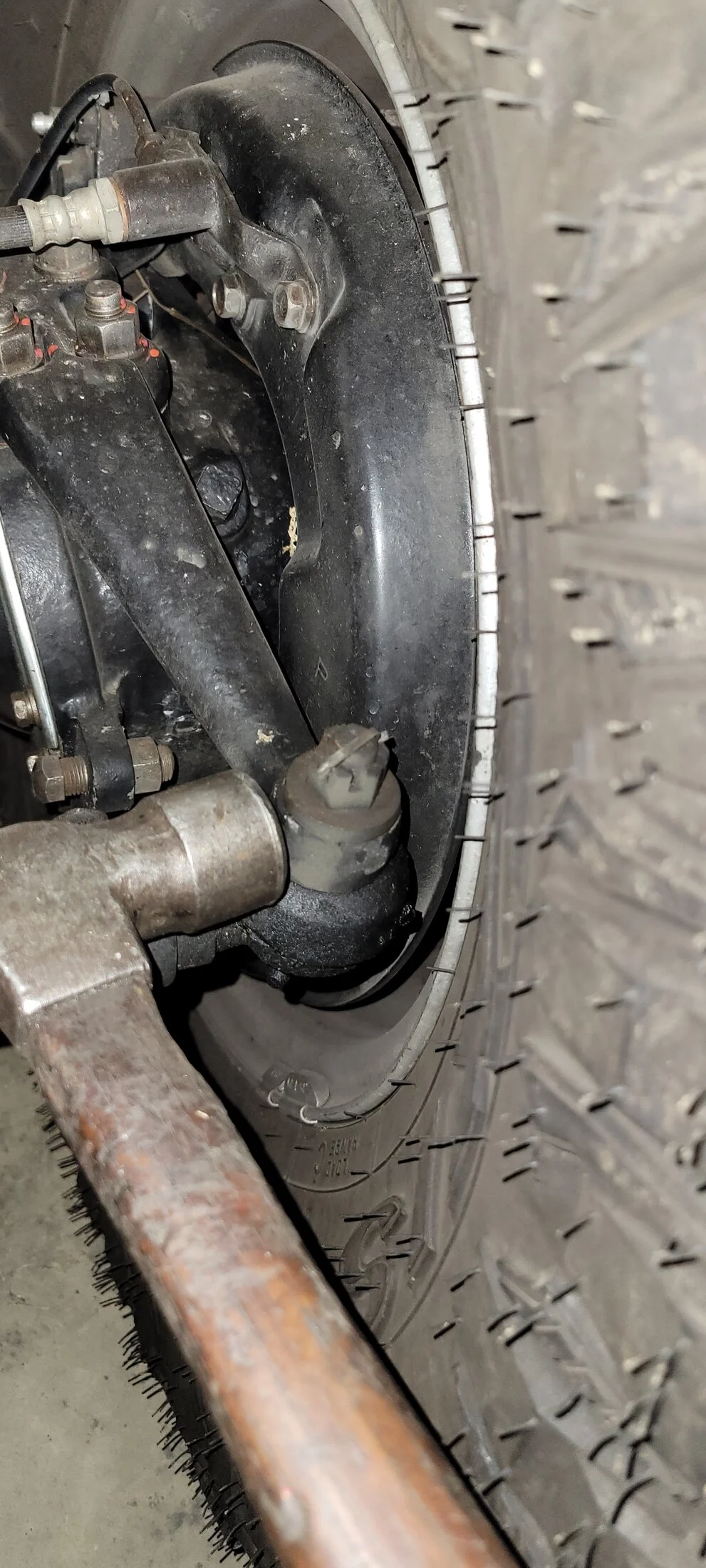

Got the axles on stands, the tie rods aren't budging but all my tie rod pullers are to big so I gotta order some smaller ones.
Will spend this week looking at new suspension and axle/brake rebuild kits. Thinking of going with skyjacker for the springs. Whish I could just find a stock height kit but all I see is 2" kits. Plan on just running 31s.

You don't need a pickle fork. Loosen the nut, but leave it on so it's protected.
Hit the female portion.
