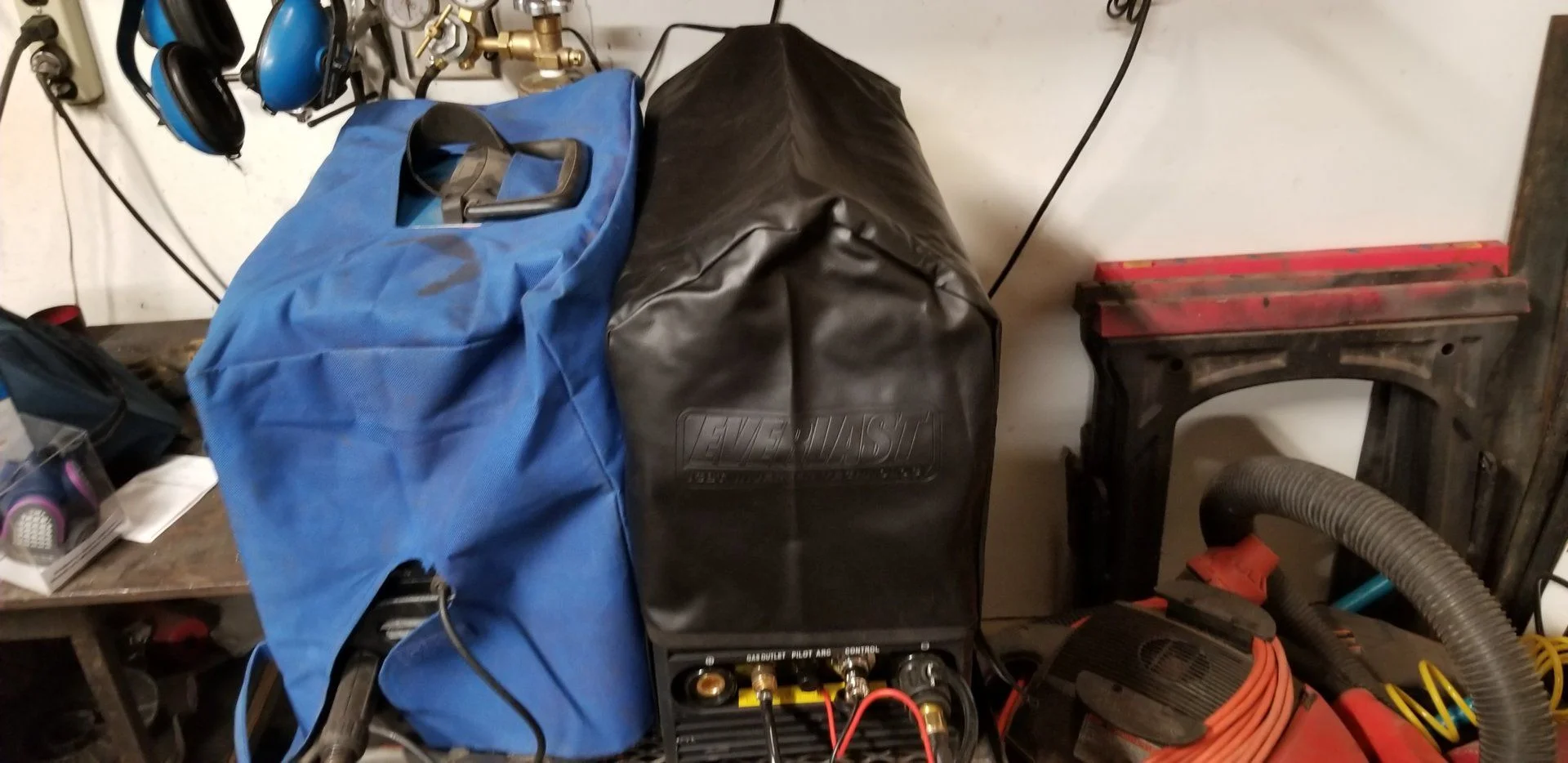

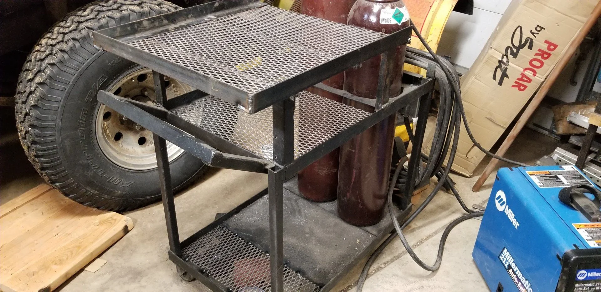

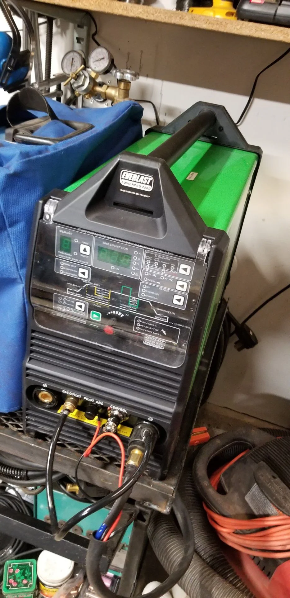

It's an Everlast PowerPro 256D multiprocess welder. It does AC and DC TIG, stick, and is a plasma cutter too. With that, I needed to upgrade the welder cart to fit the new machine.
I widened the top shelf to fit both machines and used up the rest of the expanded metal for the shelves.
I think they fit pretty well.

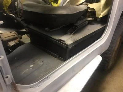

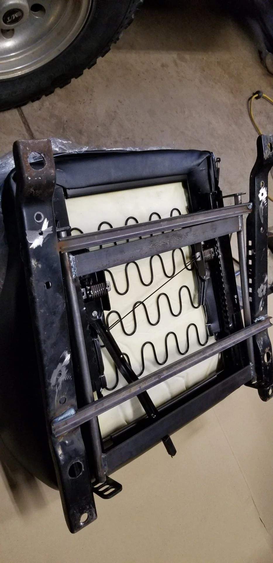

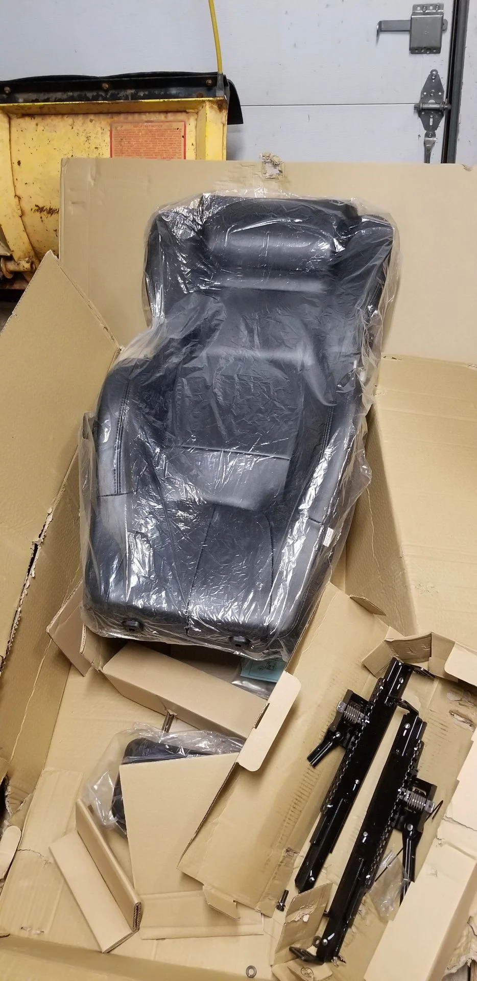

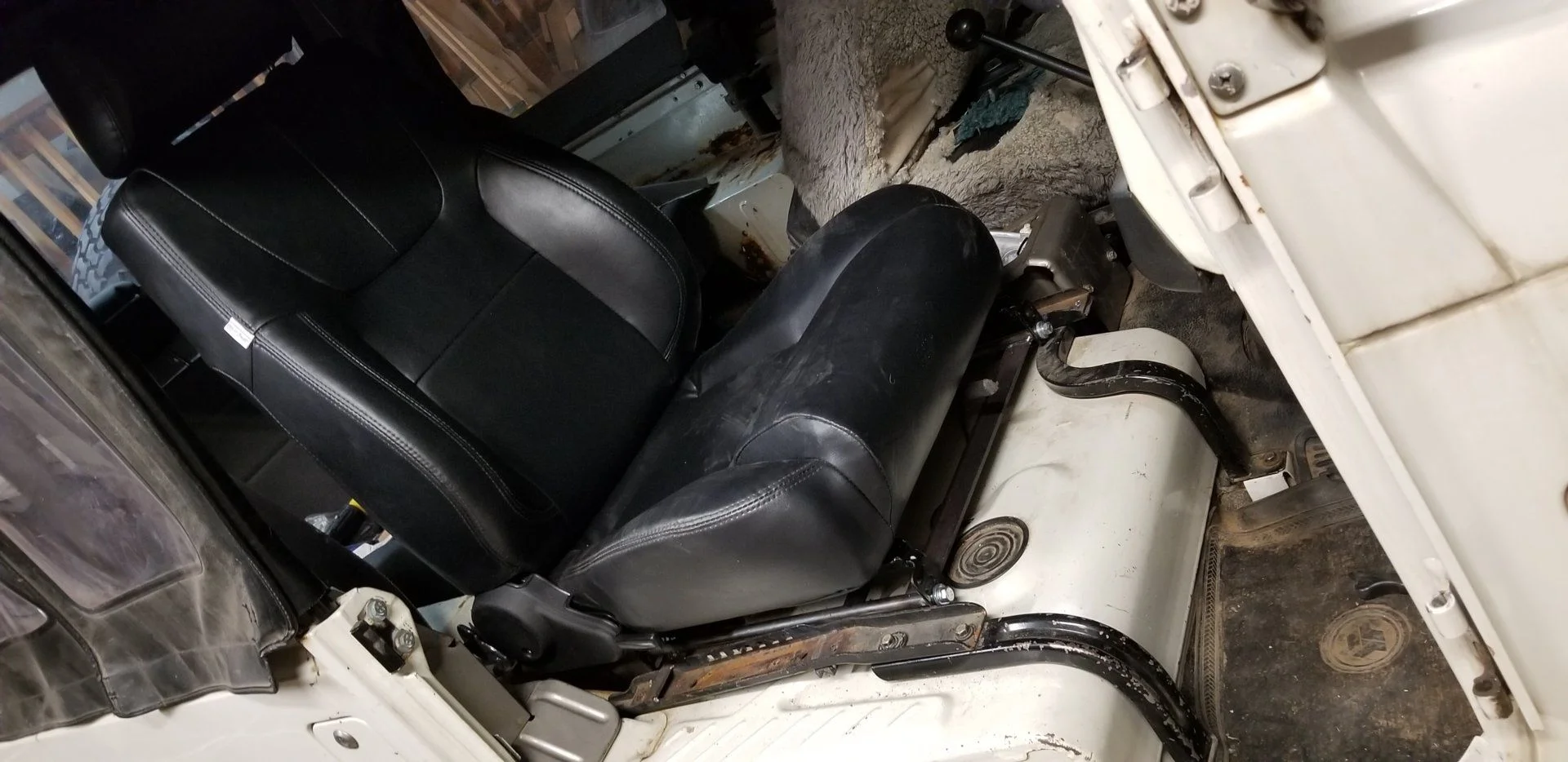

I also did some work on the cruiser. It's been needing seats since I can remember, and I finally convinced my dad to get some new ones. I went with the Procar by SCAT 80-1200-51 seats. They are the Lumbar support, bucket, recliner seats.
I popped out the old passenger seat for a practice run. Procar doesn't have 78 fj 40 brackets, or at least I couldn't find them, so I'm basically starting from scratch here.
I was too busy wrestling with the seat to take pictures, so here are some final product ones. It slides about 8 inches, which I think is better than the none it had before. I can fit comfortably in it without it being all the way back, so I'm hopeful for the driver side. These things aren't built for people taller than 5'8".
I decided to reuse the old mounting hardware from the stock seats so I didn't have to fab up new mounting brackets, just the seat to bracket mount. I'm hoping to save the drive side seat completely.
Here is the seat all the way back.
And all the way forward. It can still go farther, but the transfer case stick is in the way.

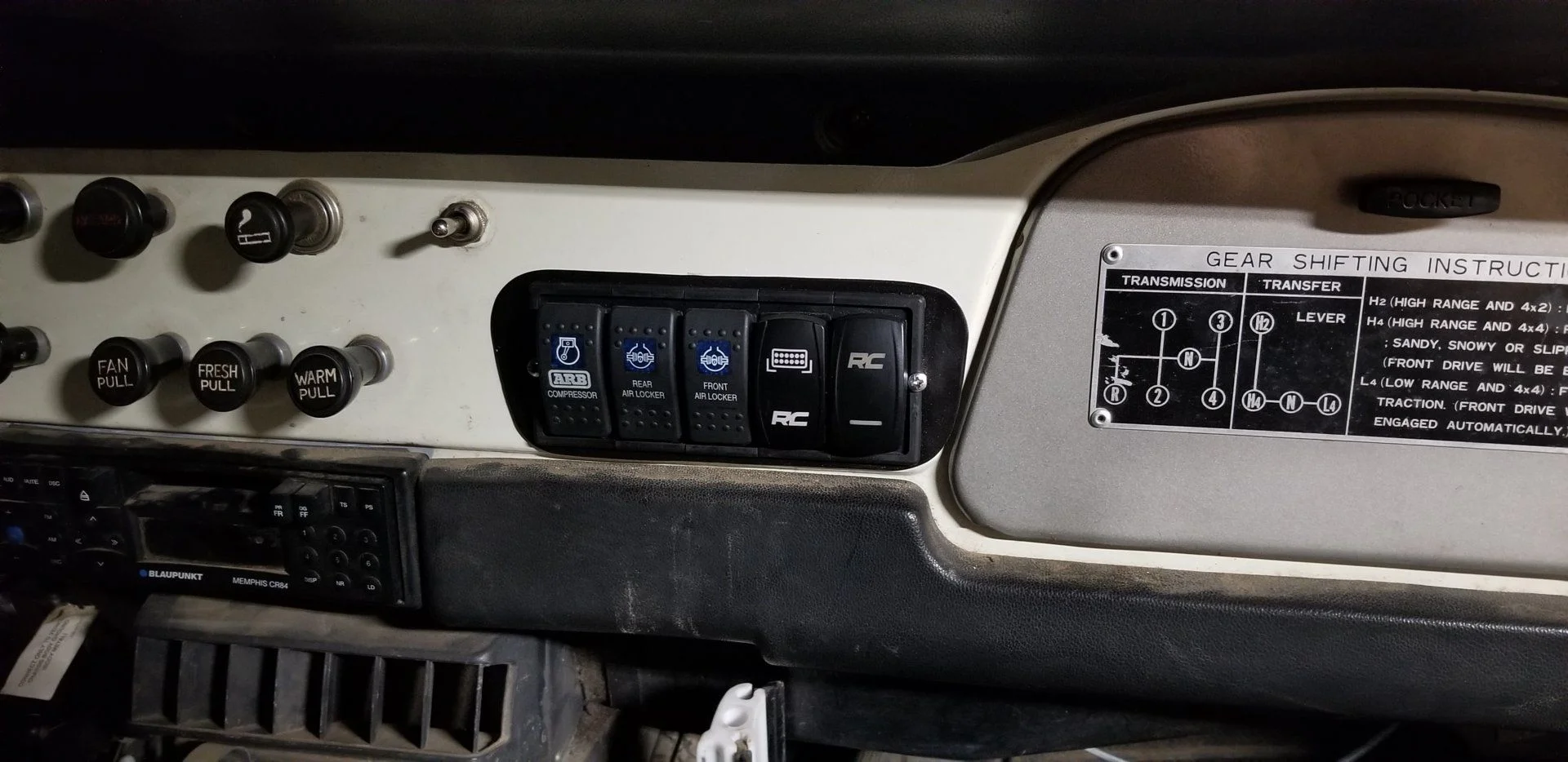

I also got the switches completely mounted in the ashtray hole. I think it looks pretty clean, and I didn't have to add any other holes in the dash for it.

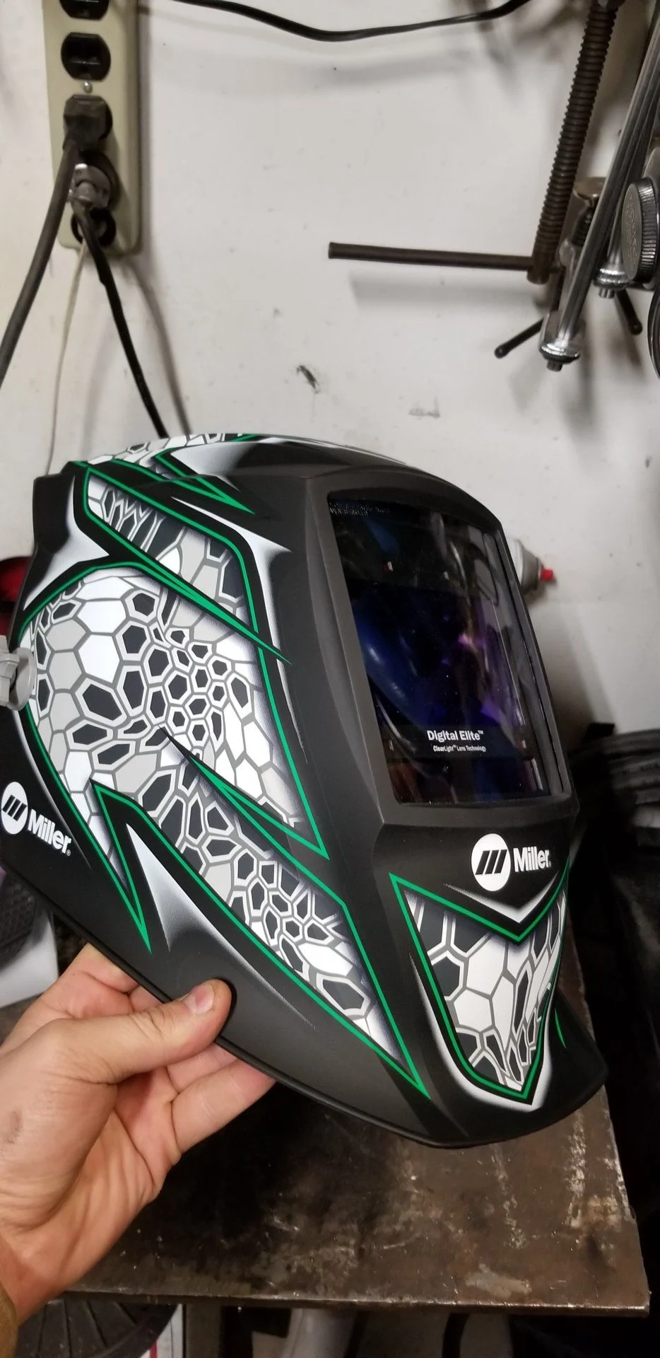

Since I have been doing a lot more welding recently, my dad decided to get me an early present.
It came with this nice little respirator that fits under the helmet. If I start wearing it, I may not get lung cancer by 30. :)
It supposedly filters out most welding fumes and dust, so that will be really good for me to have.

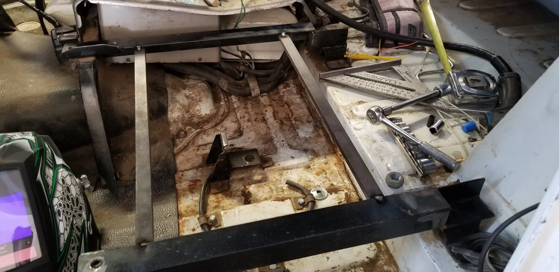

There was a slight amount of junk under the seat. I also found the stock bottle jack and the front license plate which has been hiding from us for a while.

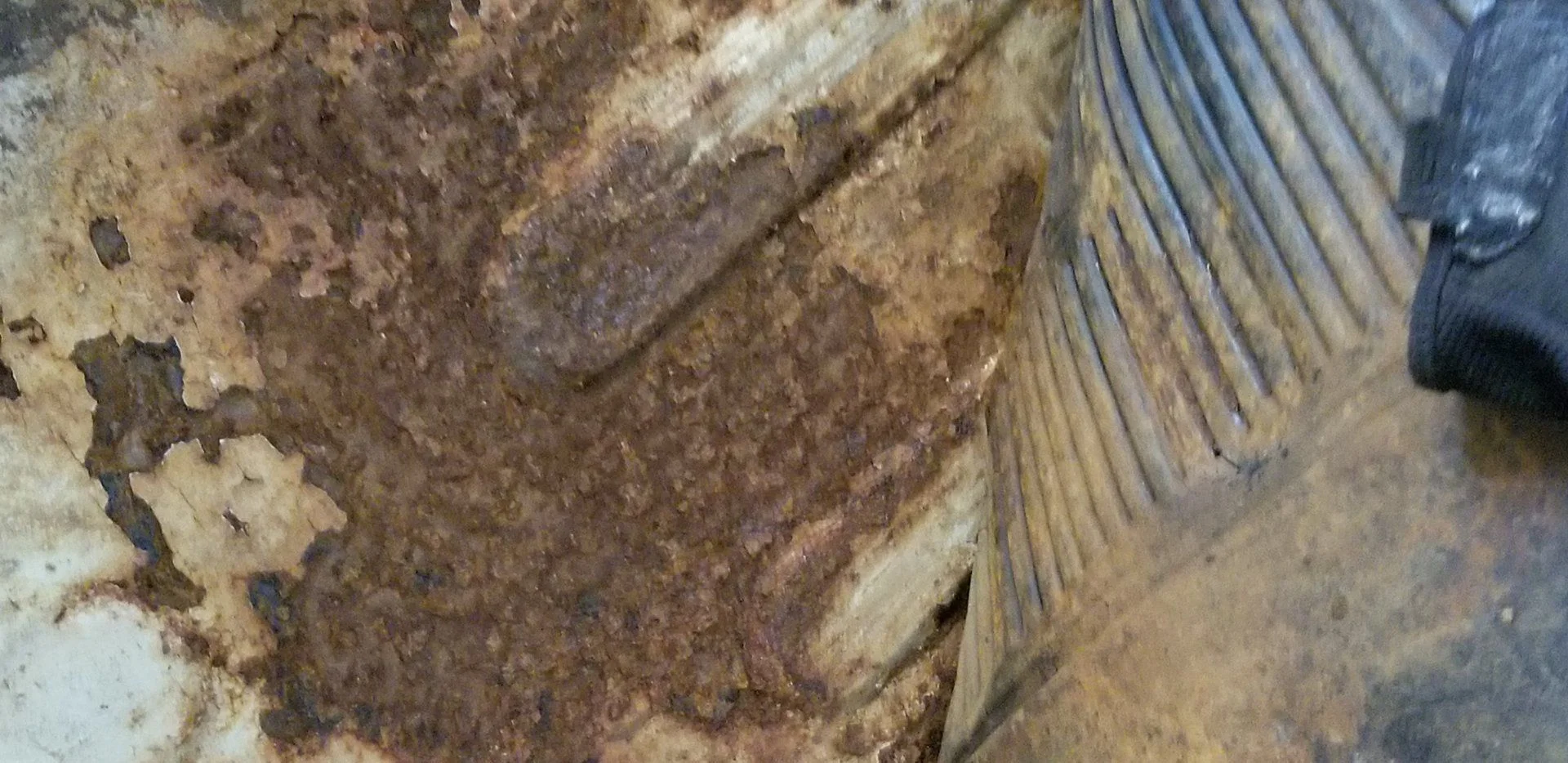

There is also some rust and a small little problem with the tub hiding under the seat and mat.
Yes, that is a crack in the tub, and it is adding some extra daylight into the cab. I need to fix that soon.

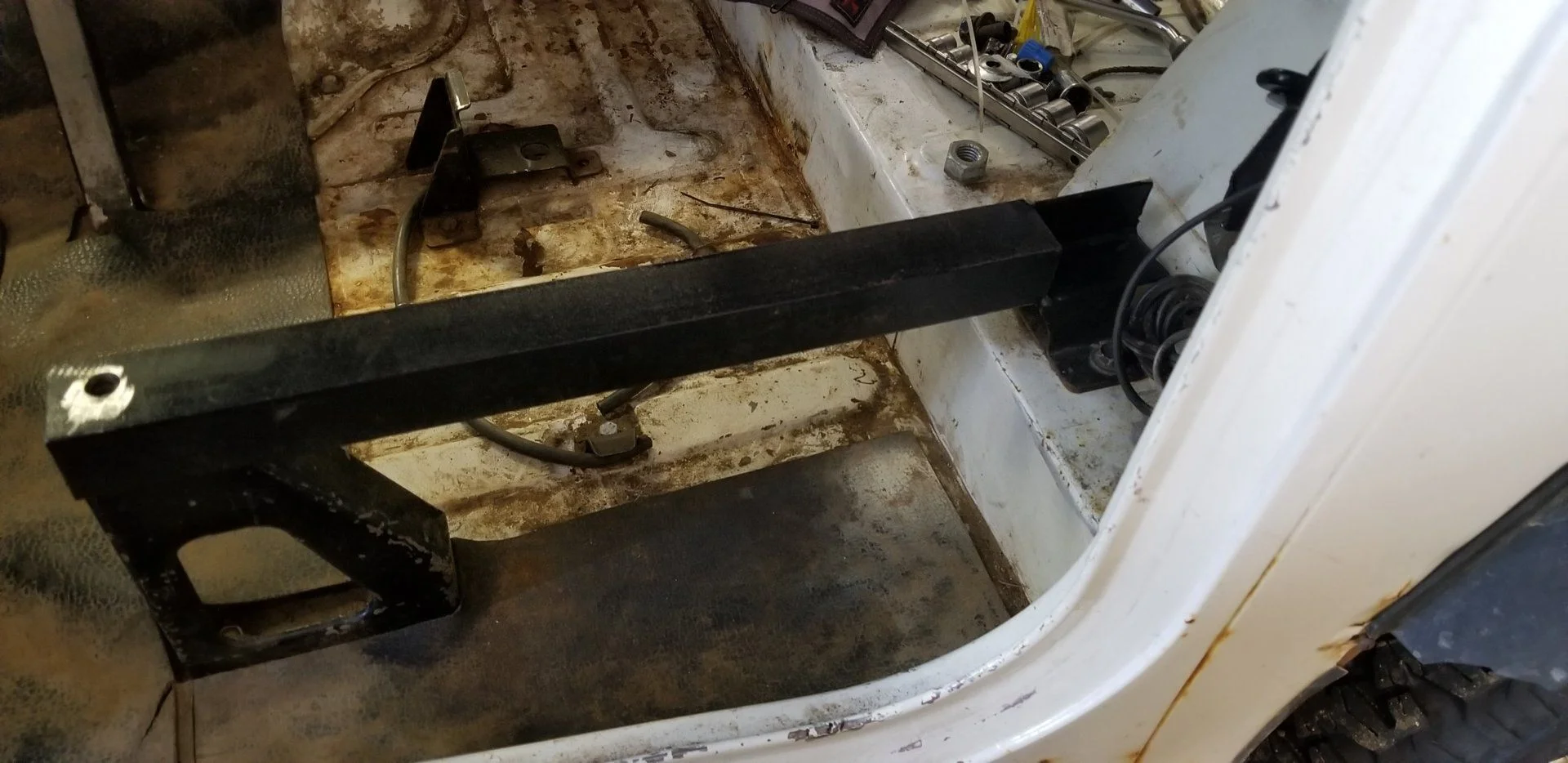

Instead of ripping apart the perfectly good sliding seat for the mounting brackets, I decided to make my own.
Rear Axle teardown

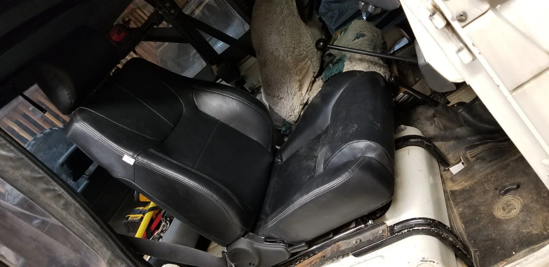

Here is the seat installed.
The seats slide far enough and I can sit in there comfortably without it slid all the way back.

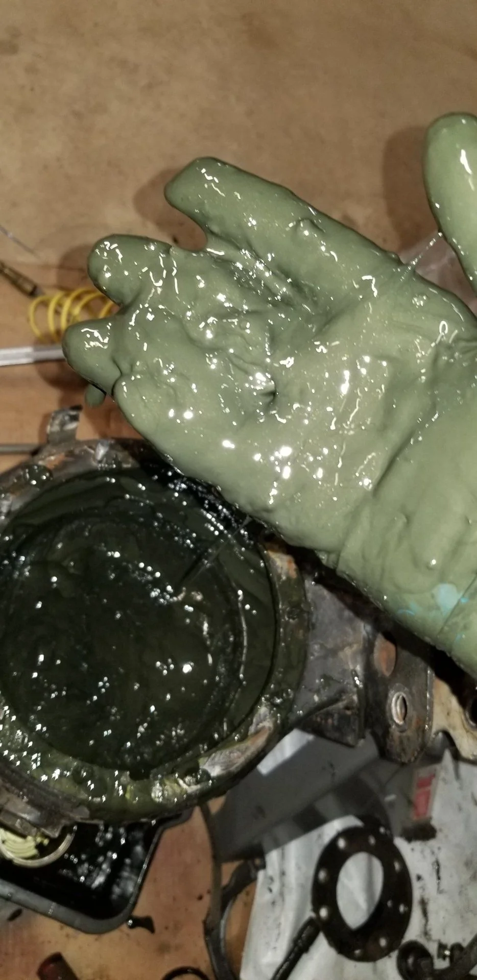

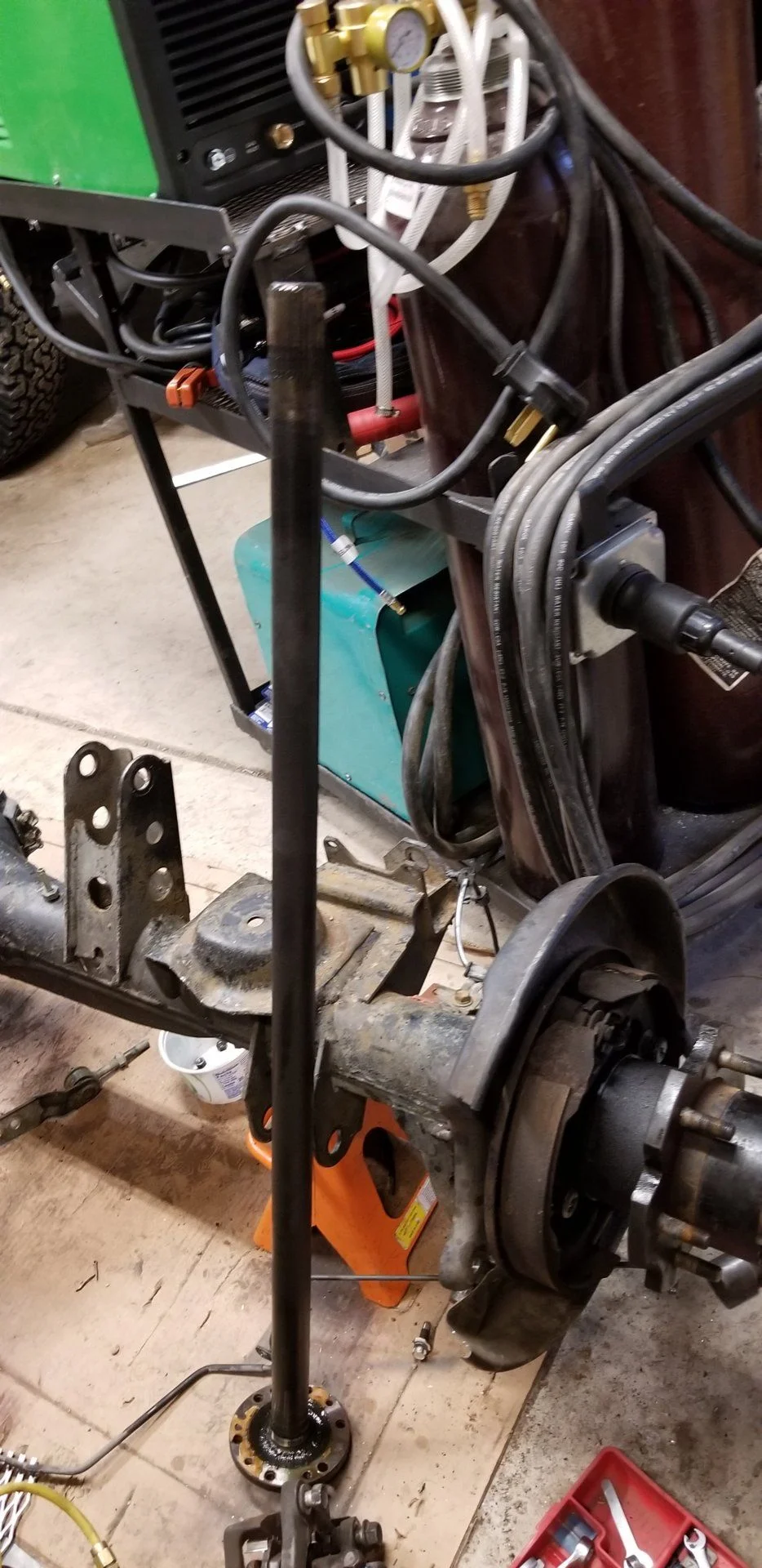

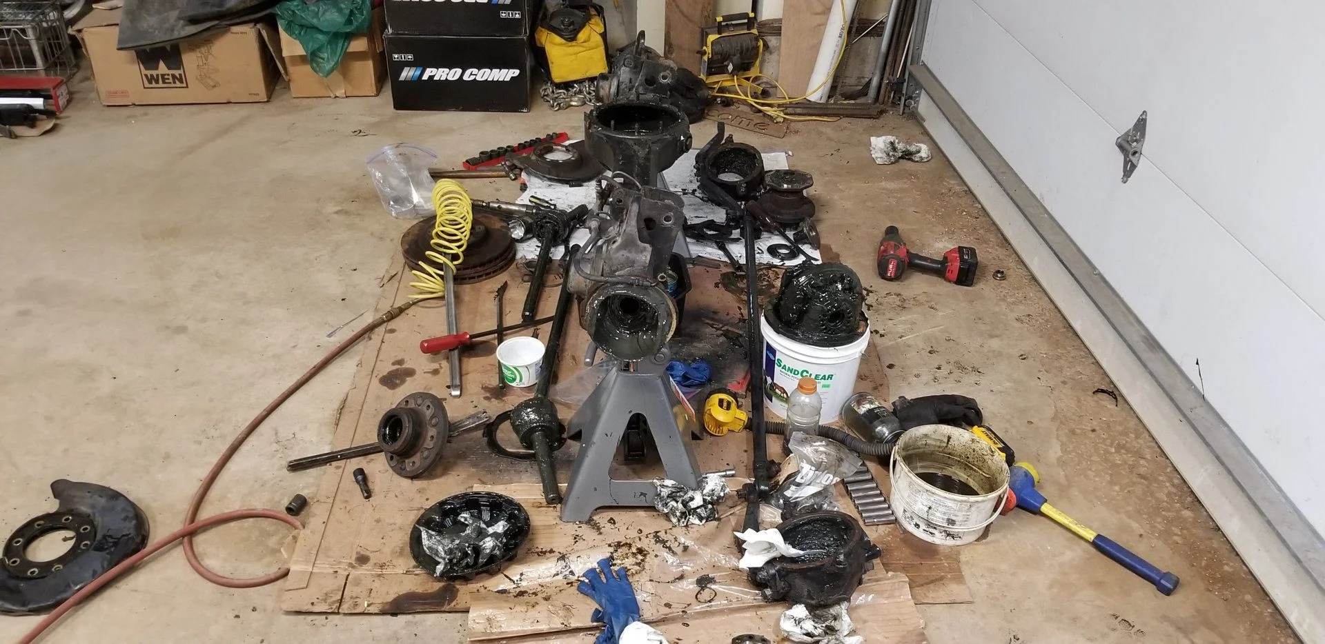

I also started the 80 axle disassembly. I feel bad for this 80. Whoever owned it before it was stripped abused it. A lot. The oil in the rear diff was black and way chunkier than I would have hoped. The front pinion bearing looks like it has been through hell and back. There is a good inch of play in it, and I am hoping that it hasn't worn into the housing, but I'm not hopeful on that one.
The rear spline shafts look good. They came out easily too which is nice.
You never really realize how heavy the diffs are until you get to pull one out. This one was no different.

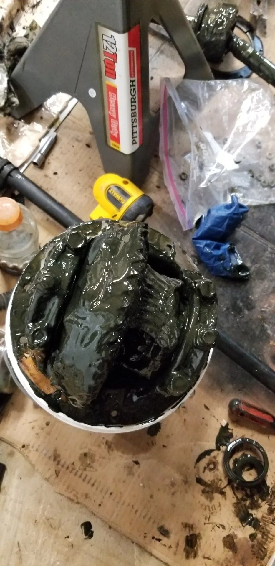

Here is the nasty oil. Yum. Glad we are rebuilding these axles.
Birfield Soup

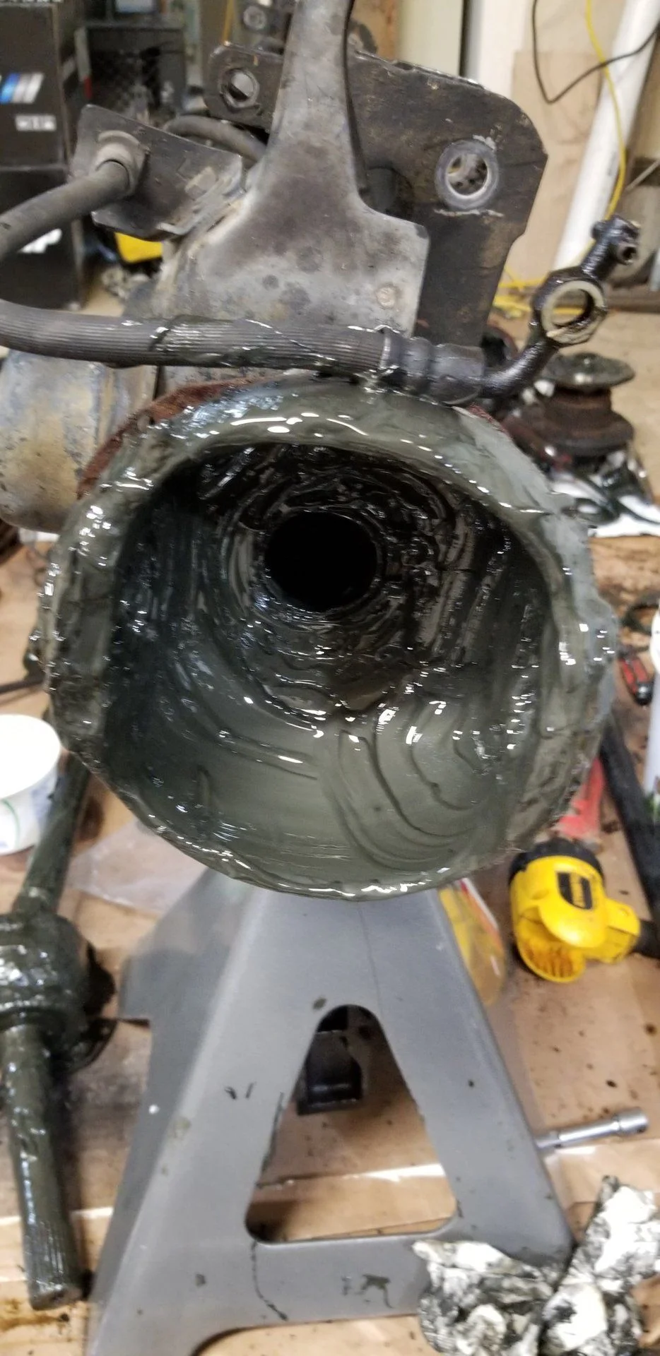

I got to playing around with the "Needs a new pinion bearing" front FJ80 axle. Here is the breakdown.
We were going to let someone else deal with the breakdown of the front axle cause we didn't have the correct sockets, but the NAPA by our house had them so we decided to do it ourselves.

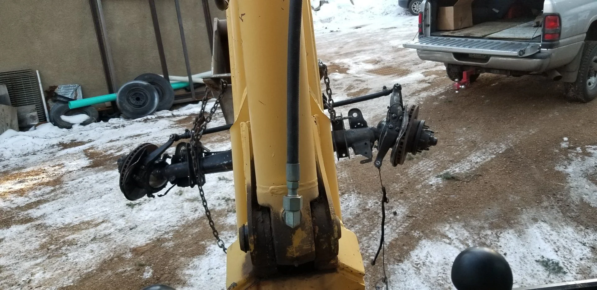

The axle was in the truck and I am extremely lazy, so here was the easy way to get it out.
I then had a fabulous time pulling birfeilds.
These things were an absolute mess.

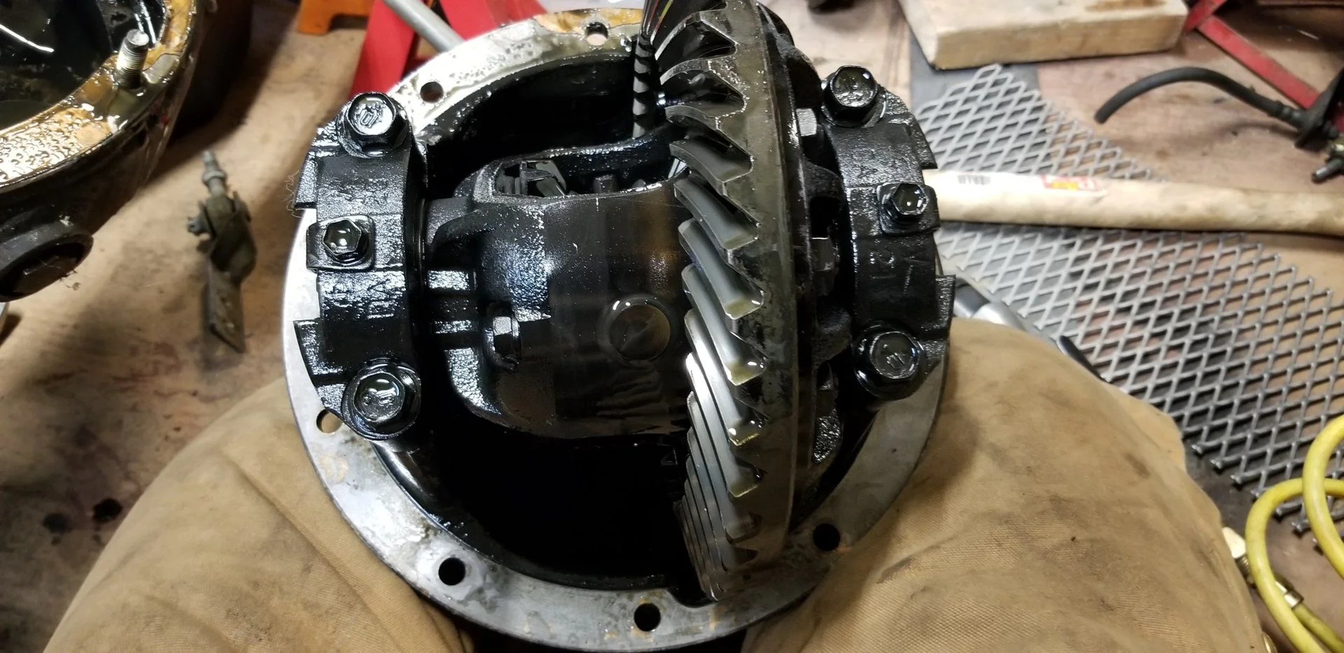

I started with the diff, and luckily the pinion bearing was still partially intact and it had not worn into the housing.
This was all that was left of the bearing:
I then wrestled the diff off. It is completely shot. The spider gears are free and were holding it in pretty well. I eventually got it free.
Here is the aftermath:
As it turns out, the PO decided to use the extra chunky grease formula in the diff. Here is a video: FJ80 Axle

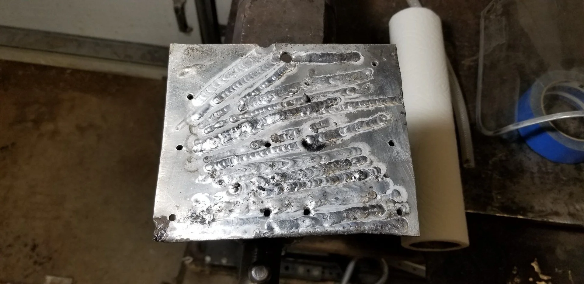

On a completely unrelated note, I did my first ever tig welding today. I finally got around to trying it out. I decided to do some aluminum because I need to do a robot chassis out of aluminum for my college robotics team, so I decided to start with aluminum first.
Here are my attempts. I tried my best. Tig sure is a lot more difficult than Mig or Stick.
