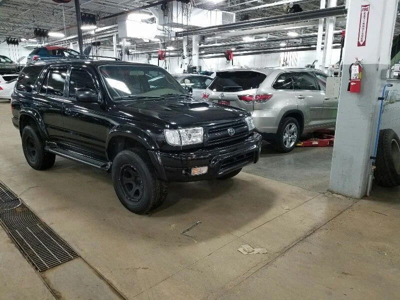

So here she is, the sr5 with the sport trim stripped and limited trim swapped. I also swapped the wheels and tires before I sold it. I had to swap the whole doors, bumpers, flares, hood, and hatch, and door panels. Then I sold the sr5 and made a fair chunk on it

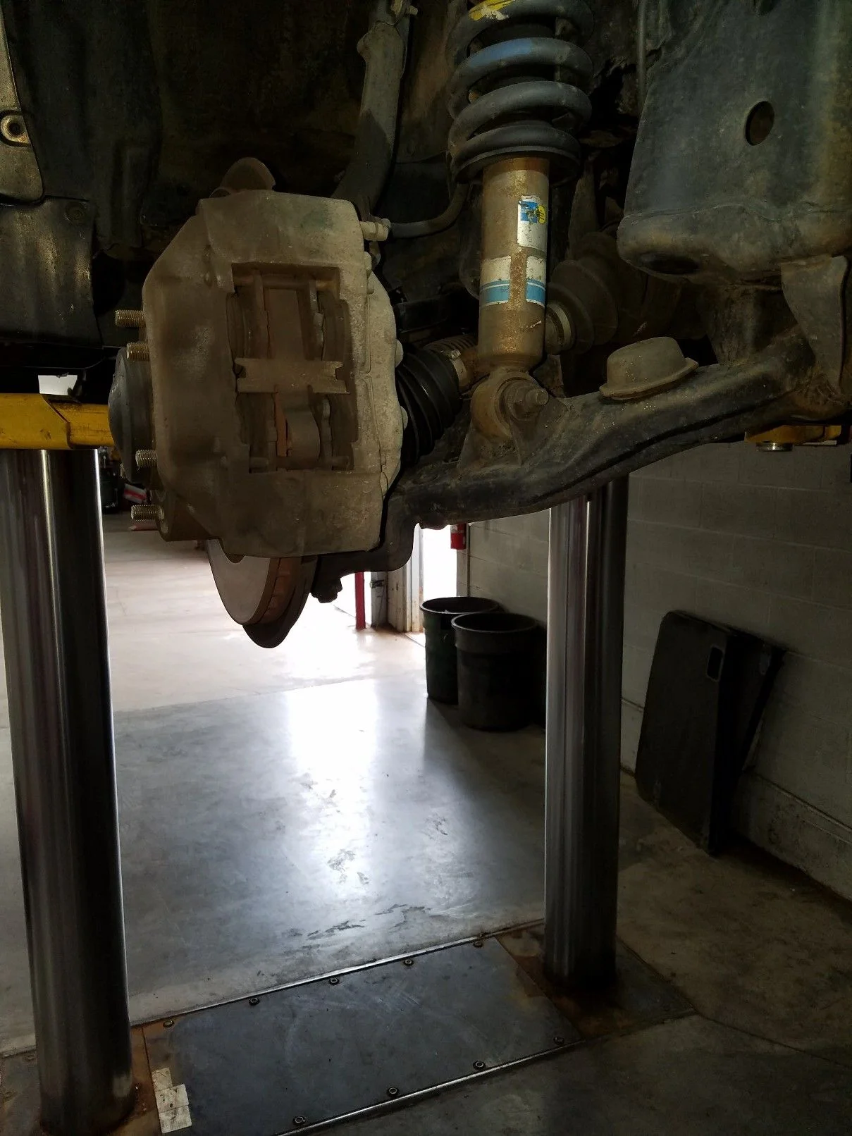

And here is the limited with the sr5 sport trim. More work than I thought swapping the parts around. I found some factory running boards on Craigs, so I picked those up. I like running boards on it because they really protect the body from rock chips, and keep a lot of road crap off the sides. I found a set of bilsteins on Craigs, the front now rides really nice. The rear is a little stiff, not sure if that's typical with bilsteins. Part of me wants to lift it to have a stance similar to the sr5, but it handles nice at this height. And it's easy for people to get into.

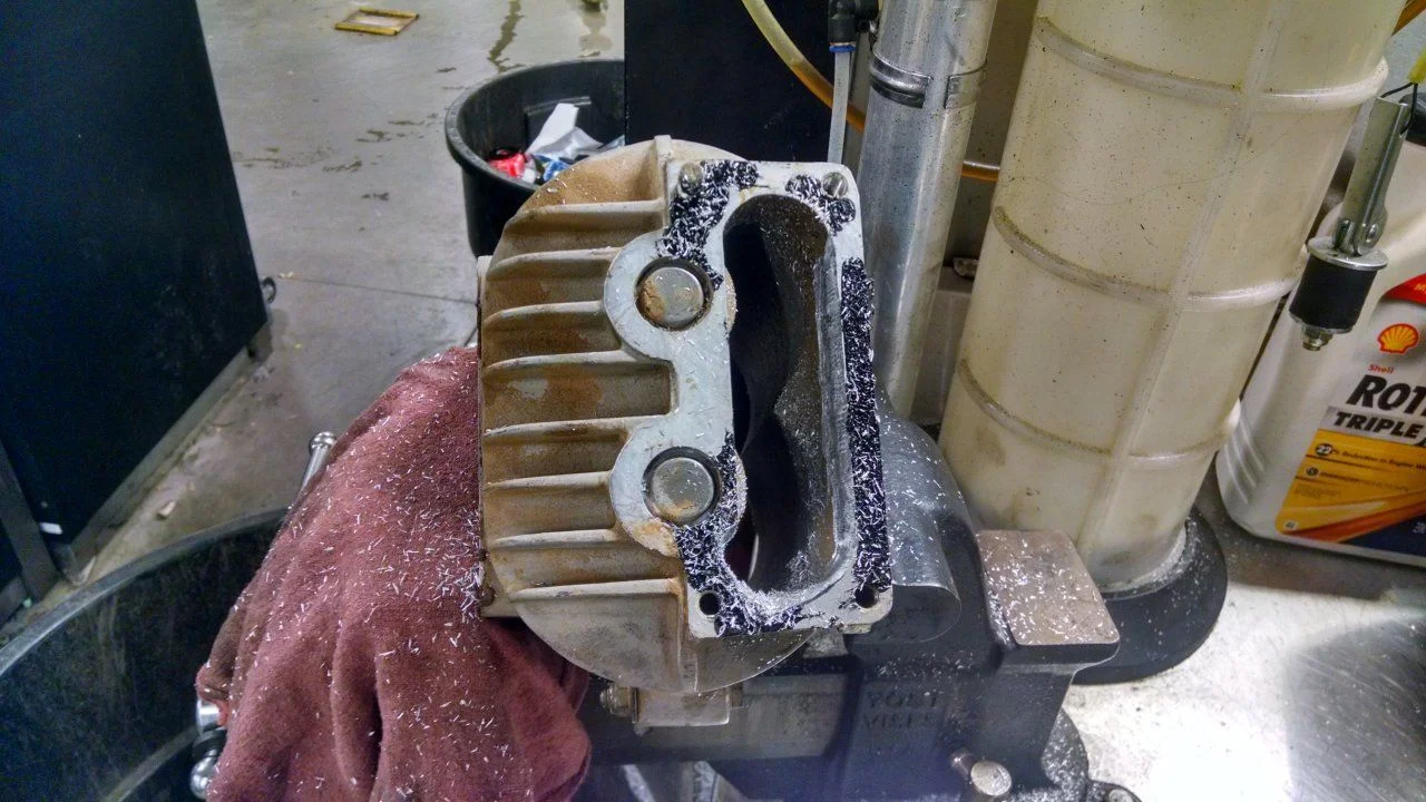

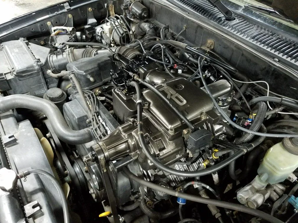

Valve cover gasket time! Here is what the valves look like with 1000s of miles of water meth...

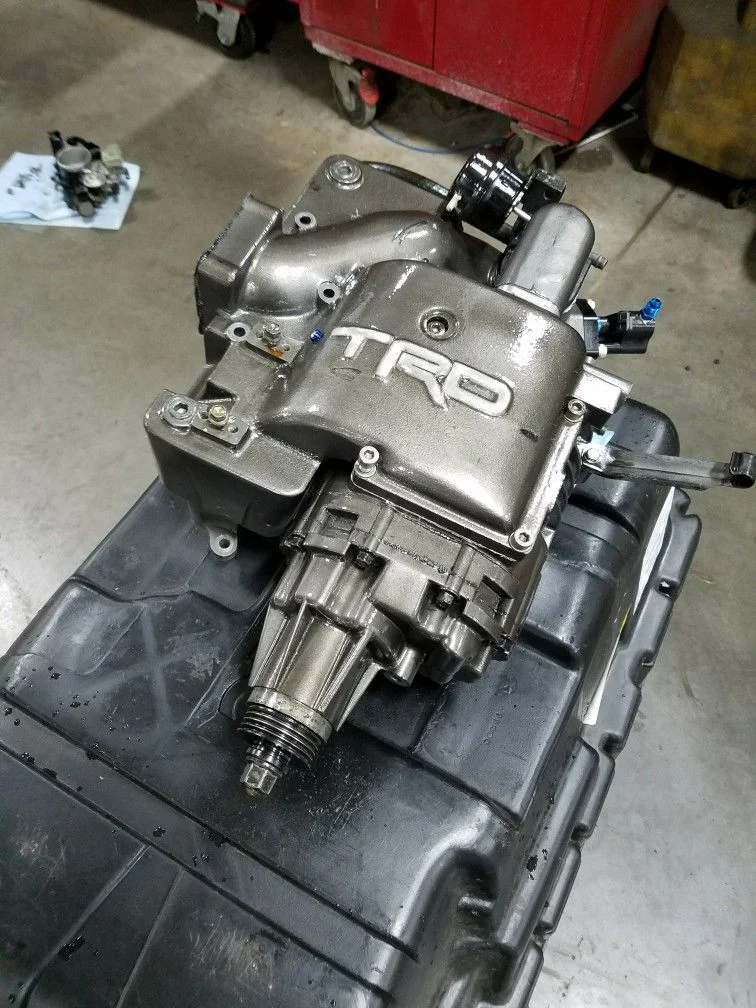

Cleaned up the supercharger, I ported this compressor a while ago. Silencer ports are also plugged. If u want a loud supercharger, and u want to increase efficiency a tiny bit, plug the silencer ports. It's easy to do on a 1st gen supercharger.
Did you paint the calipers? I used Eastwood Extreme Ceramic frame paint or something like that on some calipers. Looks just about like that. I found the paint chips super easy even after a week of curing so I'm not happy about that.
Yea I just used some por15 I had laying around. Im not sure if it will chip not. They do make caliper paint but I just used whatever I had.
