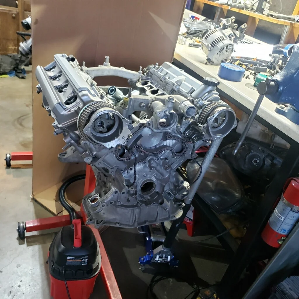

So what if I told you I know where you could get a 1UZ 1gen for $200. Just needs assembled. It was torn apart for a LS400 project and right before he put back together he ended up buying a Fast Furious Supra. The engine is all there, already has the parts for a good 700 hp. My buddy tunes 1uzs and 1JZs and just wants it gone since he isn't doing the project anymore.

I mean I wouldn't try to talk you out of it. Me and Zac were going to pick that 1UZ but we already got one sitting on an engine stand waiting for us to start the Volvo drag car
So what if I told you I know where you could get a 1UZ 1gen for $200. Just needs assembled. It was torn apart for a LS400 project and right before he put back together he ended up buying a Fast Furious Supra. The engine is all there, already has the parts for a good 700 hp. My buddy tunes 1uzs and 1JZs and just wants it gone since he isn't doing the project anymore.View attachment 2921909
Can I get in on this deal? What all does it come with?

Um I don't see why not. But most likely you would have to pick it up in Colorado Springs.
Thank you! I sent him a message about it. I’m always in for an excuse to vacation in Colorado!
Yeah come visit me and DJ. Show you some of the trails around here
