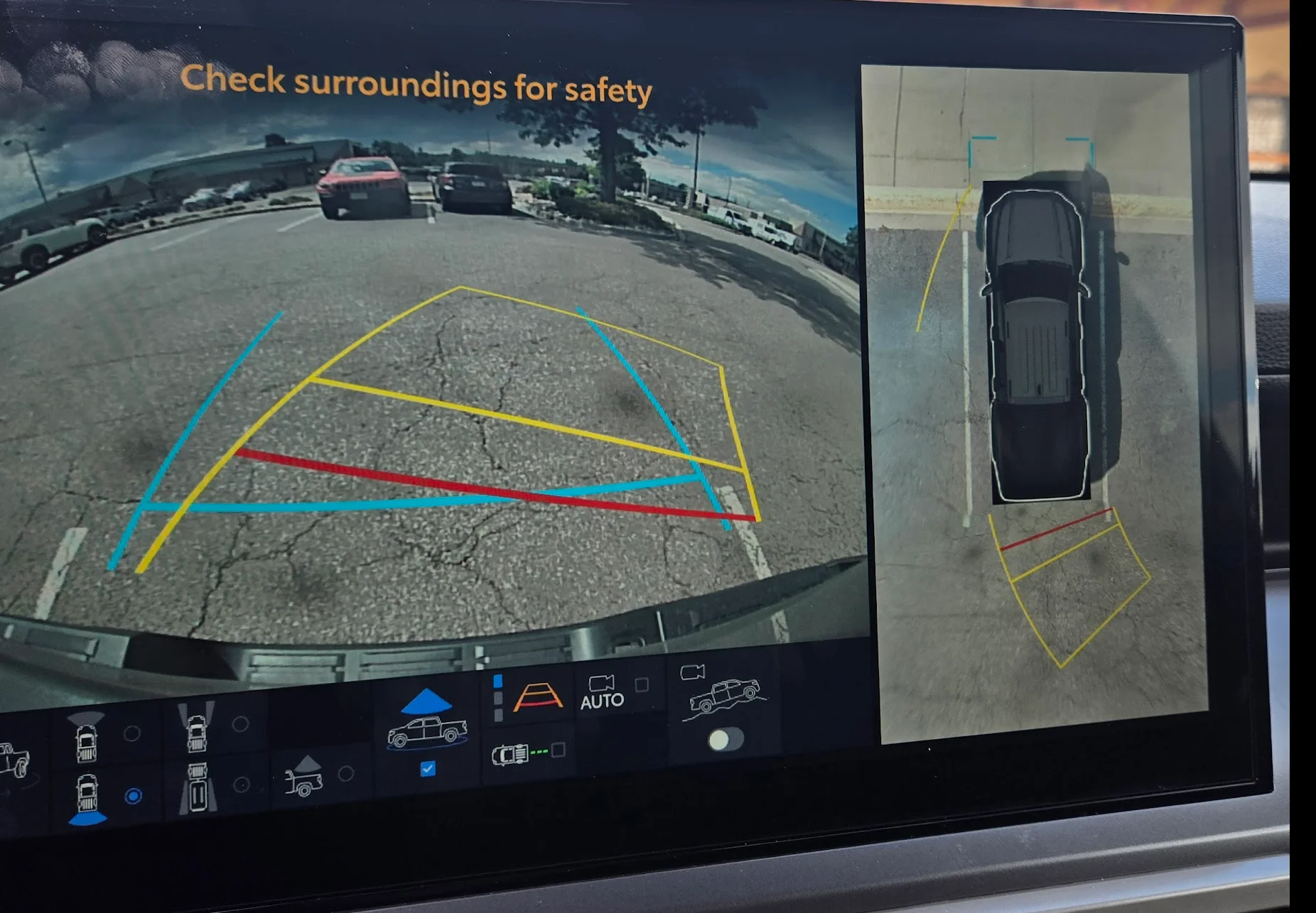

  • The premium comes with the multiple camera setup with a birds eye view. It has an algorithm that combines all the views into a 360 view from above. I wasn’t sure I was straight in a parking spot and turned it on and I moved over a bit. It also comes on when you get close to something

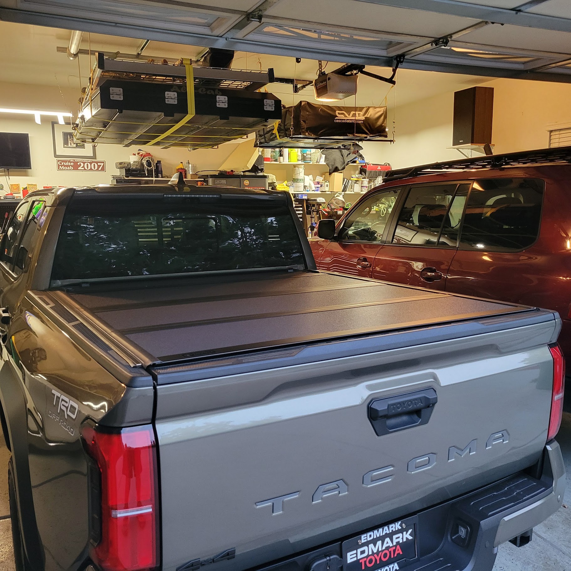

  • Installed a Trifold Hard Tonneau Cover PT954-35240 and about to install it. Good deal with 4th of July sales

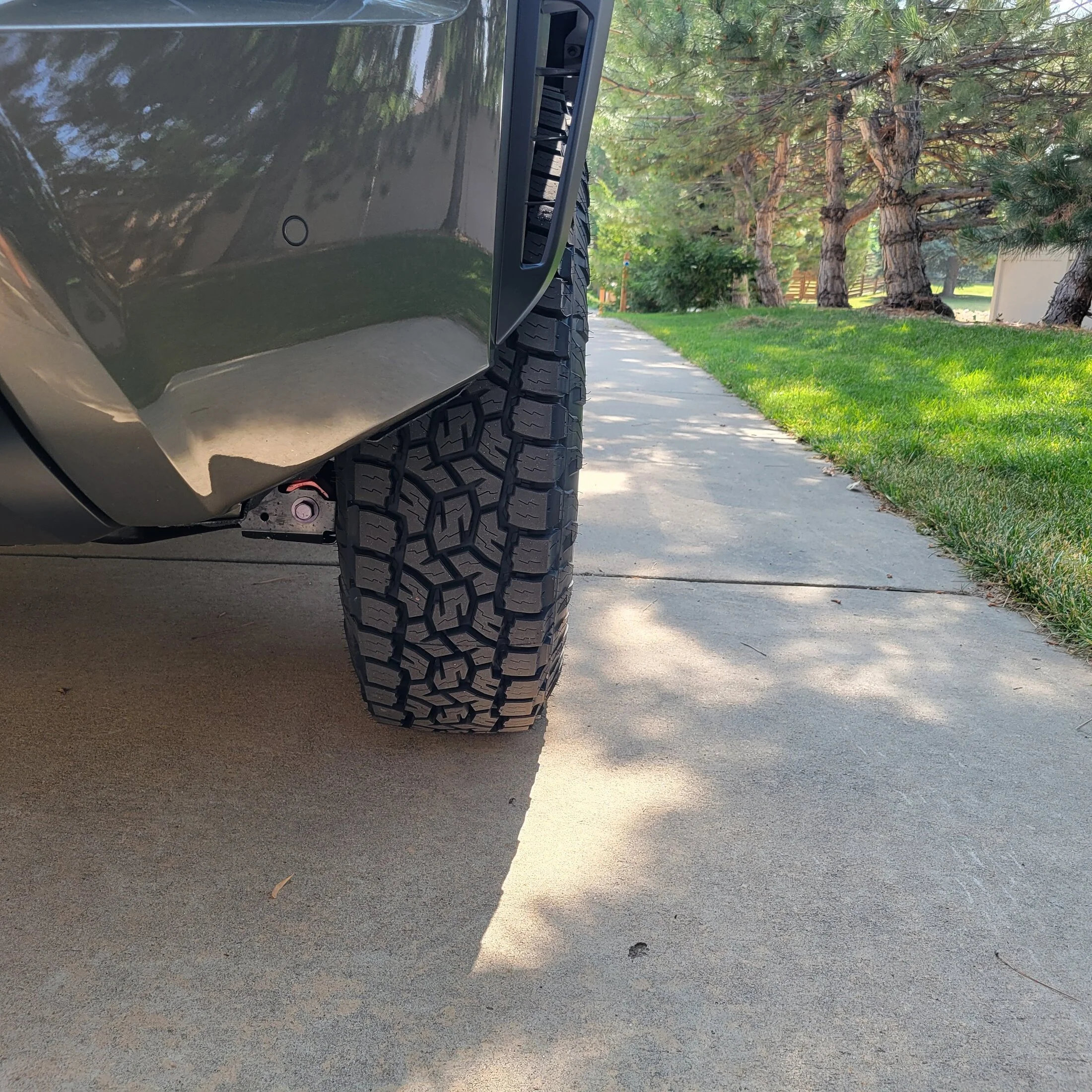

I swapped out the tires for Toyo AT3 255 80 17's. Its a 33" tire 10" wide. This video made a big difference in my decision
These replaced the 31" tall 10.6" stock tires that came with it

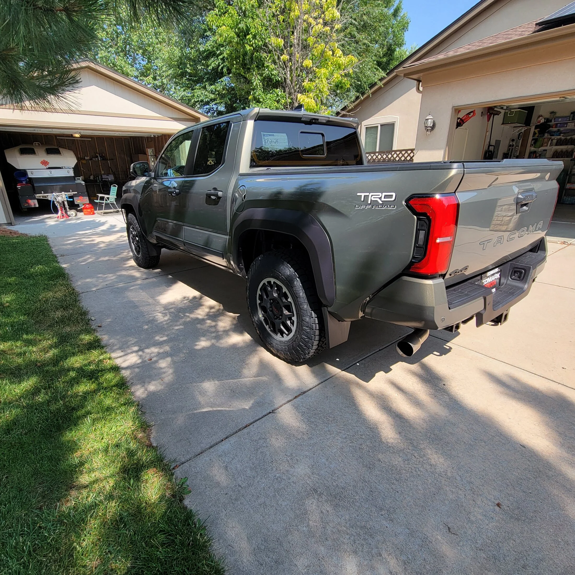

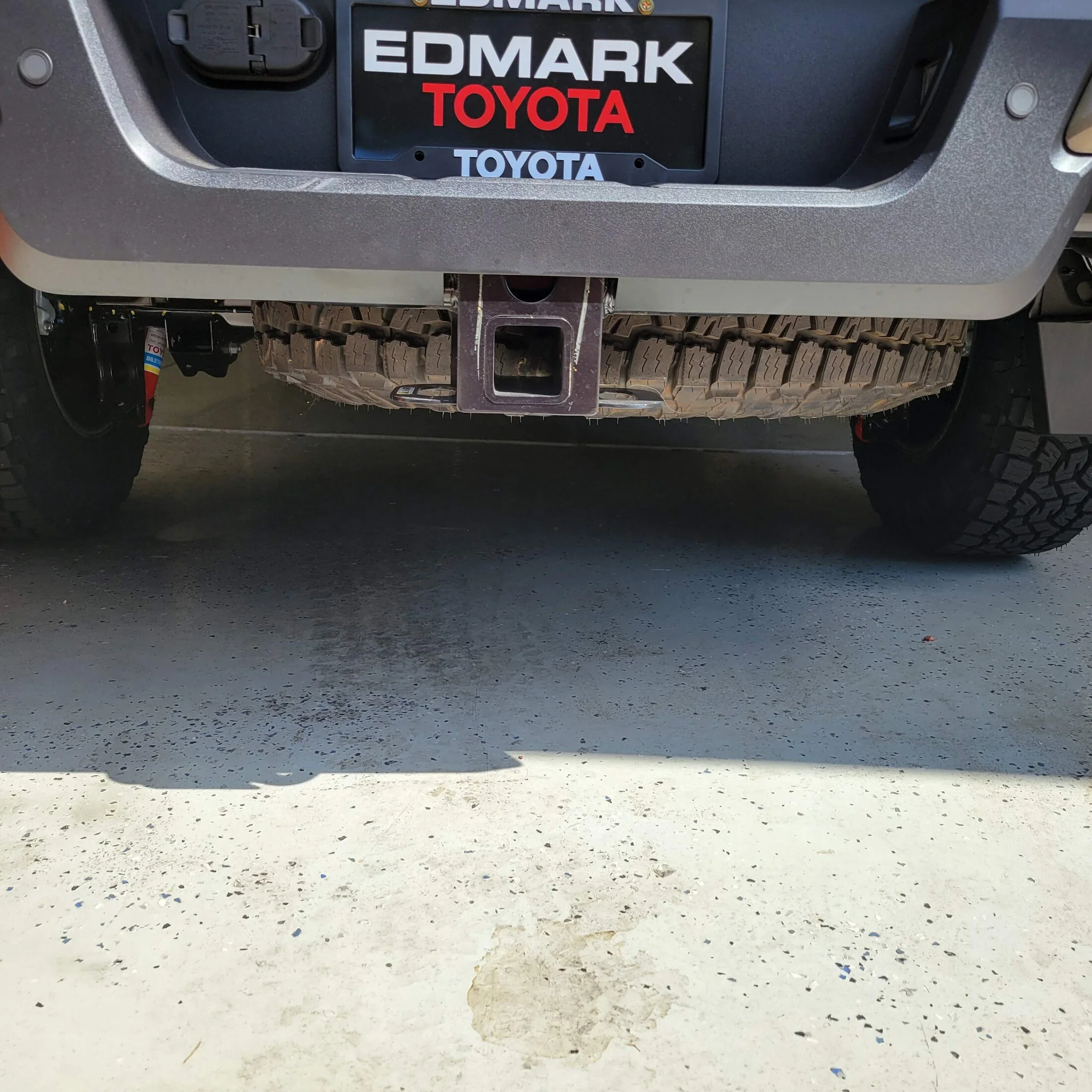

There were two things I didn't like. The short exhaust and the lack of a full size spare. I wouldn't feel comfortable offroad with the smaller temp spare. The exhaust would get smacked and damaged the way it sits
So I removed the back end of the exhaust and installed Toyota part #PT226-35241-AA, offroad tail pipe. It did remove the resonator and I will have to see how the exhaust sounds

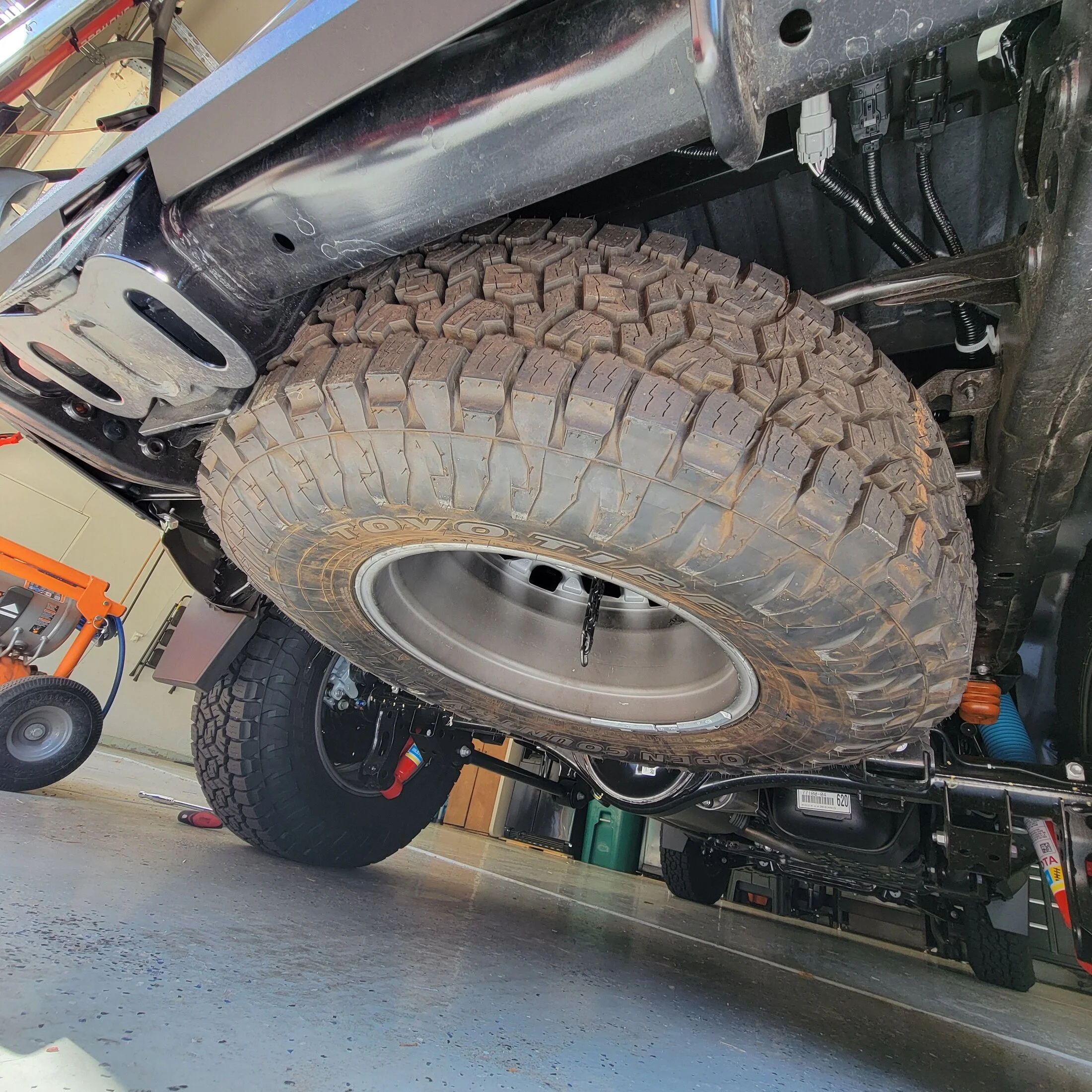

I bought a stock TRD Off Road RIM even though the tire would fit on the steel rim. I also bought the same tire I replaced the stock ones with, a 33.1" tire 255 80 r17
Looking at it now, it does seem to sit a bit to the right side. It is in there tight with no movement so that is OK. I haven't tried to adjust it.

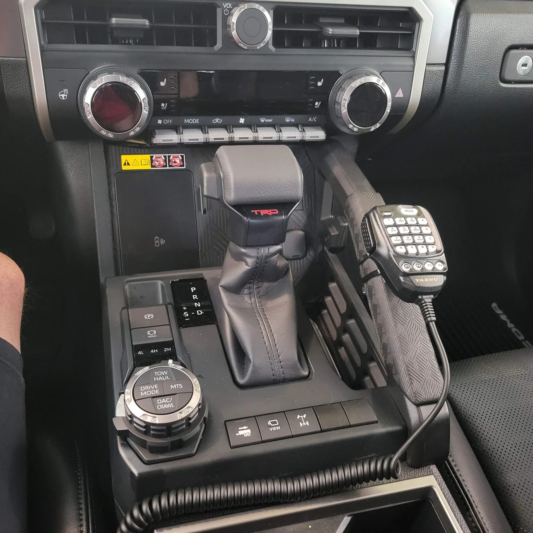

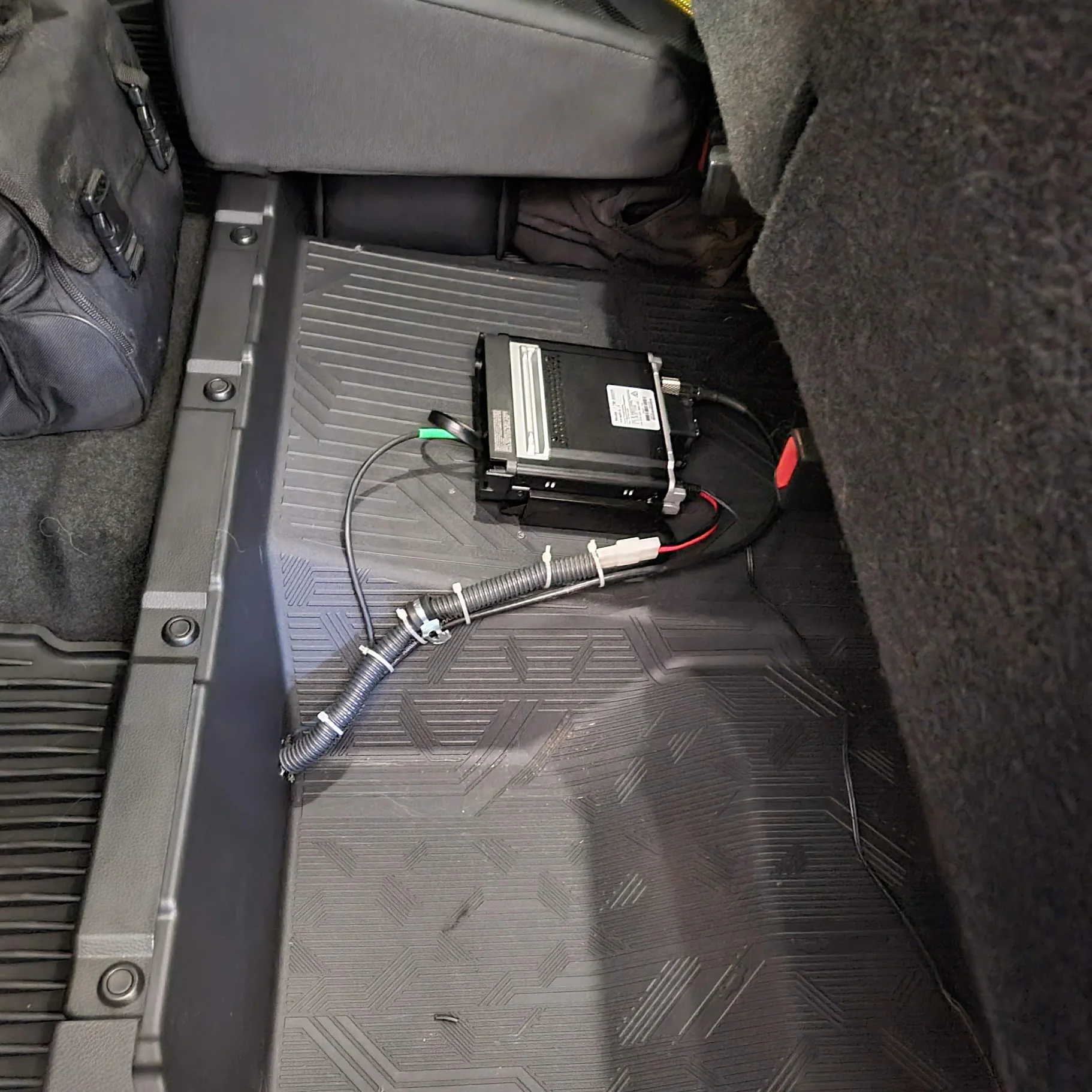

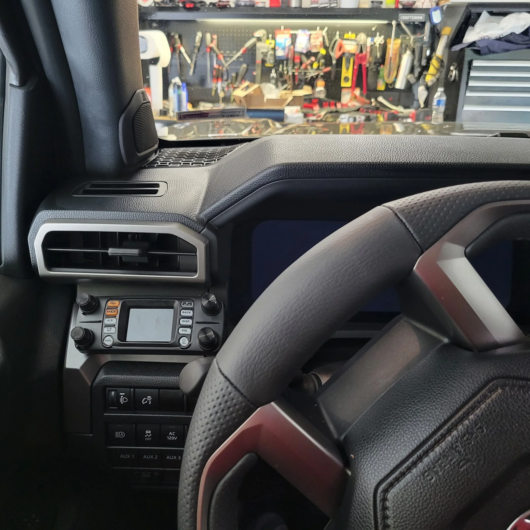

I installed the faceplate and also the microphone using zip ties for the microphone holder
Thinking of running the main unit under the rear seat. Still pondering.
I ran the wires from the engine bay back to the rear cab, but haven't hooked them up yet. Left the fuse out of the fuse holder for safety

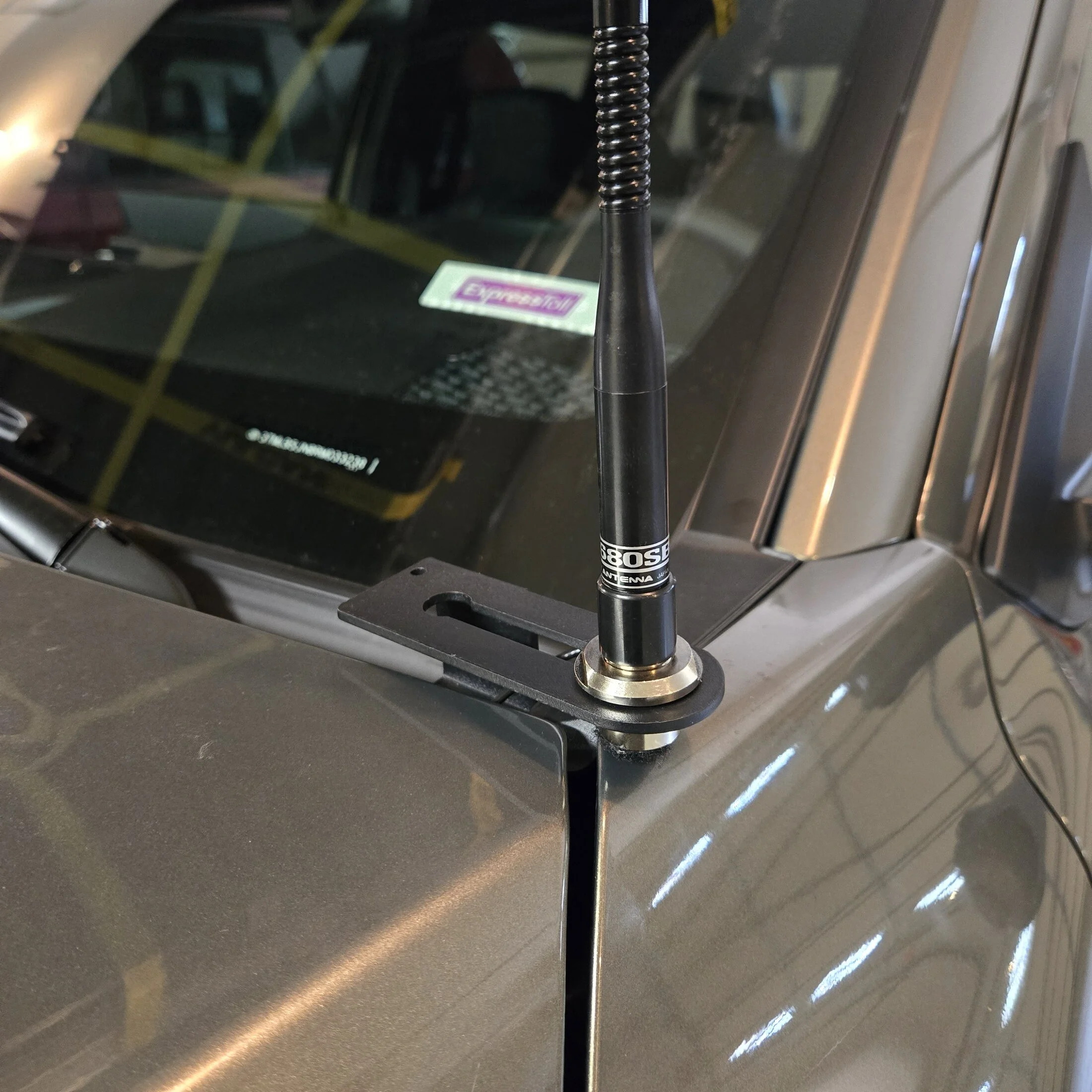

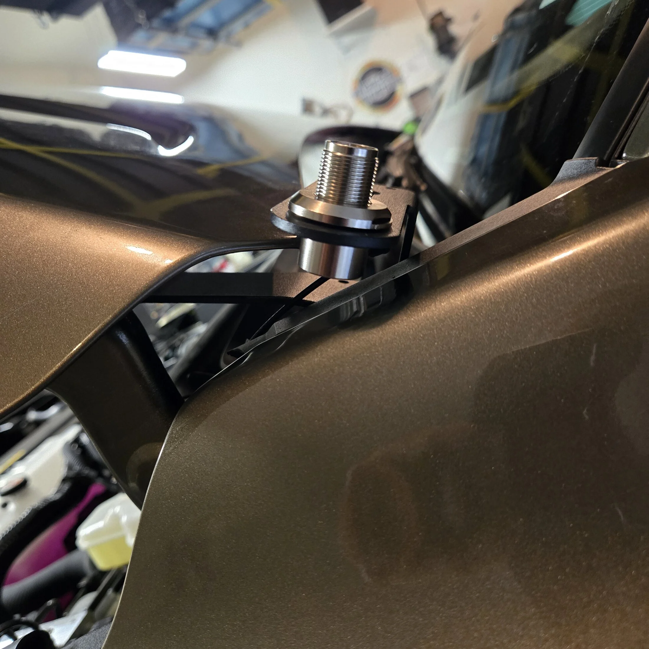

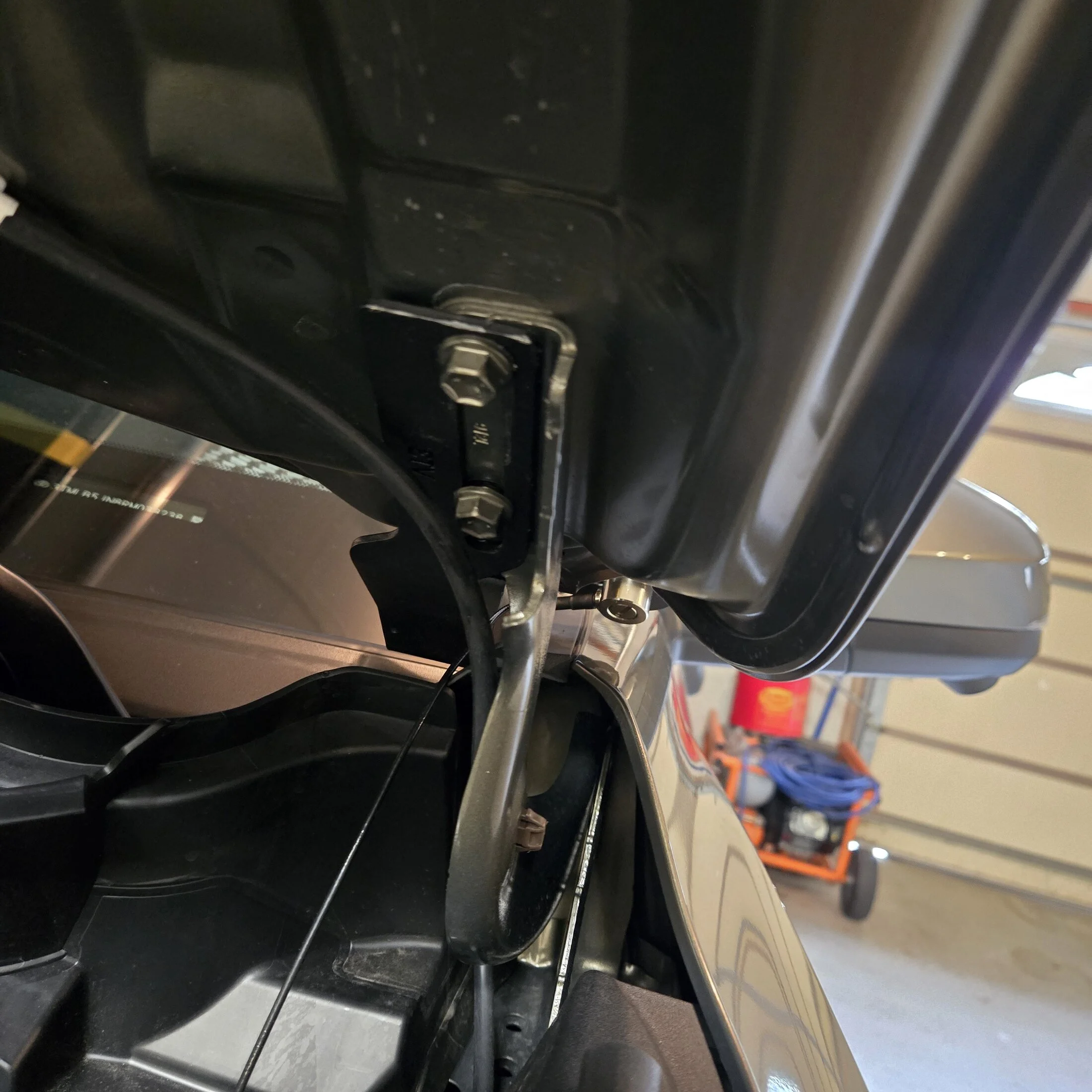

I ordered the ditch light brackets from Victory offroad for the antenna mount and will drill the hole to 5/8". They said it would work
On the ditch light bracket, make sure it sits high enough for your antenna mount type (PL-259 or NMO). My Caliraised ditch light bracket sat really low and the PL-259 connection below the bracket was too deep ant hit the hood! Drilling to 5/8 sounds like you have a PL-259 because that's what i initially drilled mine out too. I had to enlarge it a little more to slip the antenna mount through. If it sits high enough, it's a great mount for an antenna!!

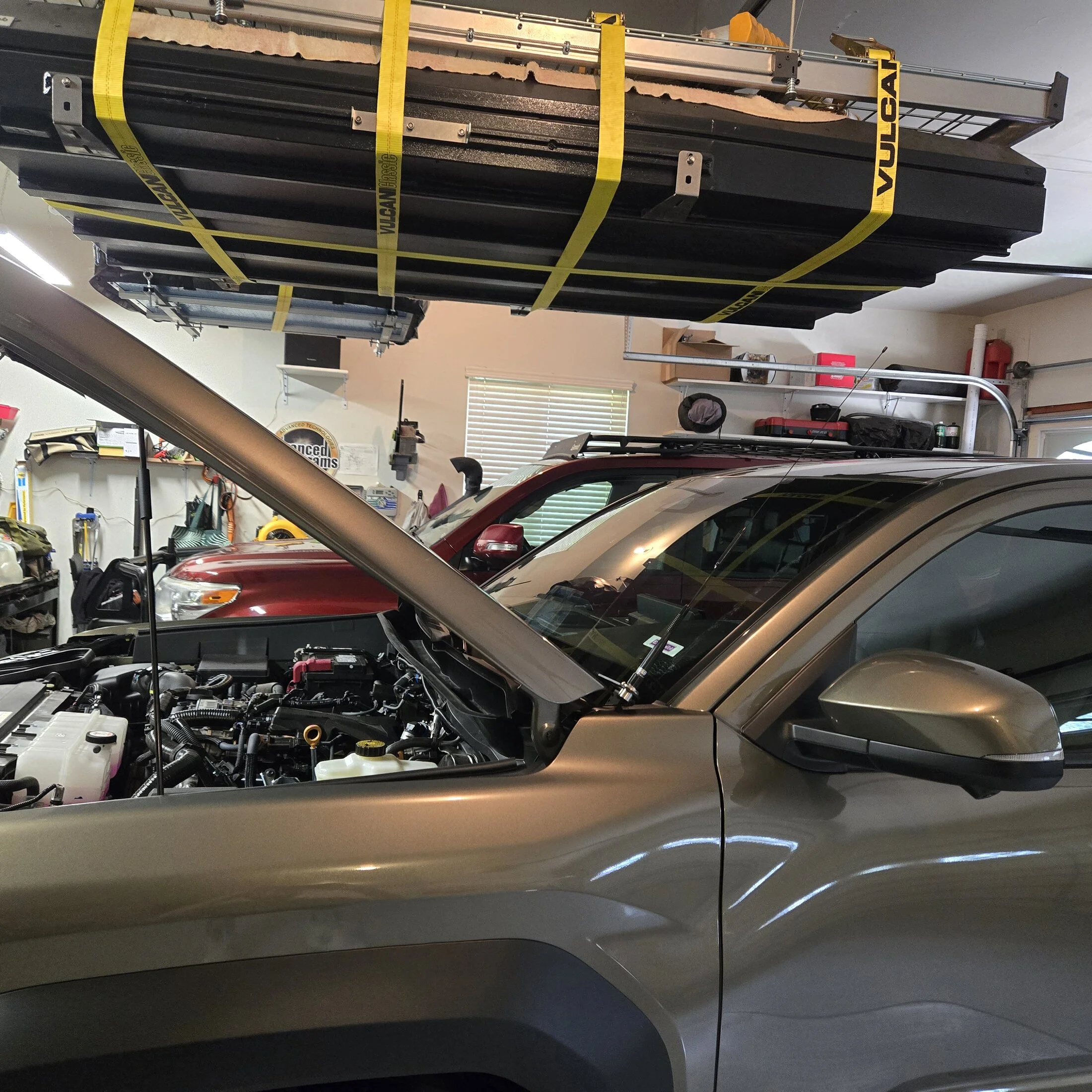

I installed the main unit under the seat in the rear. This is not available to Hybrid owners

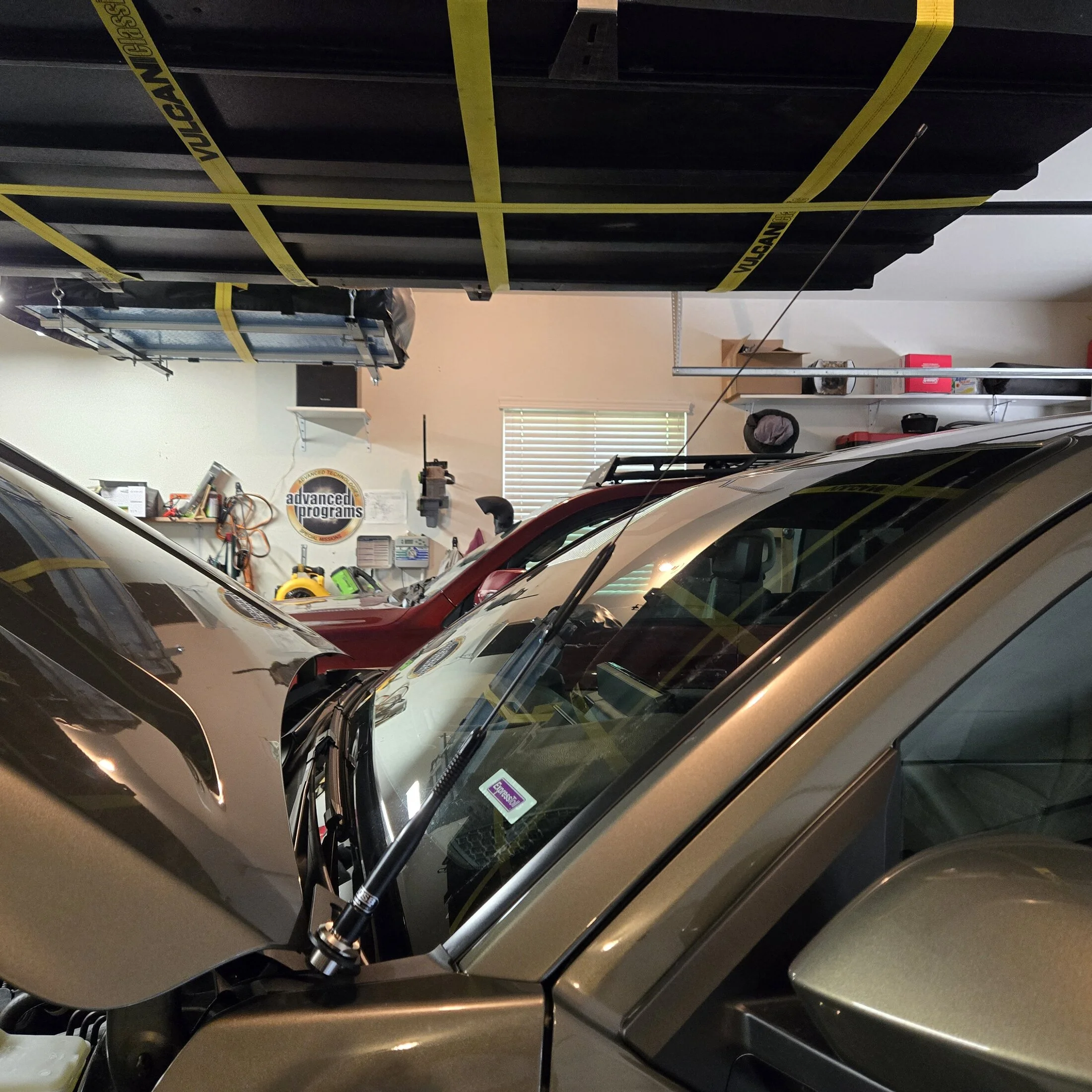

Completed the install for the antenna and radio is now setup. Only able to test it so far 200 to Taco in the garage. Maybe I will run an errand tomorrow and have my wife LISTEN on a hand held and text me if she hears me :)

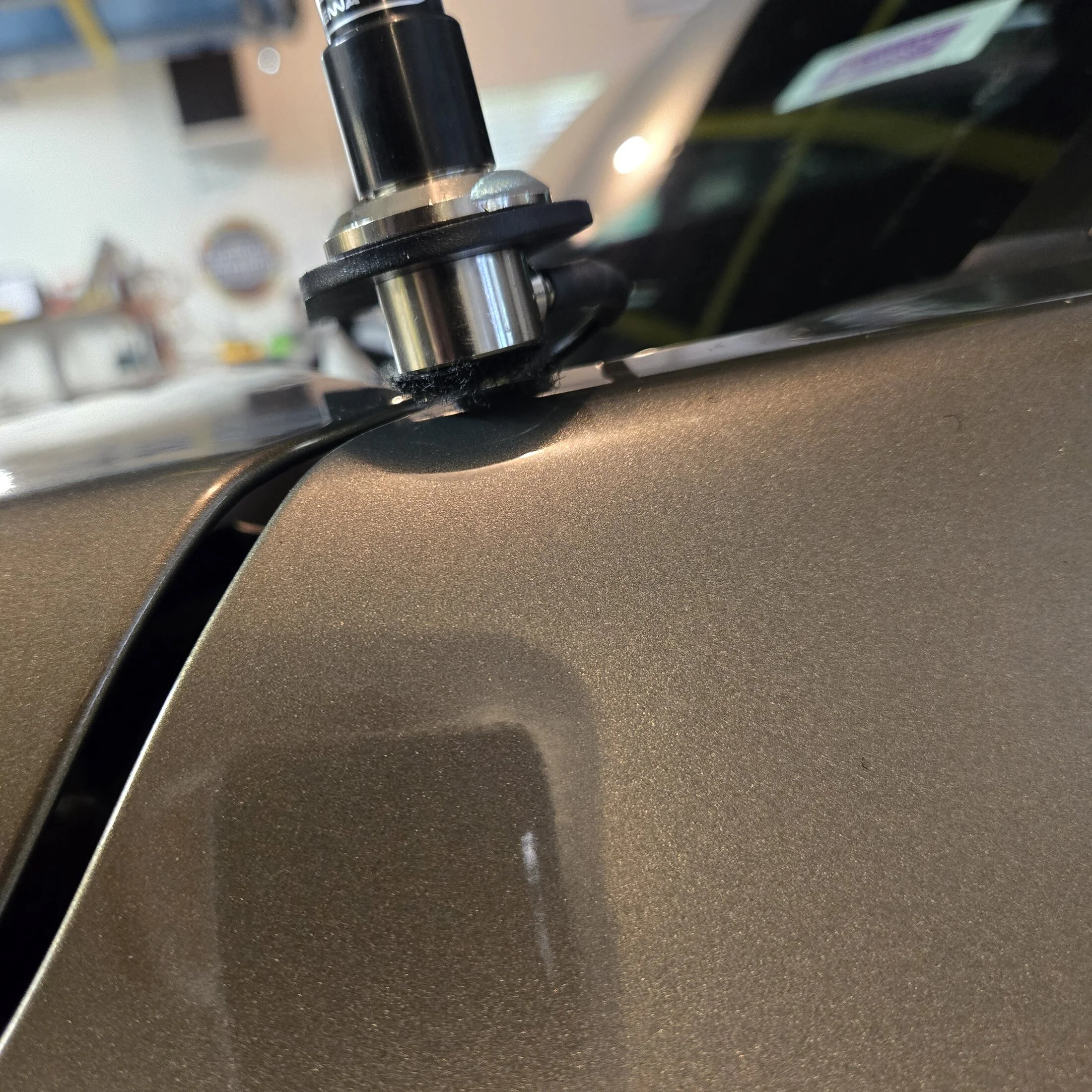

I bought the Bracket from Victory 4x4 pictured above. I drilled out the hole with a 5/8" bit and then used a dremel to remove a little more until the antenna mount fit
I then installed the bracket without the antenna mount. Need to be careful here and remove one bolt, put the bracket on and hand tighten. Hold the bottom of the hood while removing the second bolt as it will shift. Slide the bracket over the 2nd hole and put the bolt back in.
Tighten both bolts and ensure the hood is aligned when down.
Put hood back up and feed cable and mount through back of hood and into the antenna mount. I bent it slightly to give a bit more room before installing it.
Install the mount and tighten it down. It looked like there was clearance underneath, but I added a piece of felt to the bottom of the mount as an extra precaution against scratching the paint.
Screw on the antenna
It doesn't obstruct anything up or down and it isn't in the way out the front windshield

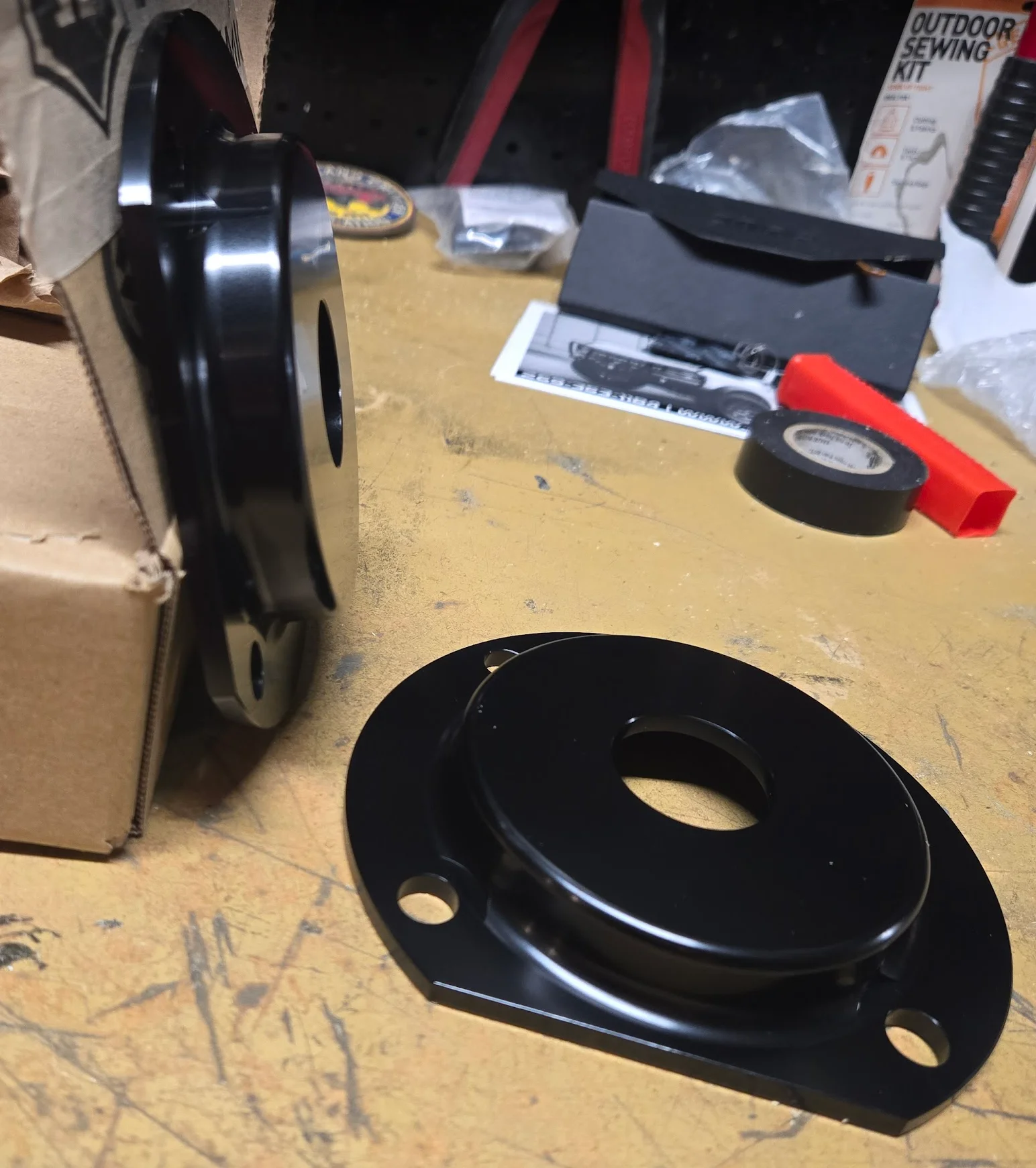

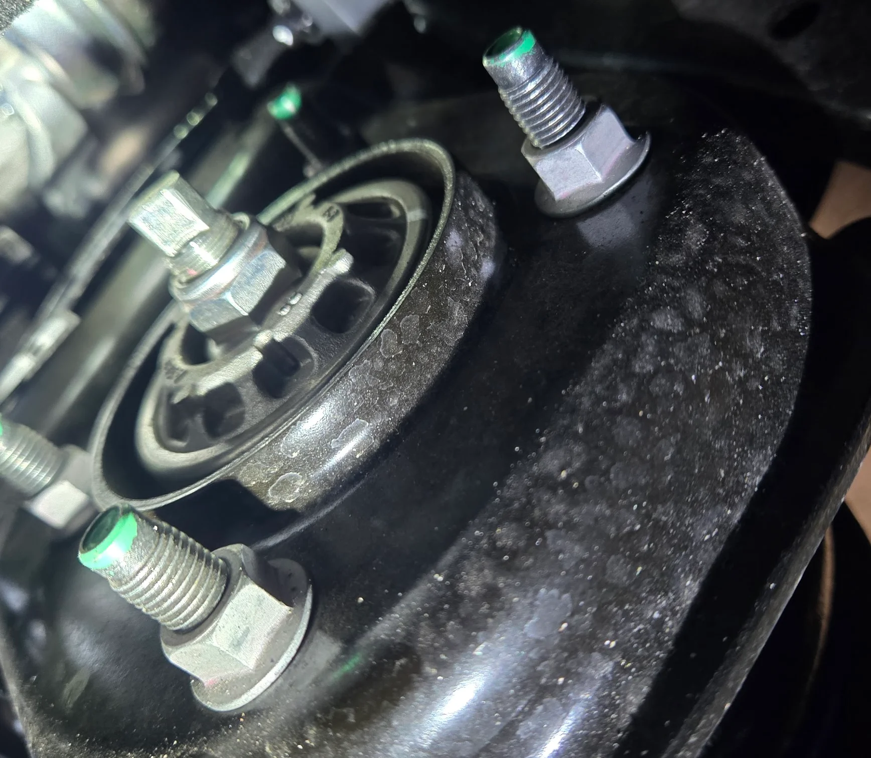

There have been a few Tacomas that have broke the shock top. ICON had one and did some testing and came up with a fix
View: https://www.youtube.com/watch?v=gn2Be4jAj_w
I ordered a set as looks like cheap insurance and they do look robust and easy to install.
The video shows the problem and how to install the fix. I wonder if the 250 has a similar design

I am glad I got the premium as the birds eye view can engage any time with the push of a button and it lets me know when I am good between the parking lines. All the cameras and algorithms are pretty cool
The safety sensors are real good at letting me know when I am close to something and automatically turns on the camera view.
The rear cameras look for traffic on the sides in a parking lot and pedestrians and display the item and direction with arrows. They will even brake if it thinks you won't in time backing out with a car coming up the lane :)
