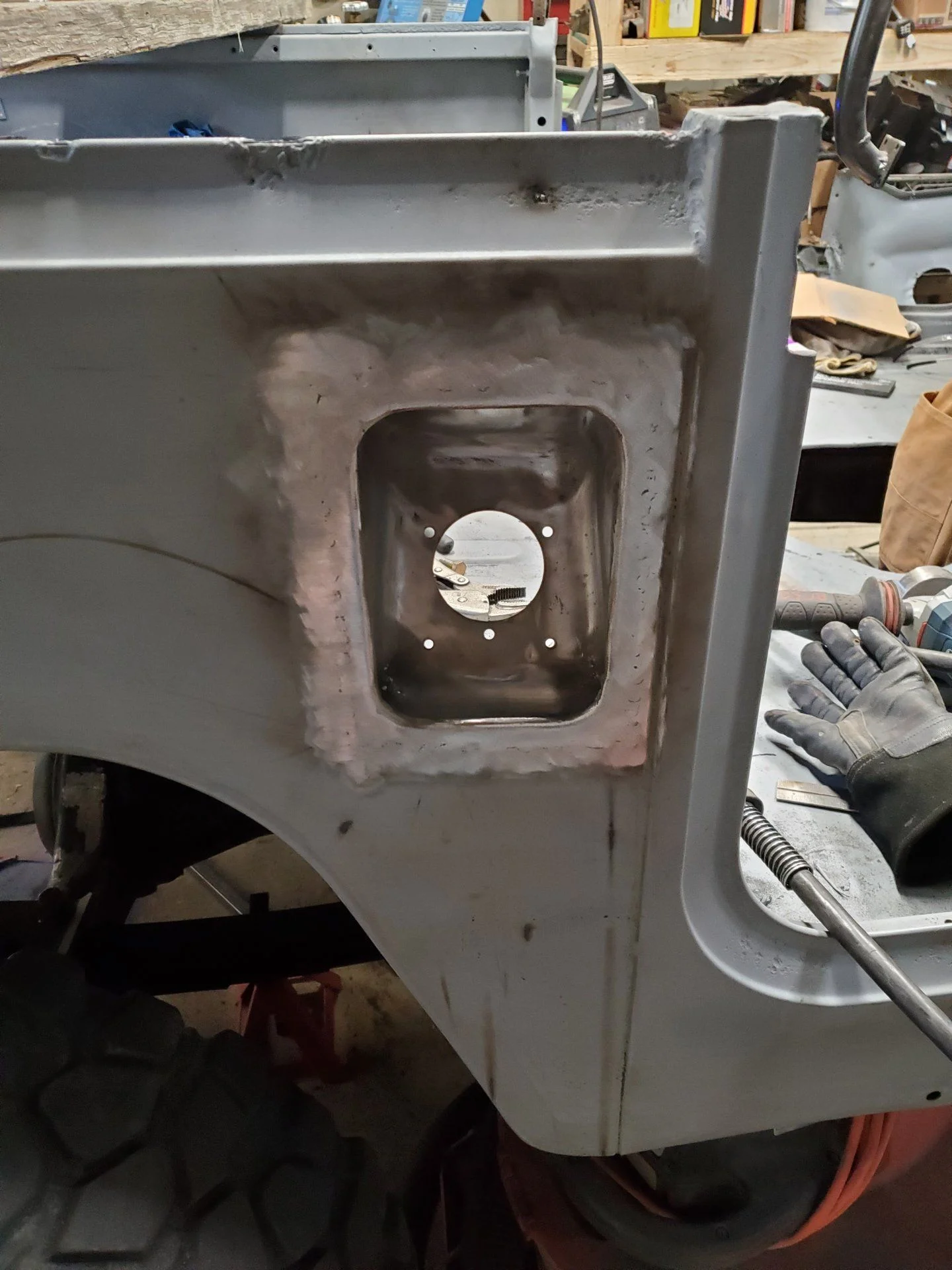

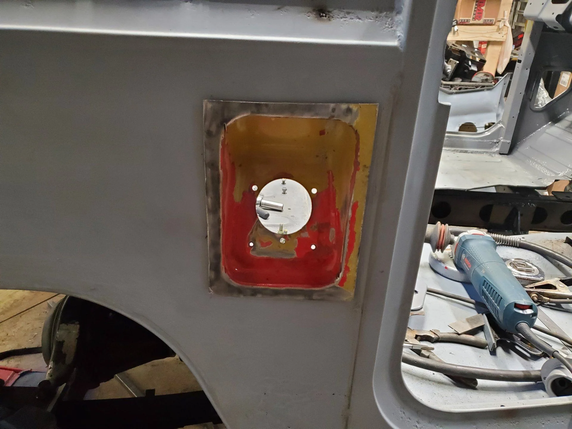

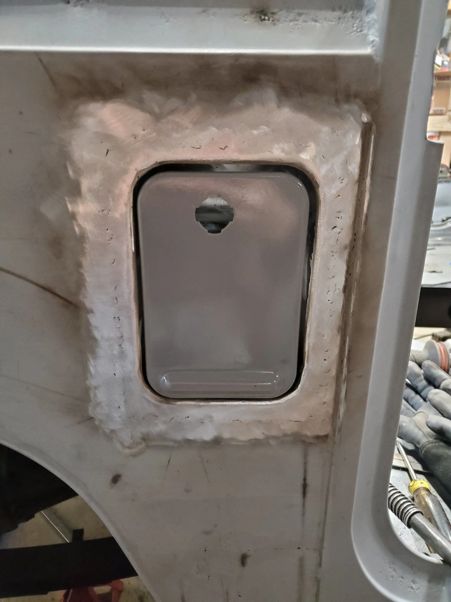

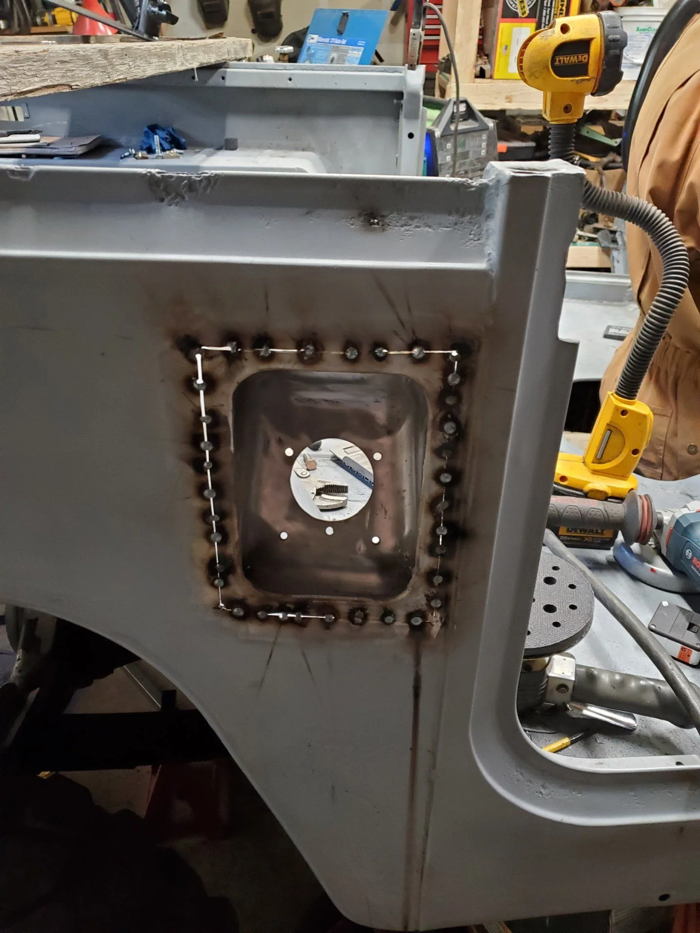

A little update. Got a gas filler hole in. Stupid po was kind enough to remove it.
The door is a little cattywompus, but it at least fits.
Does anyone know where I can get one of the OEM lock latches for the door? The little piece that bolts above the filler neck.

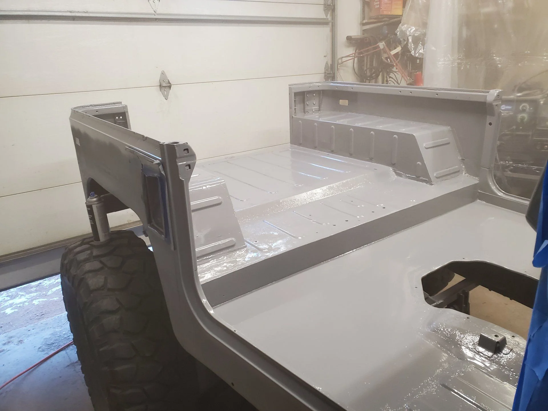

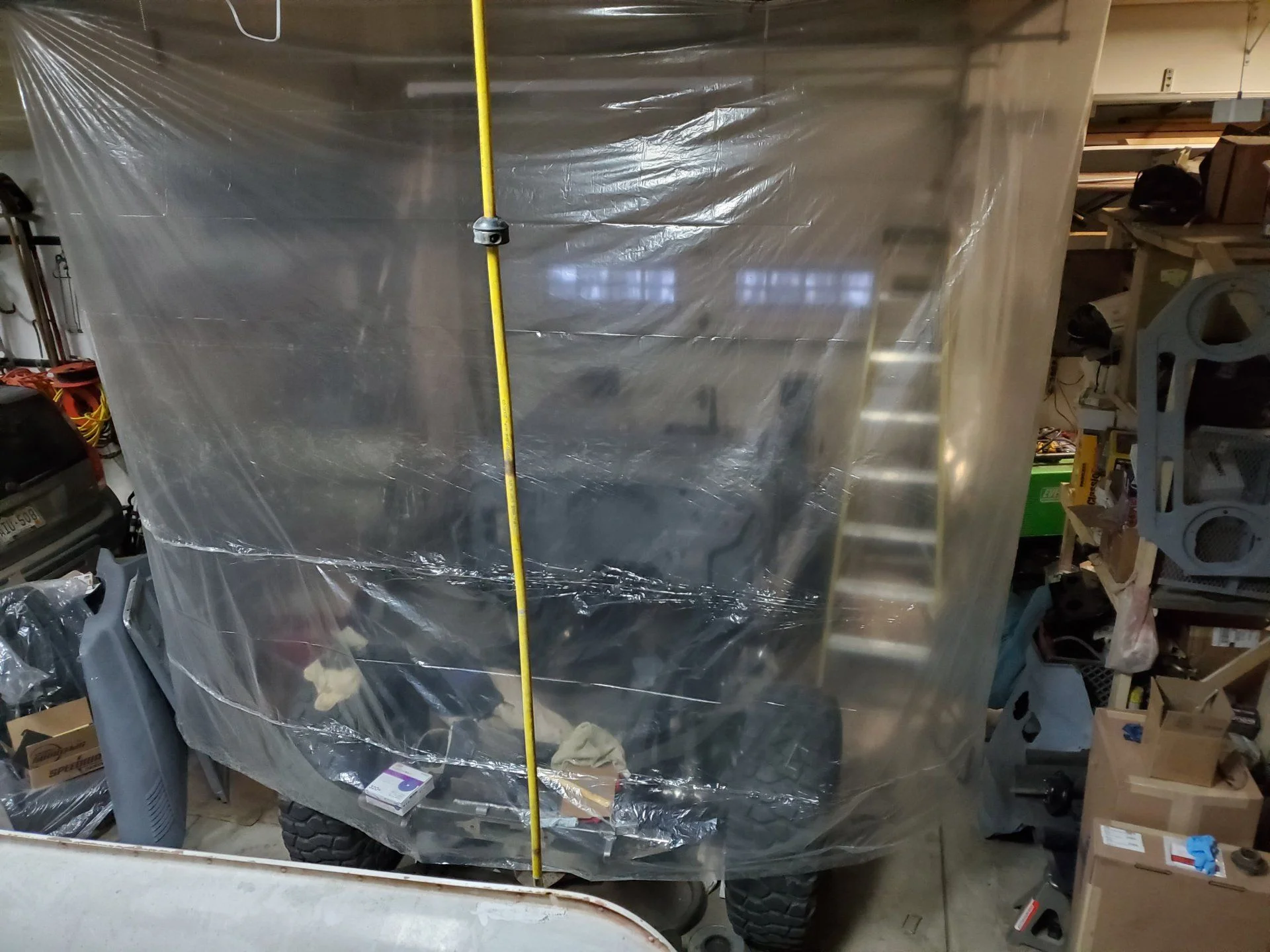

I put up some plasticz as I am planning on painting the rest of the tub tomorrow, so some more updates to come.

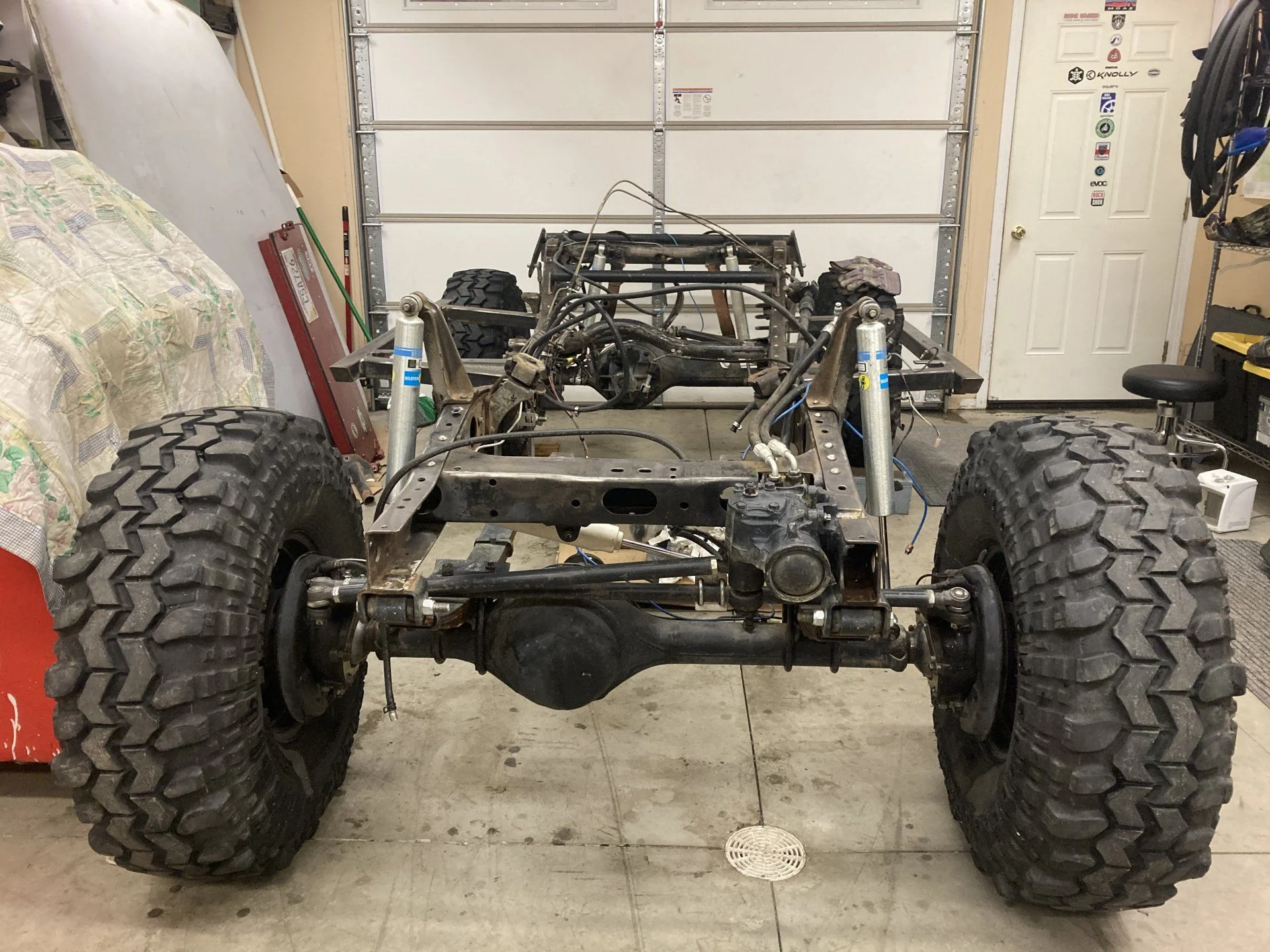

Here a shot of my frame ready to paint.
Looks like your tubs top rail has really disintegrated. Was it rusted that bad? The dealer may have those fuel door parts including the lock.
The passenger side is really bad. The PO was nice enough to cover it all up with a large amount of Bondo. It all came off when the tub got blasted. Funny enough, the other side is just about perfect. I'm leaving it alone pretty much. I hate Bondo and I am planning on running the hard top most of the time anyway. This is a wheeling rig, I'll make the body acceptable from 10 feet away. I'd rather have paint that I know will stick instead of filler.
Gotcha. Just my opinion as something you may want to consider. If the rust on that rail really was that bad, the sandblaster only gets rid of the superficial rust. If you cut off the top rail outer layer, clean out the hidden rust, spray with weld primer, put back together, the rust won't continue to spread. Fairly easy to do now. As far as running the hard top all the time, I've noticed on harder trails it throws off my 40s weight bias front to rear and it doesn't climb as well. You may find yourself feeling the same way. Also my hard top seems to get hammered on harder trails anyway so I prefer to run without it on the harder stuff. But on less difficult trails and on the street I love my hard top.
Good point. I'm about to start painting that, so I may not, but I'll dump some rust converter down there to help stop stuff. I thought that was a single piece rail with just the clamshell up top. Hopefully, the dry air here will slow everything down as well.
It will probably slow it. With your fab skills though you could probably cut it out and fix it in like an hour.

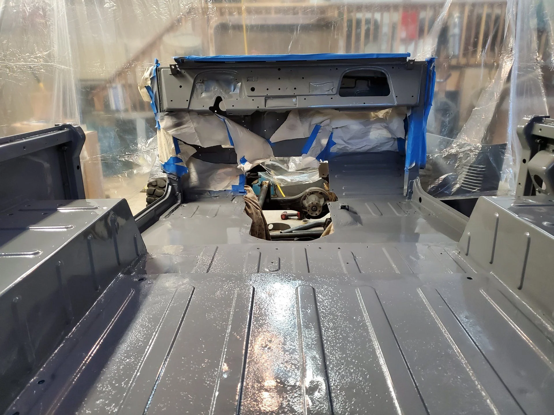

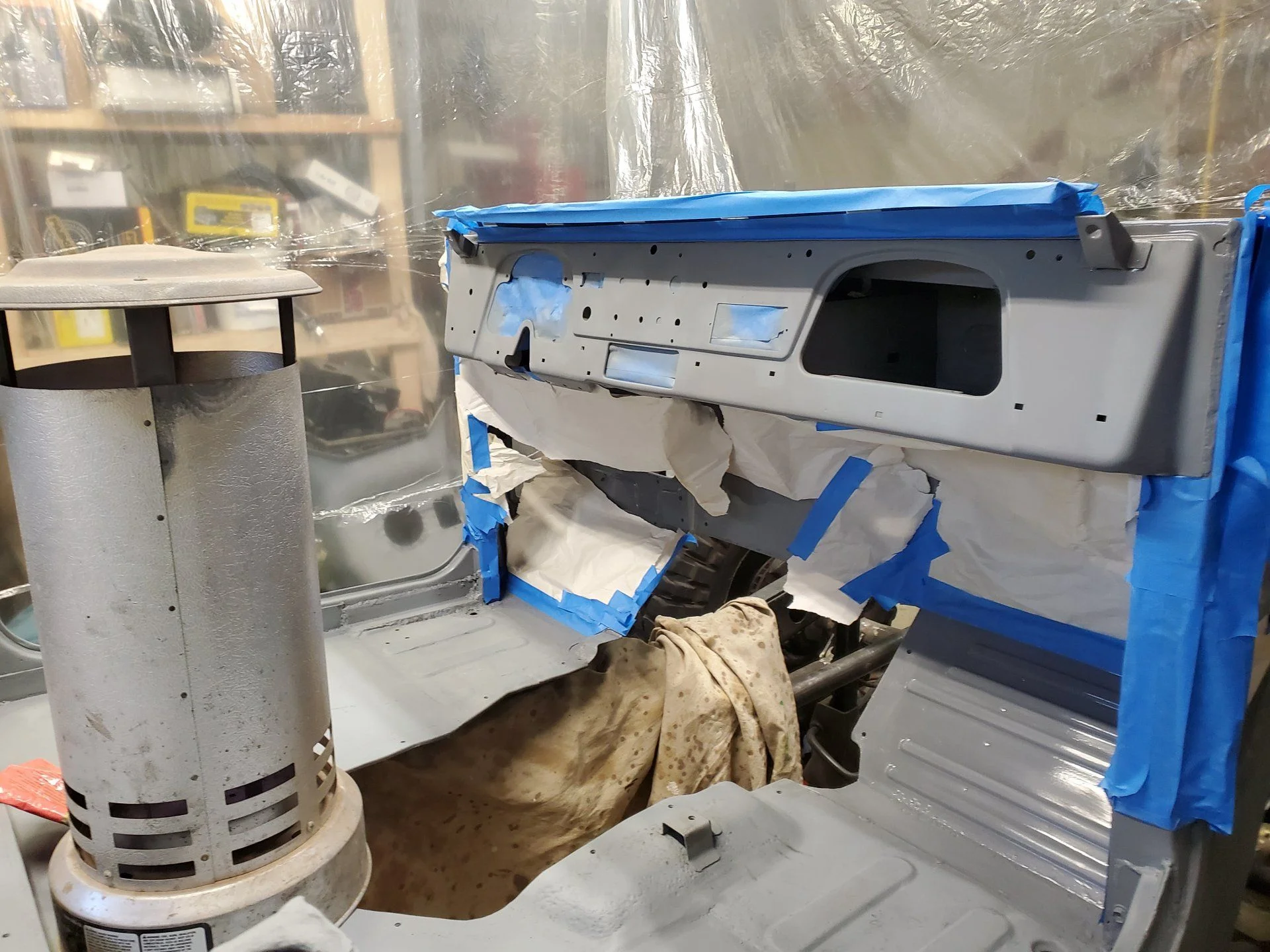

Got the rest of the interior prepped and painted today. Barely had enough paint, but everthing got 2 solid coats.
Preheating everything is a big pain, but necessary.
All painted. I'll wait about a week before doing anything, but I can fully start reassembly now.
