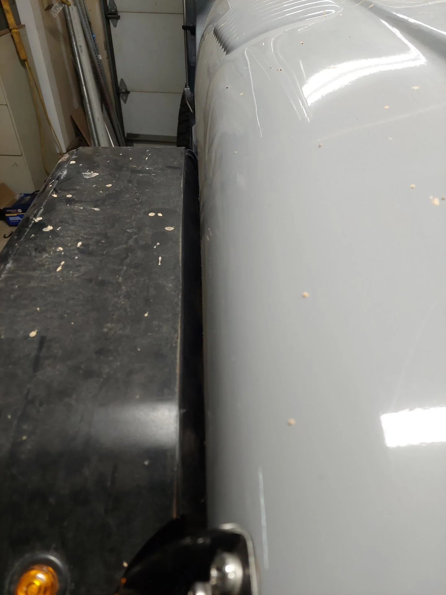

New front fender rubber to stop me from flinging stuff everywhere. It helps a ton.

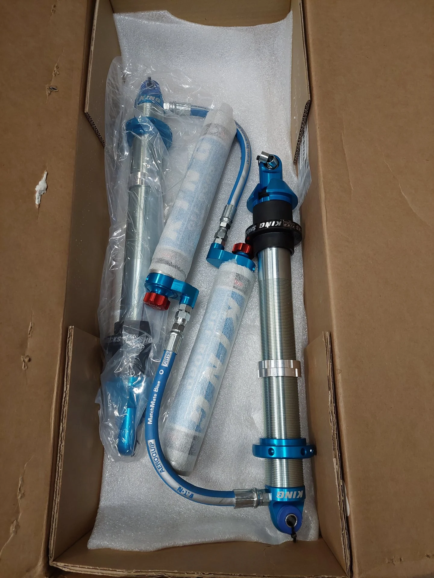

New coilovers for the rear. King 2.0, 12", with compression adjusters. I'm planning on a 1:1.2 rear cantilever suspension and mounting these laterally in the wheel wells. Should give me about 14" of rear travel, without cutting my floor.

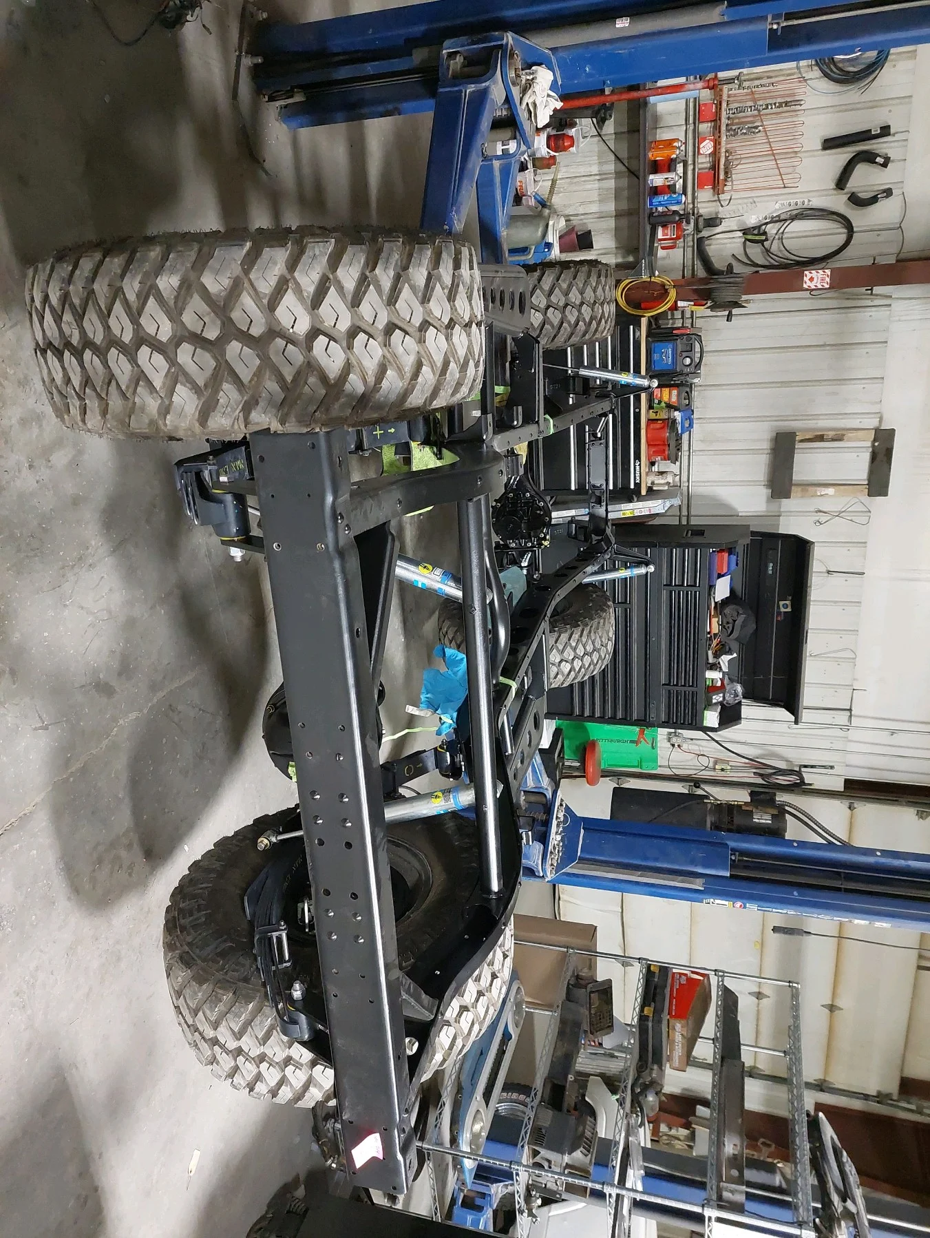

Got a ton of stuff prepped for the new shop build, and got the chassis, suspention, and axles reassembled after paint and zinc.

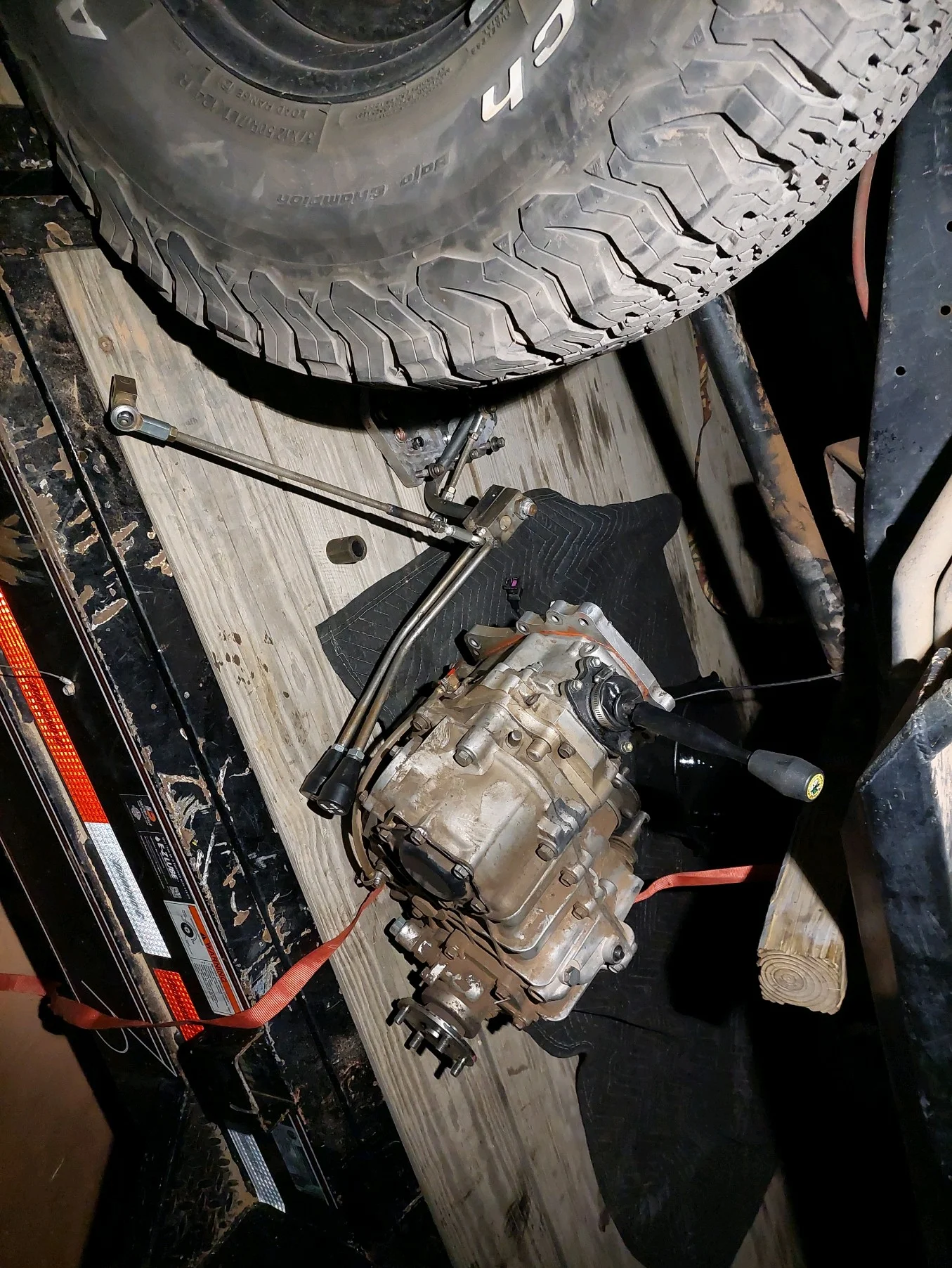

Later that night, this fell out.
It's heading off to California to @zidaro in his new build.
