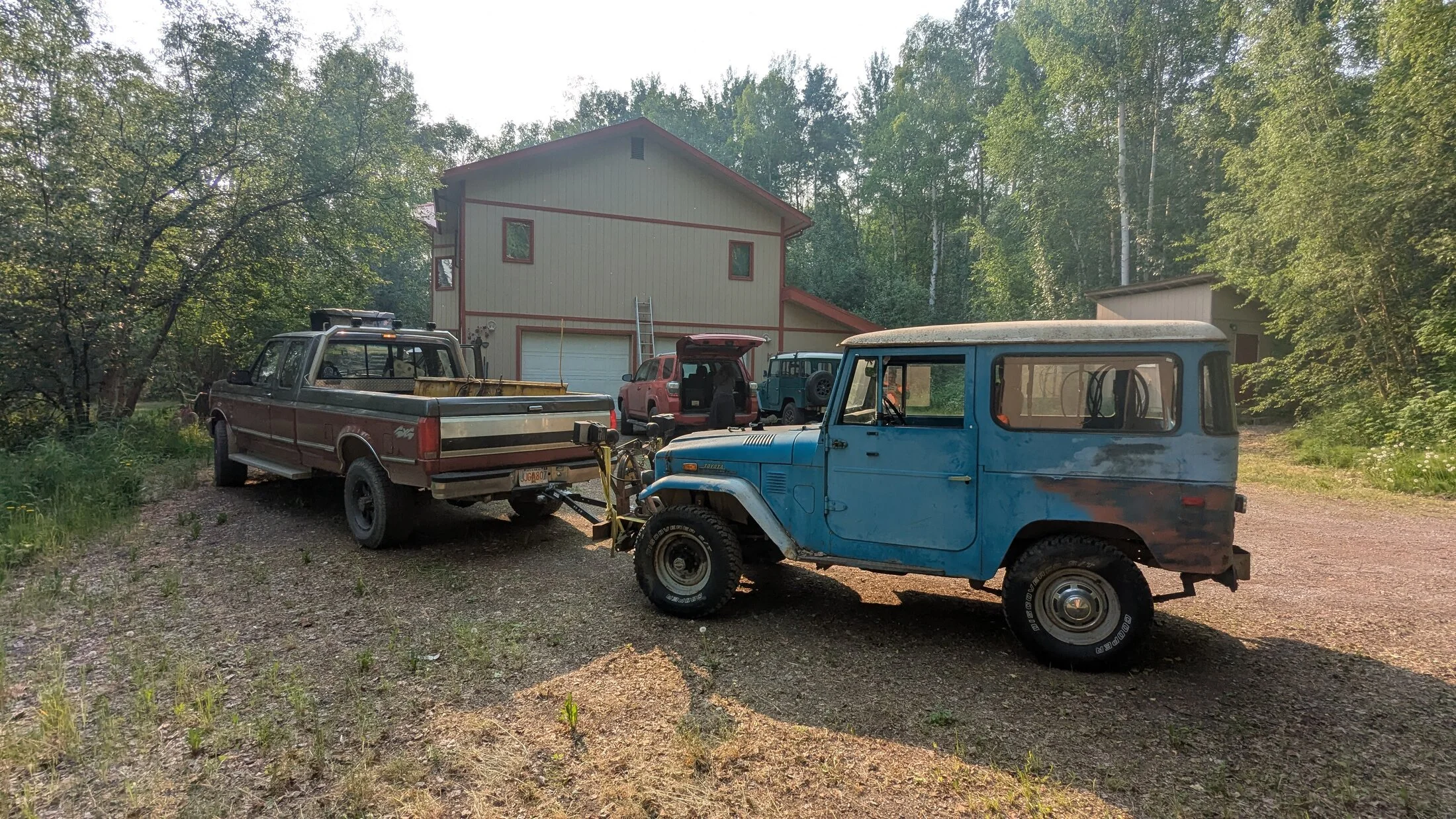

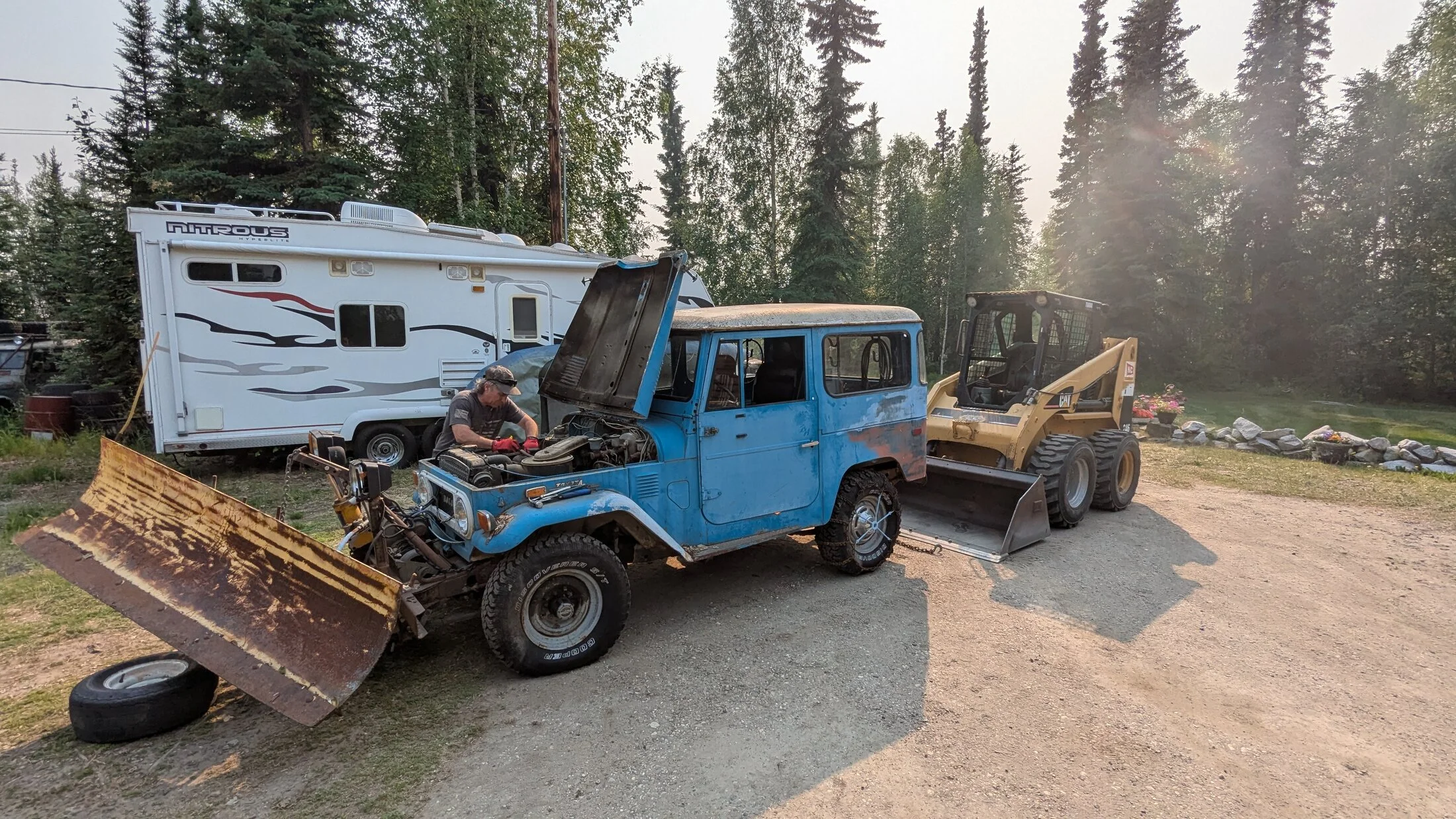

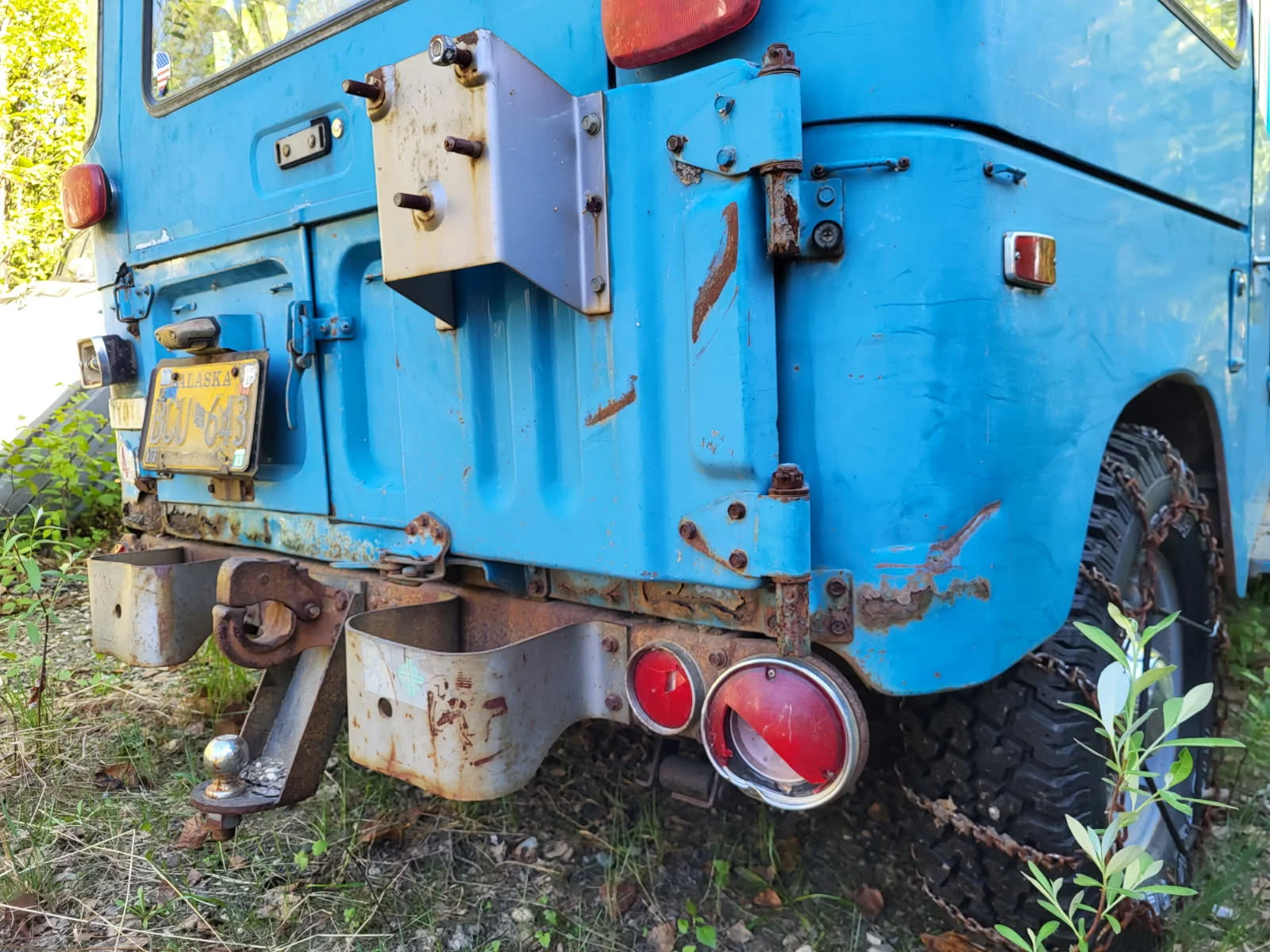

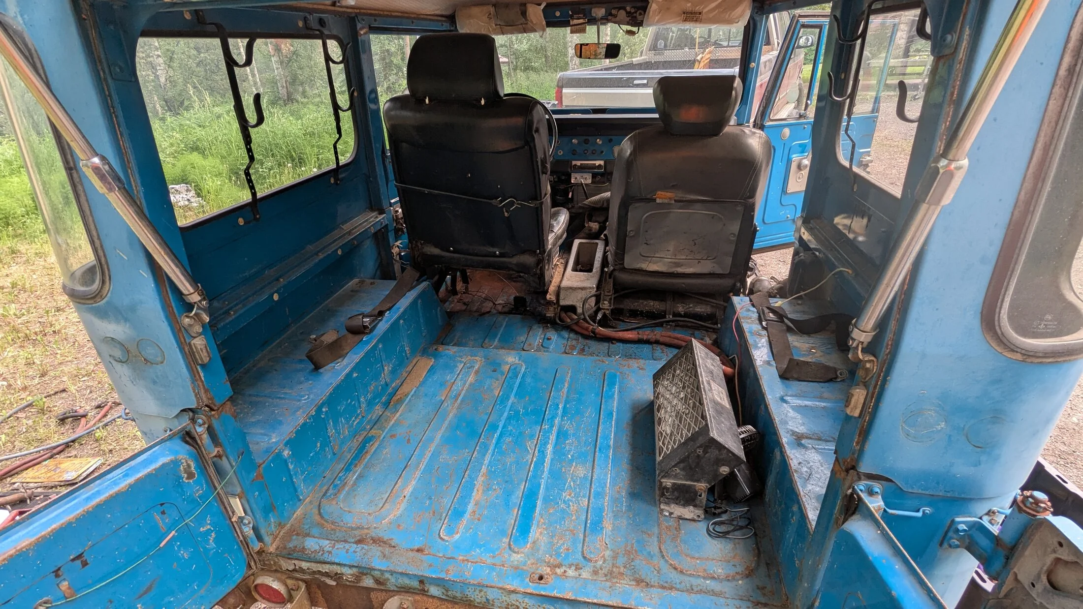

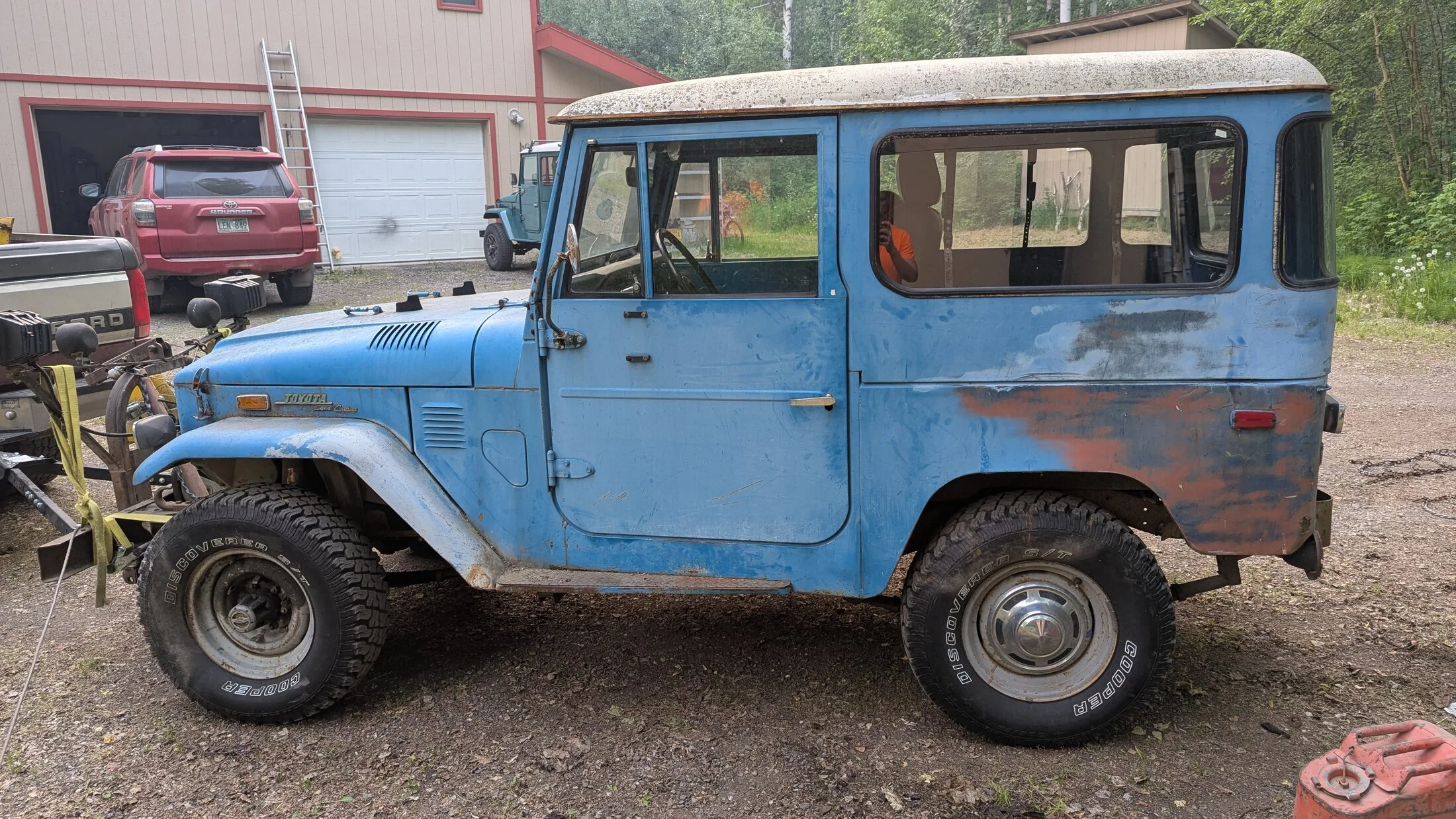

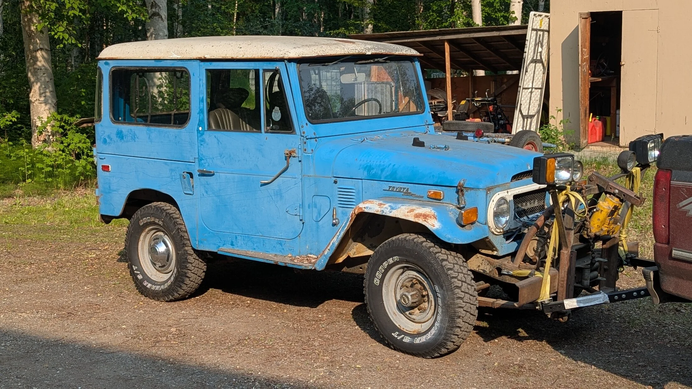

I picked up this 1973 FJ40 last night from a local in the interior of Alaska and will be chronicling the journey here. The plan is to keep it rough enough around the edges to be able to do a bit of off roading and exploring and not feel too bad about scratching the paint.
Pertinent details:

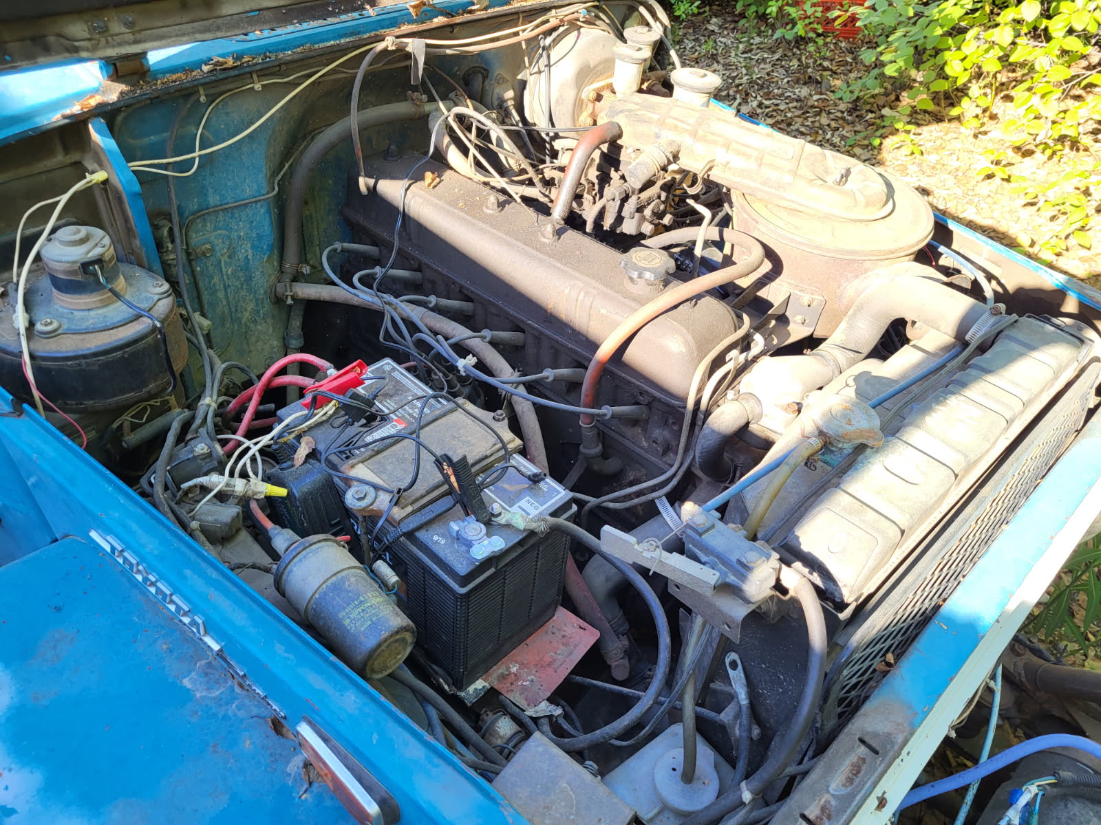

1973 FJ40 with seized original 1F engine.

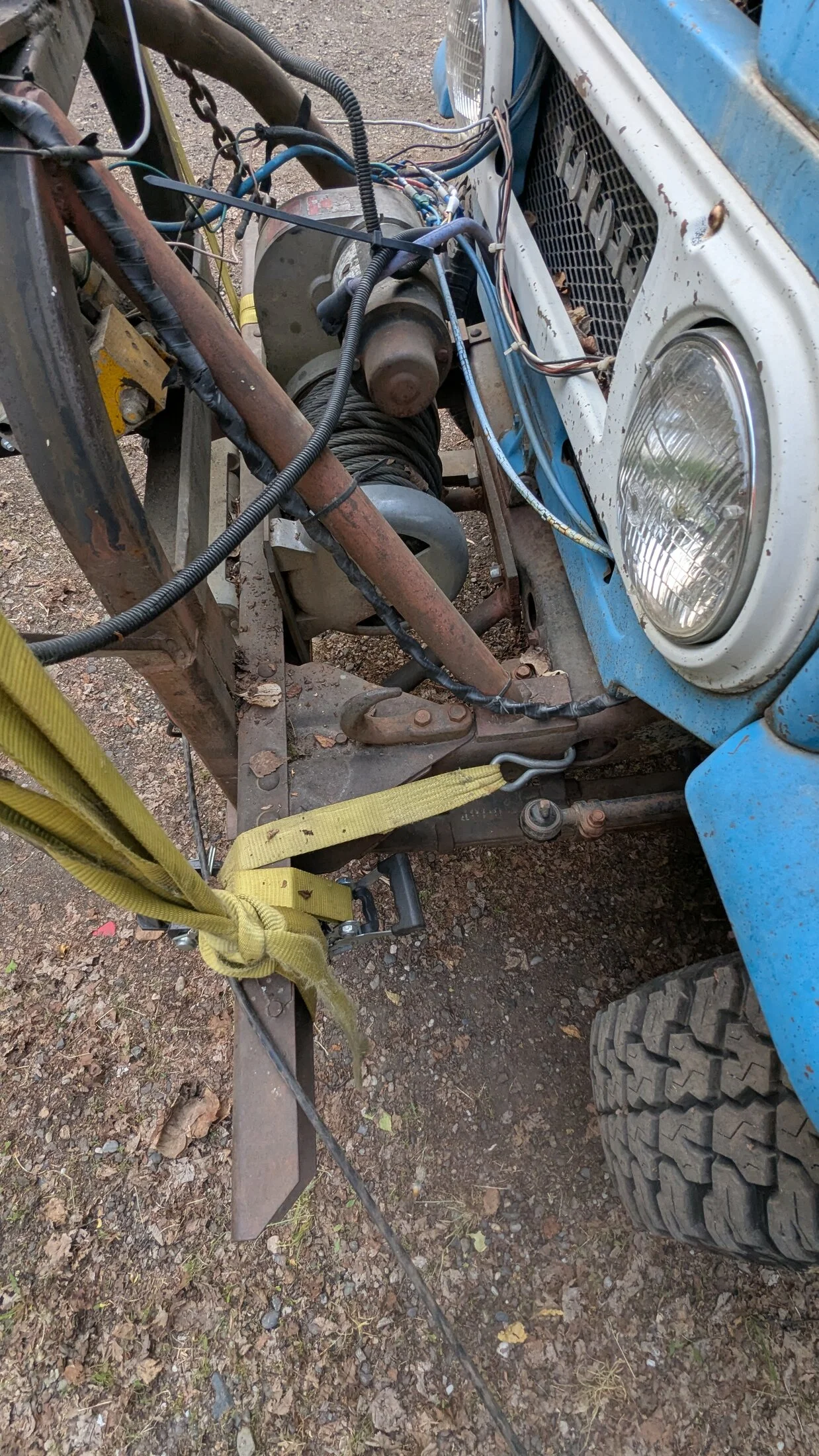

Original Warn/Bellview winch 5687.
Original winch bumper and interior controls.

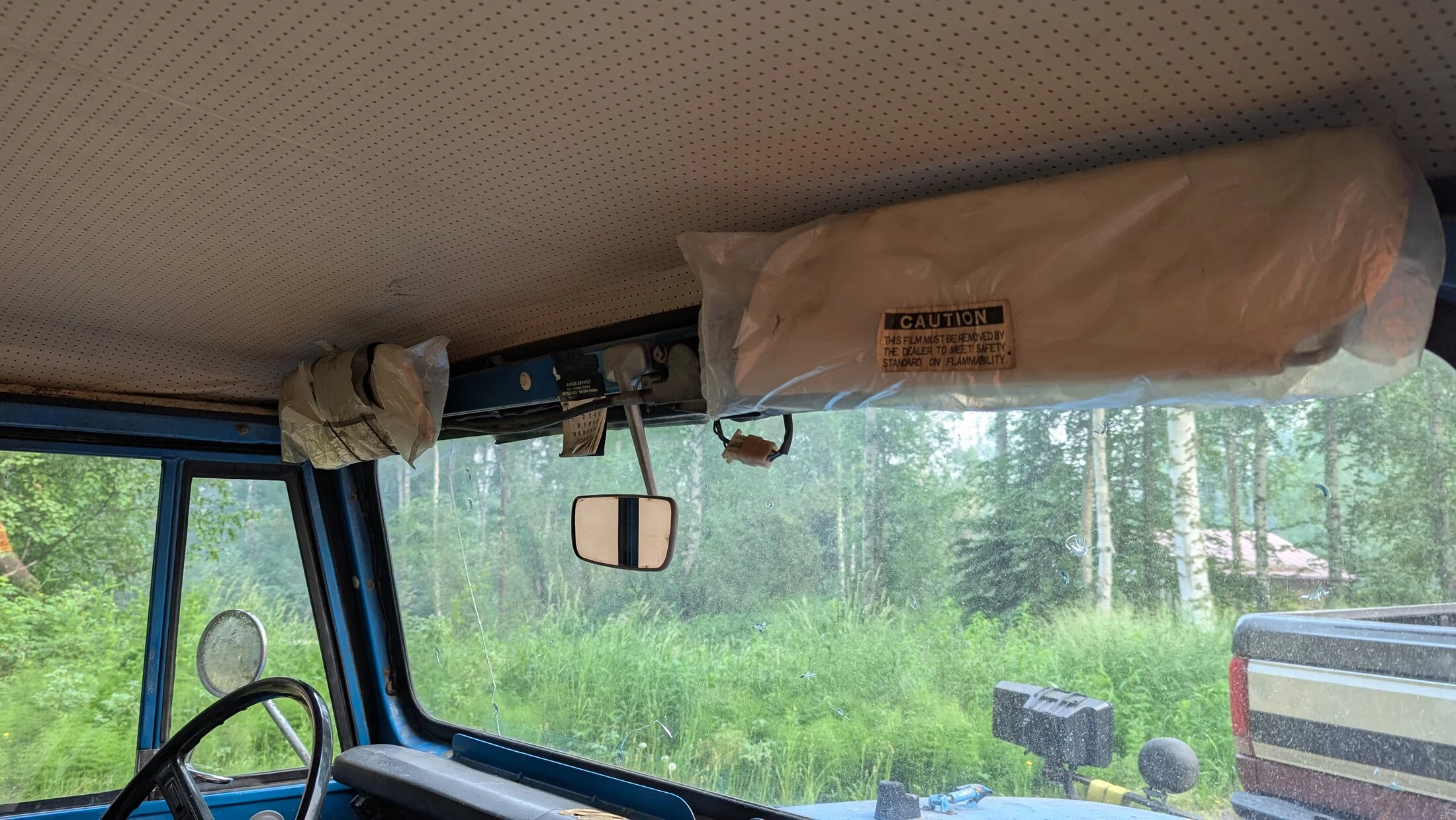

Sunvisors still in plastic wrap!!

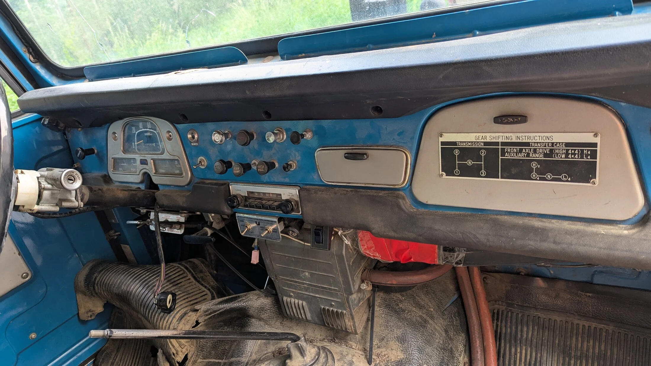

Everything on the dash looks complete and original.
What looks to be 17,000 original miles on the odometer as this has been a plow truck its entire life.
Still has the original floor mat but it's in rough shape.
Drivers seat was replaced at some point.

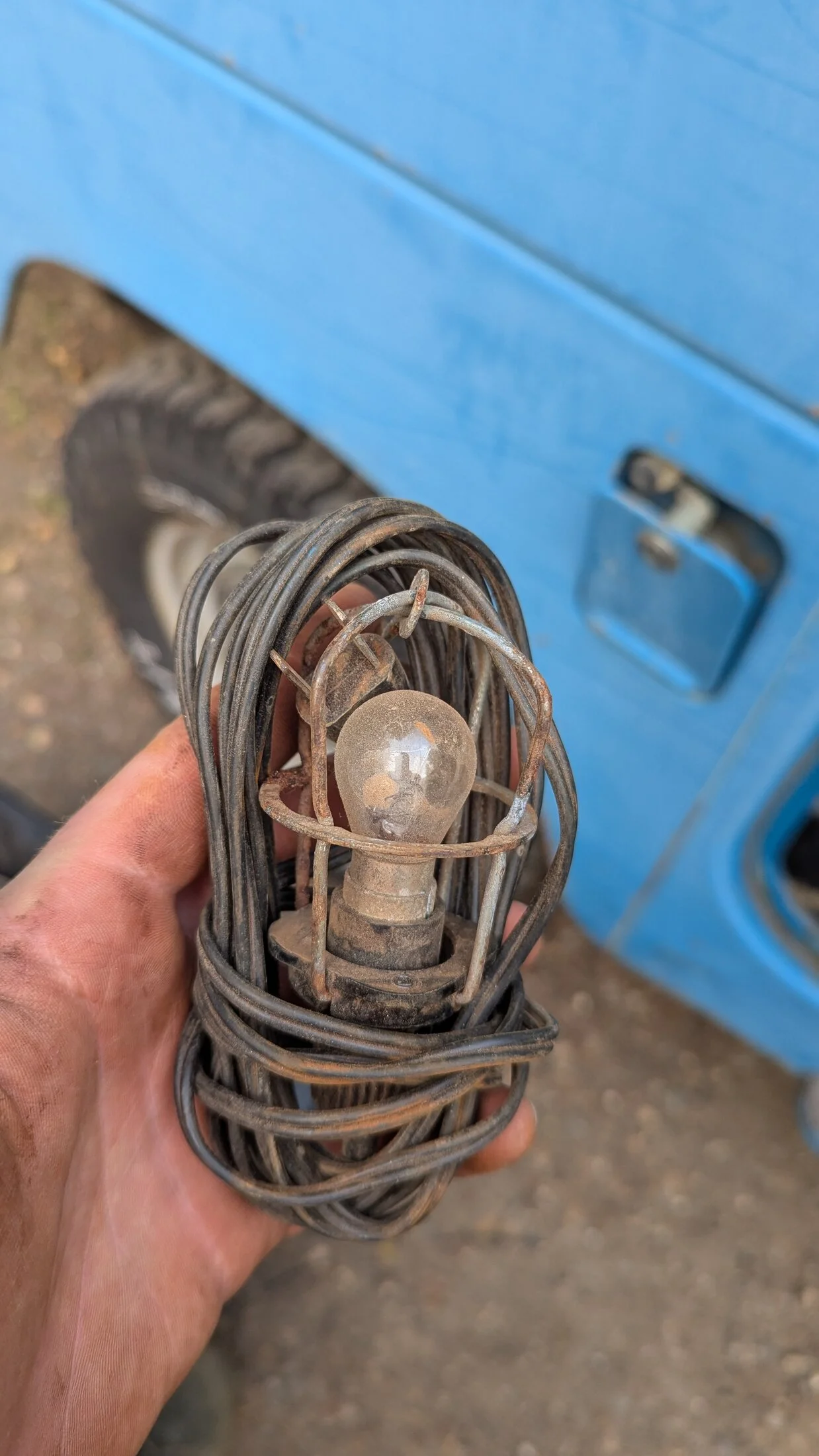

I found the original work light in the glove box too. Never seen one of those.

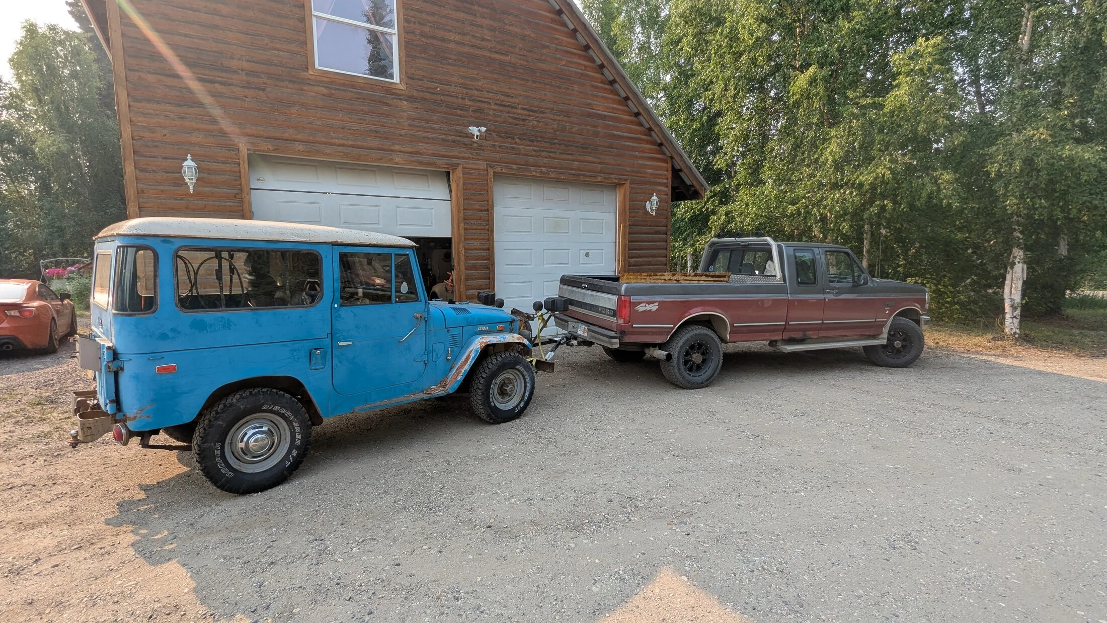

Towing it home last night I had a jeep pass me and give me a thumbs up. Made me chuckle.

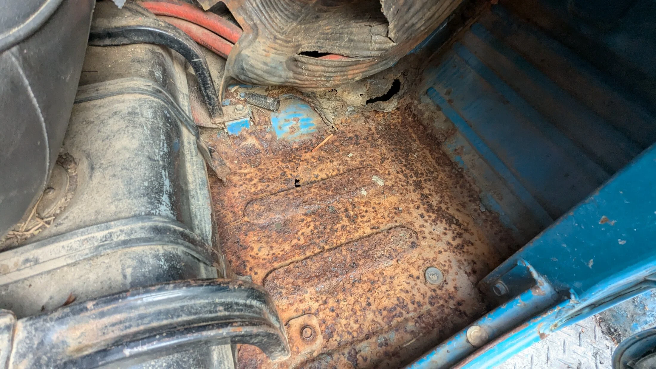

I know I can source new floor pans from a few different online websites, but if anybody has a set of unused floor pans sitting around I'd be interested in buying them. Same goes for a set of rear quarters patch panels and rear sill.

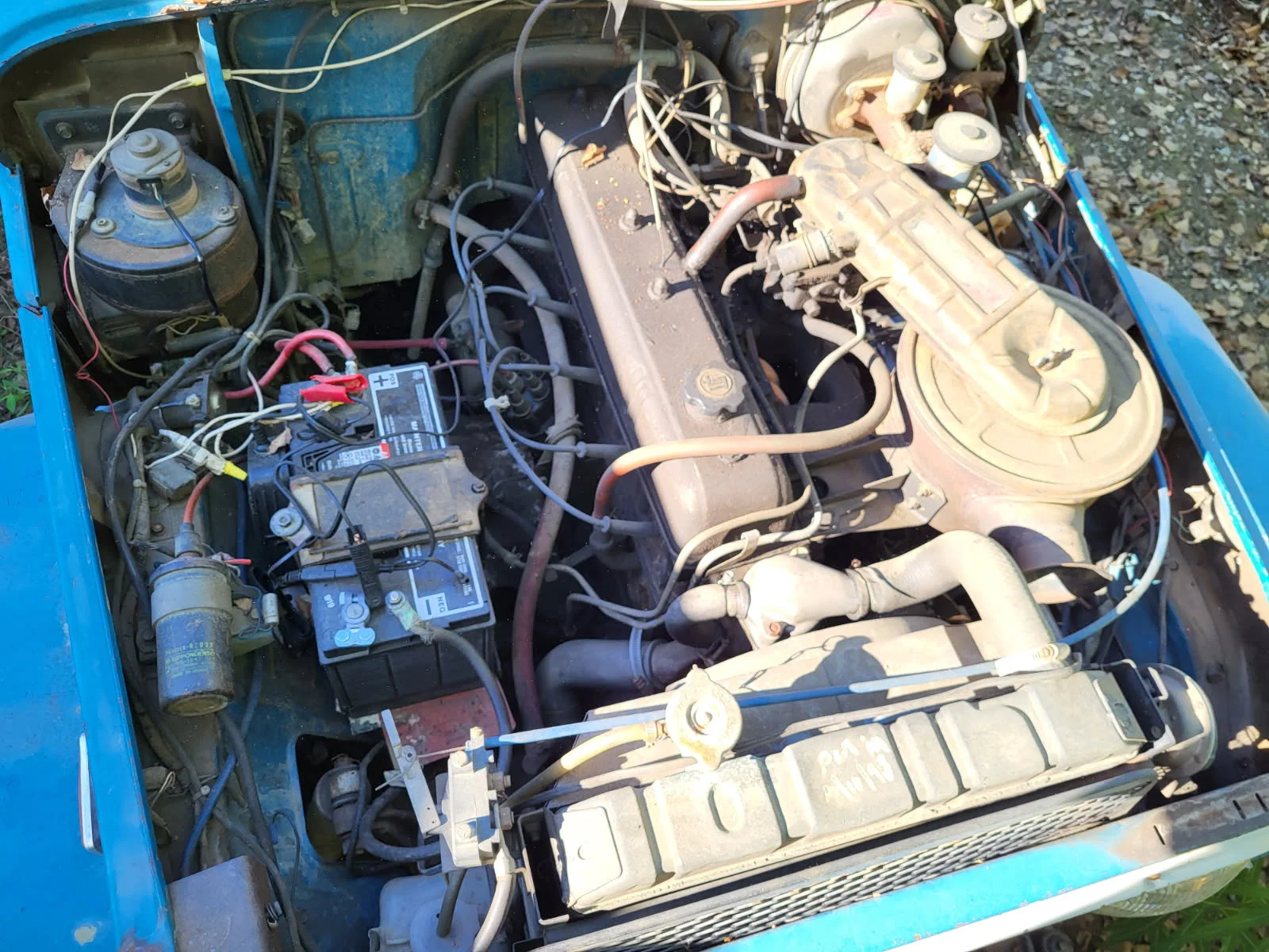

Have you considered trying to free up the F engine? Just because it's seized doesn't mean it's toast. It could just be ridges on the cylinder wall that are keeping it from turning.
Ok yes I've considered it and will be trying to break it free this week. But, the PO said he let it run dry on oil and that's why it seized up.
So I may get lucky, but the reality is that it's probably toast and I'm exploring other options. I've also got a trip planned down to the States in July where I'll be driving a truck and trailer home so I'm also open to bringing some power plant home with me.

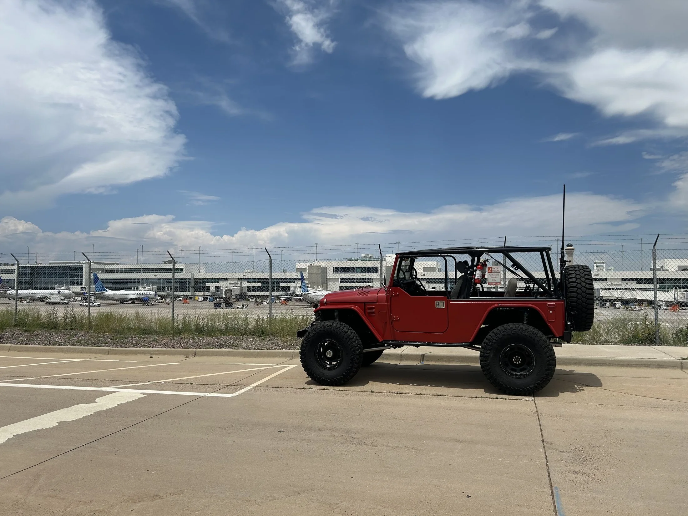

Mine is getting 13 mpg and it weighs 5700 lbs empty. I also am not too light on the throttle.
I have 187:1 final drive in low/low and I have amazing control off road.
I’ve had a 350 and 383 sbc in this same cruiser and the LS is no comparison. It drives like a modern truck, and smells like one, too.
I drive mine on the road and I pull a camper over the mountain passes in CO so the extra power comes in very handy. I also have a 5 speed transmission, which helps with noise and fuel economy.

Keep in mind that my Cruiser is very heavy compared to a stock Cruiser, which I imagine cuts into the fuel mileage quite a bit. It weighs 5700 lbs empty. That is without a hard top and doors, too. I am also running a 6.2L with 1-ton running gear, NV4500 and 40” tires. I’d probably run a 5.3L LS if I were lighter.
I wired my engine myself using the stock GM harness as a donor, which was a recommendation that I received from someone in this community (@archie73 ?). I connected with Brendan Patton at the following company for guidance and tuning.

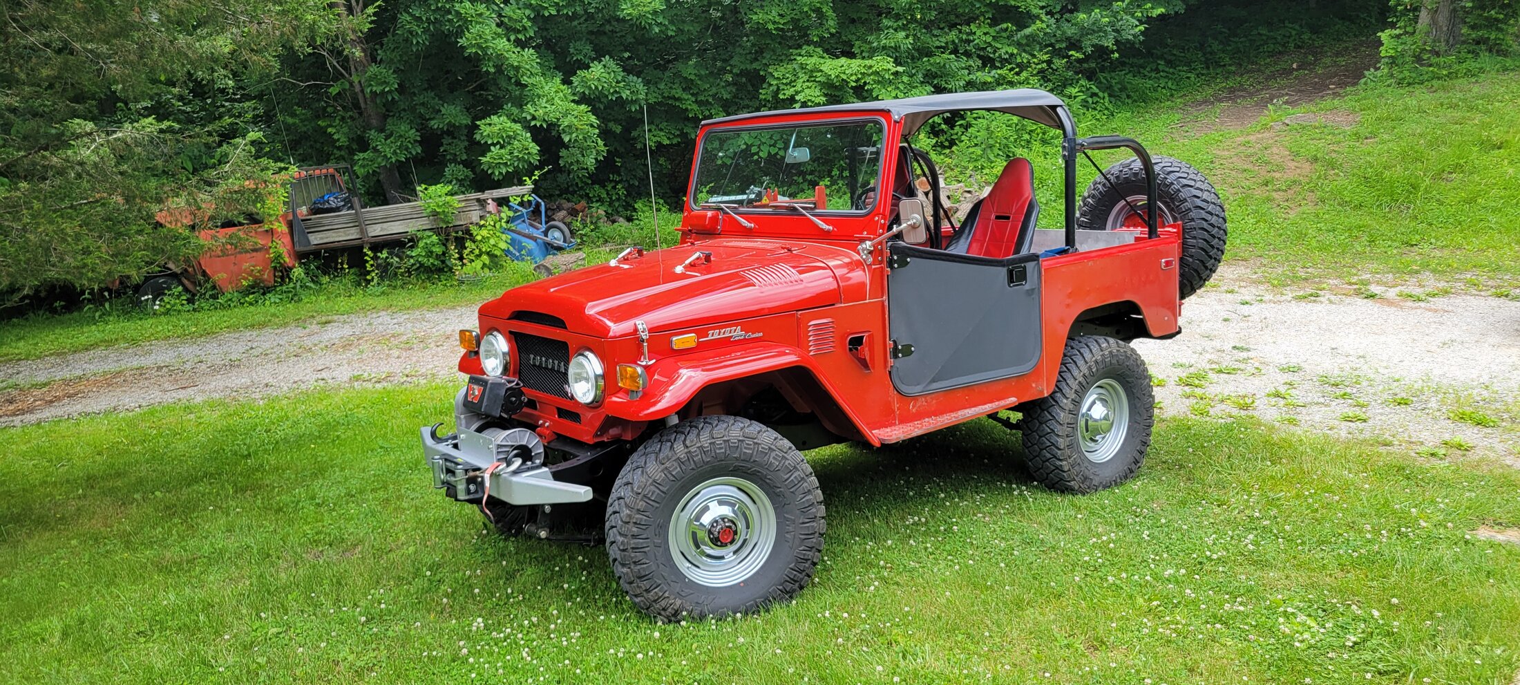

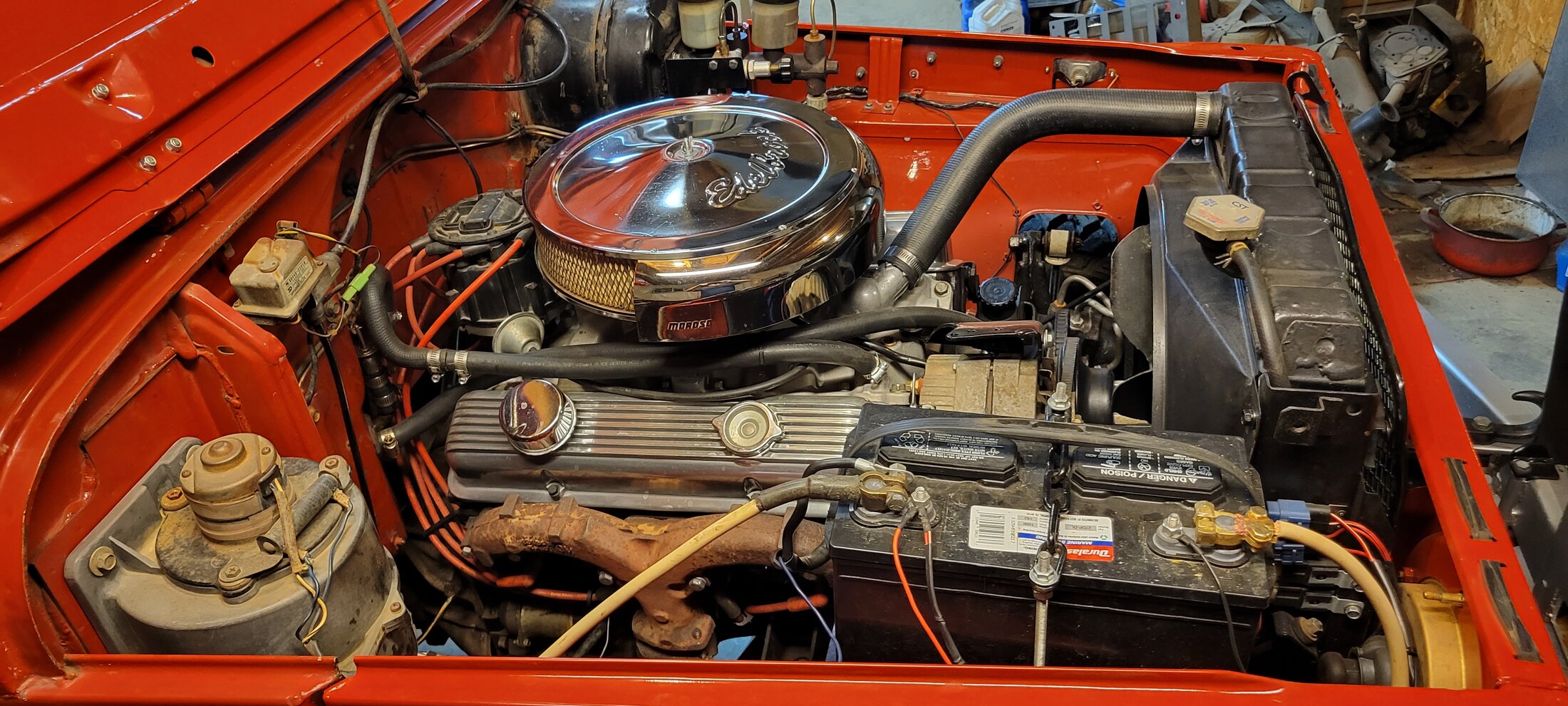

The v8 makes them sporty and a lot more enjoyable to drive. Carb'd 350. Wiring consists of a hot wire to the dist and wiring required to run an internal regulatated GM alt. I use the factory gauges and an idiot light for the alt. All wiring is stock color correct. I added 2 wires. Currently It gets about 14mpg's, but should improve once I get better heads on it.
your Cruiser is clean!
Thanks.
Strategic pics and a shiney frt end parts. It's got some issues, but overall pretty solid. It's a work in progress. I've never had one drive so nice.

I poured WD40 down into each cylinder and waited about 24 hours. Put my 24" breaker bar and 46 mm socket onto the crankshaft pulley nut and couldn't budge it. Guessing I had around 100-150 ft-lbs of torque on it. Bummer, but not unexpected. I may drop the oil pan and loosen up the crankshaft bearings one by one to see if one of them is spun and welded to the crankshaft at a later date, but I'm leaning towards doing an LS swap currently.
