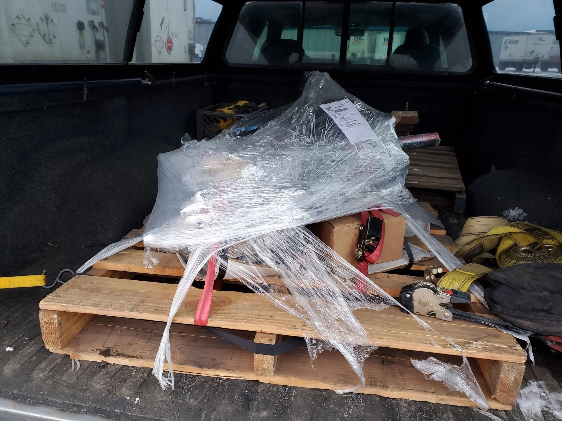

Picked up this hunk of metal from the shippers today. Thanks @orangefj45!

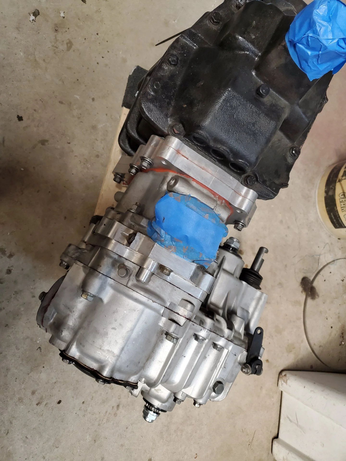

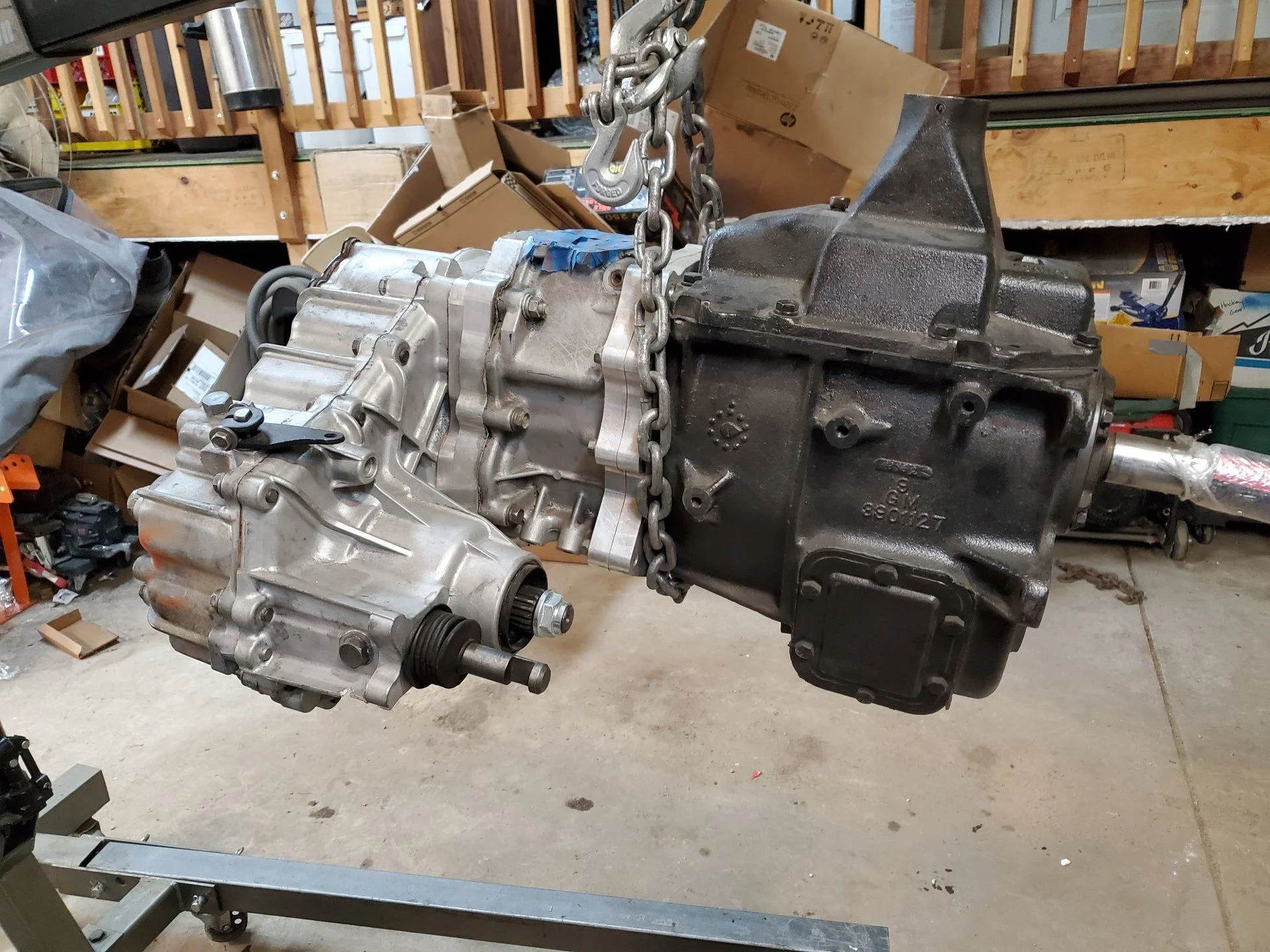

SM465, Toybox, Splitcase has arrived. Now to mash these two drivetrains together...

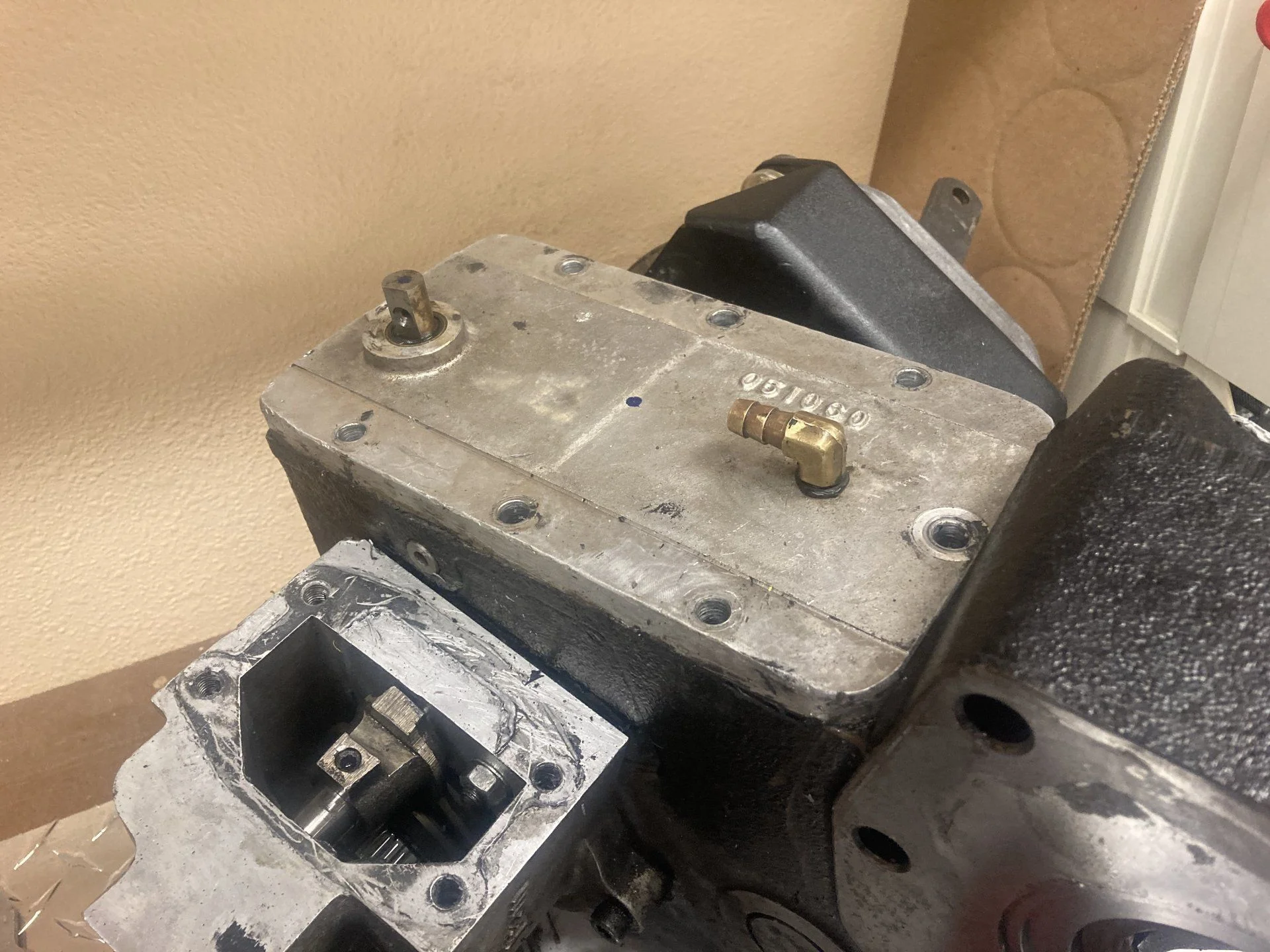

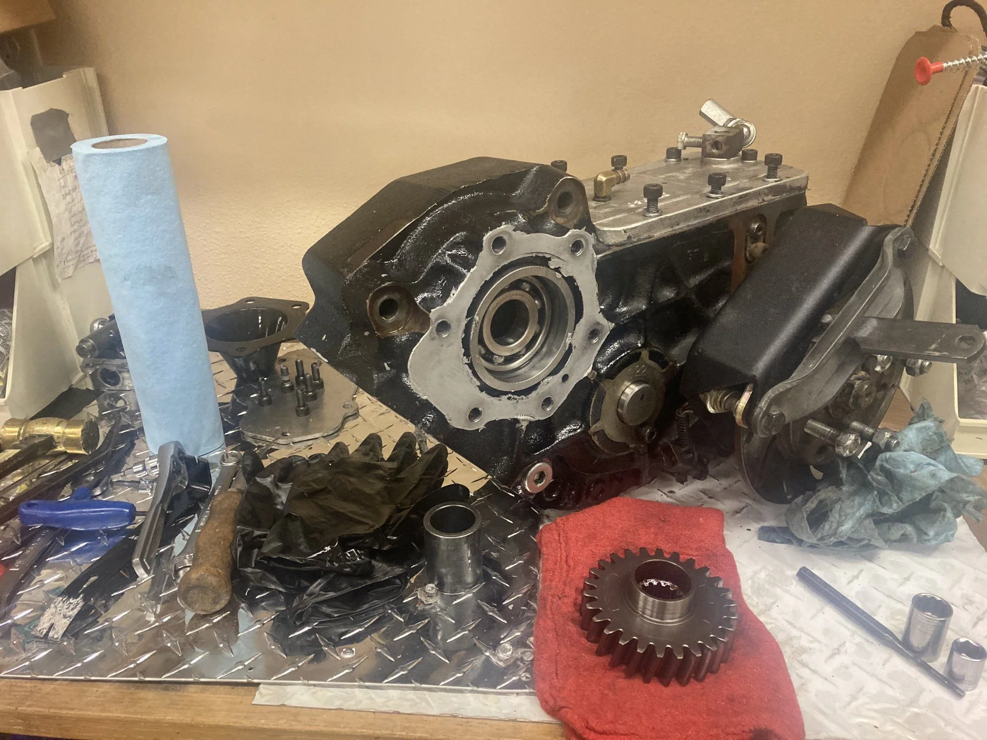

This is the case cover. What a bear. I can’t remove it. I’m I missing something?
I've never had to pull apart an Orion. Maybe post up in the pinned orion thread so the guys that really know them can help.

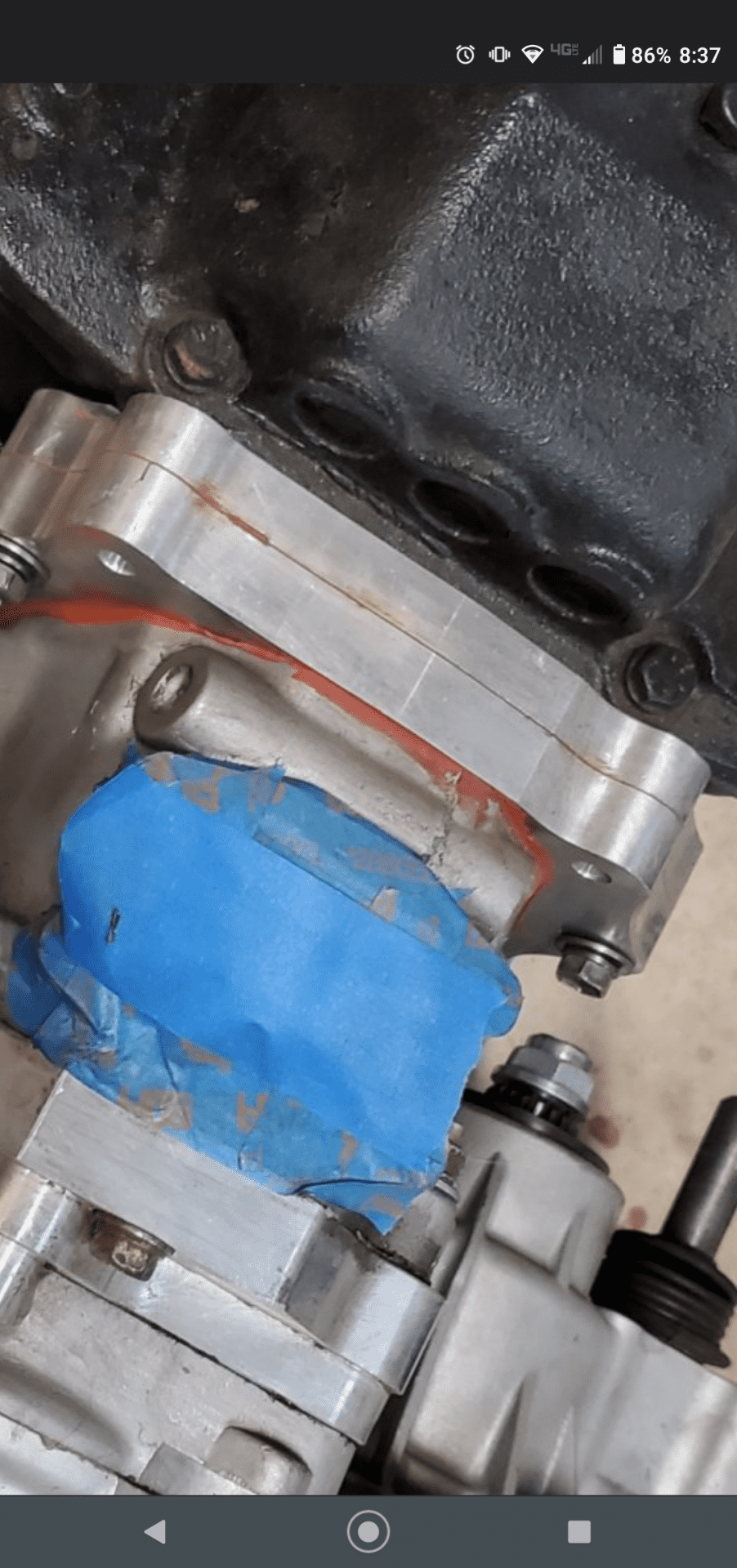

Running into some problems separating the SM from the toybox. I've walloped it pretty good, but I can't even get anything to move. I can't get anything between the plates to start prying them apart. Anyone have an idea how to get the two seperated? @Godfather90 do you know if it is only the 6 bolts on the plate closest to the transmission that needs to be removed? I'm througly stumped.

Hmm, I may just take this to a transmission shop and let them fiddle with it. I don't feel like breaking it.
Are these through holes?
Or are they blind?
Is that where the alignment dowels are?
If they are blind with a dowel there might be enough material to use a bottom tap and thread it. Thread a bolt in there and bottom it to the dowel and pop it apart?
Just a thought...
Mike

One has a pin. Other is empty. I may tap it, but I worry that I am going to strip the aluminum before the thing pops. A block and sledge wasn't moving it at all.
I bet if you can thread it and get a good purchase it would pop it right apart. It will concentrate the tension on thst comer and spread it easily. Just lubricate the threads. Put something below the bolt to prevent the bolt from getting into the partially threaded portion at the end of the taps reach.
