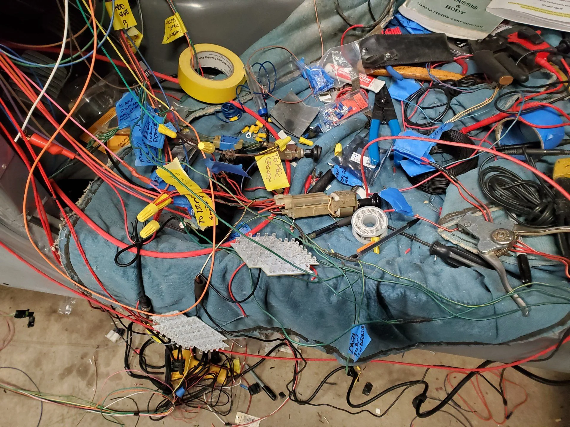

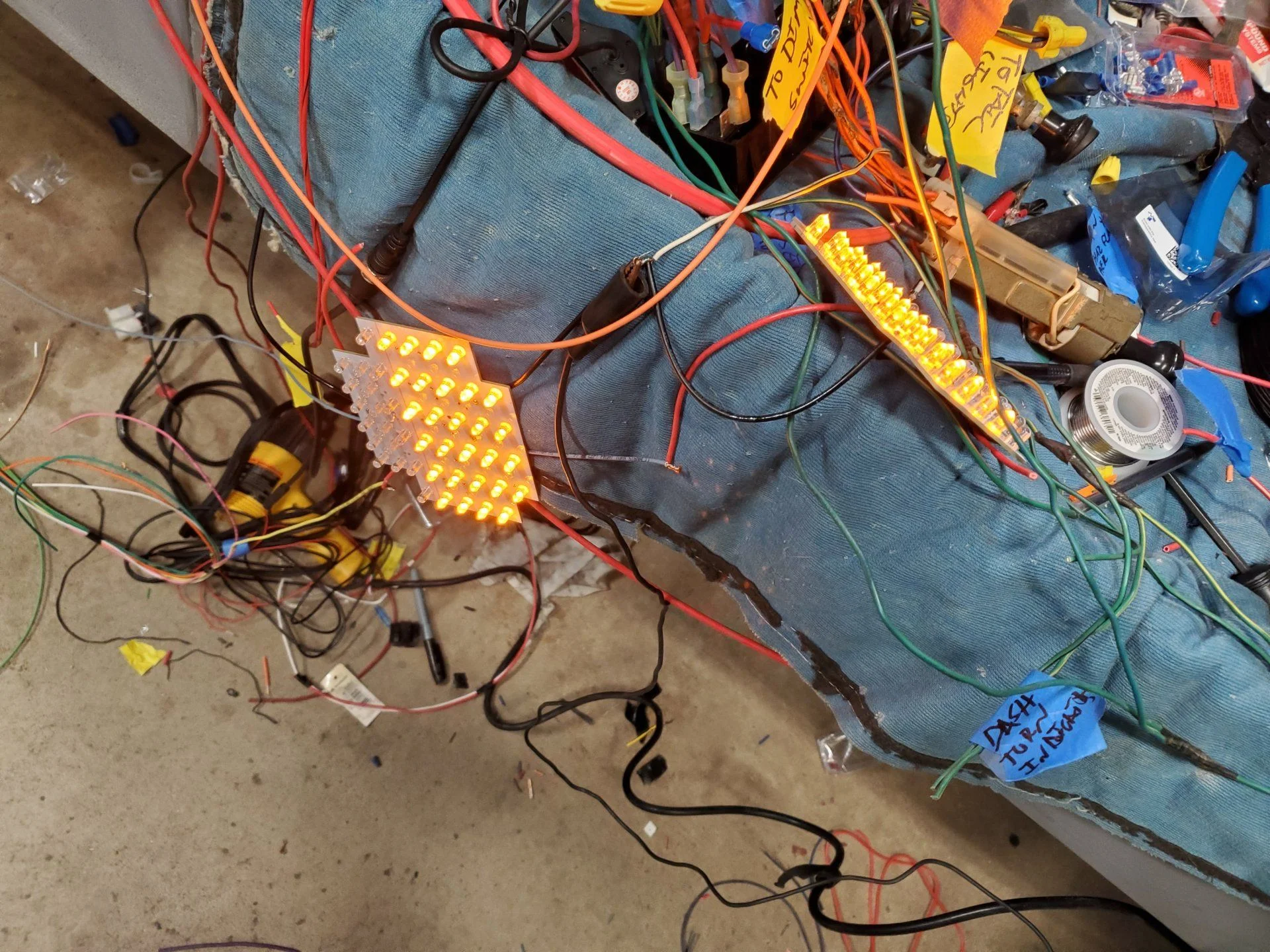

Small update.
I have been fighting with wiring a whole bunch, and when you are an absolute trogolodyte like me, it hurts your brain. My PO hacks have not helped.

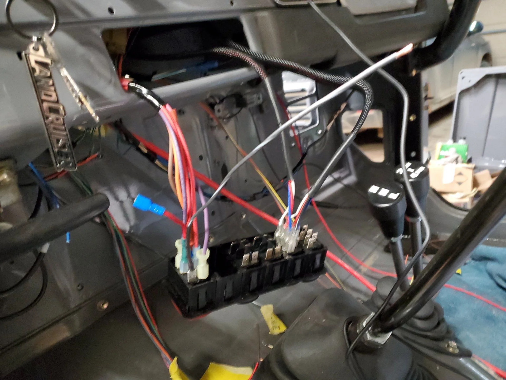

Light switch rebuild.
Current testing phase. I have the hazards, light switch, hi/low beam, and blinkers working.
I'll start installing and cleaning up the wiring tomorrow, and will try to get my wipe wash switch integrated.
Small update.

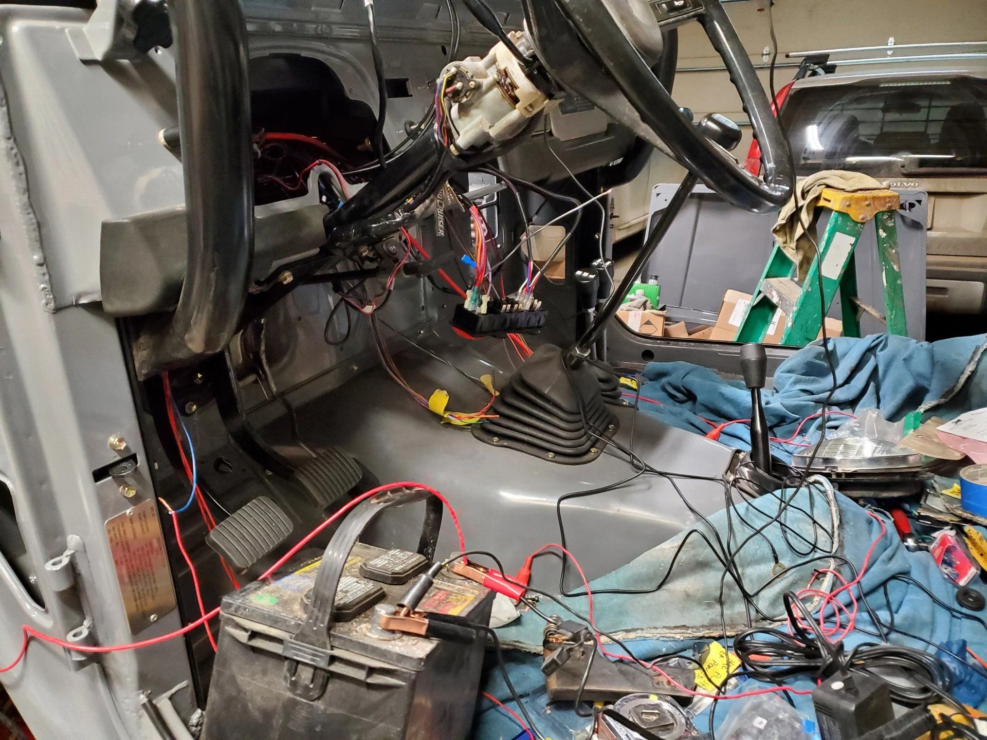

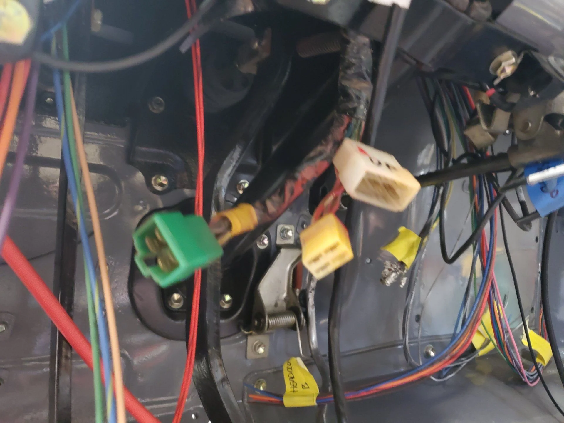

Most things are integrated, but I can't seem to get my wiper motor working. It keeps blowing fuses. Does anyone have any ideas why? I matched the colors for the 3 wires out of the switch and grounded it, I'm assuming the solid blue wire is power. Am I assuming wrong? Is there an easy way to bench test the motor?
Little update. Wiper motor and switch works great, but toyota was helpful and switched colors around through plugs. Some quick testing fixed everything.

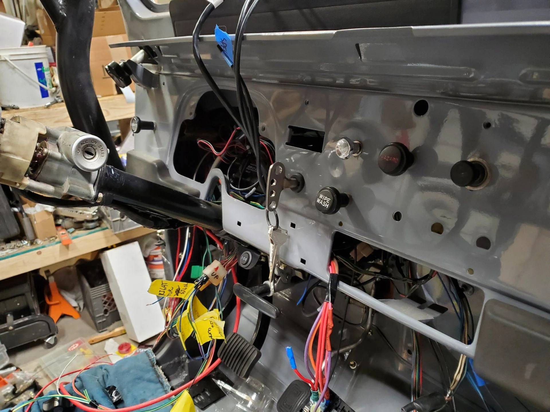

My dash is almost cleaned up. Its getting there.

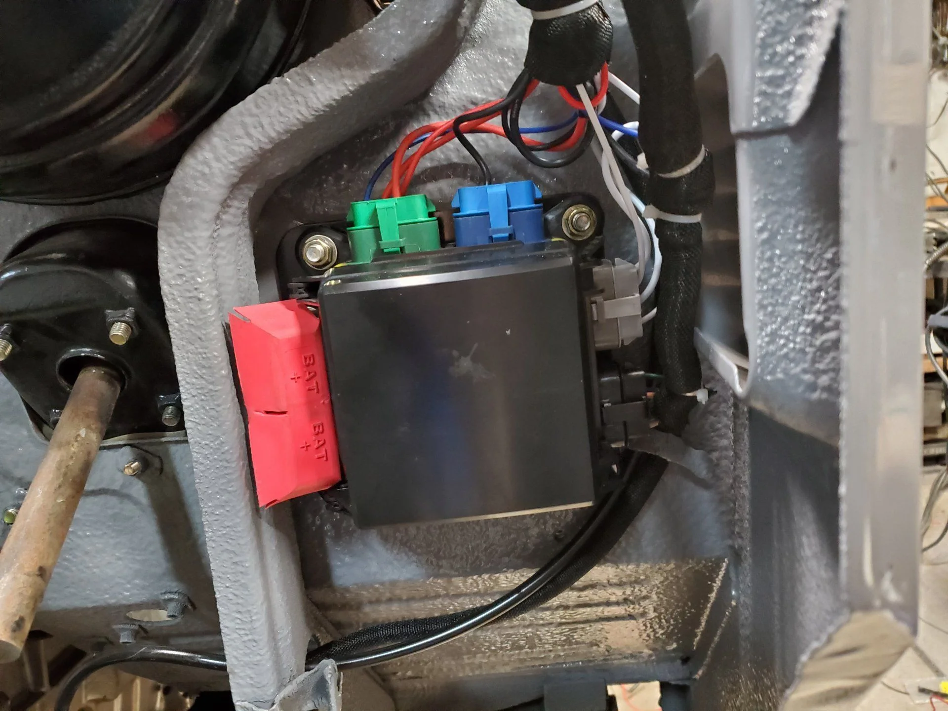

I got my relay box fully wired up. I am curently running my headlights, 12" light bar, aux backup lights, and 50" light bar through it. It is a super clean way to pack in 8 fused relays.

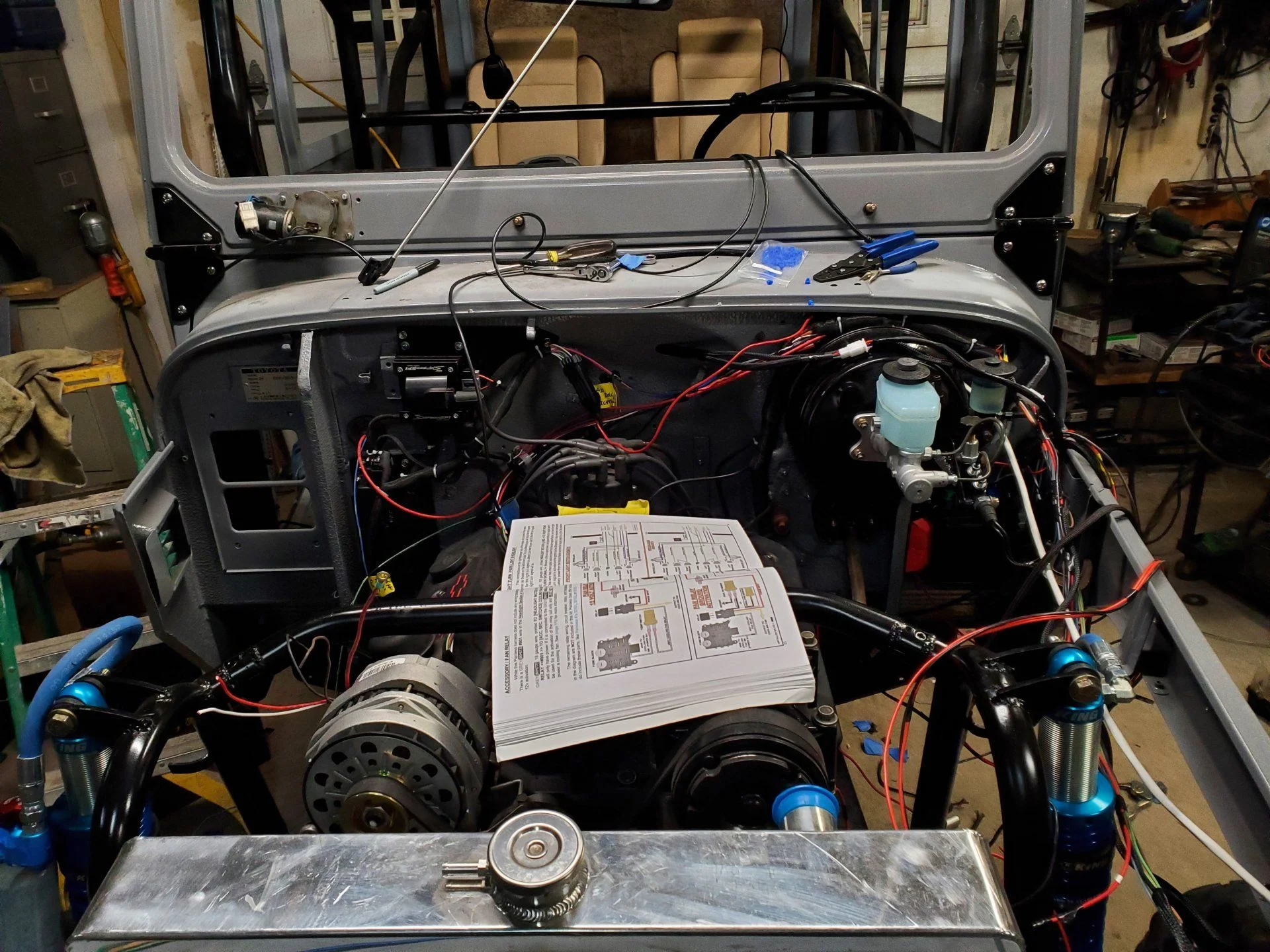

Engine bay is starting to clean up a bit.
