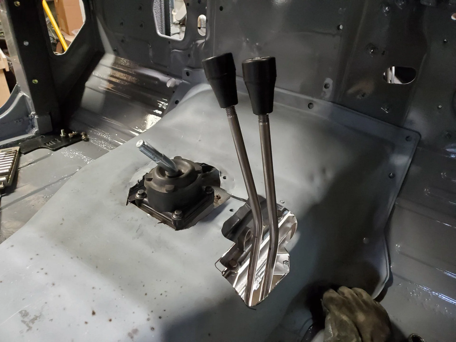

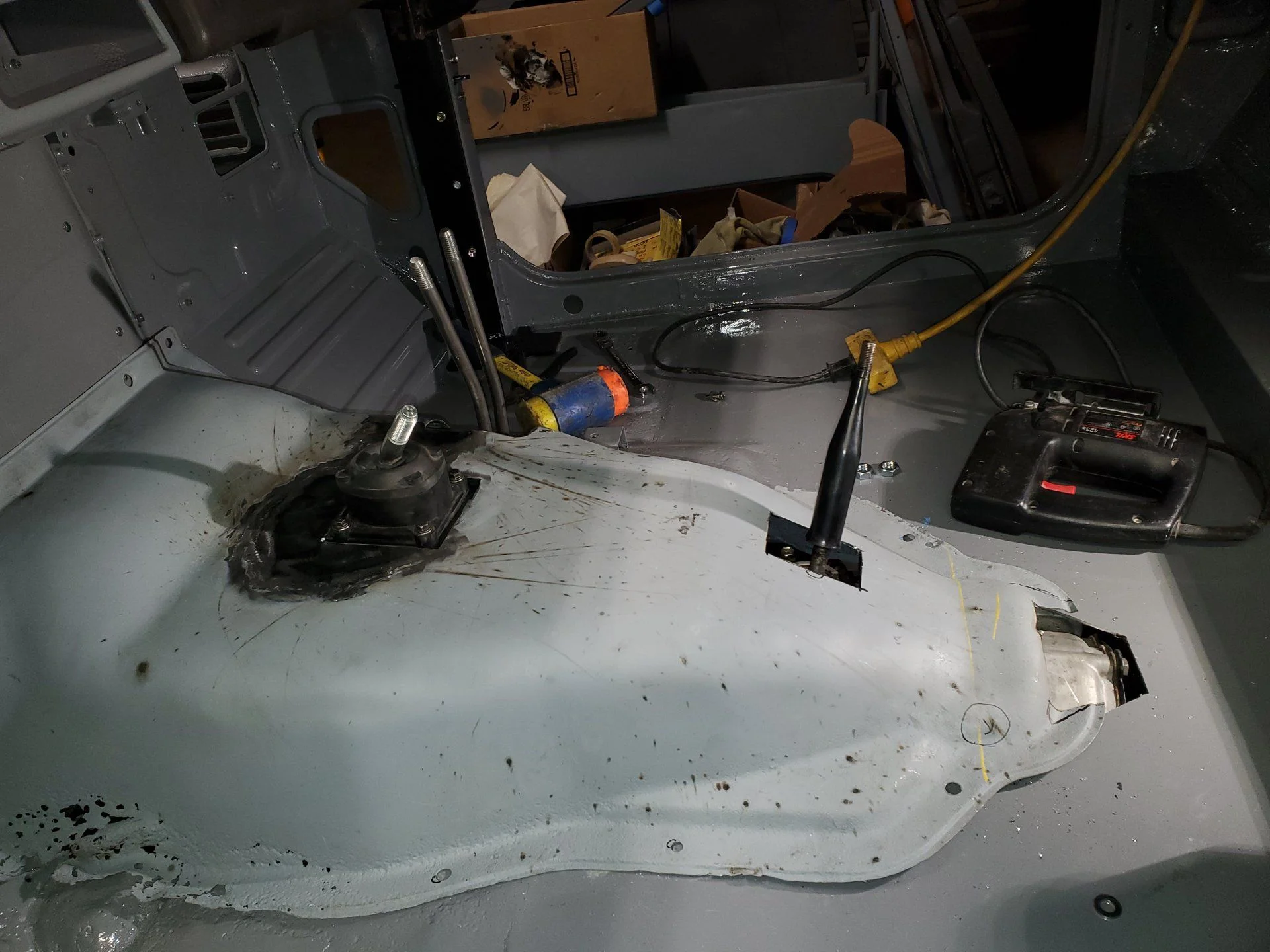

A few more pictures I forgot I had. The toybox shifts super smoothly. I really like it. It also just happened to locate itself in a really good position. I think I can still fit my cup holders in there and have access to the shifter. I'm happy with it.

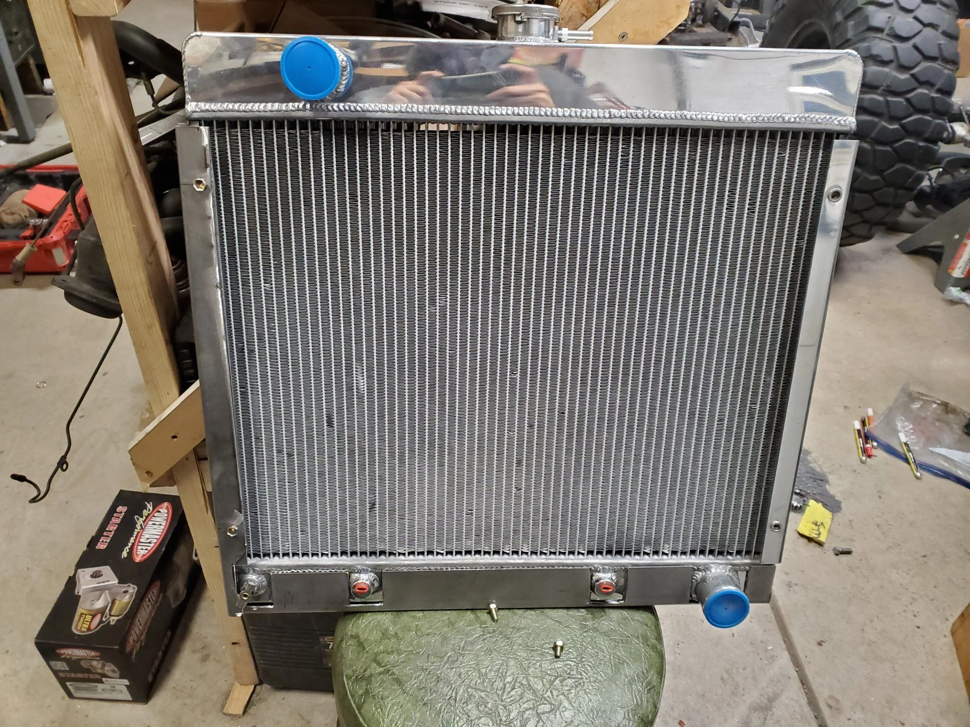

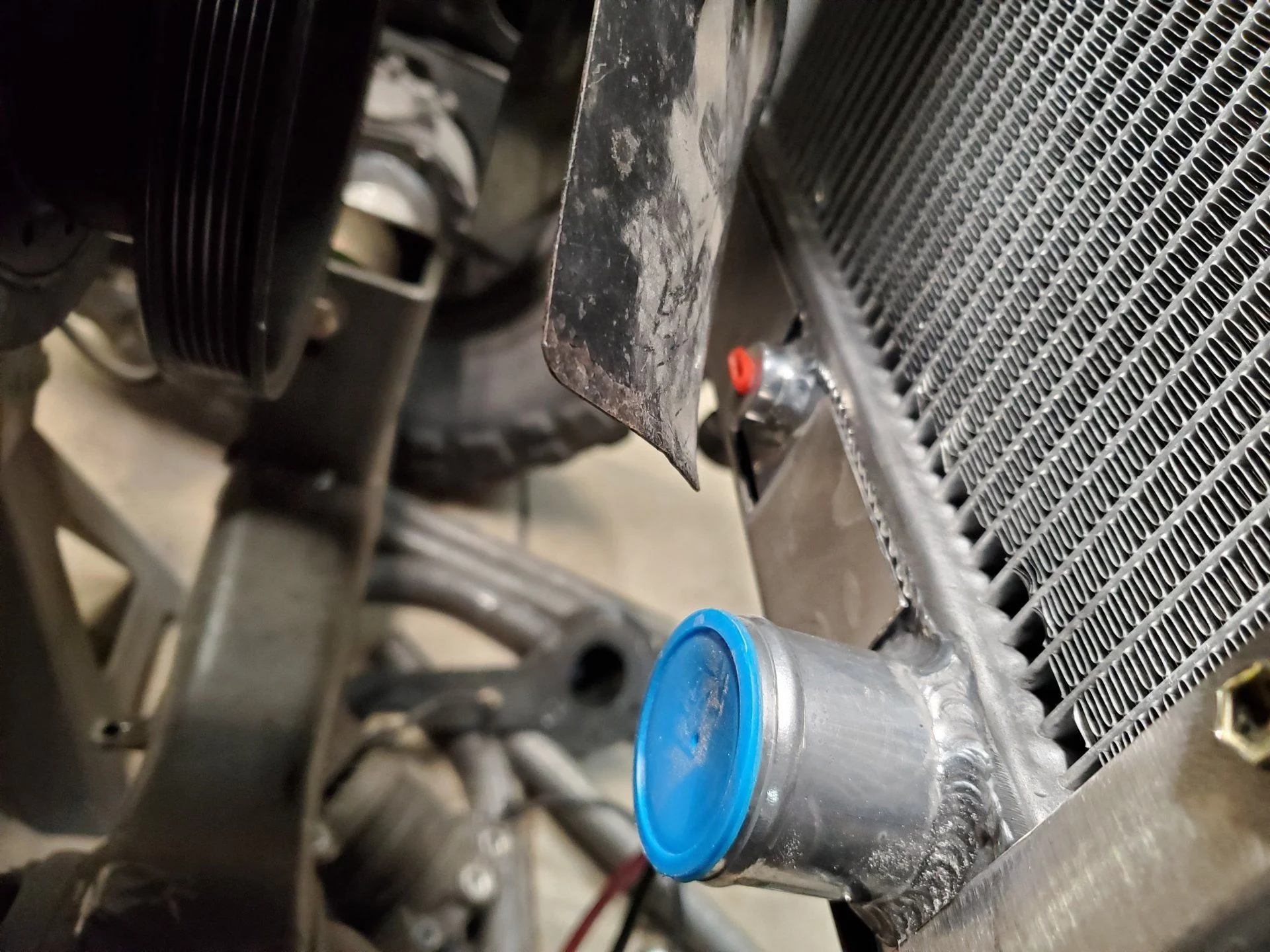

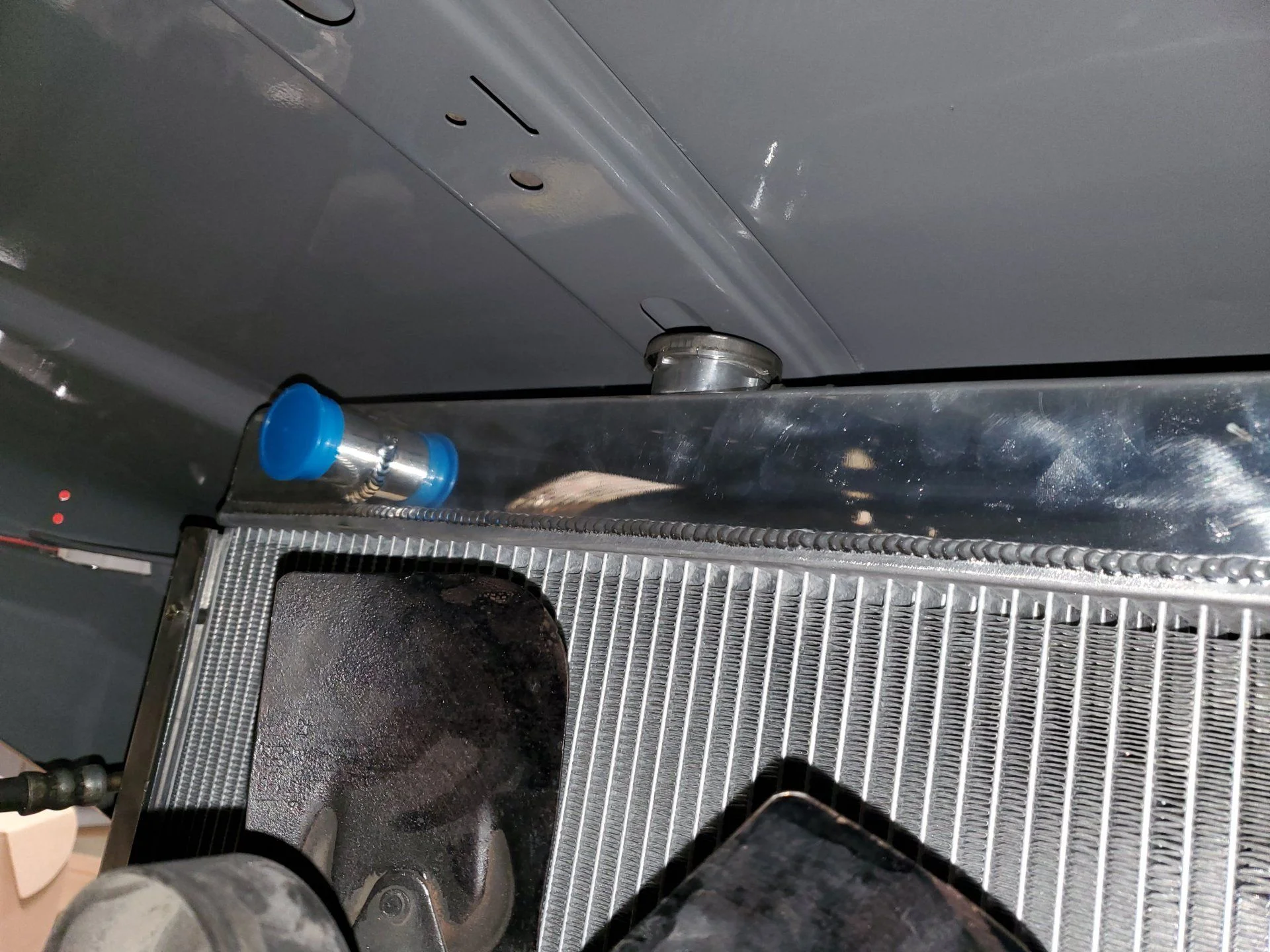

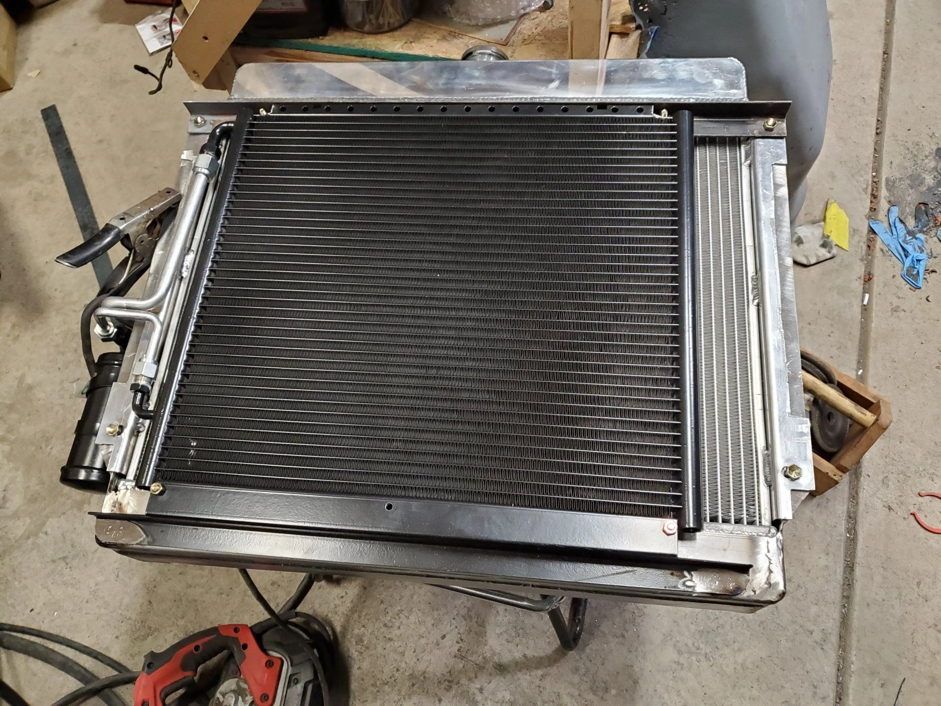

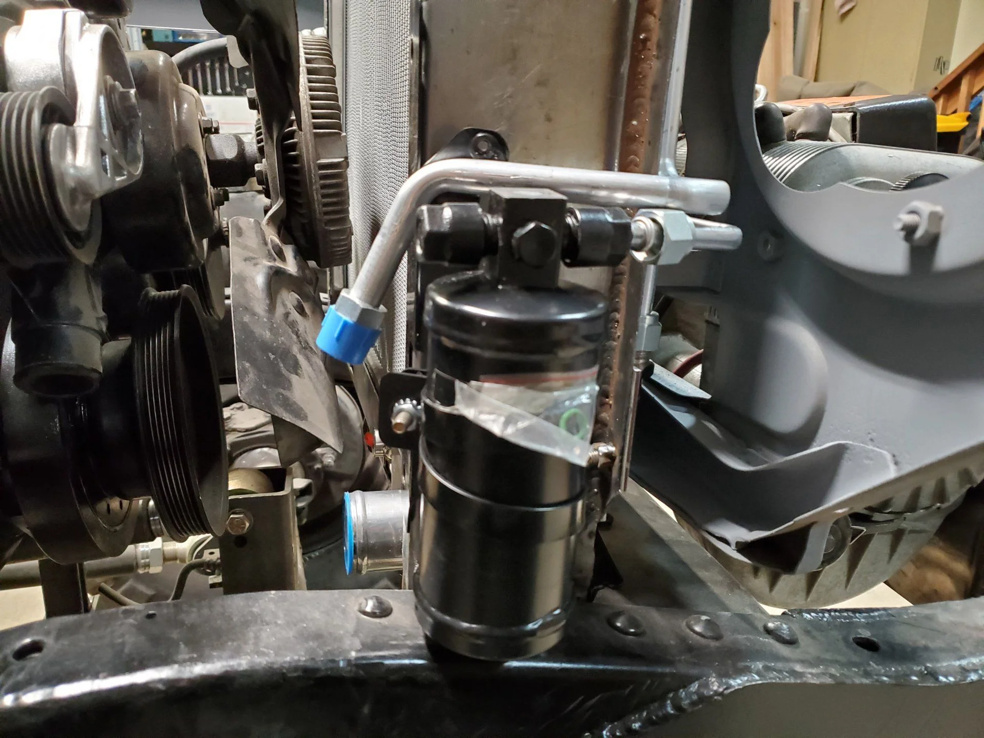

I stuffed the radiator and condenser in to verify fitment and spacing for the fan. It's tight, but fits well.
Tall and wide.
No issues with the outlet and fan wanting to meet.
The hood fits at least.

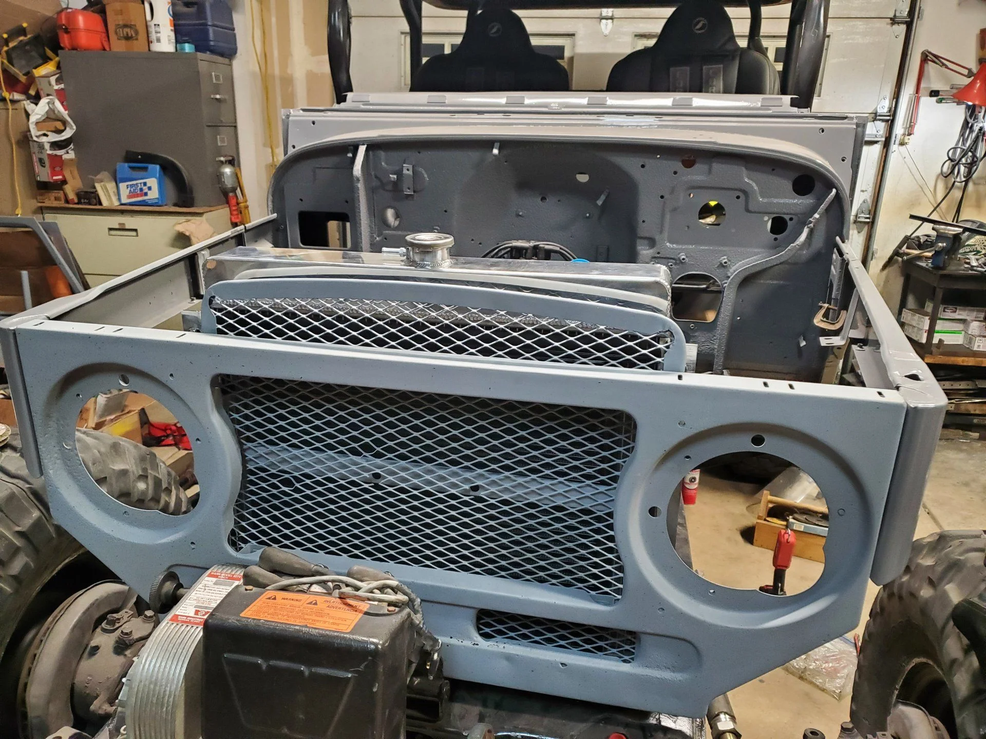

Finished getting the radiator mount done. I'm waiting to add supports as I am not sure where my shock hoops are going to be living yet.
Dryer barely clears the frame.

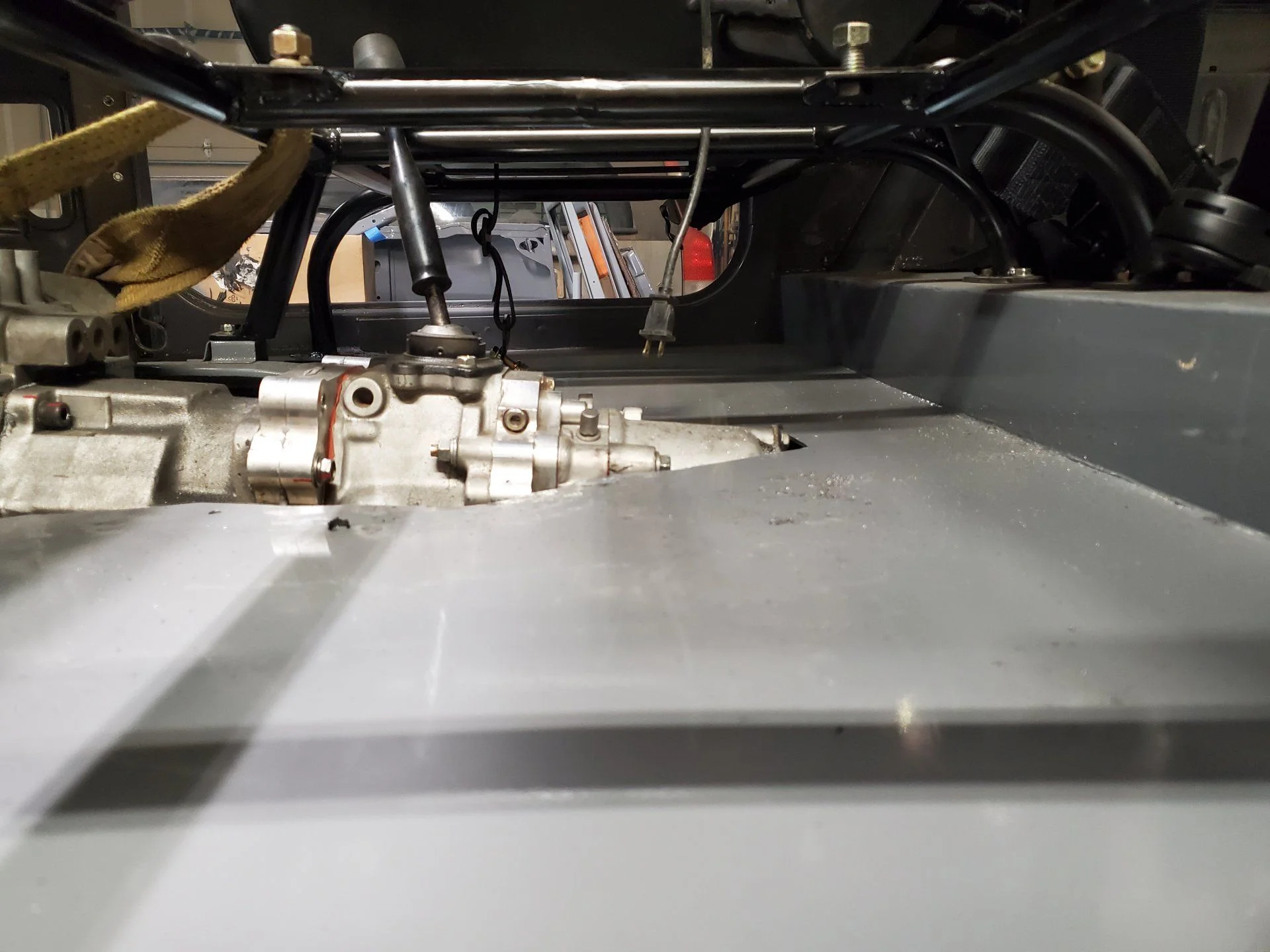

I got the floor trimmed for the splitcase.
I'll barely need to adjust the hump to allow for coverage, and I will just recess the current fuel tank design to go above it.

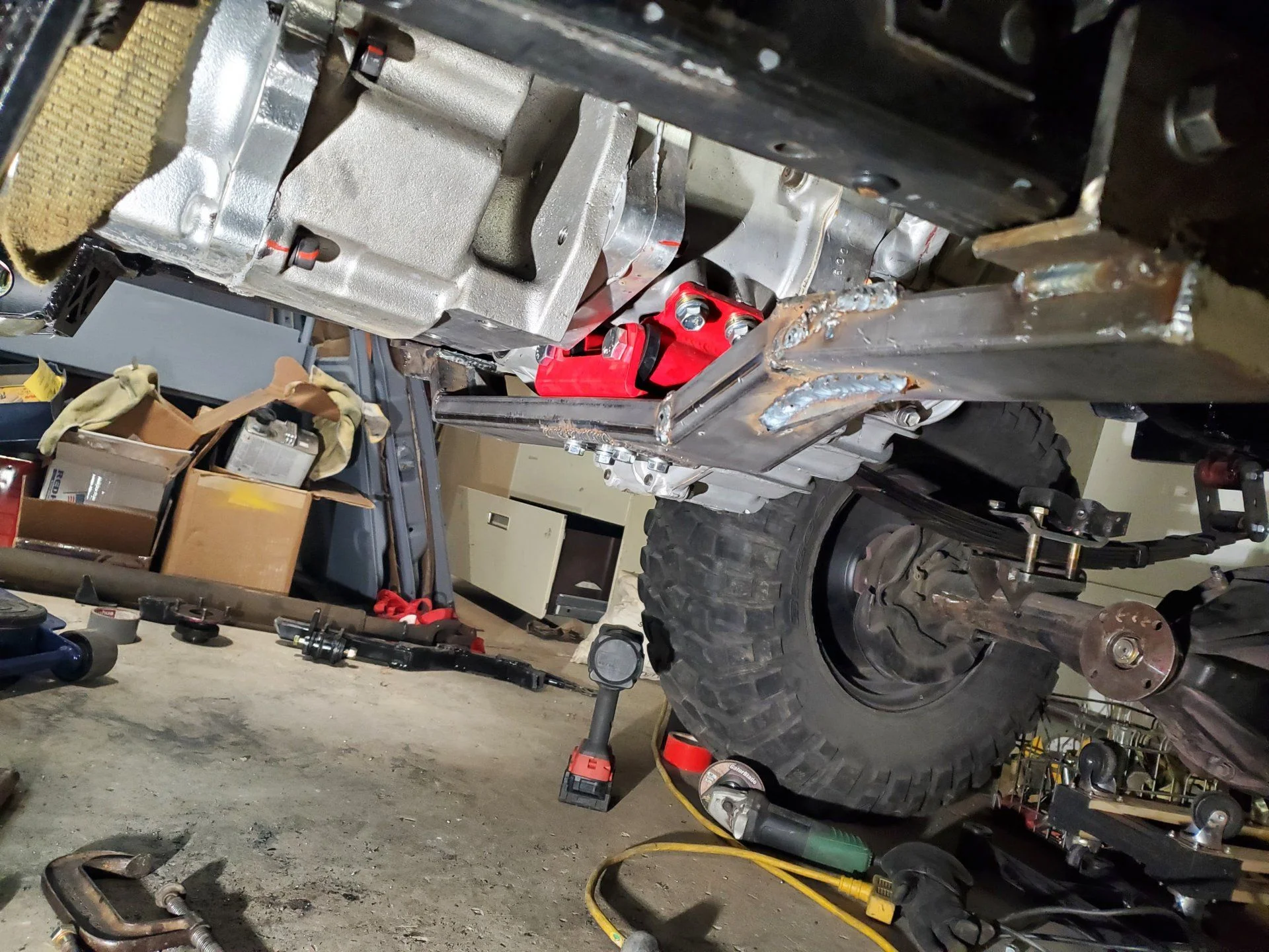

No pictures, but I got the engine fully squared up to the frame, and tighened down for the last time, so I could work on getting the transmission and t-case mounted.

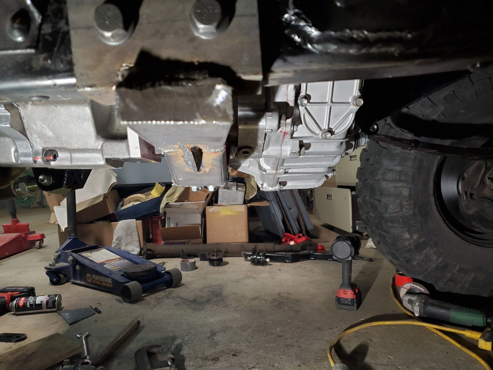

I built the rear crossmember that mounts to the toybox. It's fully removable, and I will be building a modular skidplate that mounts to it.
The bottom of the transfer case is right at 19 1/2" not the best, but it optimizes my ground clearance and rear driveshaft angle. The hump will be getting full 1/4" armor so I can drag it around on rocks without hurting it.
That rear driveshaft is so short. I still can't get over it.

It is, and I really hope that I can get away with it. IDK what I'm going to do if I start eating those up.

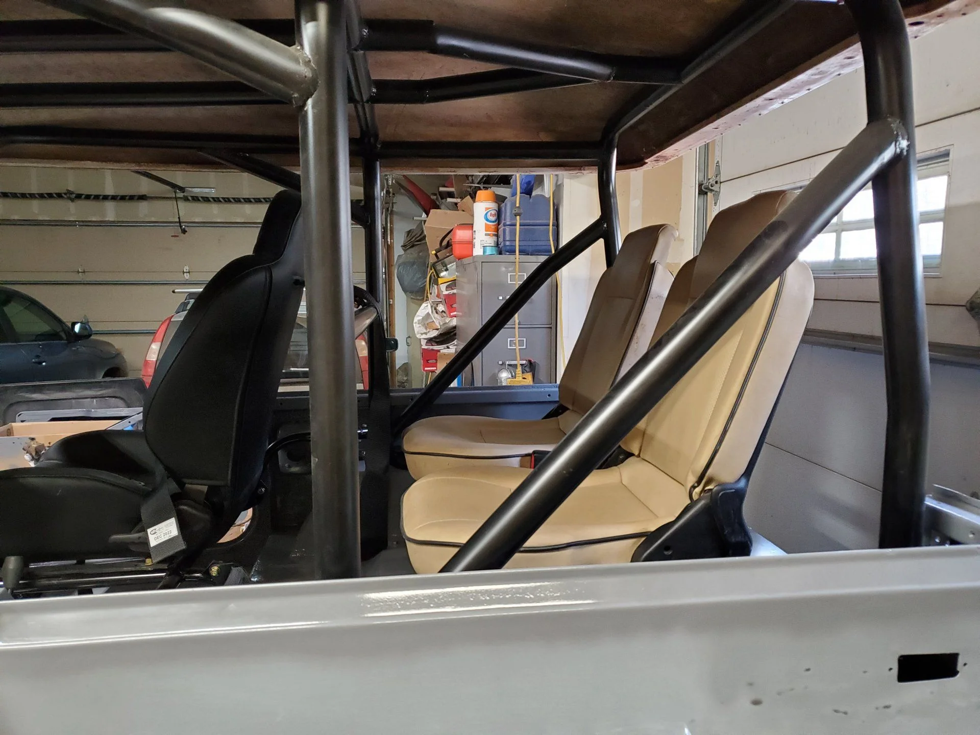

With the help from my dad, I got the rear box and seats in.
I need to get the seats dyed and ready for final installation, but that will be for another day.

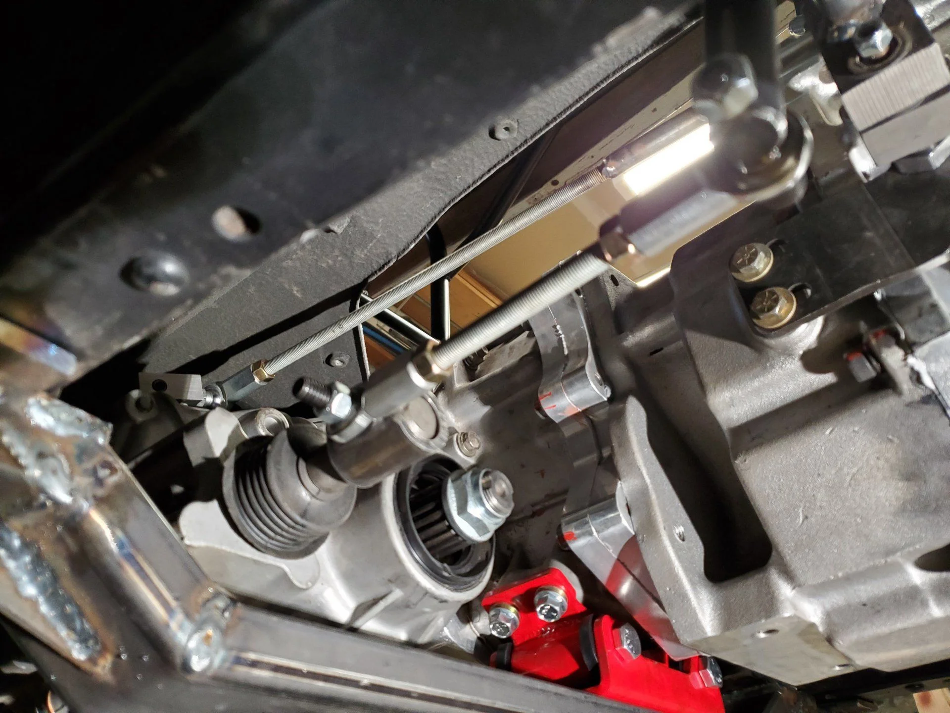

Twin-stick part 2, electric boogaloo.
I'm using @orangefj45 's doubler kit for the split case. It went together well, but the H-N-L rod was just a bit short for this application. That was solved with an extra bit of tube I had lying around.
I really like that the blocks that are supplied are even, unlike the AA kits.
My only gripe is that all the holes seem slightly undersized for the shift levers, 2W-4W rod, and the piviots. A small bit of grinding on everything allowed for them to drop in, though.

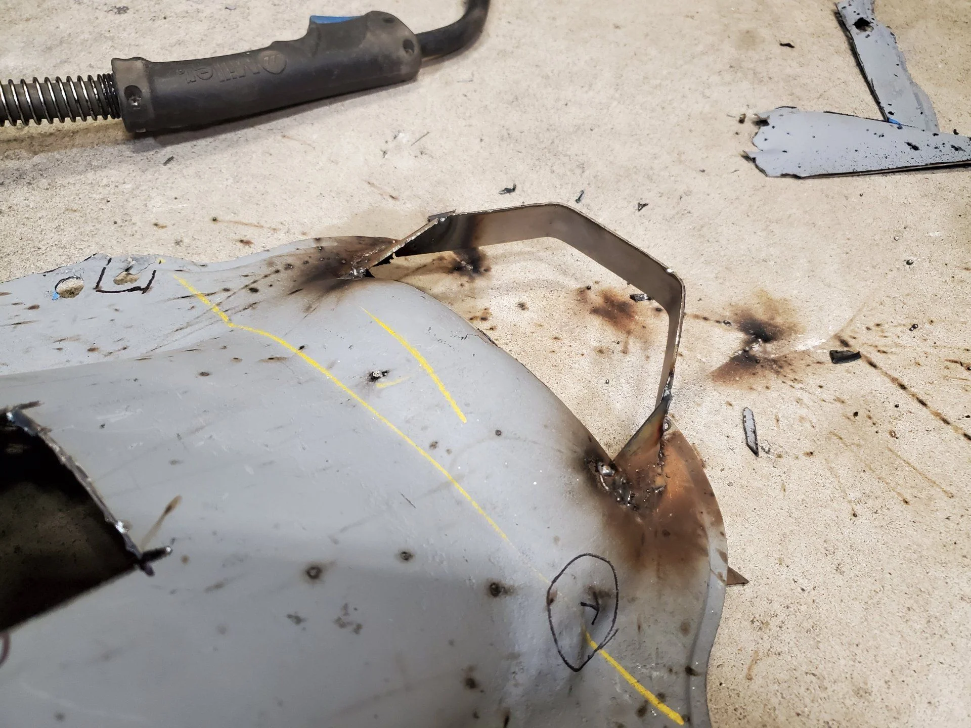

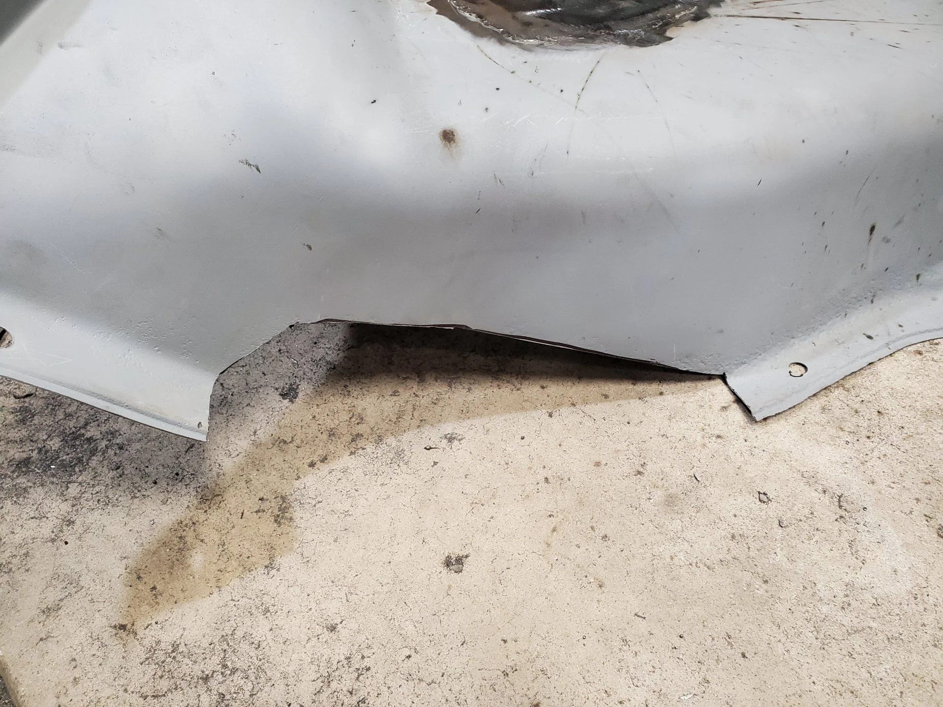

Starting to modify the hump.
I decided to completley cut out and replace my PO's work with a wrench to bend the lip up. All the metal was streched, so it would have taken forever to move it back.
Done.

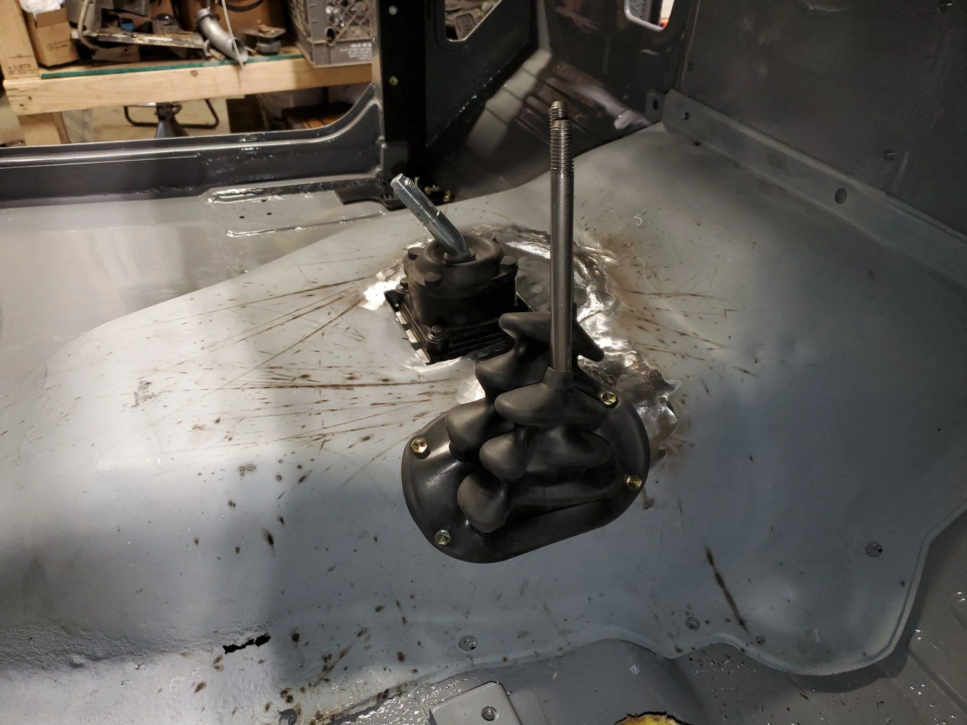

Boot installed.

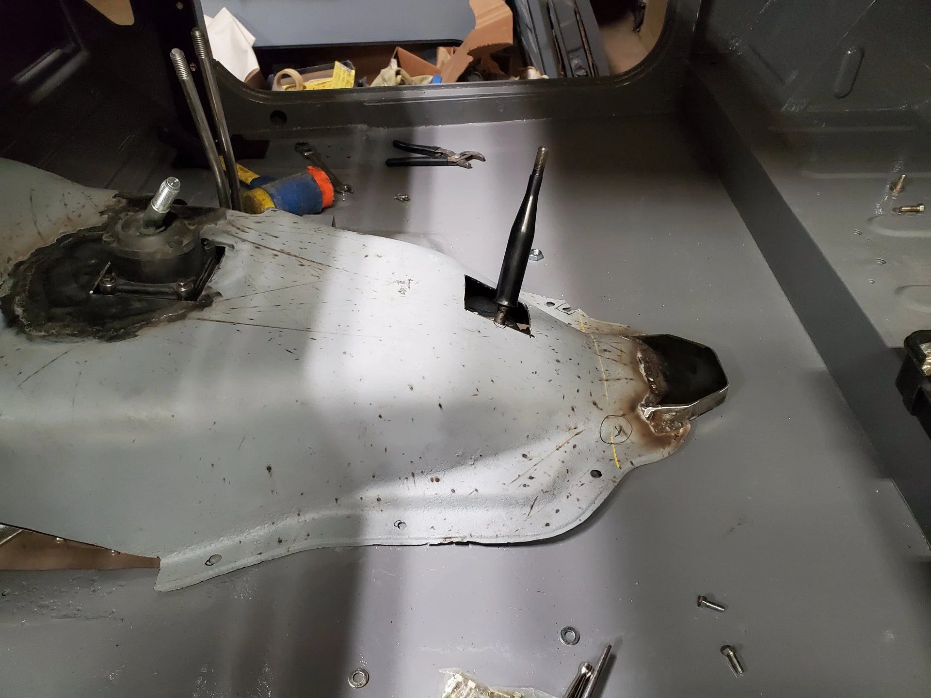

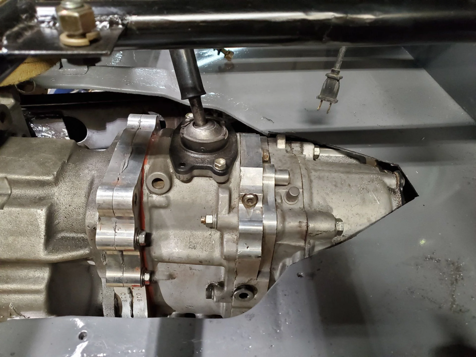

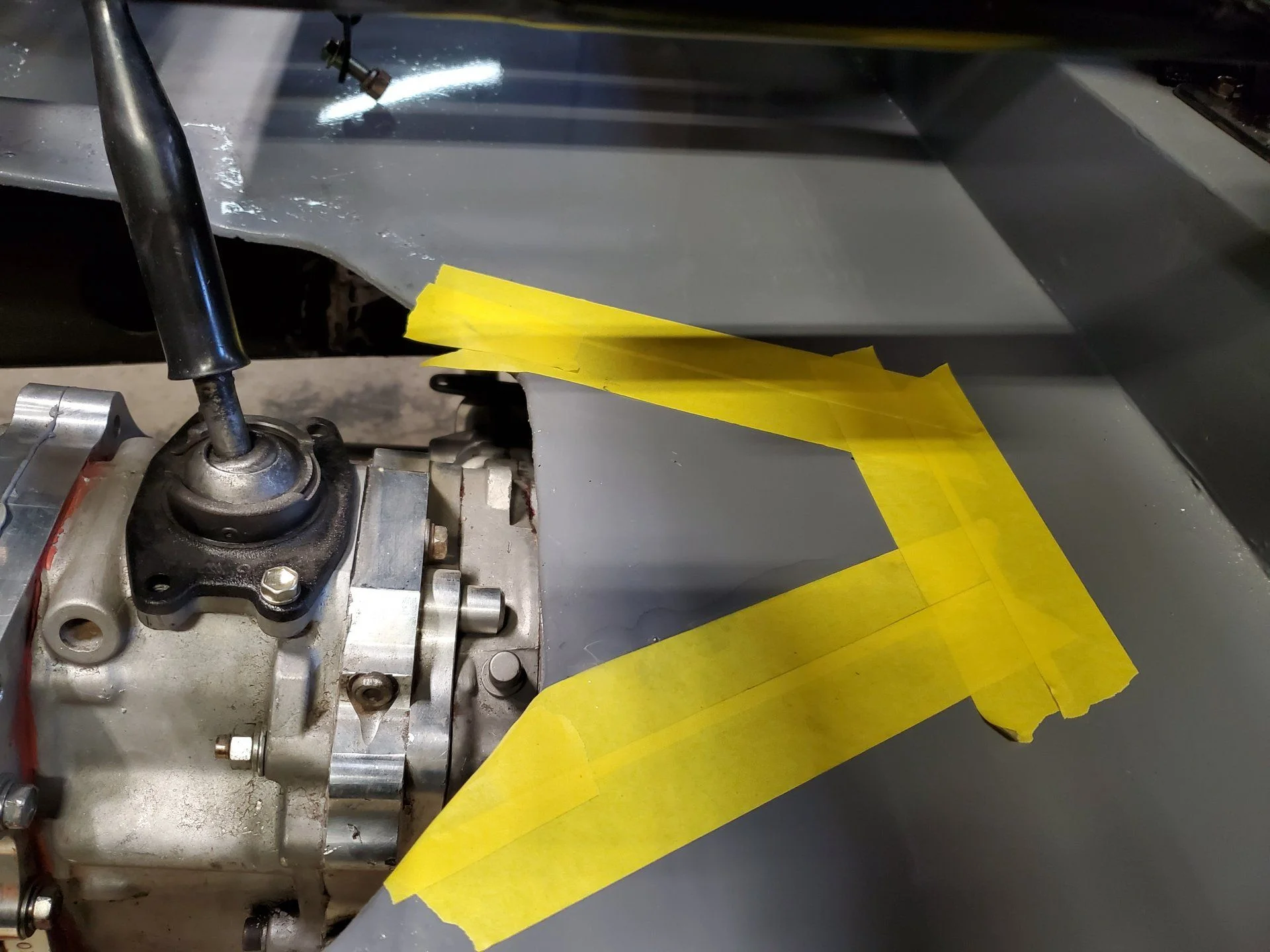

Toybox shifter hole cut out.
Modifiying the tail to allow for the splitcase.
Welded up.

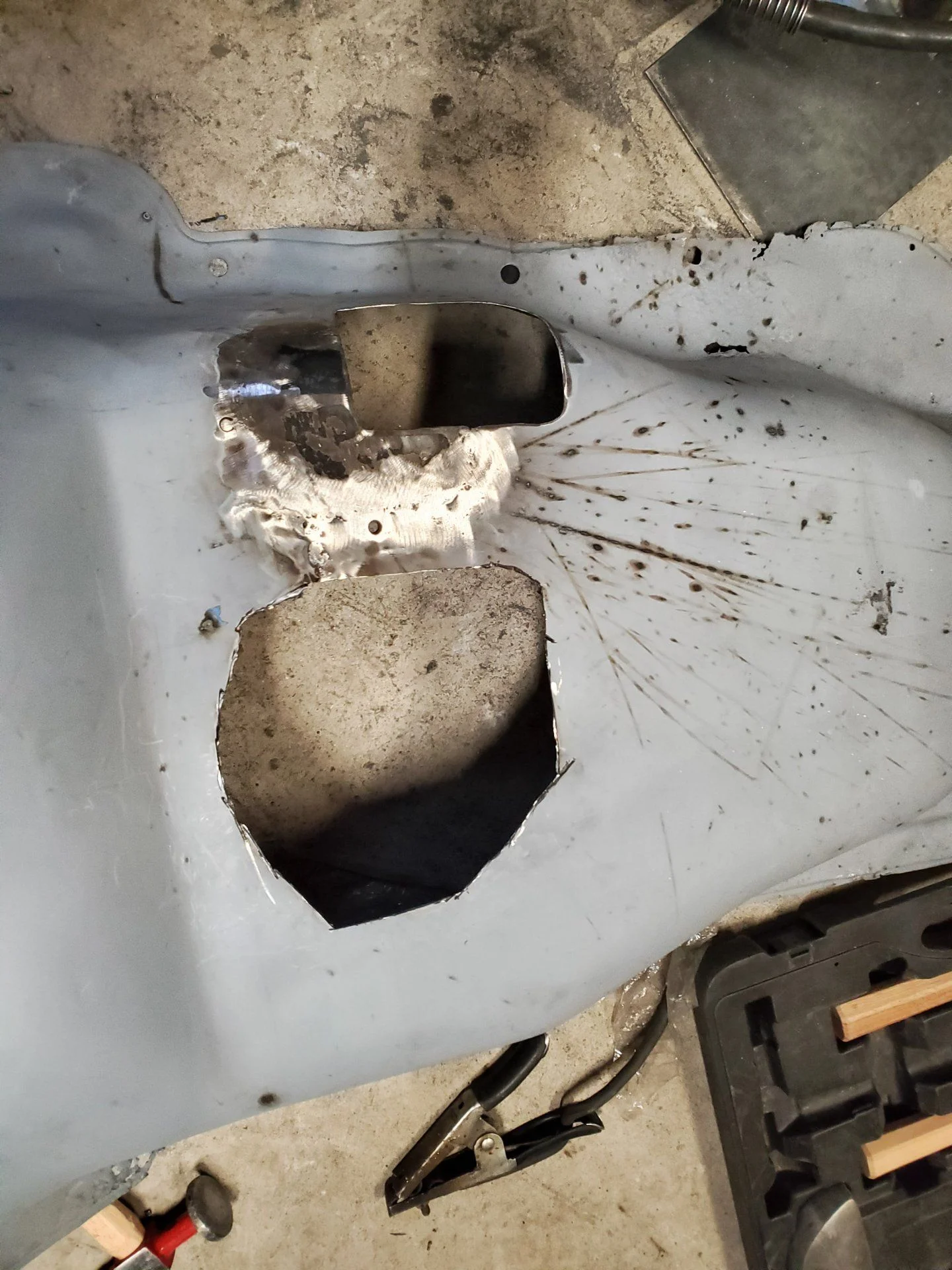

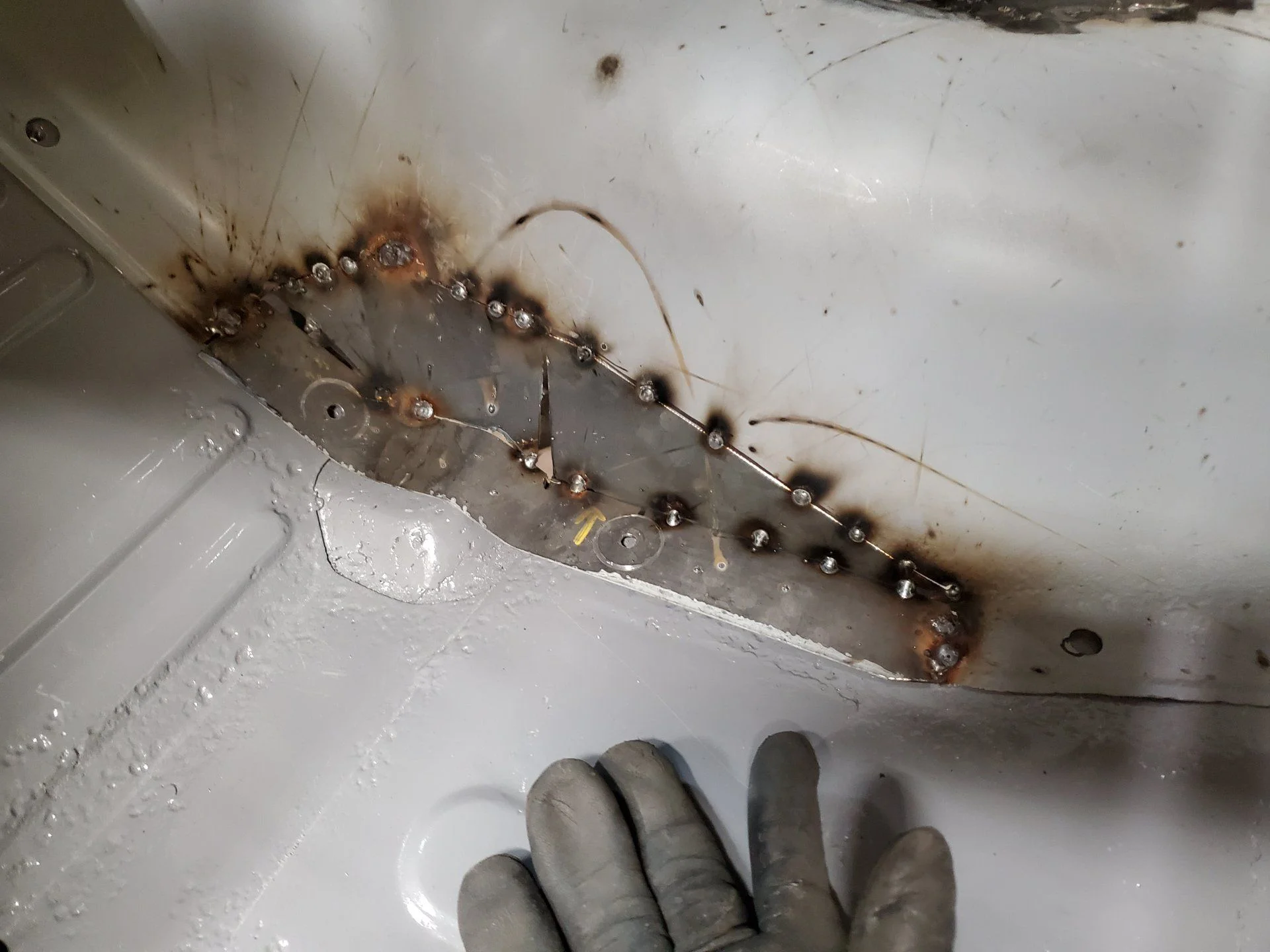

Hump Rust Repair
Removing cheese.
Started to fill.

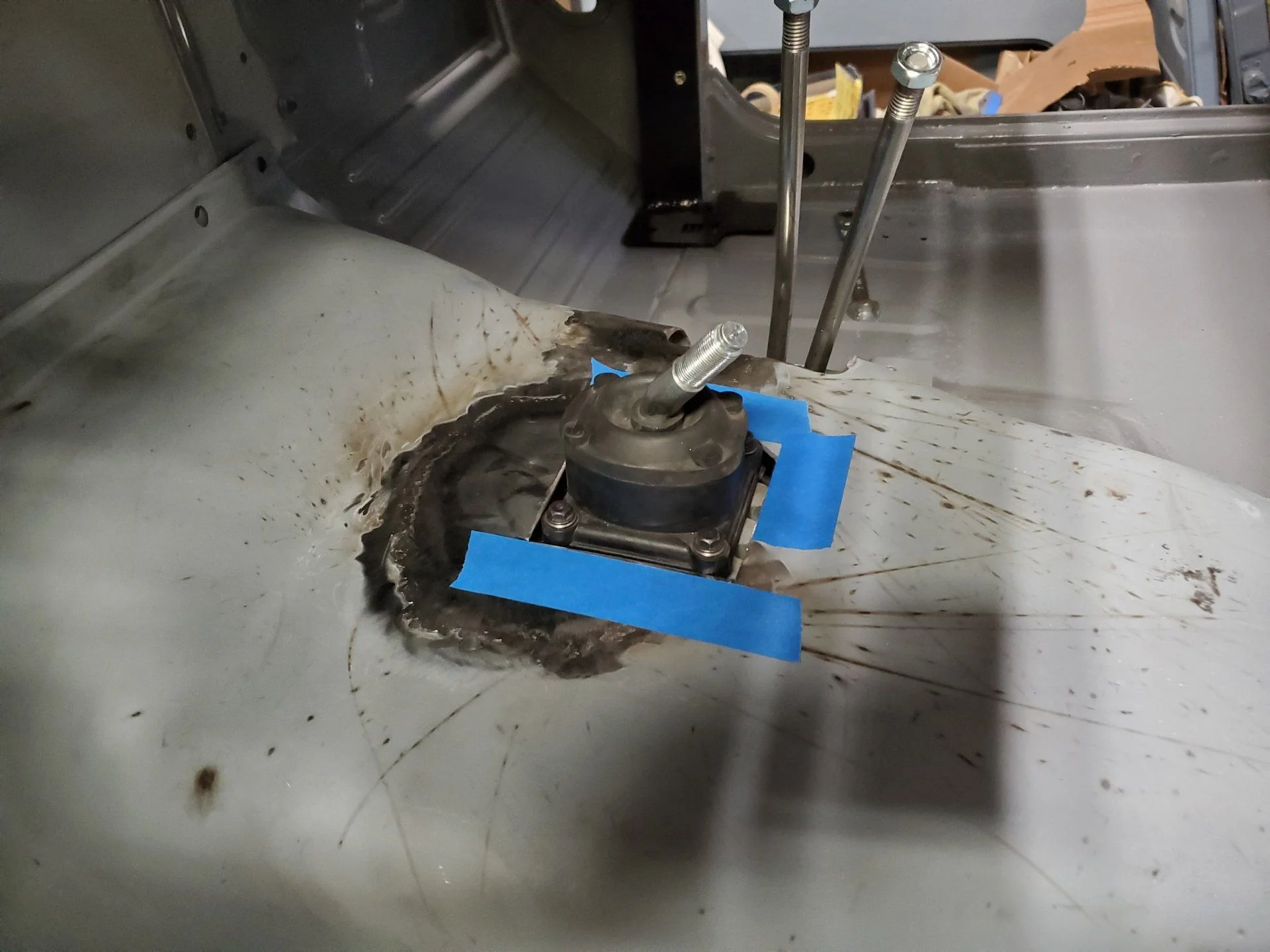

I would HIGHLY recommend enlarging the transmission tunnel hole around your NV4500 shifter. Mine was like that and when I had a motor mount going bad the plastic shift tower hitting the body was enough to pull all four of the M6 bolts out of the top cover, and I had even heli-coiled them, too. I since put steel thread inserts as a repair, but would hate to see you have to deal with it.
Good to know. I'll be sure to do that. How much spacing do you think is needed?
it's really only the sides you have to open up, I'd give it at least an inch on each side to be safe. Also, if you don't already have a shift boot the FJ60 boot works really good
I've been looking for one. Is the 60 boot a rubber one?
I was going to say the same thing that matt is about enlarging the trans shifter opening. The 60 inner and outer boots are rubber, yes.
