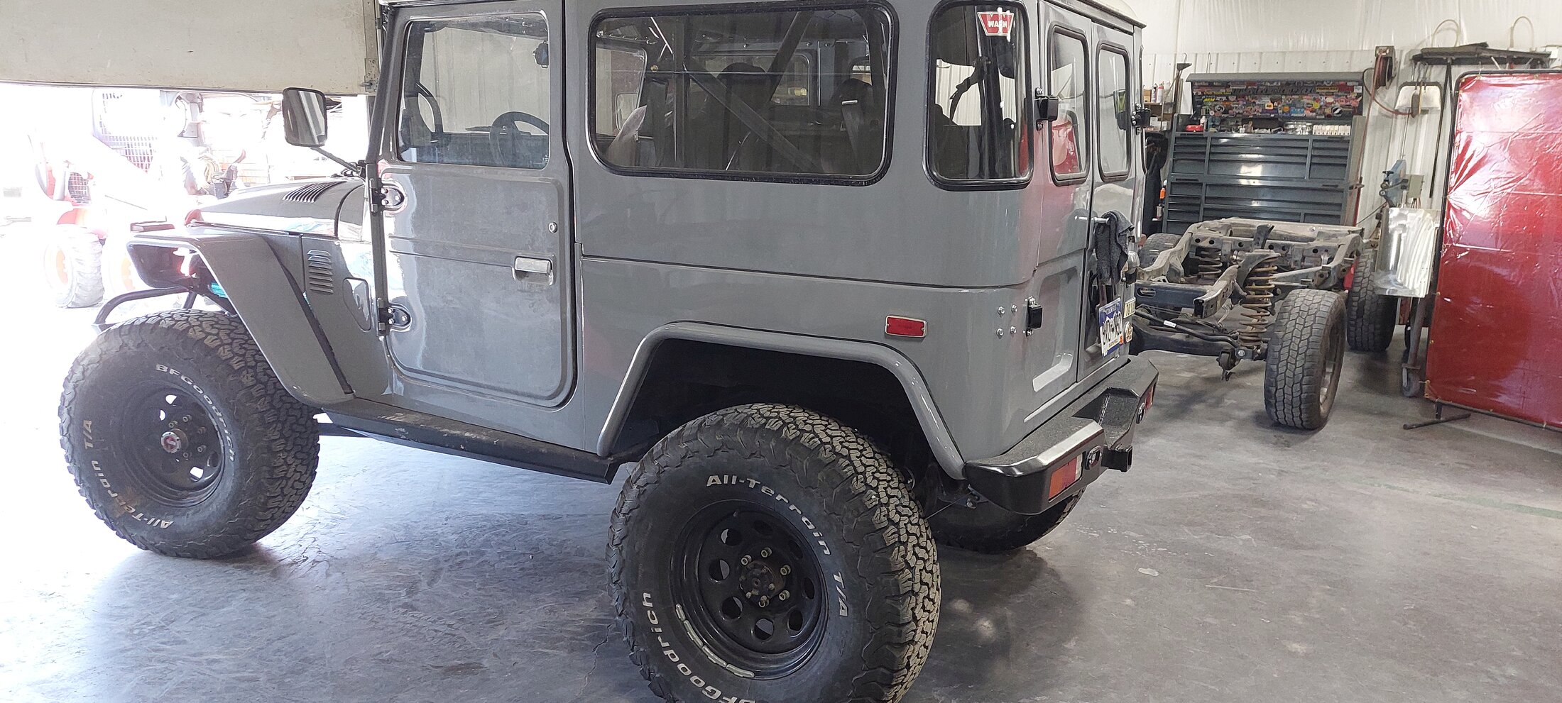

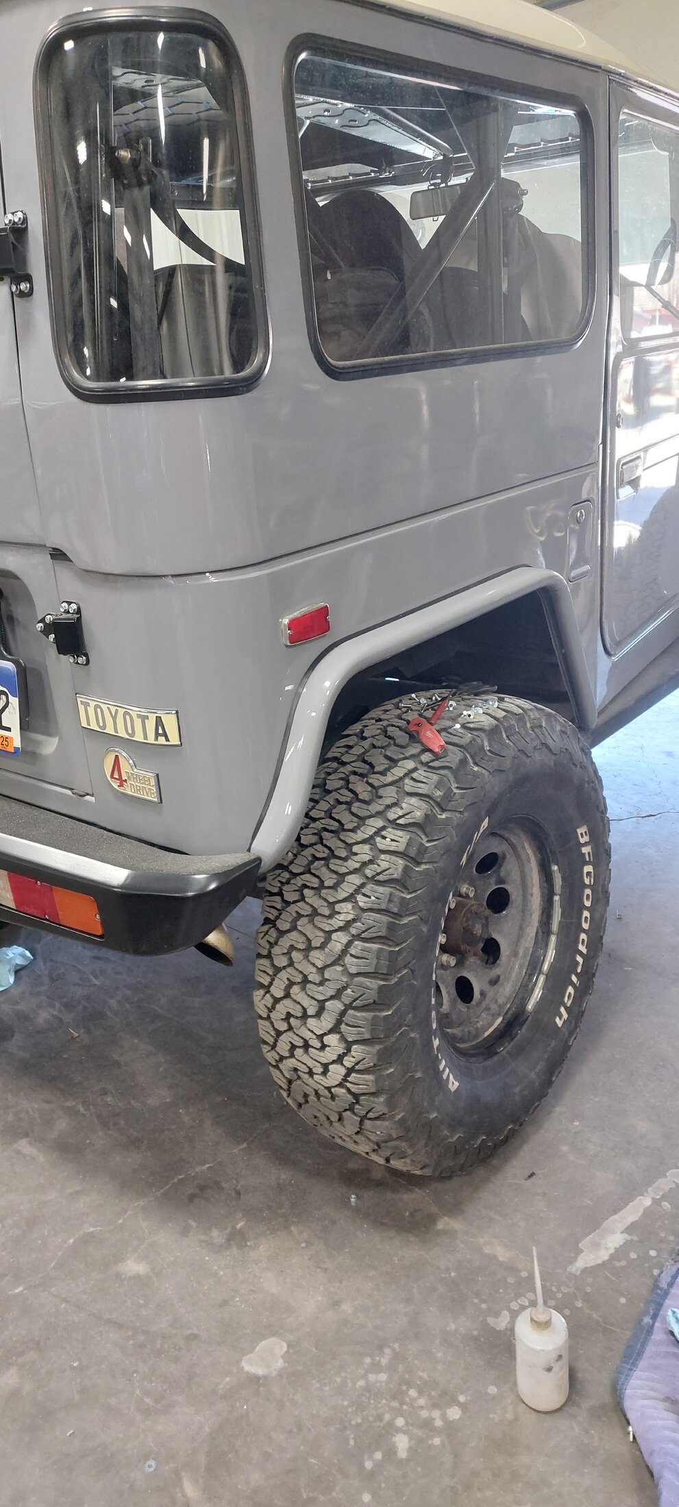

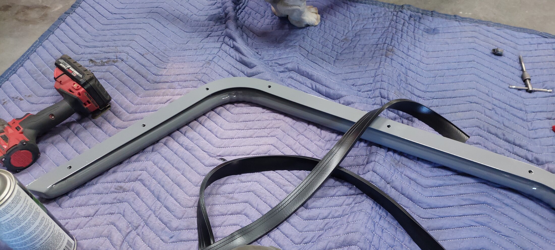

Went to the gym and then to the helpful hardware folks place and picked up some weatherstripping for the rear flares. It's definitely not garage door weatherstrip or anything like that :rofl:
Anyways, it worked well and looks good.
