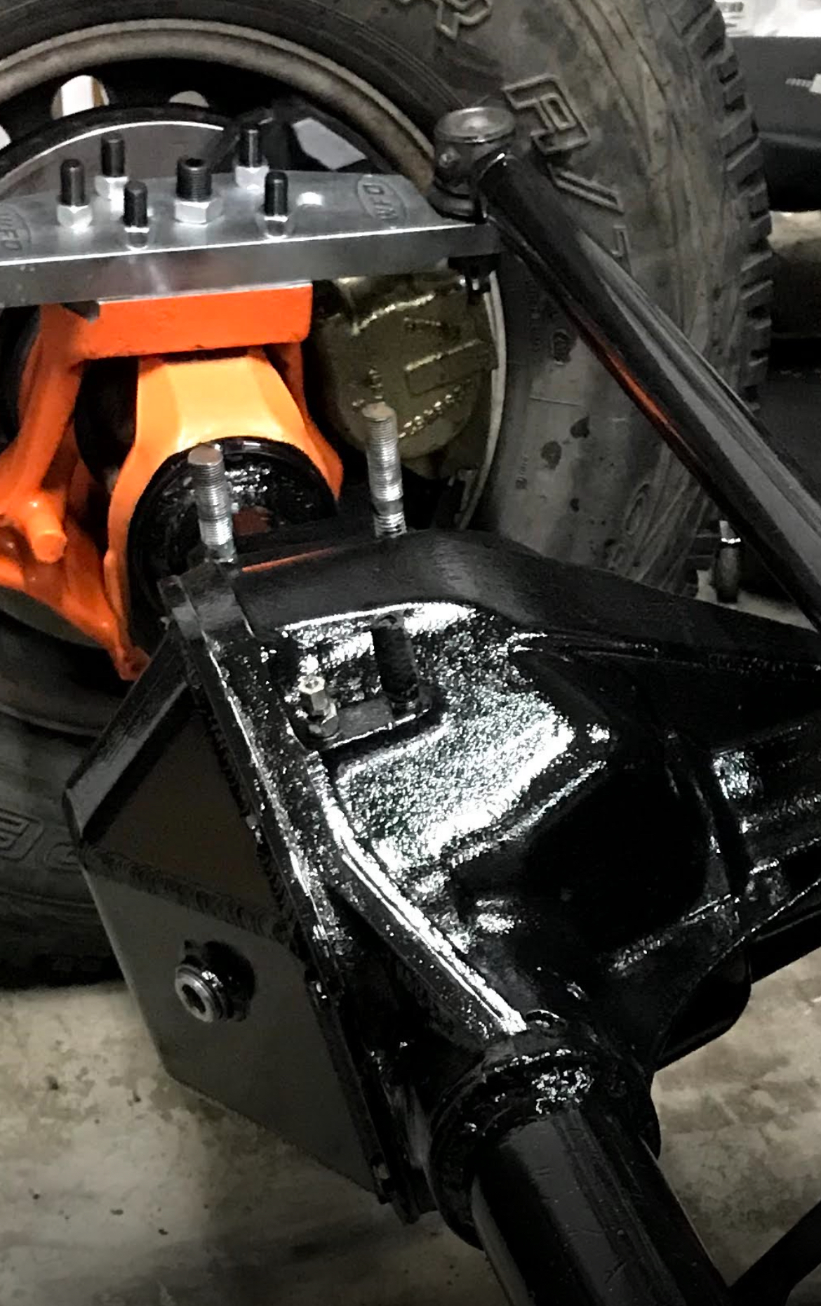

Set the toe today. it was toed out 1/8" I reset it to 5/16" in. I used these home made bars to set it. they work like a charm.

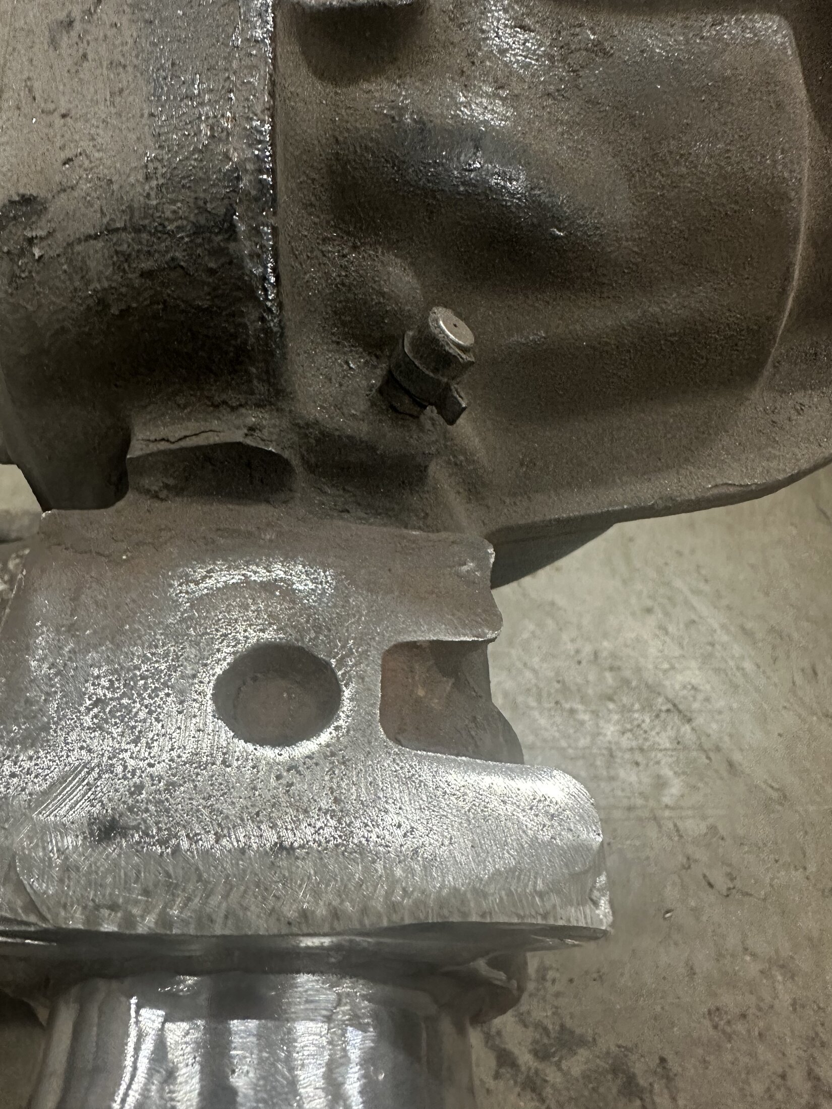

When I went to pull the first bolt on the front a big puff of air came out 🤨 so I thought the vent must be clogged.
I have look and I can't find a vent is this normal on a Dana 60? I have little to no experience with Dana axles
It does have drive flanges so it's turning all the time.
Thanks in advance for any Help/input
So maybe I can drill one of the unused threaded holes all the way through and use that ?

They are more likely to leak if you don’t have a vent. You’re effectively pressurizing them as they get hot. To make it easy, and avoid getting metal shavings in not nice places, I would drill and tap your diff covers and use 45 or 90 degree brass fittings if you have the room, run to a breather hose and you can put a little check valve on it if you’d like. Or if that won’t work, drill and tap on the differential housing with the cover off and a rag where you can catch the shavings.
